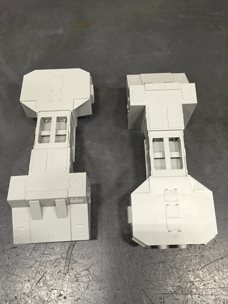

Both ends of the vehicle built up. Like many of Takom's early kits, it is made up of many duplicate parts / assemblies. This is where I left off on it, with most of the sub-assemblies completed.

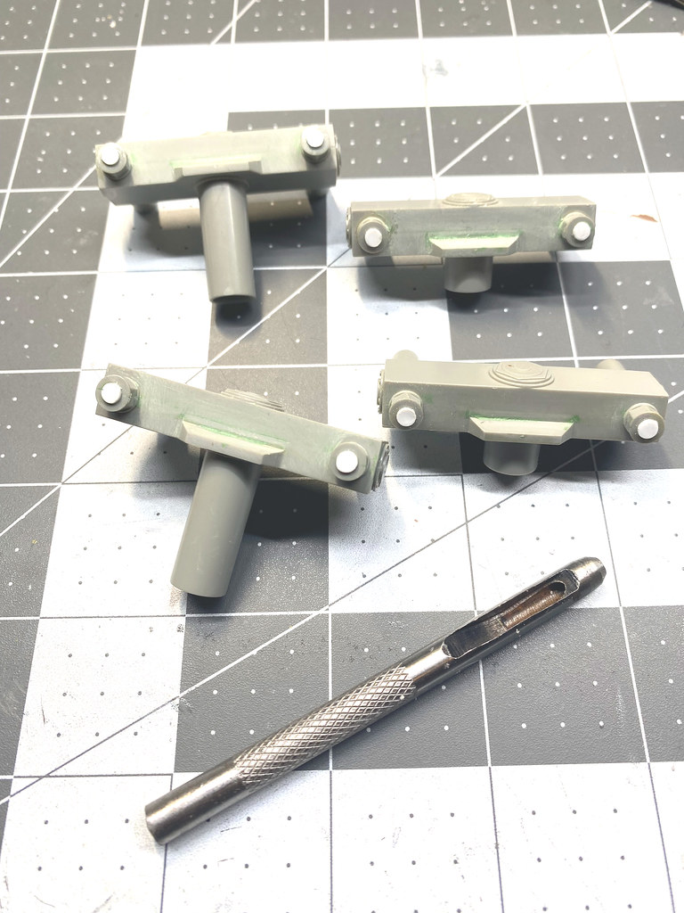

When I picked it back up, I started by filling and sanding the seams on all of the sub-assemblies. These are the wheel mounts, and on the bottom of each were small raised circular plates. Sanding the seams around and through these was going to be a pain, so I just sanded them off instead of trying to work around them. A hollow punch and .010 sheet styrene quickly and easily restored the detail :)

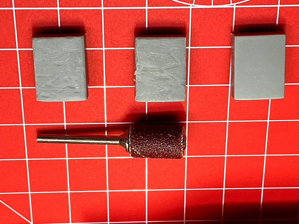

Next, I worked on the 64 pieces that represent the solid rubber block pads around the wheels. The actual vehicle was tested and moved around under its own power, and at 130 tons whatever it ran over was sure to leave impressions in the pads. I used a nice little rechargeable motor tool I got for Christmas to randomly rough up the pads, then used a small wire brush in the same tool to remove any styrene "fuzzies" created by the sanding drum and to soften the wear marks on the pads.
