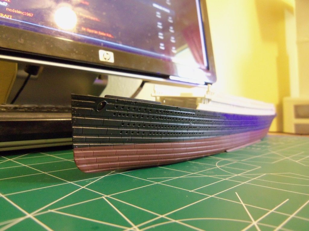

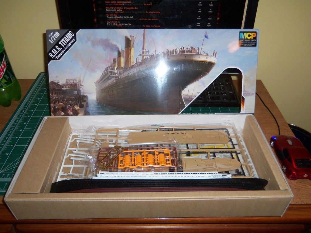

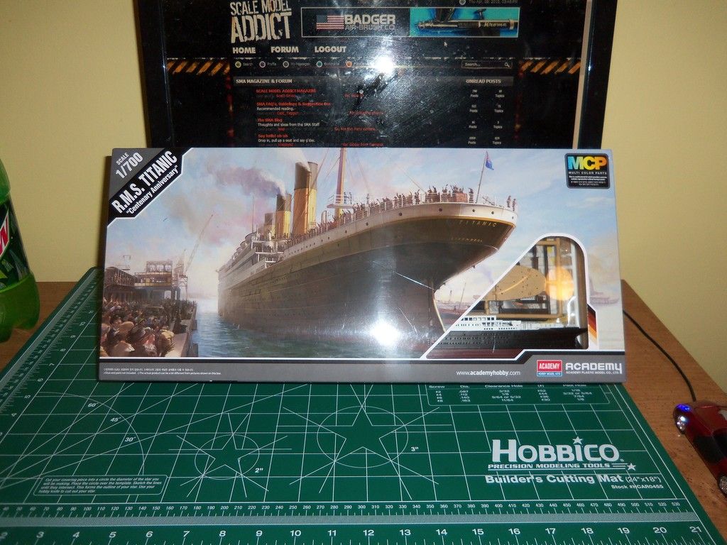

First build log and first entry into the BSC 15'. I've chosen one of my favorite subjects to get back into the swing of things. The kit finally came in today!

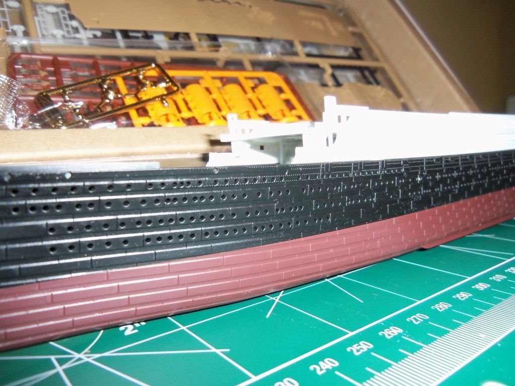

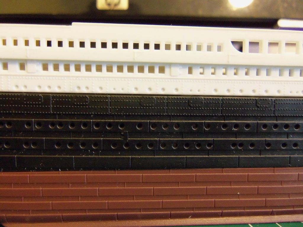

The hull and superstructure are molded in color but they will be getting painted anyway. There is pretty good detail on the hull with only a few "inaccuracies". Overall I'm actually pretty impressed with the kit when compared to the Minicraft 1/350 kit. And I do like the fact that you can build it as a waterline, which is what I plan on doing. I've already got a wood deck kit coming, along with several p.e. sets. I'm going to try and rigg it with ez-line fine. We'll see how that goes..lol.

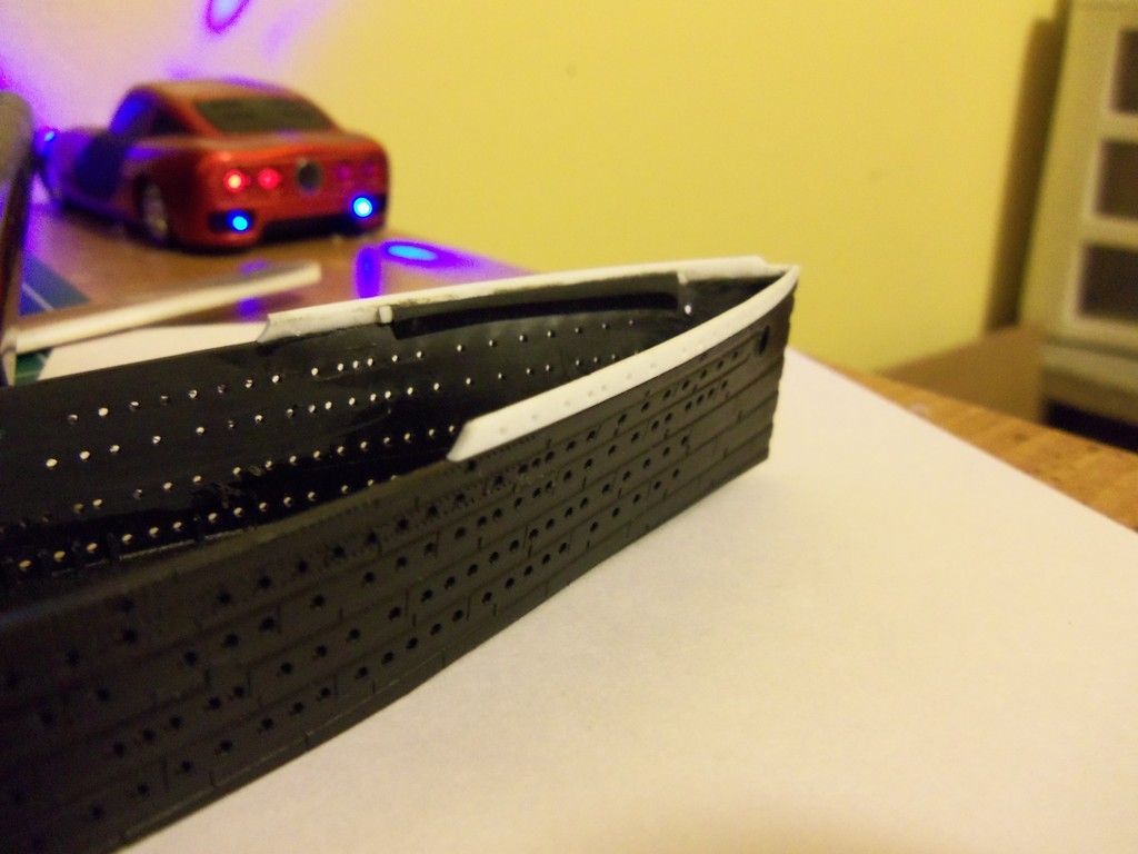

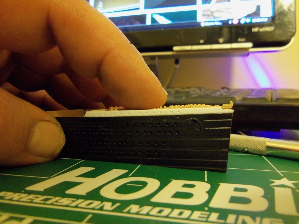

So... I started work on the big T tonight! (please forgive my descriptions and lack of progress photos, I promise I'll do better next time)

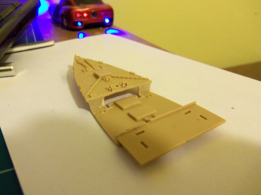

Started by dry fitting some of the decks, mainly the forecastle deck. Big fitment issue here. After cutting the molded in railing I noticed that the sides that the deck sit on were basically about two times too thick for the deck to sit at the correct height. I went ahead and glued the side pieces onto the lower hull for added strength as they are a bit flimsp by themselves. Went back and forth between sanding out the inside and fitting the deck until I was satisfied with how it sat.
There's still going to be a little fiddling with it and definitely some filler there at the peak of the bow, but it is much better than it was. I was almost like they designed it to sit above the molded in railing.
I then started taking off railing and stairs in prep for the p.e. Noticed that they didn't have the open area under the deck so I went ahead and opened that up as well. I will build the under structure that is supposed to be there out of some scrap.

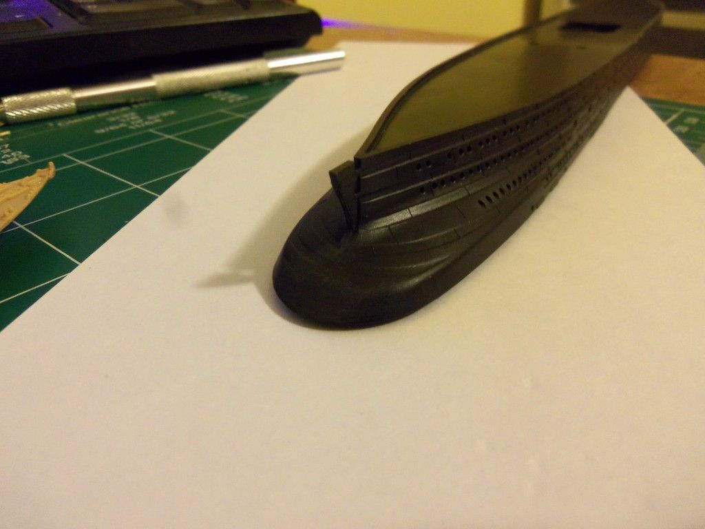

Went ahead and sanded the only seam line on the hull I could find which was at the stern.

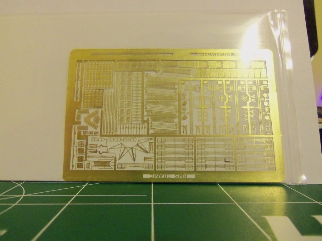

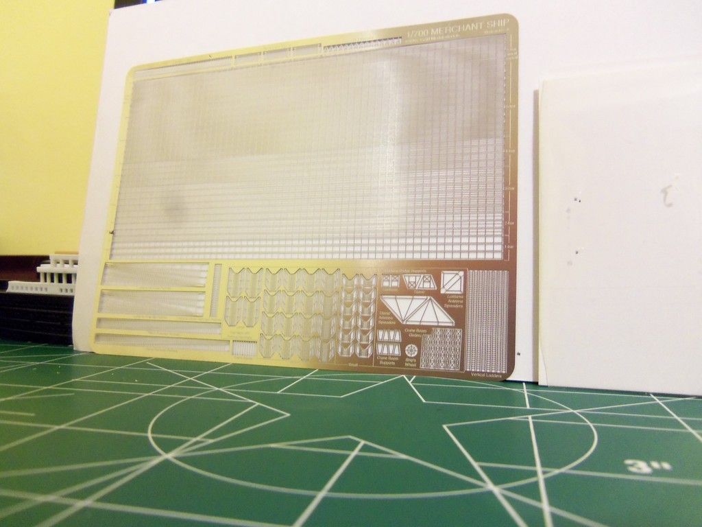

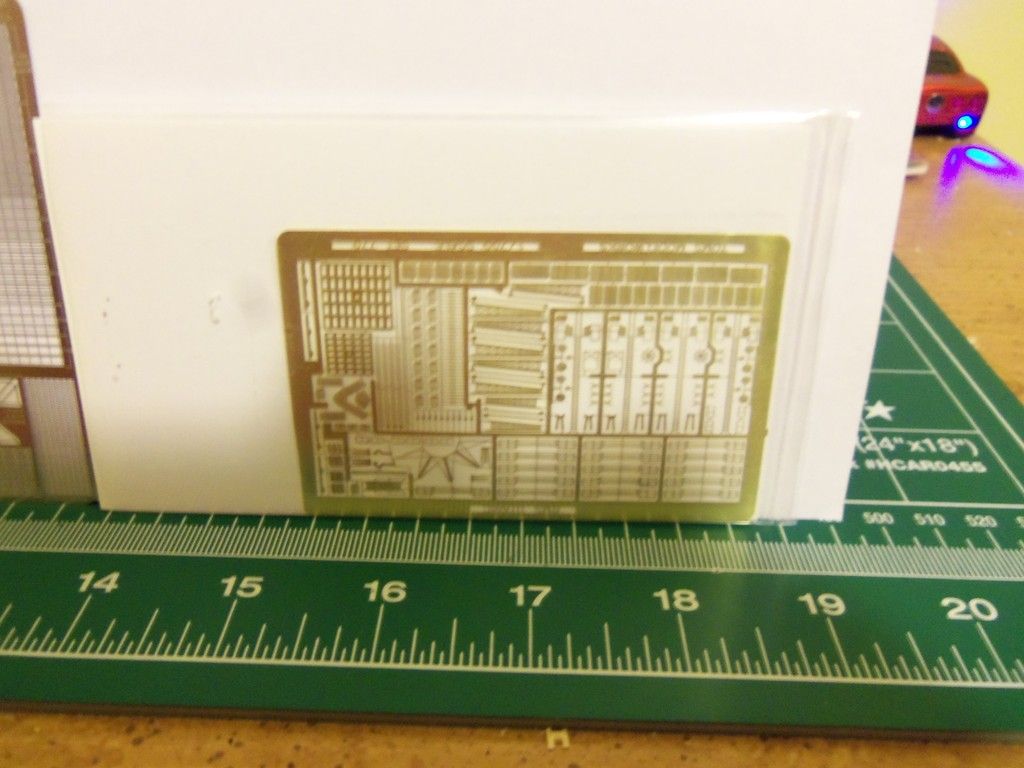

My p.e. arrived today! Here's some pics of that and it'll give you an idea of how small this stuff is. I definitely don't see me being able to use everything there, but it will definitely improve the look of the finished model..

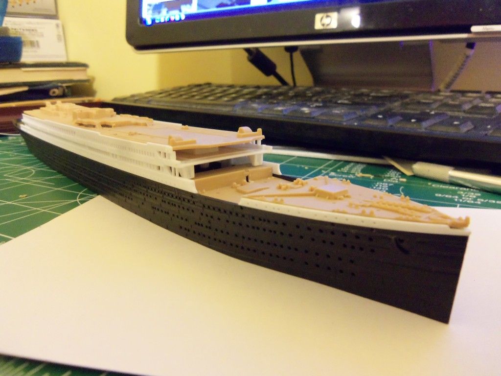

And here's a shot of the model with some of the decks mocked up....

I'd say that work you're putting into the fit will pay off for you. Smart to deal what that now rather than later with a ton of putty.
PE looks nice; like you say don't stress over using every.single.part. Just use what you want. Nice.

Nice work on getting the decks to fit on this one!! Good news on the PE showing up too...keep it coming!!!
