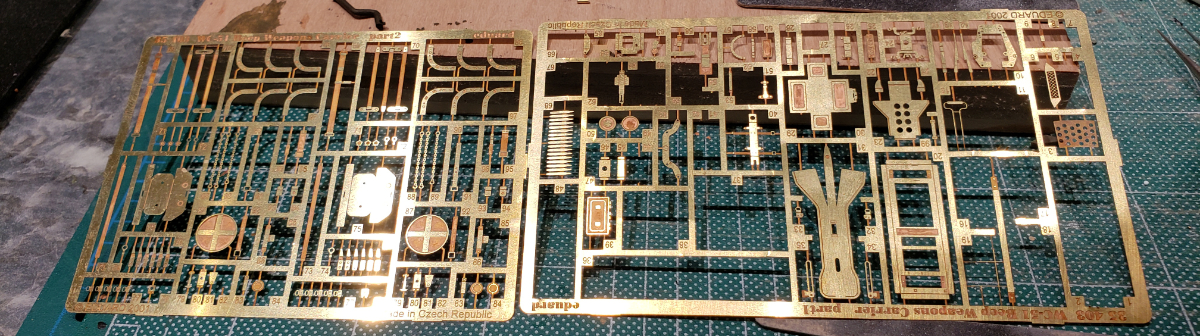

The kit: SKYBOW, in a plastic bag! not even a box... and some shiny bits from Eduard.
figures courtesy of: Verlinden and Alpine (after the rough characters I'm used to building, they were a dream!)

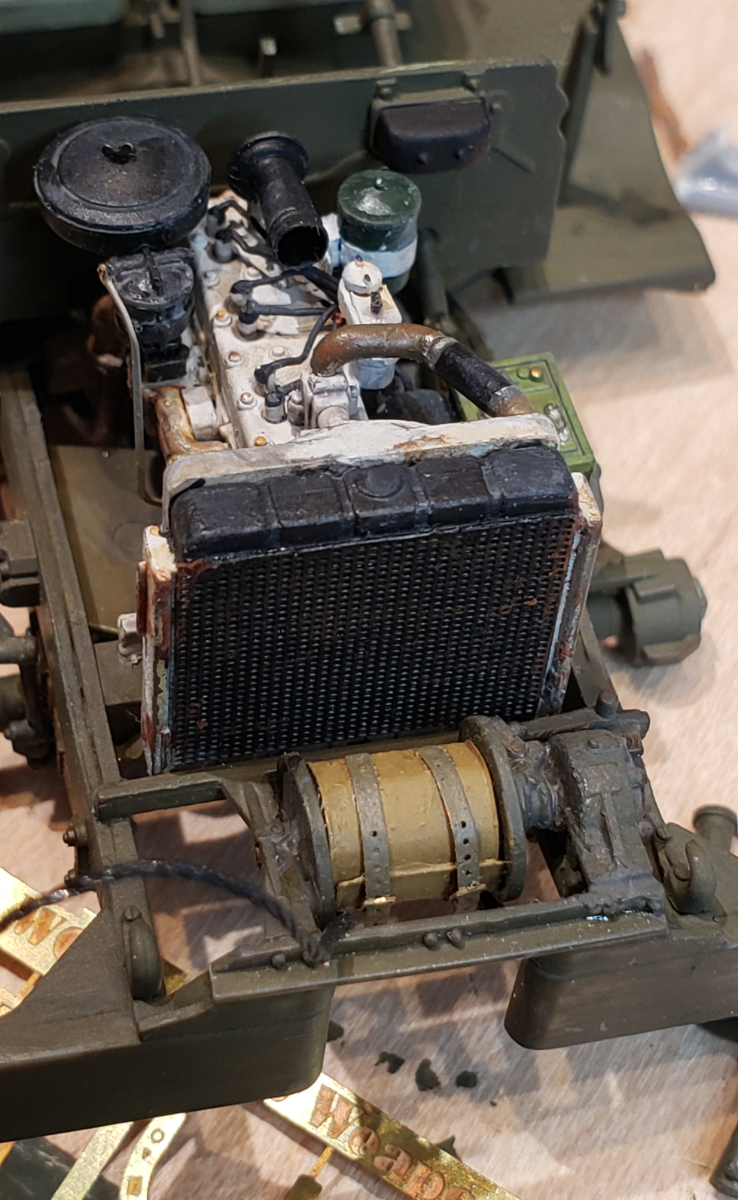

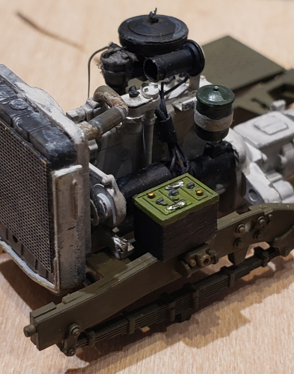

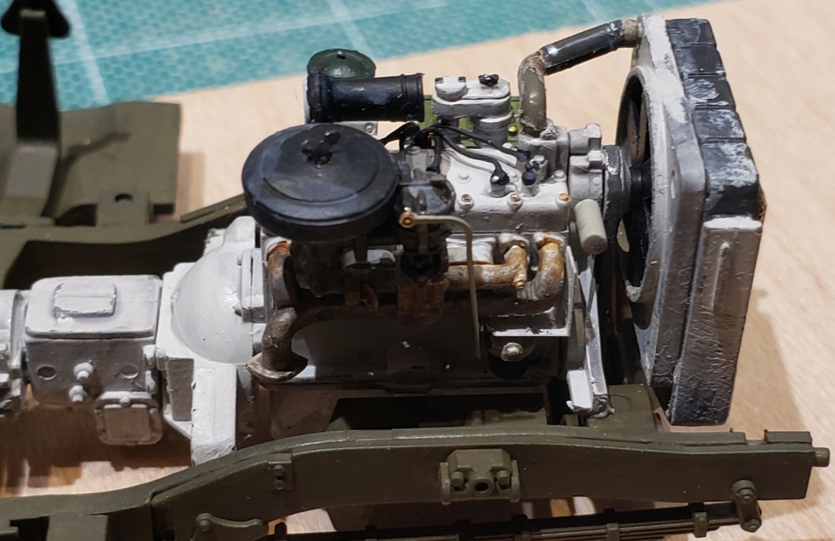

The usual fussing with engine parts, which usually involves tracking down photos, usually restorations, for a better idea of colours, wires and hoses.
for me, it has become more an exercise to become familiar with the engine, after all, it is the heart of the vehicle. Factual and technical accuracy is less important to me than the overall effect. Put enough in so that it seems plausible... I feel that the viewer's imagination will fill in the details!
I liked that the PE actually had radiator updates for both sides.
I get a rush out of just adding a butterfly nut to the air filter!
I once found a squirrel treasure mega muffin jammed onto the air filter of my '72 meteor! Don't know if he just wanted to reheat it, but I drove off before he could eat it!

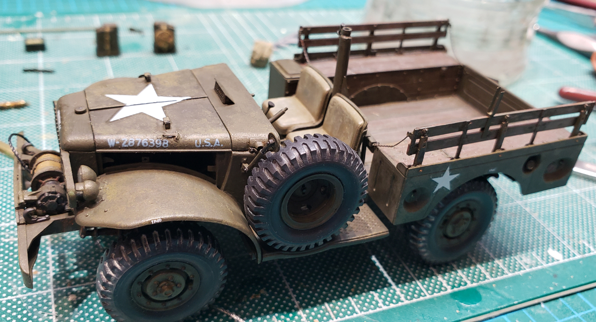

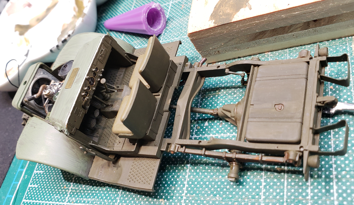

The frame gave me some grief. I posted elsewhere about it, but I noticed it had developed a torsional twist which meant that the tires would probably not all touch the ground.
In the end, I used my little Dewalt clamps to secure the frame, weighted to untwist the frame when I dipped it into hot water. It helped enough, though I could have used hotter water I suppose, just not brave enough to push it!
it is distressing to discover something like this at this stage, but thankfully still early enough to try and fix it

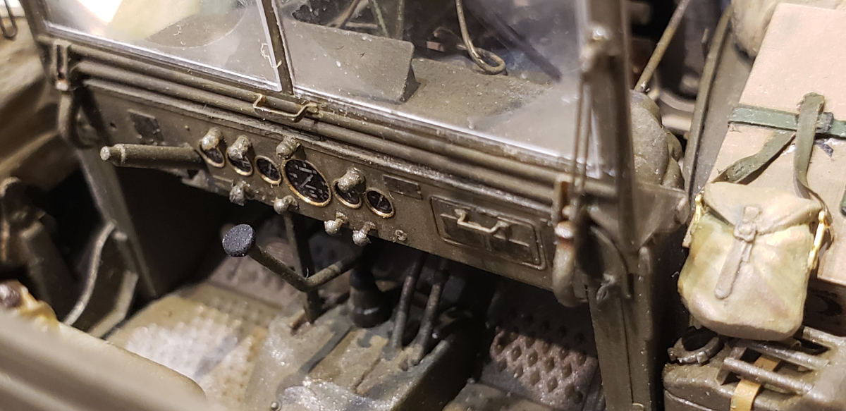

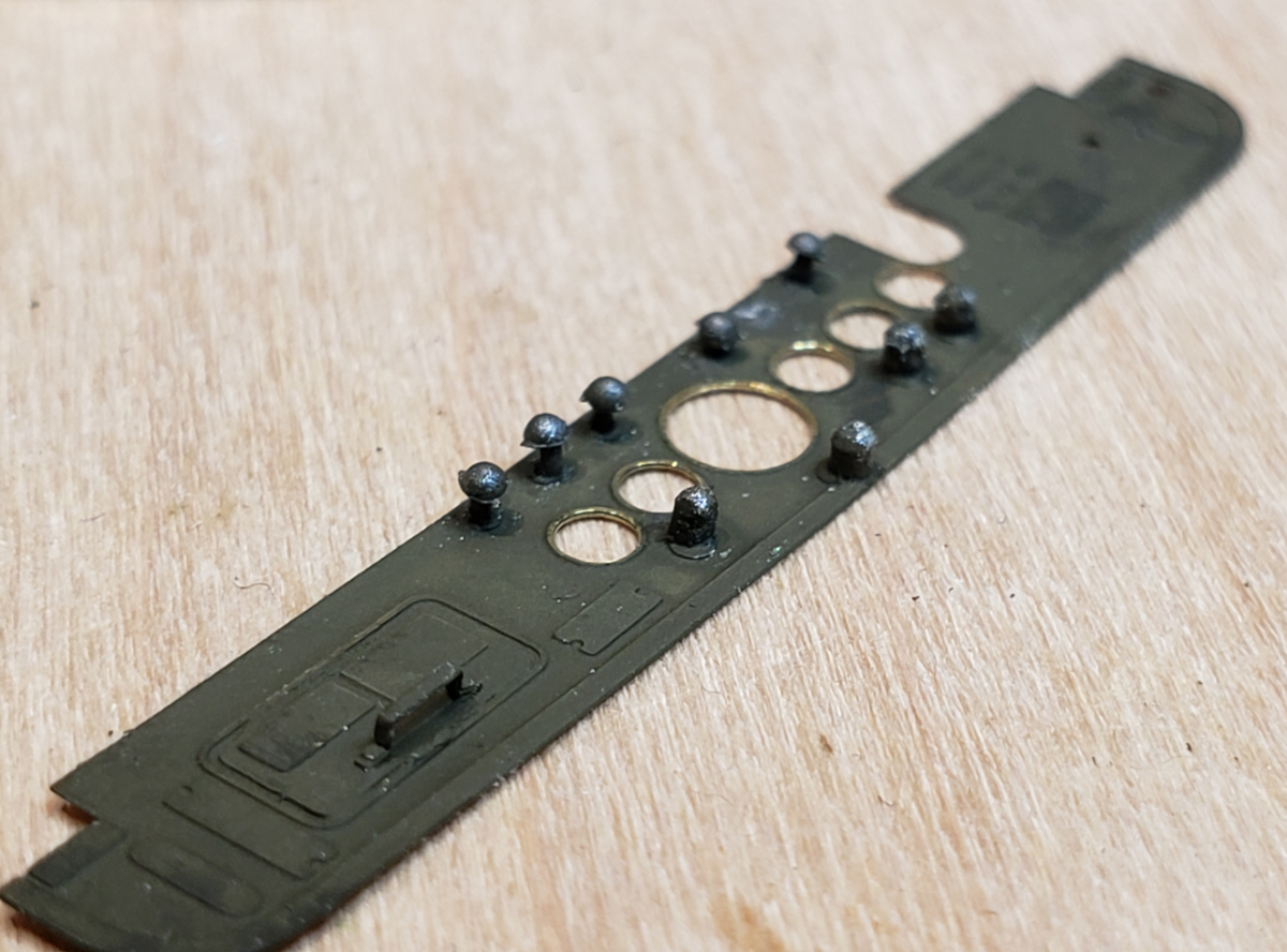

no, these aren't mini mushrooms, they are my attempt at giving a little more oomph to the dials and gauges!
at this magnification, somewhat ridiculous, but as evidenced in the photo above of the frame, it worked! Don't ask how many of those flew off to sprout in some corner of my room!
I also took the liberty of gently scraping the paint away from the rims of the gauges... not authentic, but does provide a nice effect and contrast once the dials film was added from behind
I was starting to think I might just pull it off!
at this point, I hadn't decided to add a radio and antenna, so the hood (bonnet) ID is missing a letter ; (

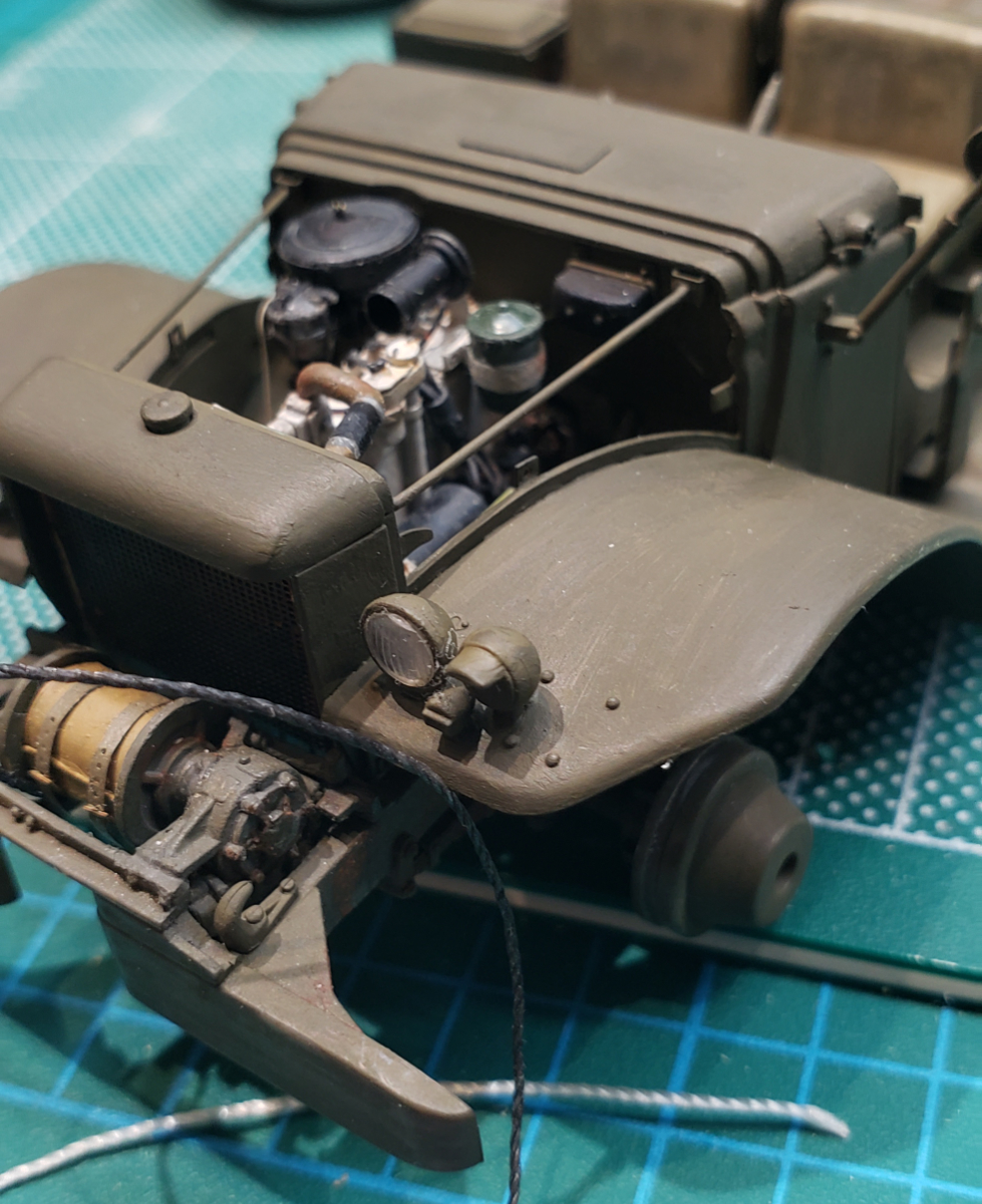

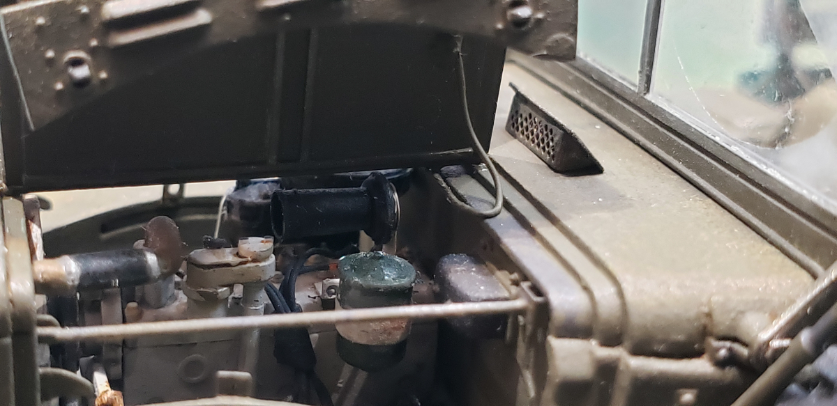

I wanted to expose the engine, so back to reference photos to see how it might be done... I think my approximation worked out Okay.

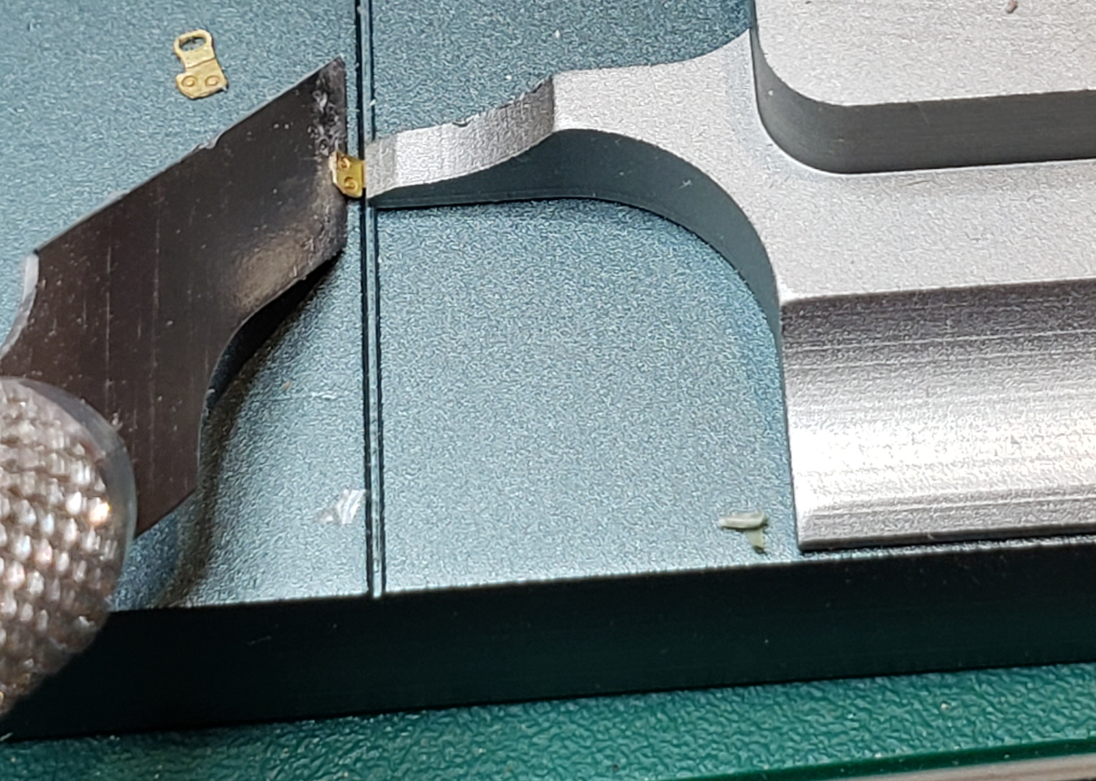

I had been using a knife and pliers and tweezers to bend PE, but on this one (knowing what other PE challenges awaited in the stash, I made the plunge and purchased a tool. Now it is my birthday every time I take it out!

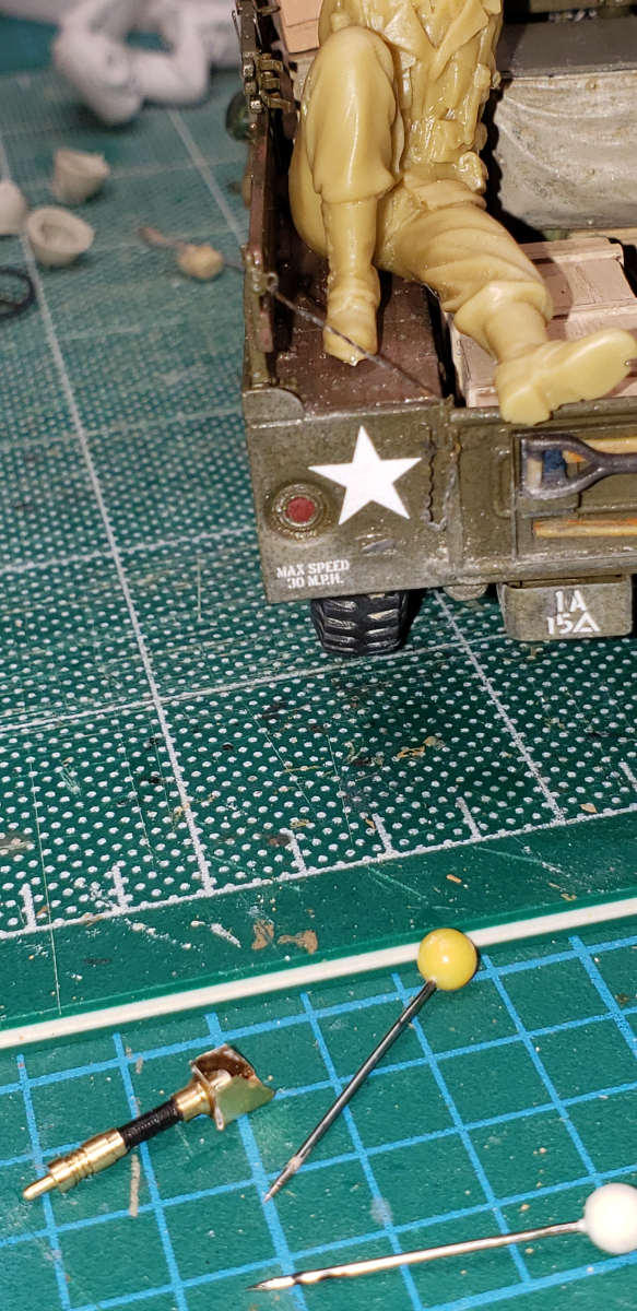

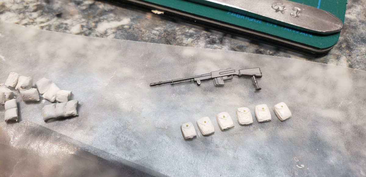

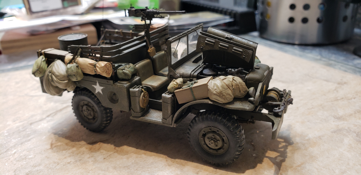

Time for stowage and radio!
the radio is covered, but I found a very nice mount for antenna

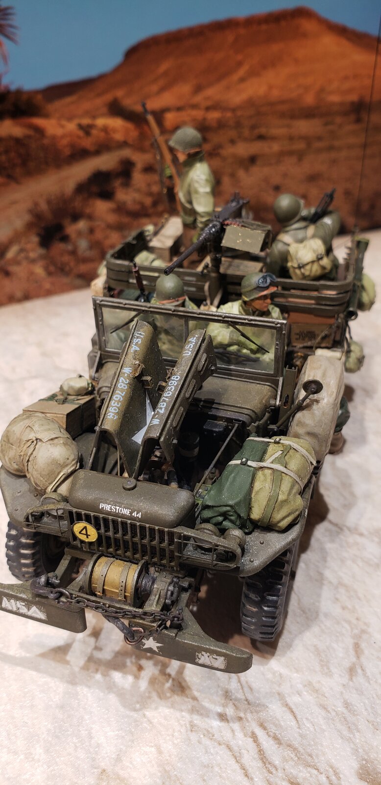

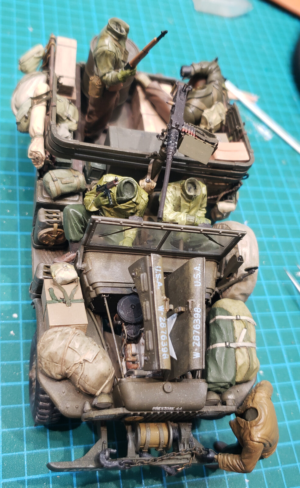

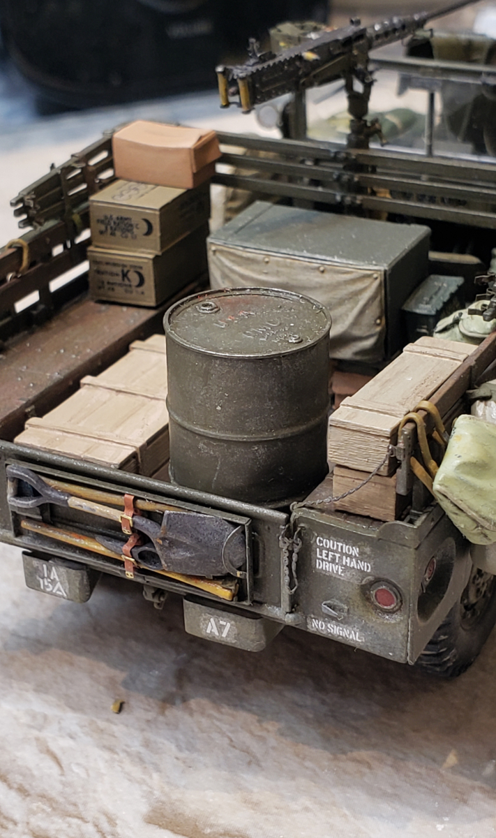

at this point I'm trying figures and stowage for placement, and have pretty well settled on the figures.
The reclining fellow, I thought should be loosely holding a BAR, so I'd need to provide him with the ammo pouches, sculpted in 2 part putty

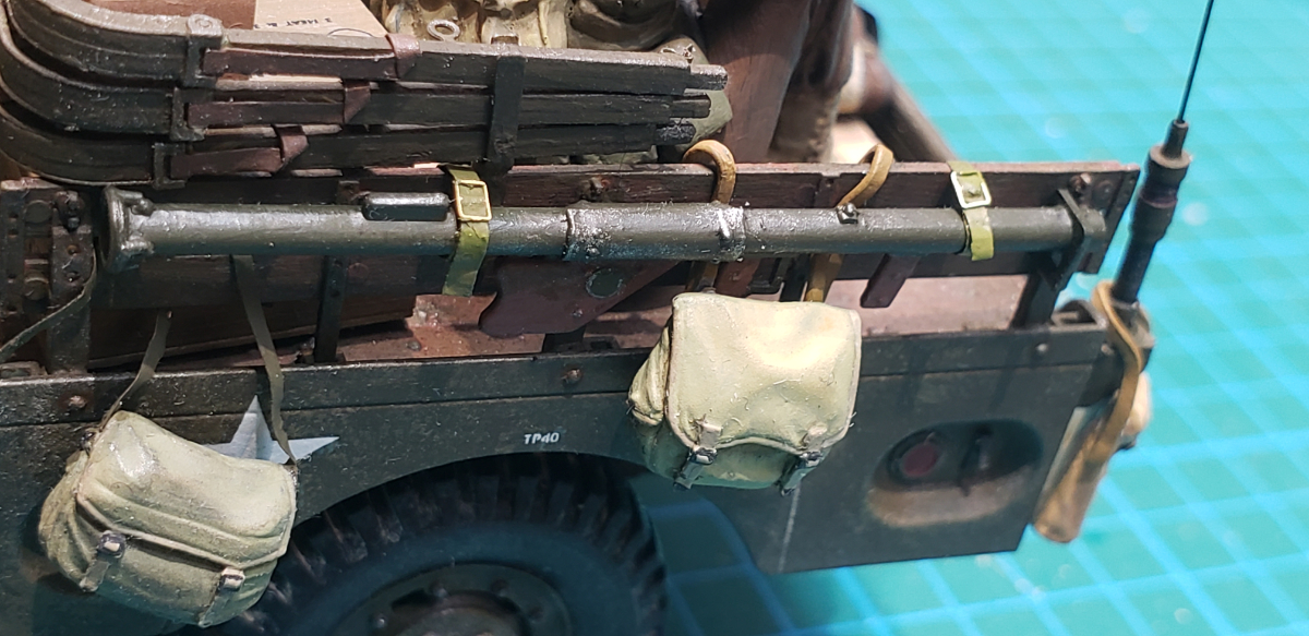

Hey, it's a weapons carrier right? how about that new fangled rocket tube?
another view of the dash
and a final test of figure placement. I opted to leave out the field mechanic because I couldn't get him close enough to the open engine compartment to be believable...

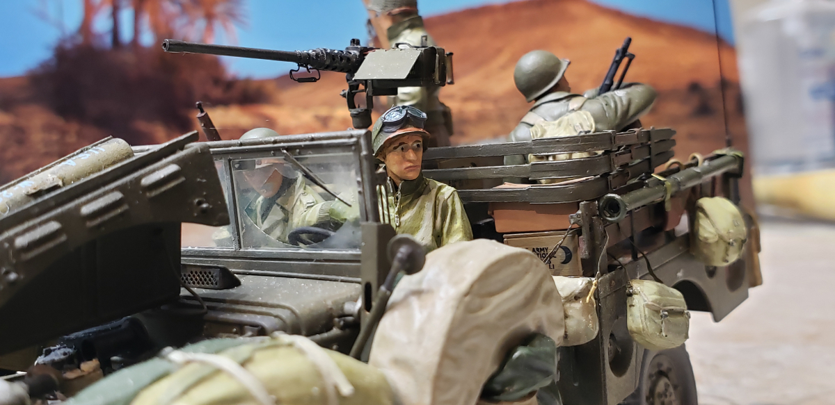

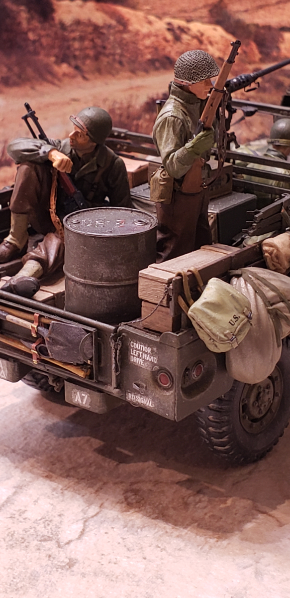

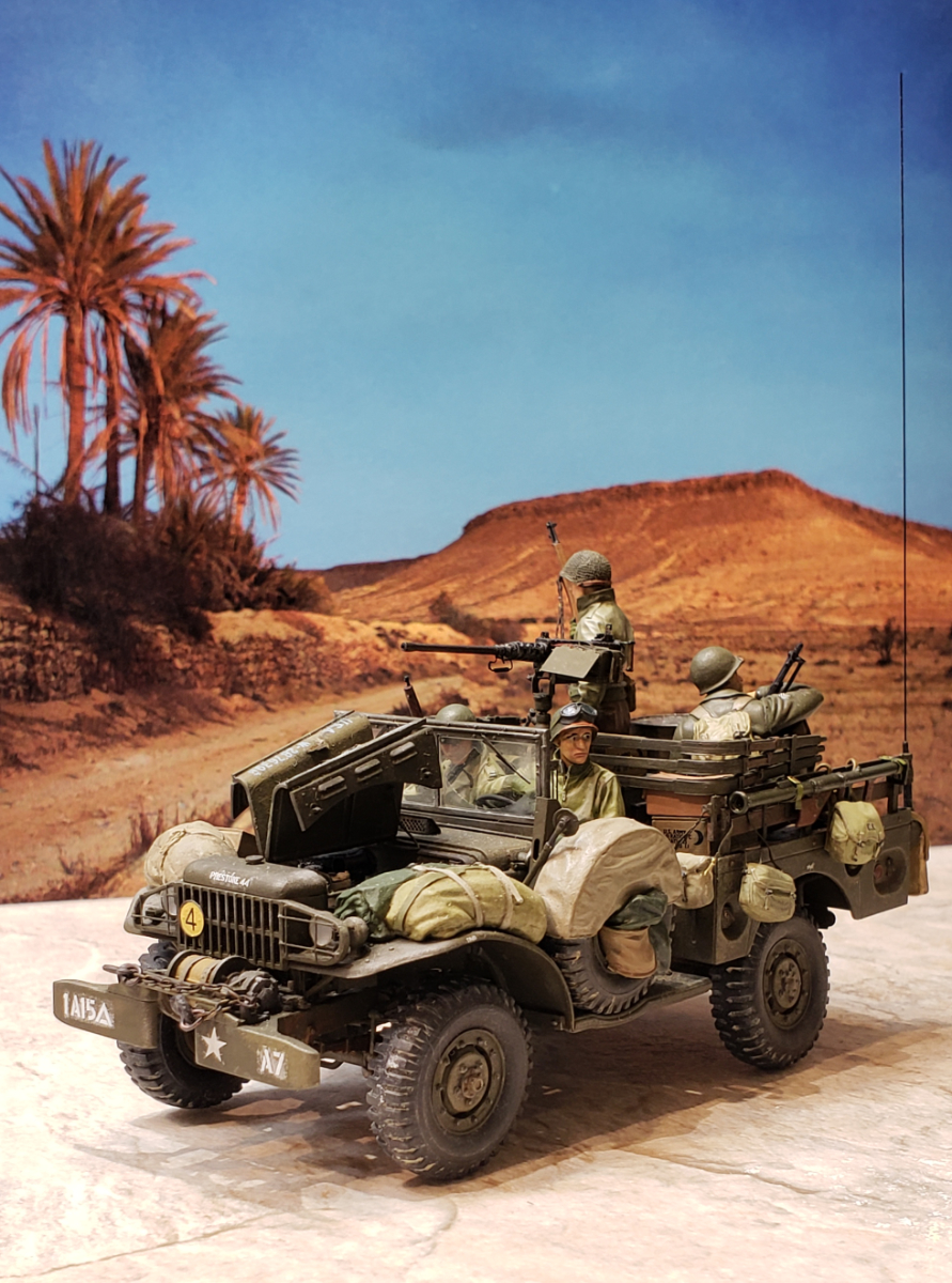

and it's done (except for that silvering that I have to fix) If you noticed a lot of dust in the picts, we were in the middle of renovations in our old 1876 home, mostly trim and painting at that stage, but the inevitable construction dust getting everywhere!
the driver seems to be saying: "I've got a bad feeling about this!"
that monster antenna was often tied down to the front of the vehicle. If I figure out how to do that, I just might! Best sleep a long time on it.

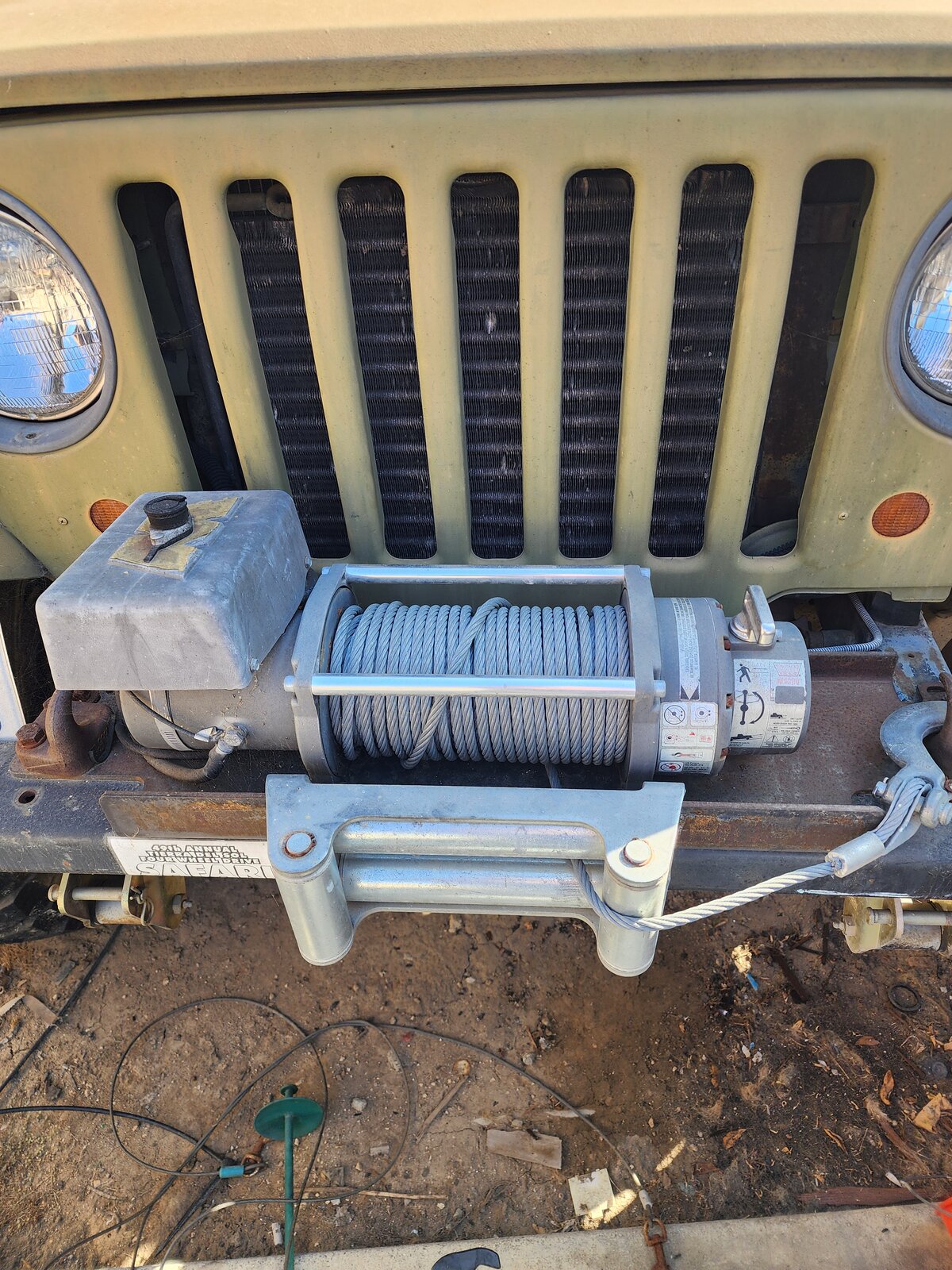

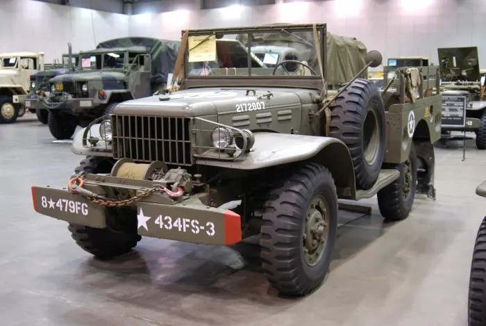

So, @BarleyBop , what is the history on the winch drum and cable cover on your model? I have not seen that before in WWII era vehicles.
I have made covers for my synthetic winch line on my real trucks and Jeeps, but have never seen it on WWII vehicles. I do it now for UV protection for the synthetic winch line. Why they did it then is a mystery to me.
Be well. Model on.
Eric
Hmmm, not knowing any better, it may be as simple as it was included in the aftermarket PE set... I'll get back to you on that one! I may have a photo reference somewhere as well:rolleyes:
In my defense though, don't you think it looks cool? Ha!

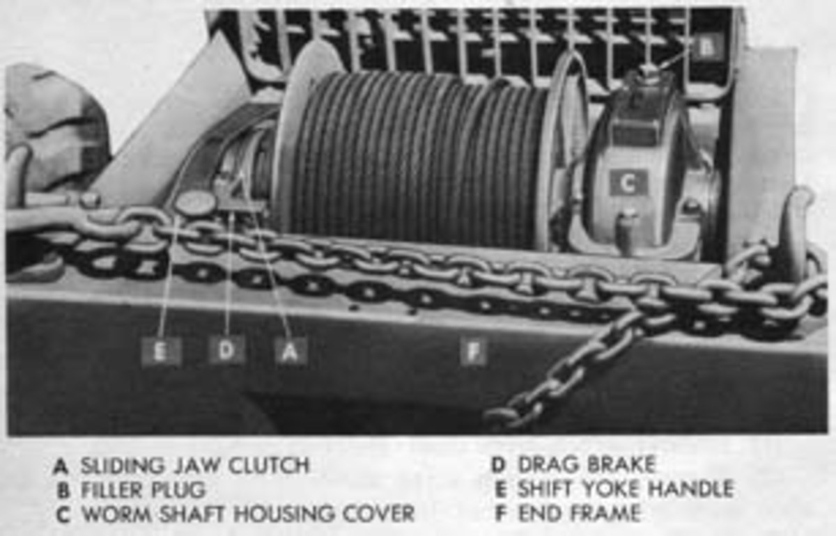

Hey @OldManModeler, so I'm back at my PC, checking out my folder of reference picts...
a Google Lens (reverse image lookup) did provide a few hits!
The first one which had great vehicle maintenance photos of the winch, which I gobbled up, not knowing the first thing about winches!
https://www.militarytrader.com/mv-101/maintaining-and-installing-mv-winches
... and they had seconded your observation thusly:
"The military once advised pouring used engine oil on the wire rope to keep it from rusting, but then changed its mind because the oil rotted the fiber core. While some show vehicles have canvas winch covers, it's doubtful if many such items were actually used, or lasted very long during military service."

Oddly enough, my fave pict was also from Military Trader:
https://www.militarytrader.com/military-vehicles/buyers-guide-weapons-carrier
I had it as a .webp file, so have converted it to jpeg to post here
Finally, upon reviewing all this winch stuff, I realized I had mistakenly called it the WC51 when it should be WC52, precisely because of the extended front end to accommodate said winch!
