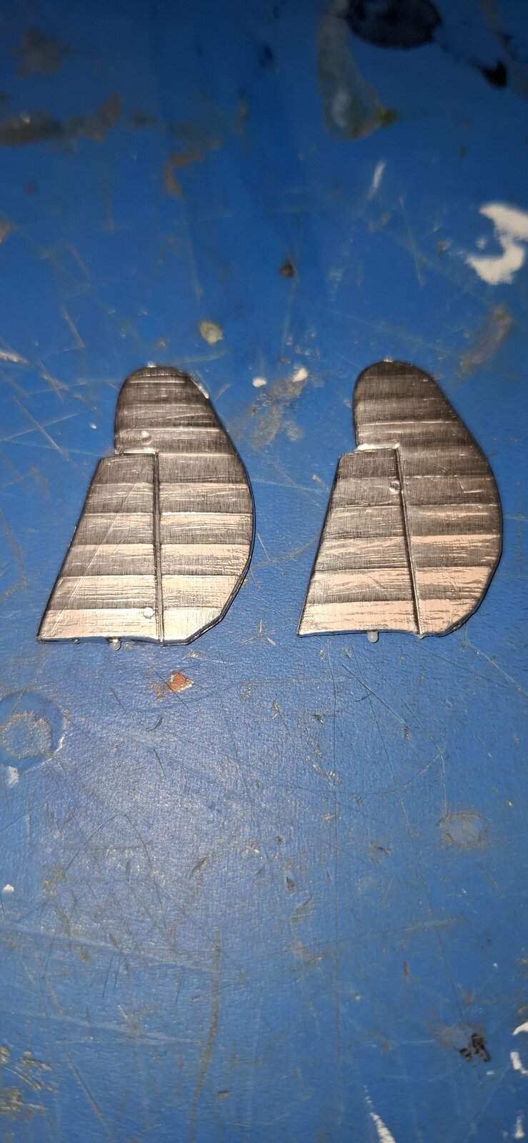

Hello everyone,
I have a question on how you guys clear coat painted Metal like Chrome oder so.
I have for example Chrome metal from green Stuff which is absolutely awesome but when I try to clear coat the model after Assembly the Chrome colors will not take the clear Coat paint it is like you Spray water on polished Metal creating bubbles.
How do you do that?
I use the chrome metal paint from your link.
Maybe it is i am using mostly water based clear coats.
Maybe i should try alcohol based like Tamiya?
Just came to my mind while we were chatting
I just checked all my clear coats are waterbased. Vallejo and Mig.
They pearl on a glossy surface especially on chrome paints since their surface is very smooth
Is it necessary to clear-coat the chrome paint at all?
