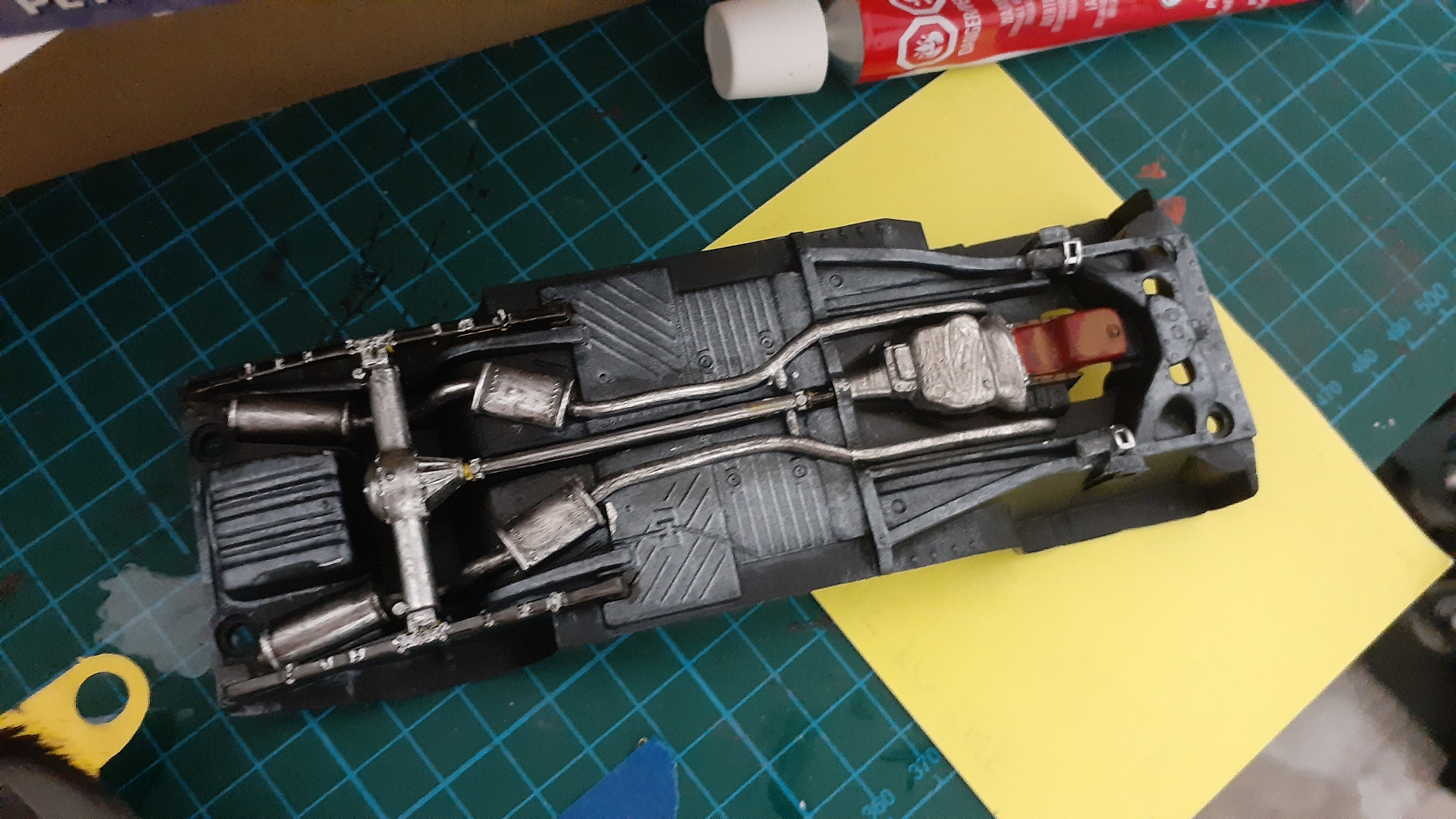

The finished chassis, graciously painted by my GF yesterday while I finished working on the vinyl Brundlefly kit.20210705_144200.jpg

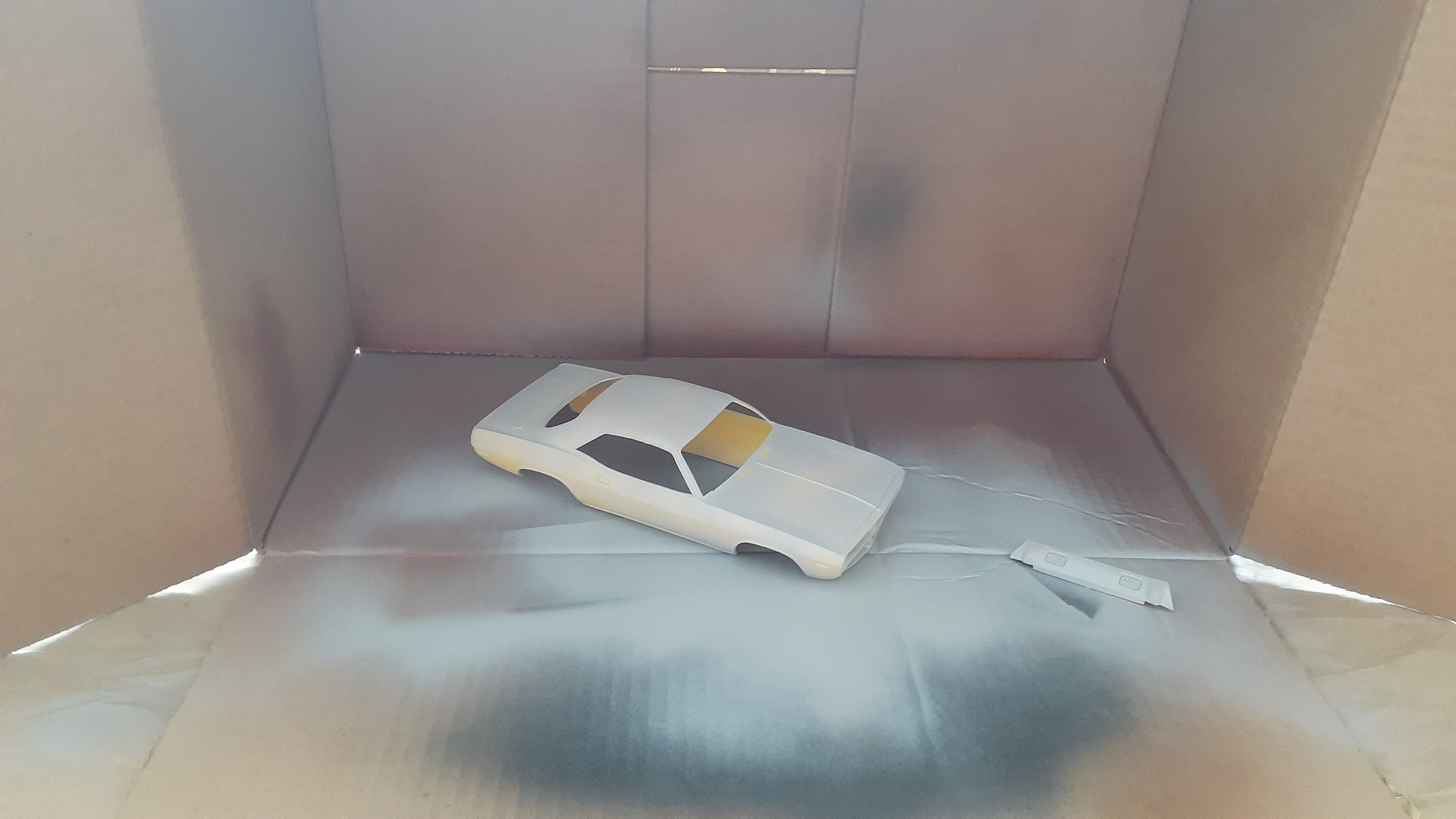

The body in process of priming. It was cast in yellow but I dunno if it'd look any good with just gloss slapped on bare plastic so decided to do it right.20210705_144130.jpg

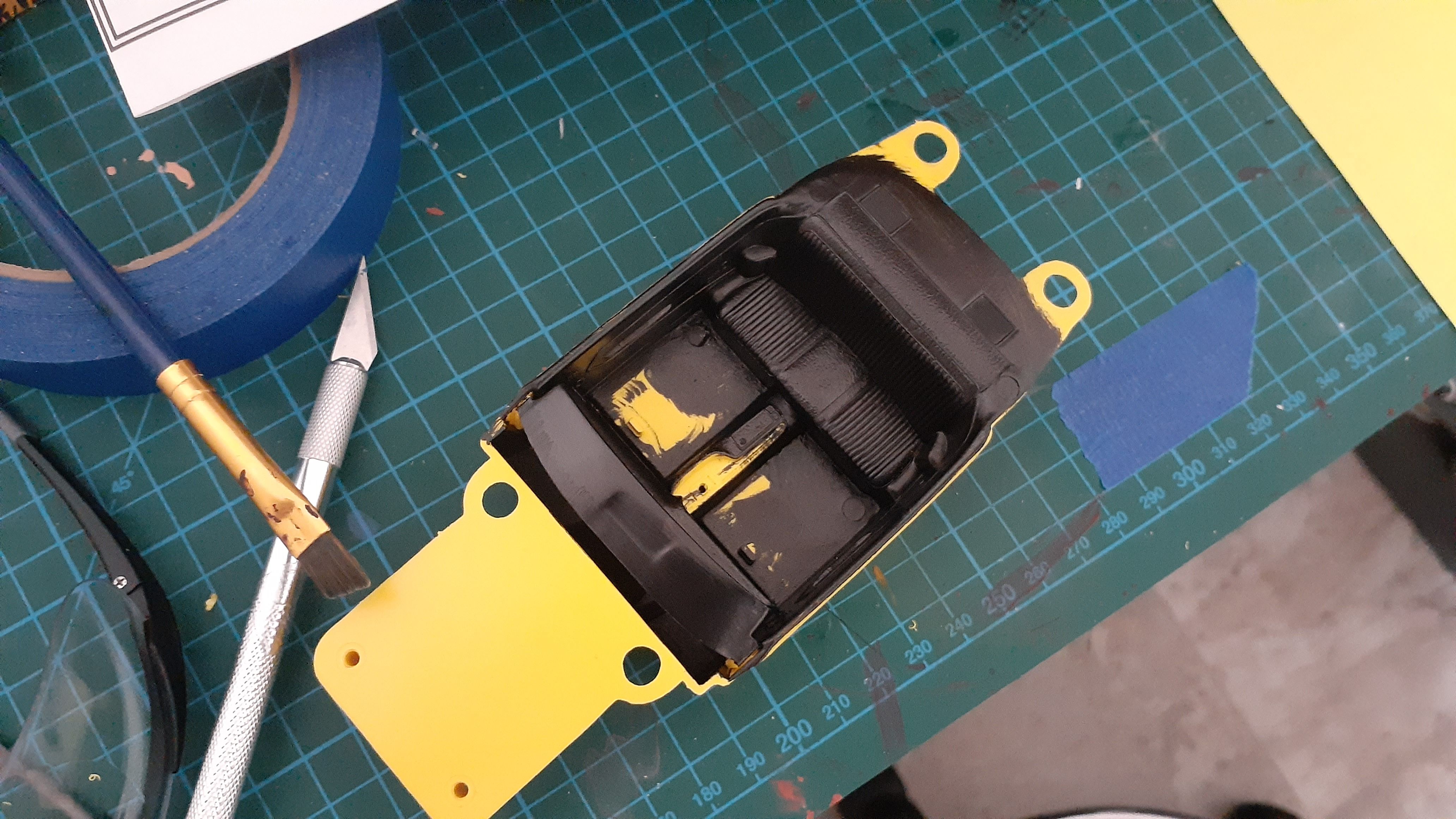

And the interior with base coat, which may just be final coat. The seats will go in after I detail paint.
I also have to scratchbuilt a gearshift since it was lost before getting to me. It won't look like the kit part, but hopefully will suffice.

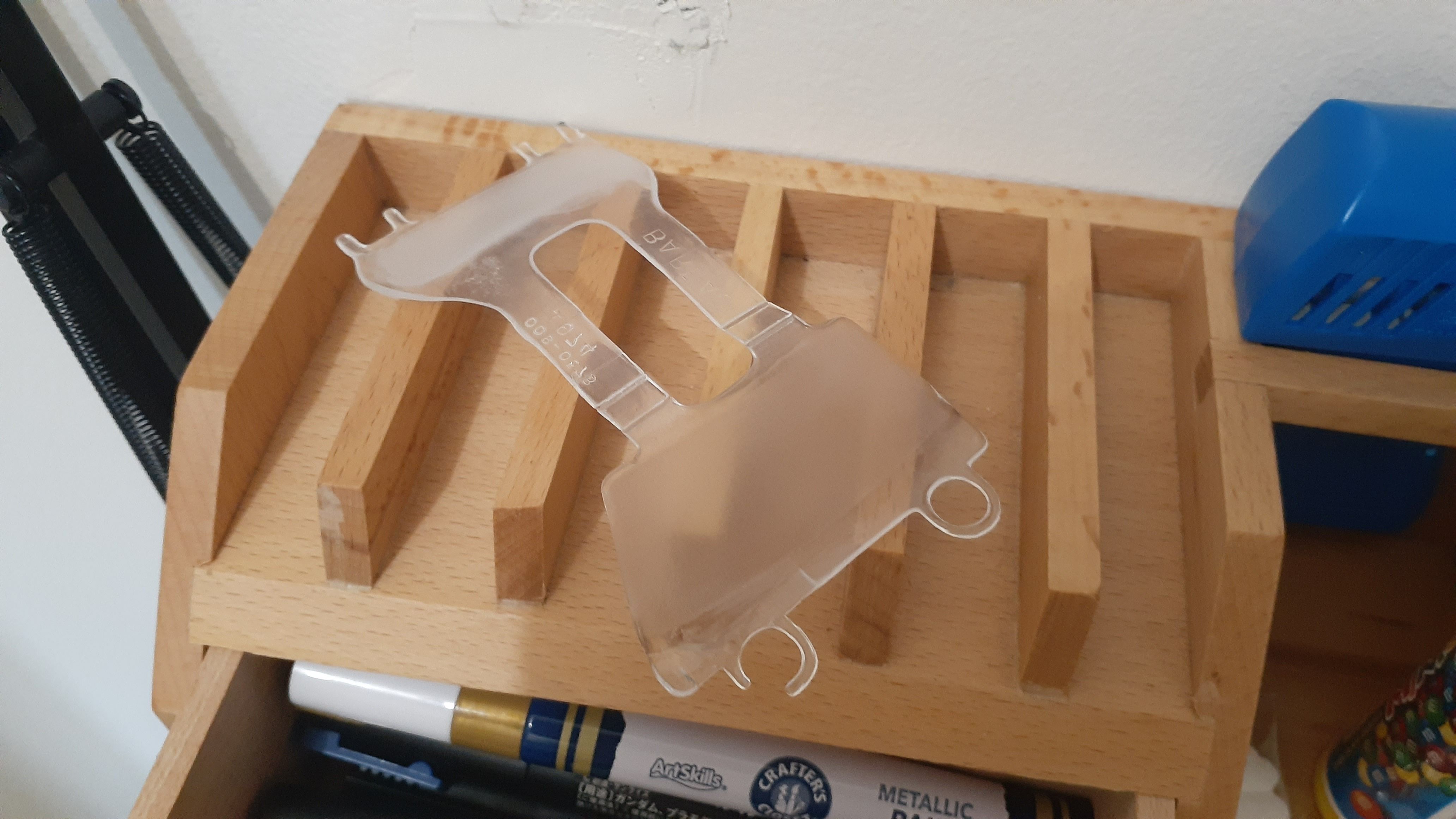

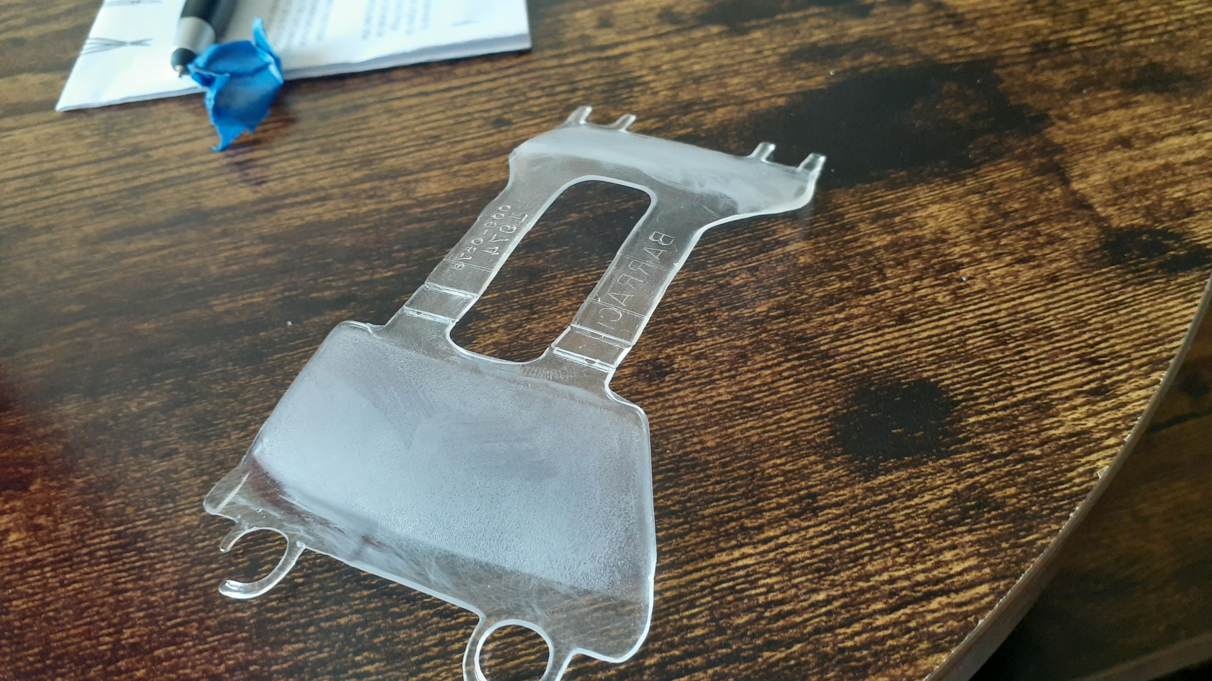

Well... I just screwed up. Put the car together last night, and noticed a few spots in the finish that needed fixing.I had a hard time getting it together, so I decided to just lightly sand the spots and recoat this morning. Now I have used clearcoat gloss over clear parts before with no issue... but in this case it frosted the windows. :(
Any way I can save this?
I think that's an acrylic resin --- try carefully removing it from the windows with a swab or something wetted with 91% isopropyl alcohol .
Probably --- they're usually around a 70% solution since that's ideal for anti-microbial purposes . 50 -70 % for that since you need a water component for that purpose .
It will just be less aggressive .
Yeah, so far its doing nothing. Would thinner work?
This is where its at now. Lightly sanding in a circular motion with 1200 paper, and polishing with a sanding stick that has a 2000-3000 grit side. I think if I had higher grits I could get this completely out.
Yes , I look up the MSDS then call Rustoleum to make sure .
It's an alkyd ( enamel ) so a paint stripper safe for plastic or the sanding that you're already into .
The Krylon , or one of the Krylons is a lacquer acrylic so the isopropyl would work -- but definitely not on an alkyd resin .
