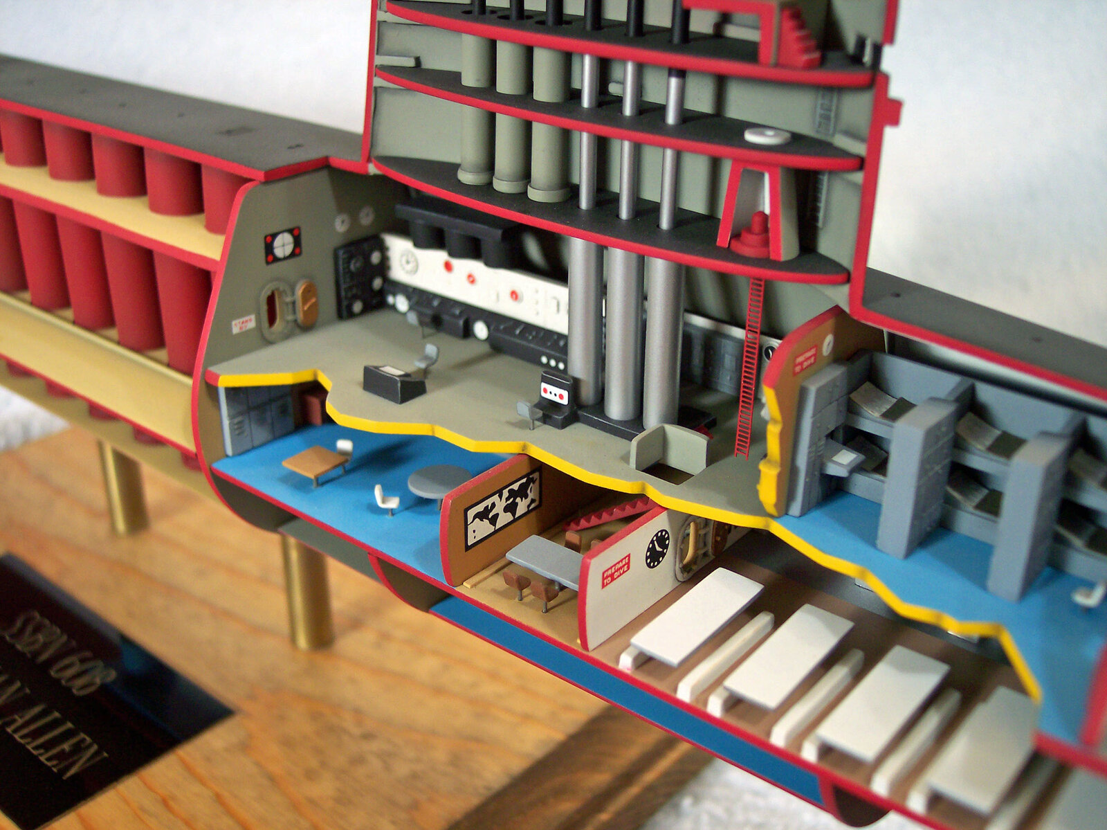

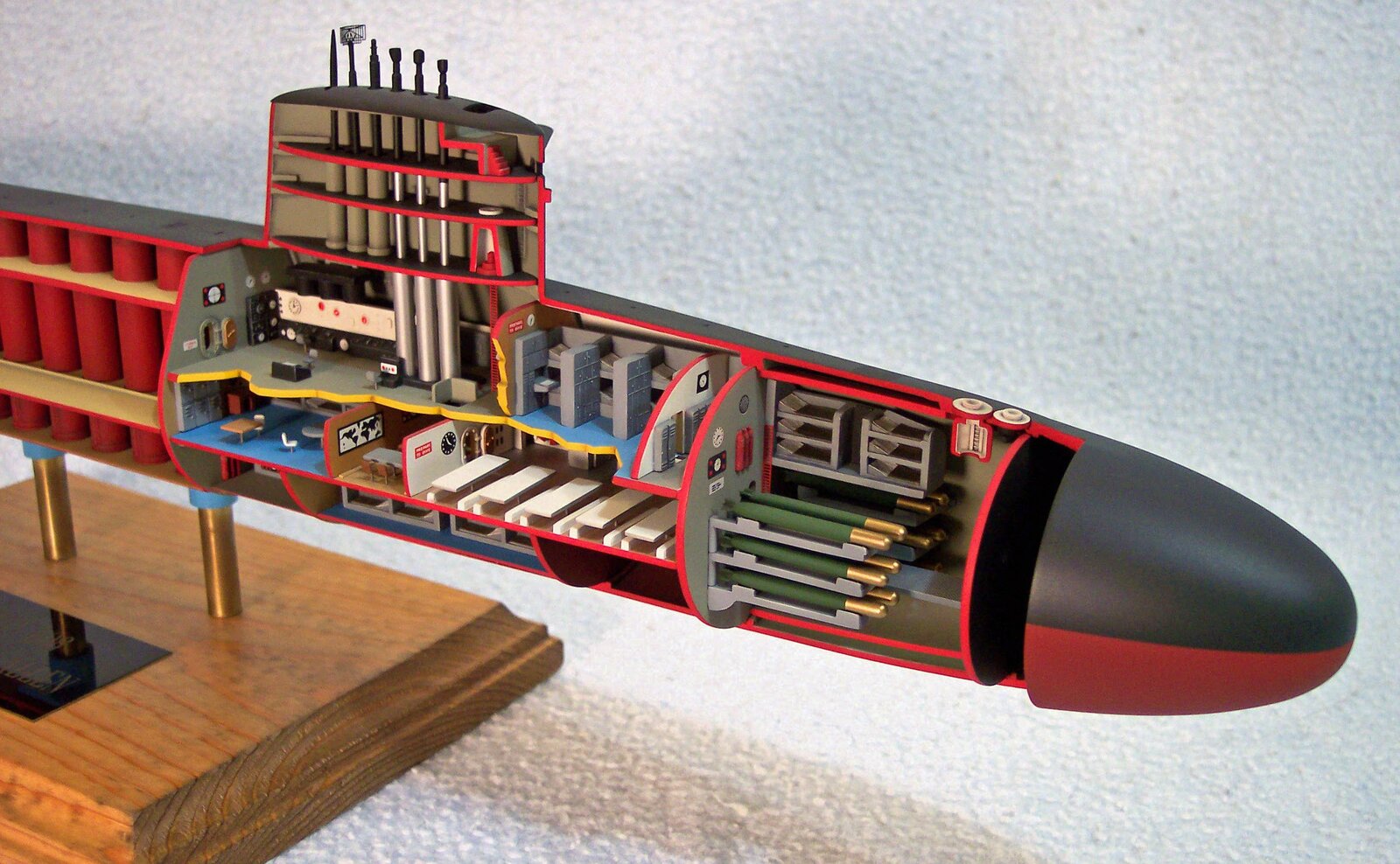

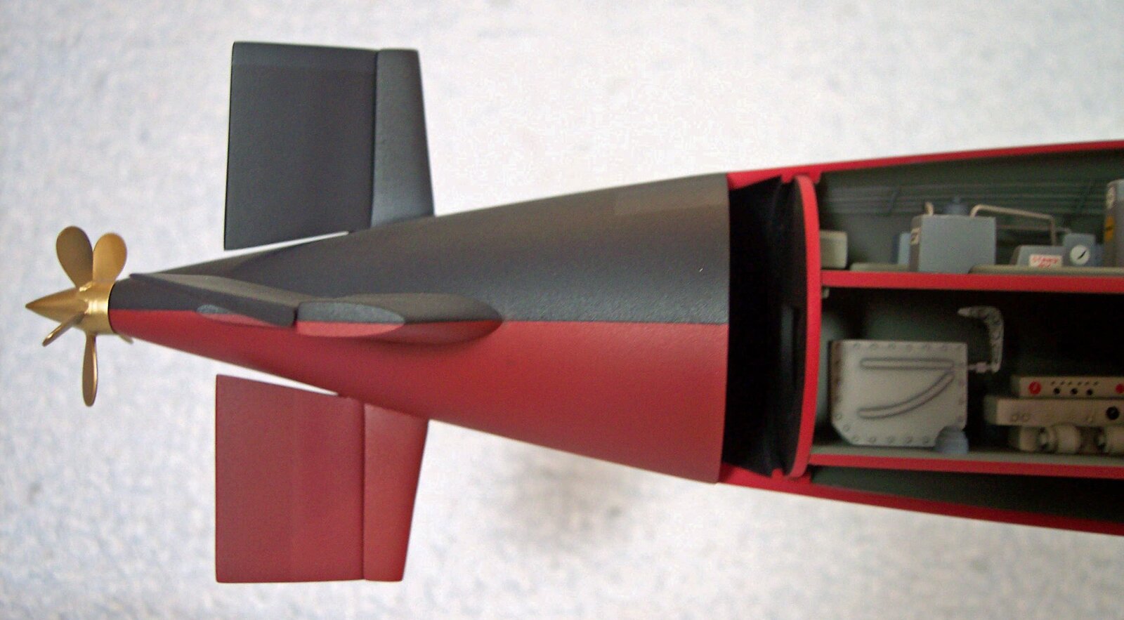

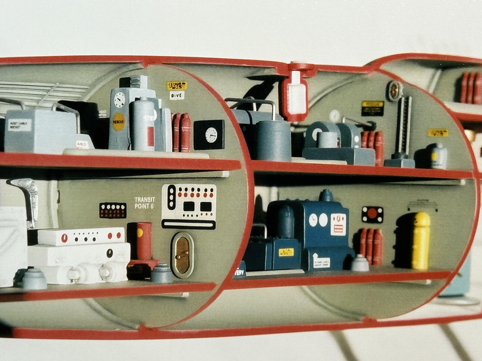

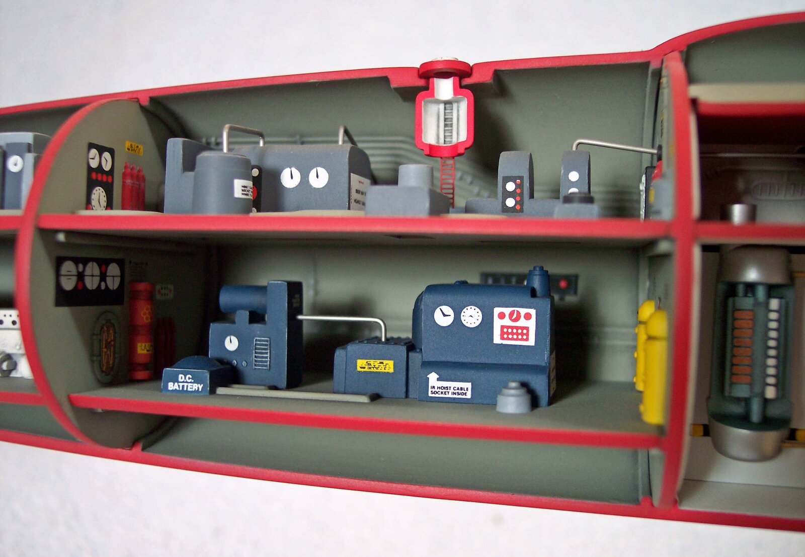

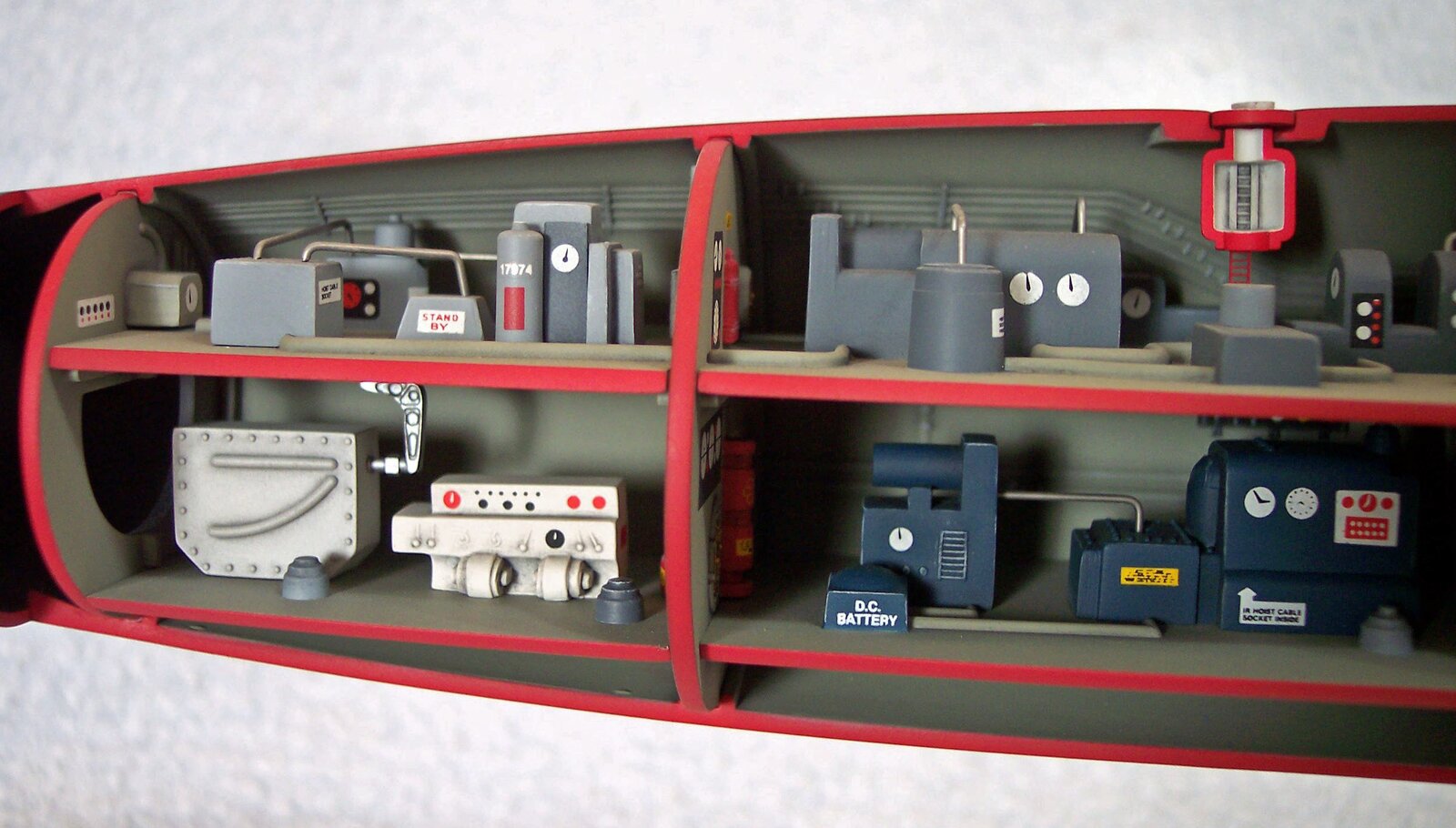

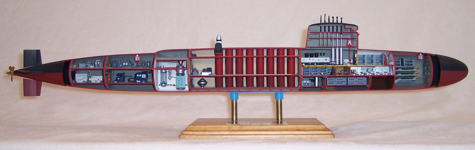

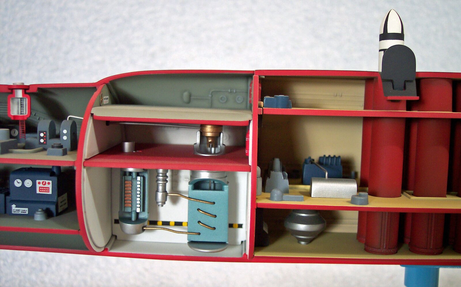

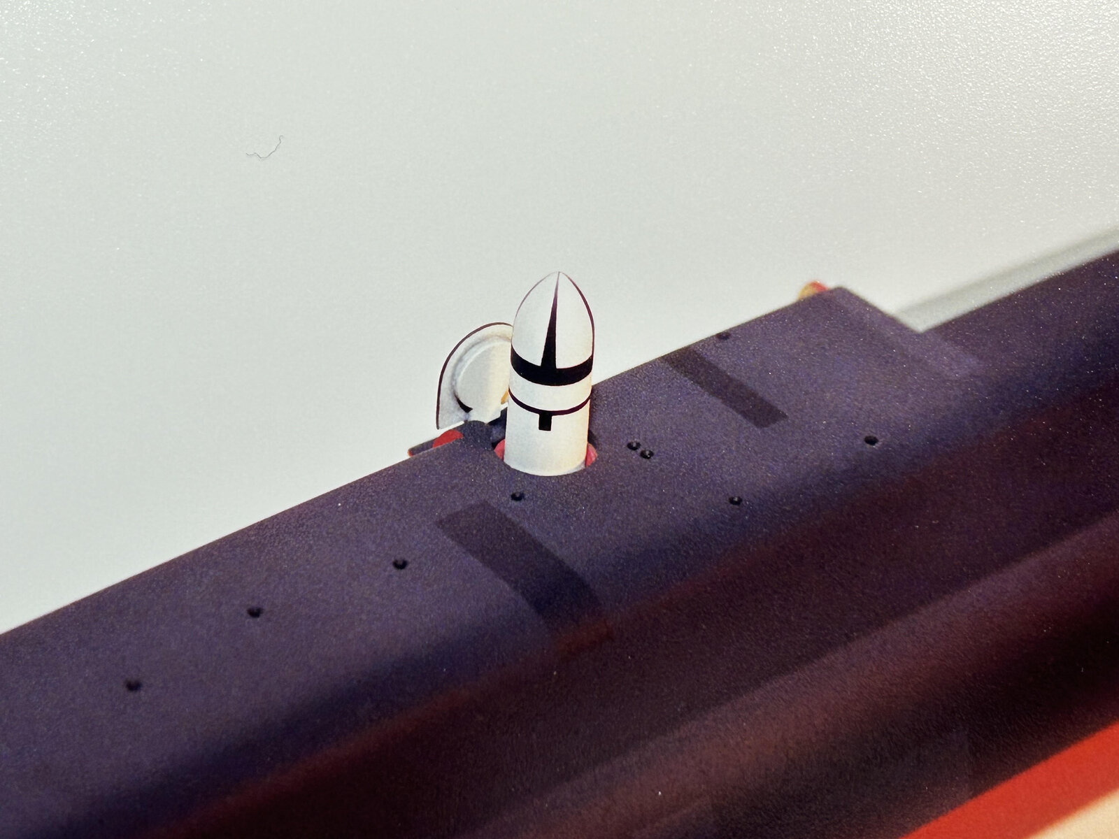

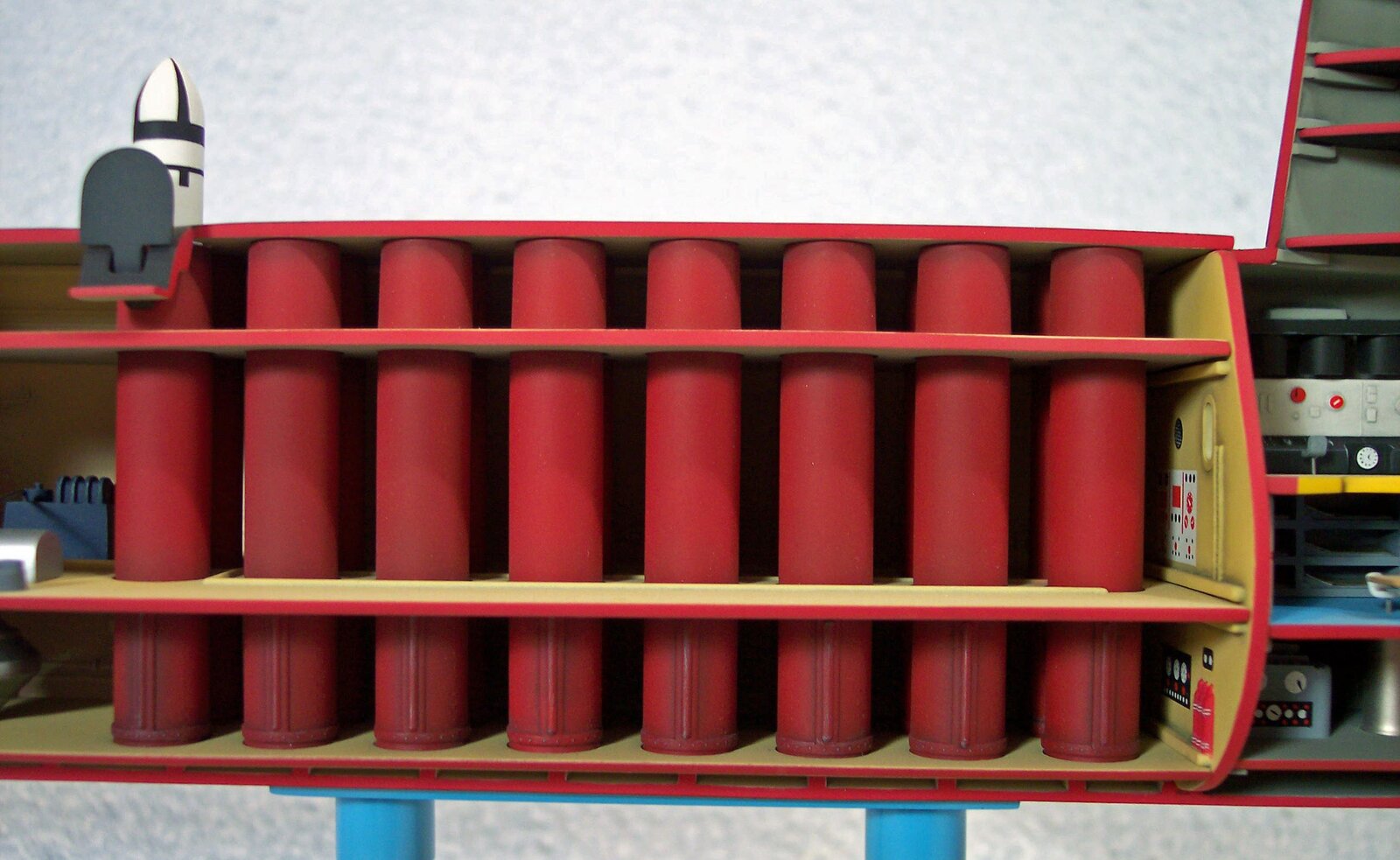

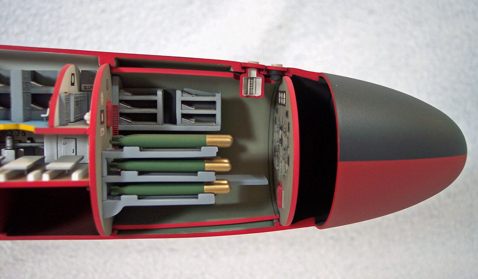

Fellow Modelers,

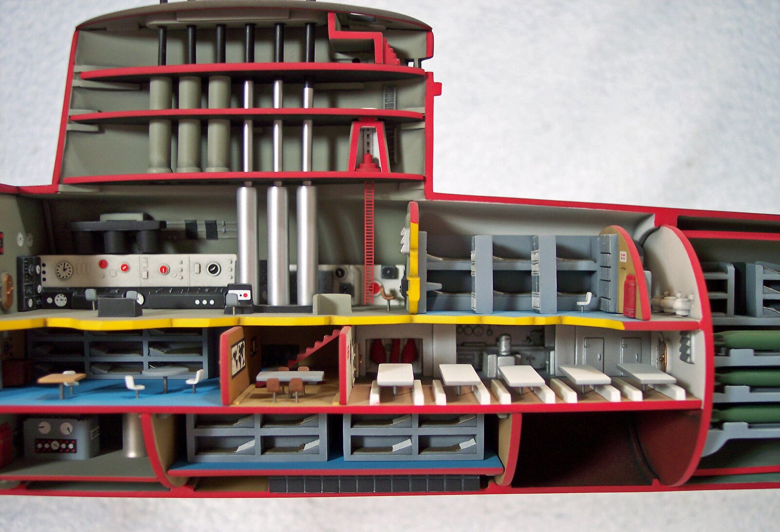

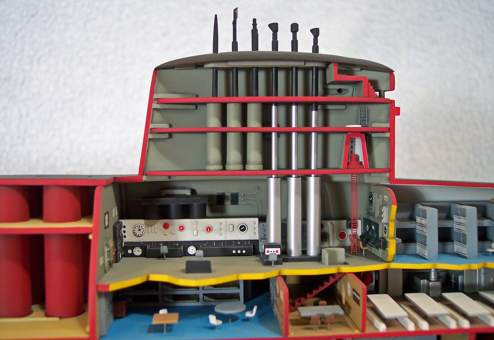

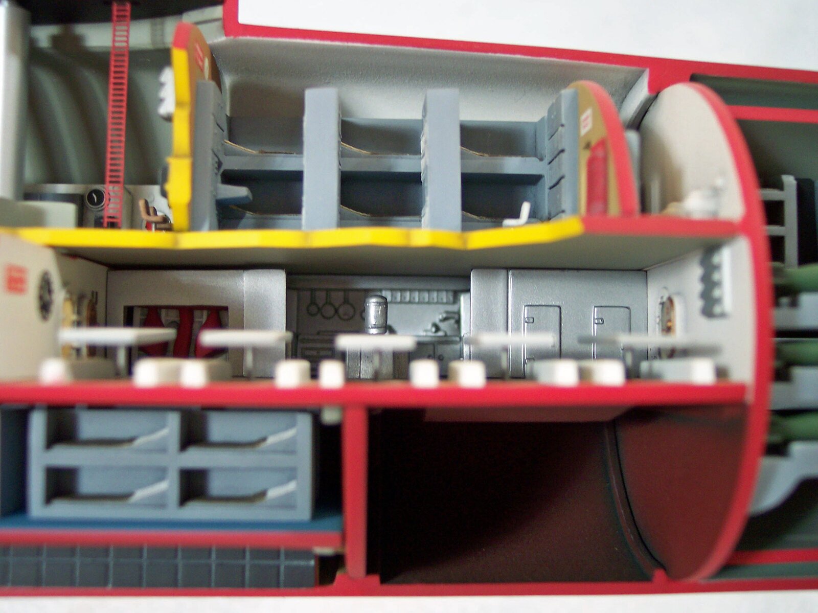

Below are photos of Renwal's 1/200 scale (25" length) U.S.S. Ethan Allen (SSBN608) U.S. Navy Ballistic Missile nuclear submarine. I built this model in 1995. It was always a dream of mine to build one of these very old kits into a nice display. Renwal issued this kit (and three nearly identical others-George Washington/Thomas Jefferson/Andrew Jackson) around 1962, and although tens of thousands have been sold over the decades there are very few finished builds posted on-line. Revell also issued a smaller 1/260 scale Ballistic Missile cutaway submarine kit around the same time, but I have always liked the Renwal model better. The fit on many of the kit parts is poor and some of the smaller parts are way out of scale. It is also highly inaccurate, as Renwal had to guess at what most of the interior looked like. I mean seriously, the Control Room is the size of a basketball court! However, to me the cool factor of this kit is a 10 out of 10. The cutaway presentation has always reminded me of educational displays you see in museums. Several of the modifications I made are listed below:

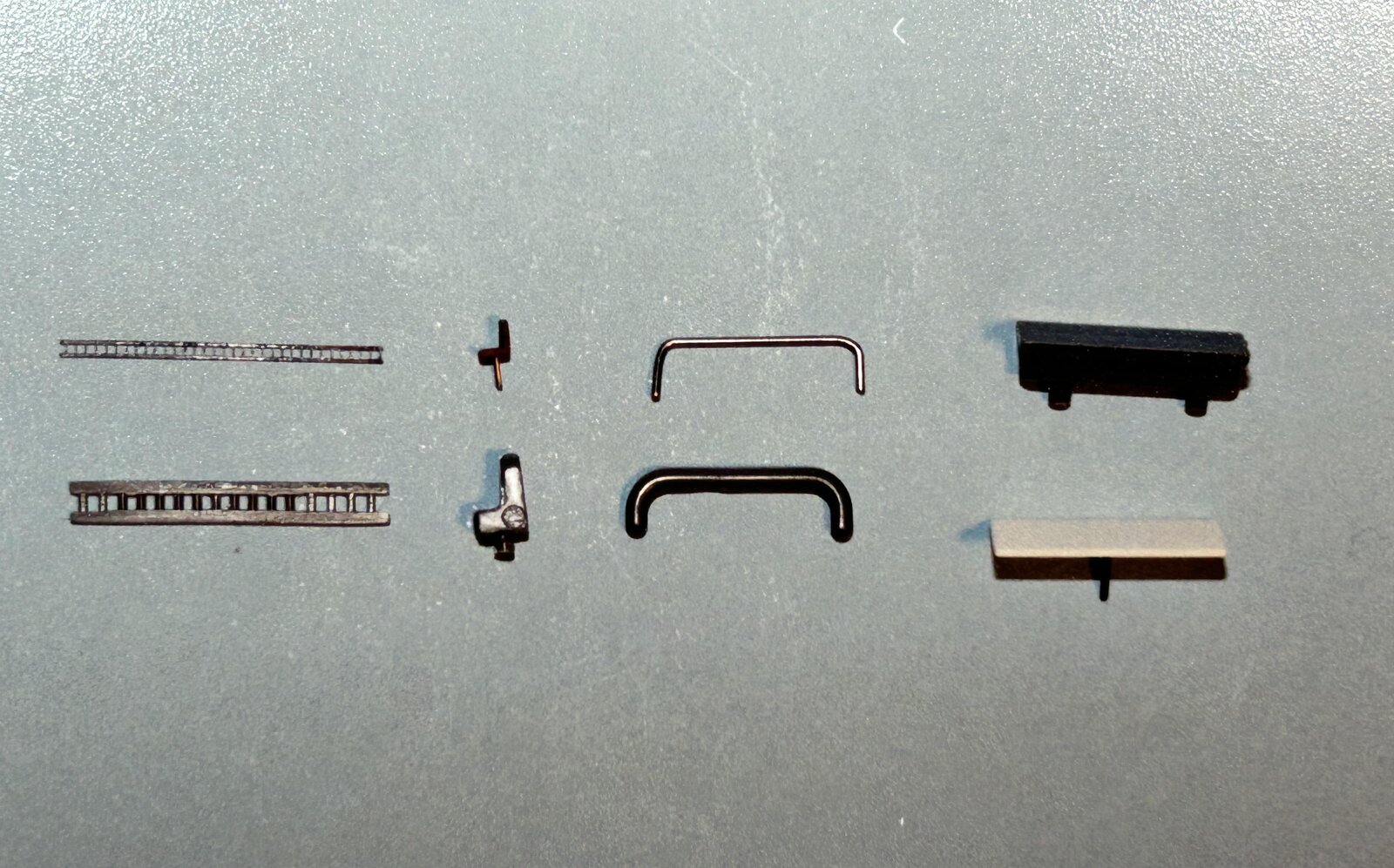

Plastic "piping" replaced with small diameter wire-
Cut out sections from the control room floor and bulkhead for a better view of the lower decks-
Scratch built chairs and tables-
Added photo-etched ladders/radar screen-
Ballistic Missile made from "Stuka" airplane bomb-
Many of the decals came from the Revell cutaway submarine kit-

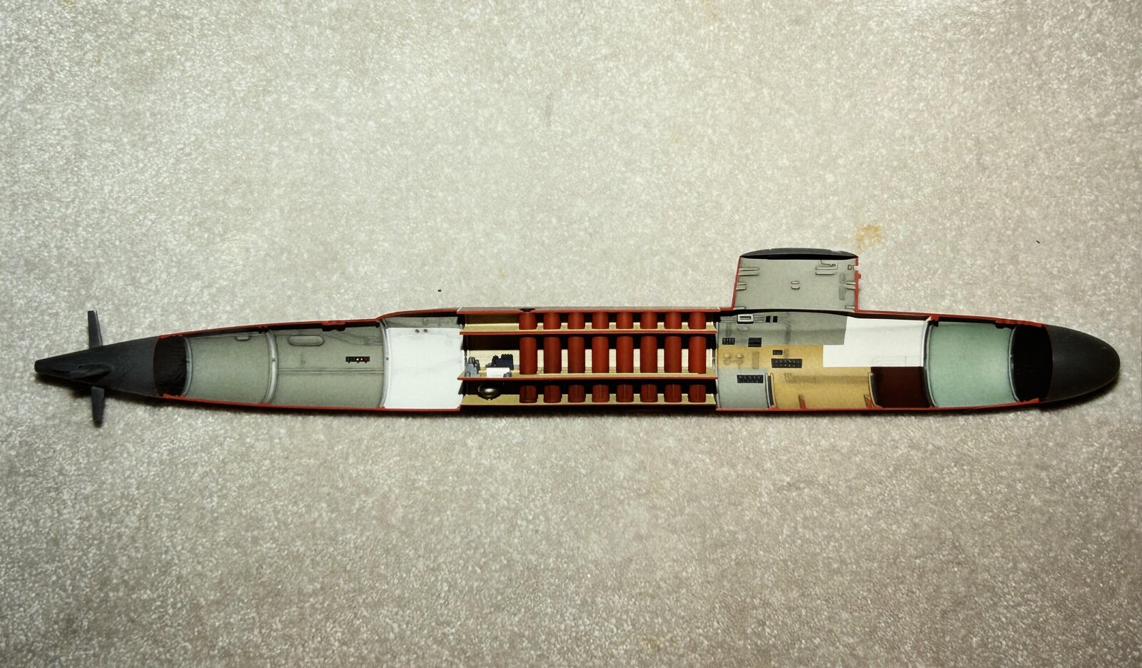

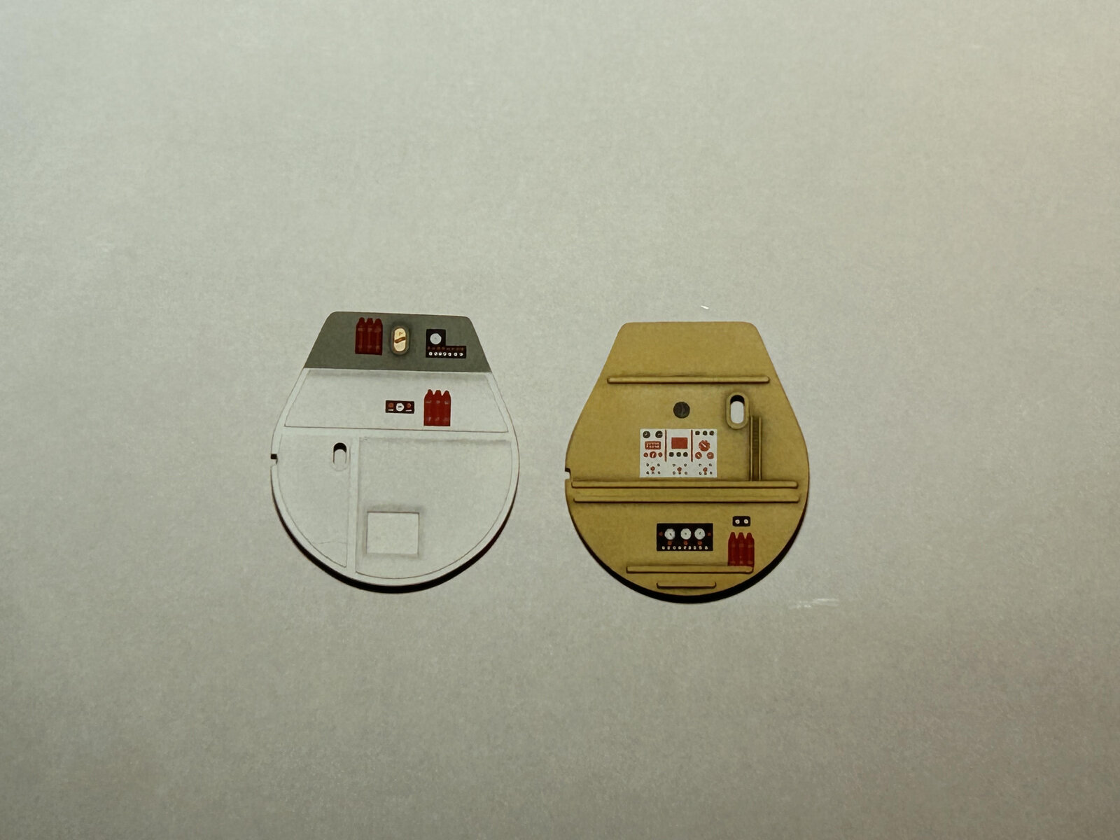

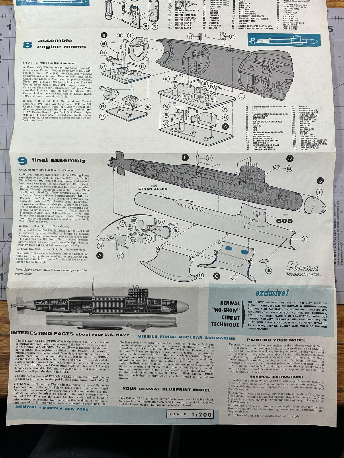

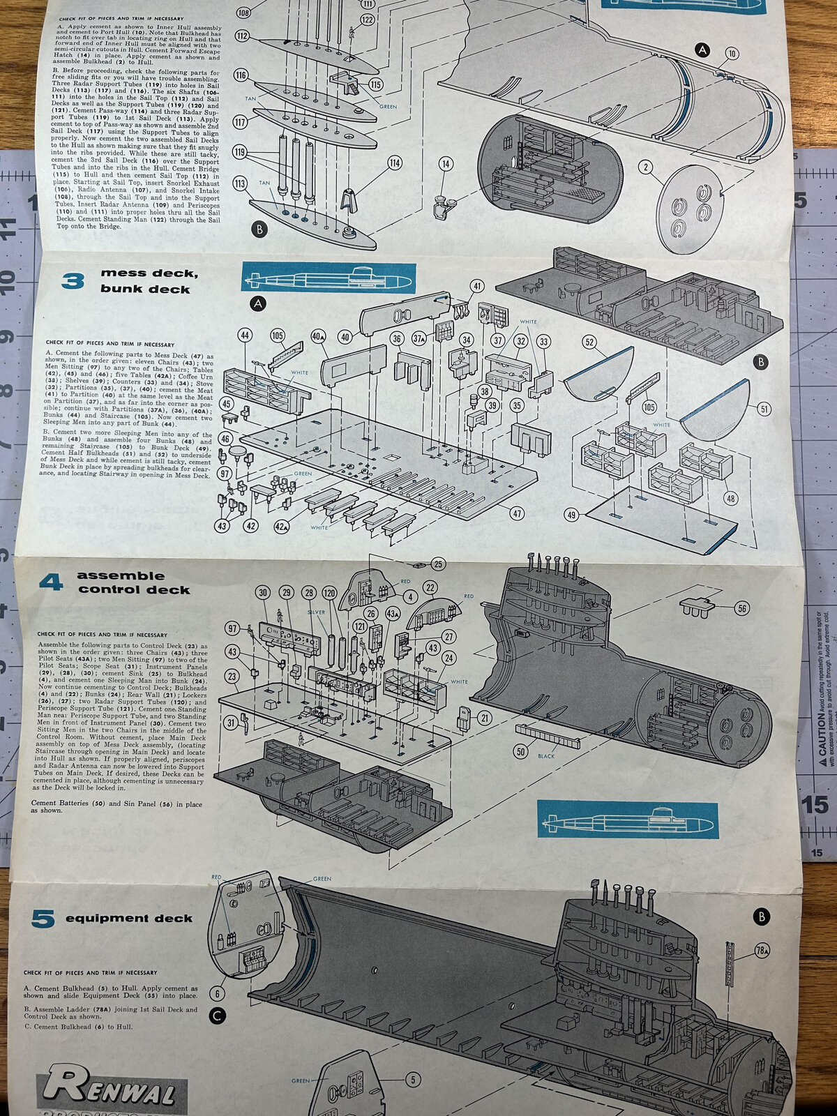

Also attached are a few construction progress photos, as well as great looking box art and instructions from the original issues. I hope you enjoy the photos.

Wow! Great job on that!
Reminds me so much of the illustrations in my How & Why books as a kid, or Popular Mechanics.
The colours you chose and detailing so bang on!
Cheers
Its not just the meticulous paintwork, its all the little signs, and surface details and dry-brushing and fades, and...and...and
Yes the colour assortment really makes it pop. Its fantastic.
Do you have the clear side? how does it look with that?

@Phillip1 , that is a beautiful job picking out the stock detail and improving on it, too! Beautiful model!

airdave-When I built this model the idea was to use a lot of different colors so the details would pop out. It would be boring if only shades of gray were used. Only the Thomas Jefferson kit had the clear hull side part. In my opinion adding the clear side would obscure and take away from the interior view.
The missile on my sub is glued in place and cannot be launched by the spring included in the kit. Below is a history overview of the Renwal and Revell nuclear submarine models:

Richard Baker-I agree, all submarine interiors are too crowded to be practically represented as a cutaway model.

Regarding (any) submarine model with a cutaway view: The only relatively flat areas are the decks. There are no flat bulkheads or flat areas on the interior of the pressure hull. Every flat space to mount something is occupied. The interior of the pressure hull (the "walls" and "ceilings" of a submarine are covered with piping and electrical cabling. False ceilings cover many of the smaller areas where the crew eats, sleeps and stands watch, but no spare space is wasted.
Just about everything inside, (bulkheads, pipe lagging, pressure hull insulation, and cableways) is painted either seafoam green or a light tan. (Missile tubes were a light tan on the older boats; Tridents employed a dark shade of red that was closer to the red lead paint color on the exterior, below the waterline.)
