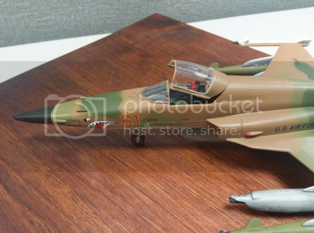

Uncertain in regards to the resin cockpits and the photo-etch. I prefer to build my jets in flight. As for the decals, usually you will need to apply a gloss coat of some kind (Testor's Glosscote, Pledge, or others), apply the decals since they go over better on a gloss finish, then apply another coat of gloss, then a flat coat to tone down the shine. Other's with more experience can better explain. I assume you are going for something like this?
