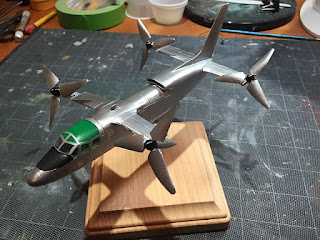

I just recently had the opportunity to paint the green translucent glass on a plane. I got the Vallejo Trans green and put it into an airbrush. The dusting coat seemed to be more opaque and as I put more on I could see the light come thru as green, but it still didn't look like actual see thru.
What did I do wrong?
Whats the correct way? TIA
