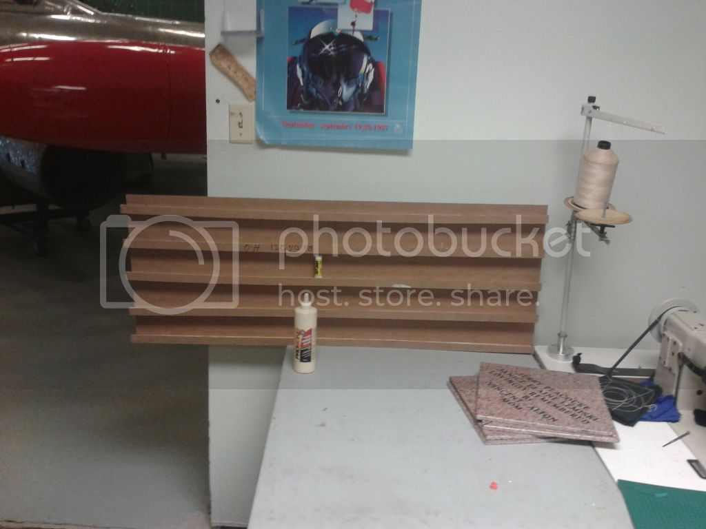

-1st step, cut your 4x4 sheet in half, then use one half to make your shelfs.

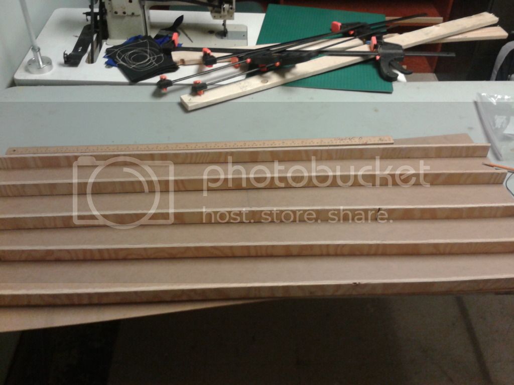

-mesure the size of paint container you want to put in it (I went 1.5'' for Tamiya) and cut 12 stripes out of 1 half of materiel (or 13 if you want to close the ends, wich i didn't
glue 6 of these stripes on your 2nd half like such
The pce i rucuped was only 17'' so I only did 5

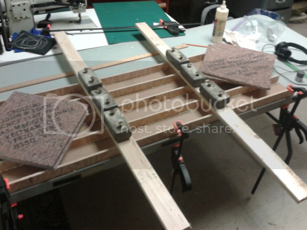

you can nail these on but i didn't, i just let them dry for a good 30-45 min with weights
then take the other 6 stripes and glue them to the front and secure with finishing nails like such

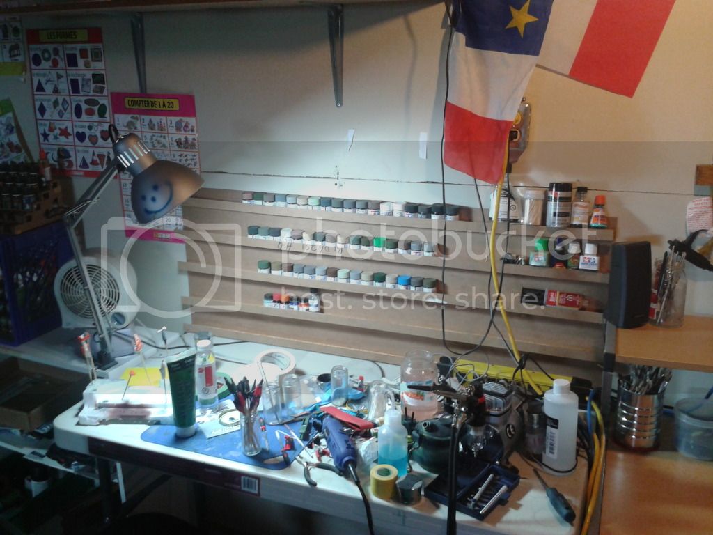

And there you got it! You can put as many of them as you want end-to-end and the beauty of it, if you're a scrounger like me, IT'S FREE!
Here's the finished product, sucured to the wall in my shop
Hope that helps some of you!!
