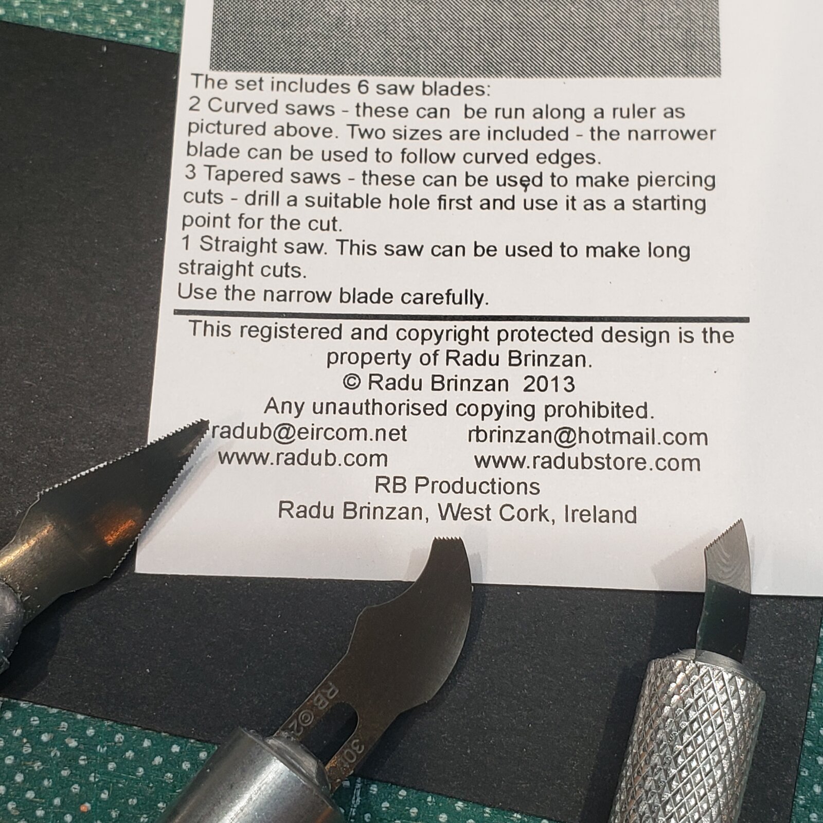

In the meantime, I'm making do with my nano saws: not as precise, still have to deal with a kerf, and very delicate.
