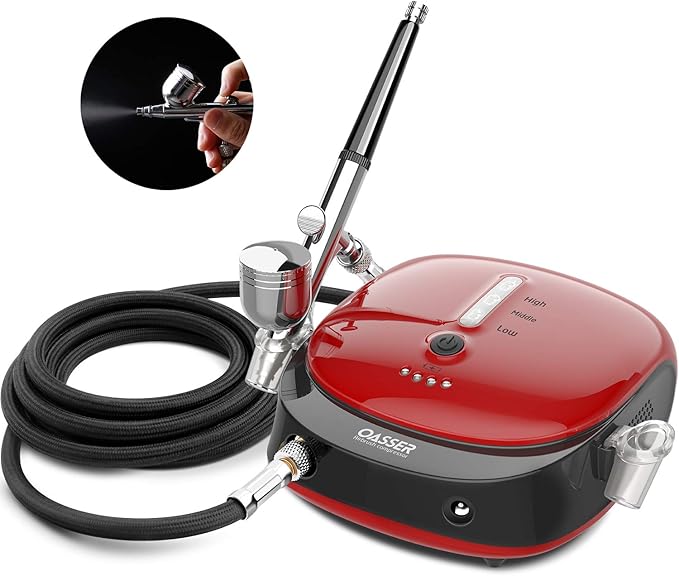

Hi, I'm having serious issues with airbrushes, I got a cheap one which was basically useless, then this one .....
https://www.amazon.co.uk/dp/B08DKCXQ6B?ref_=ppx_hzsearch_conn_dt_b_fed_asin_title_6&th=1

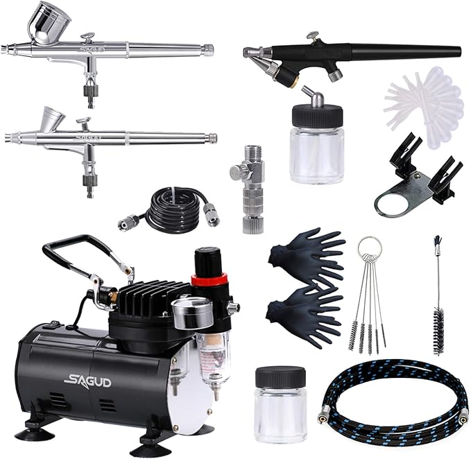

Better but not good then i forked out for this....
https://www.amazon.co.uk/dp/B0923H9WK3?ref_=ppx_hzsearch_conn_dt_b_fed_asin_title_3
Works but only close up , no wide spray pattern, only a fine line of spray, as you pull further away no coverage at all
Tried all 3 supplied airbrushes, same result

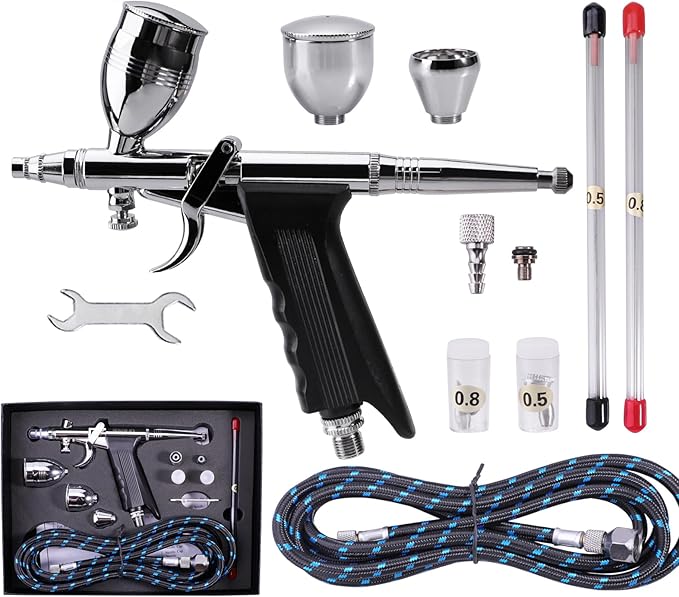

Then got this ....
https://www.amazon.co.uk/dp/B0CHYD4G2V?ref_=ppx_hzsearch_conn_dt_b_fed_asin_title_2
Still no coverage, tried adjusting pressure up and down no change
Tried all 3 needles 0.5mm and 0.8mm no change
Acrylic airbrush paint straight from the the bottle with and without thinners no change
Altered front button and rear button no change

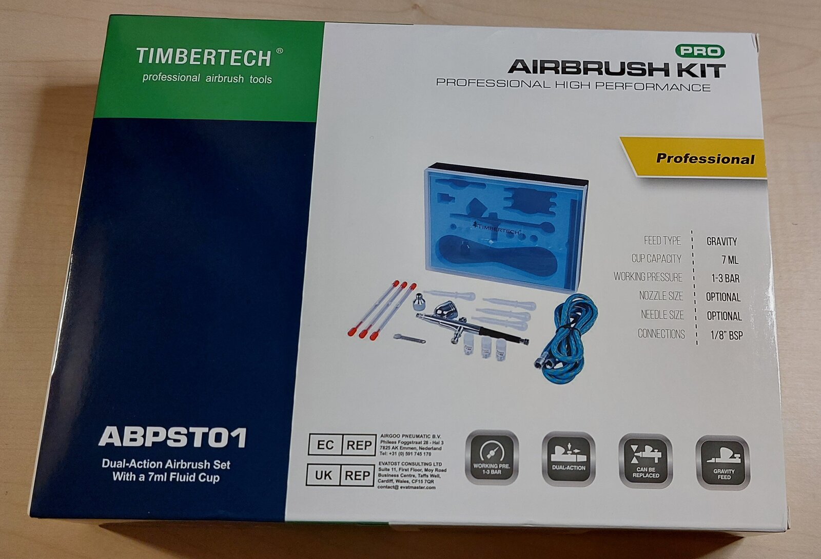

I bought 2 of these on amazon 3 year's ago. Around £20 each. Never had a problem with them but you need to really clean them well after each session and complete strip down once a month if possible.
Have you stripped down and cleaned every part of your airbrushes just to make sure nothing is blocked? Pantherman

got the same one for my birthday o.3 mm nozzle broke but still works very well I strip and clean once a week

Re what you bought...cheap stuff is always going to give you problems.
Not one of my many airbrushes cost as little as that package deal you bought which included 3 airbrushes and a compressor?!!
But it's not just about cost.
Its all about the fit and finish.
Cheap airbrushes have poor part fit, gaps and air leaks, rough and unpolished inner surfaces.
Poor internal surfaces is probably the biggest concern.
They clog easier and aren't going to operate well.
Generally thinned paint will flow better, but you still need adequate air pressure.
These small cheap compressors often don't provide that.
You would do better with propelled air canisters, but they don't last long and it gets costly.
