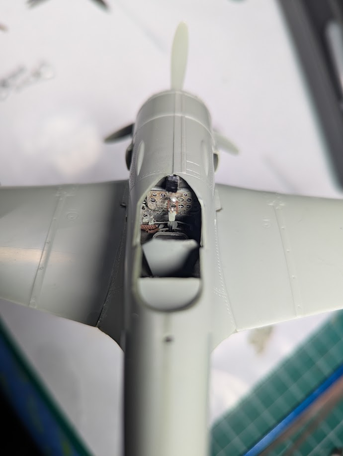

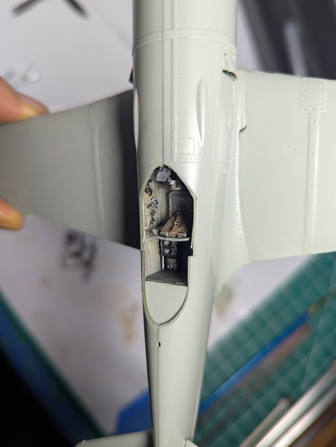

Cockpit was the worst, the actual gauge pod wasn't terrible, but it was incomplete and just a flat bit glued to another flat bit. The Eduard dash helped a lot!
Biggest issue for the cockpit though...there were no rudders, nothing, not even some lines on the floor. Really?

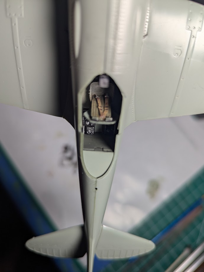

You can see above there's a fairly complex for 1/48 mechanism there for rudders now.
The seatbelts are from the Eduard kit too.

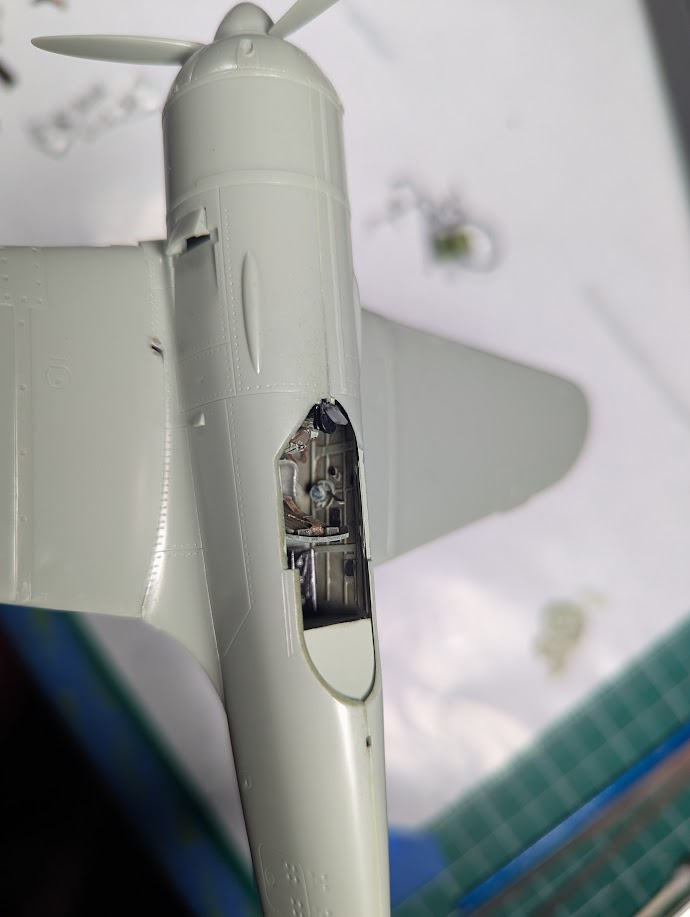

There was an attempt made to mold into the sidewalls some sort of controls. We got rid of those and used the PE. Above is the port-side controls.
Some similar constructs on the starboard side above. This will have to suffice, it is much improved over the boxed bits alone.

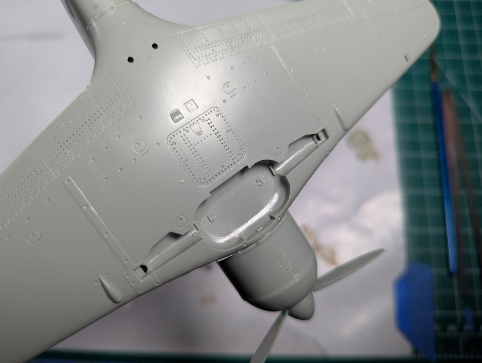

I mentioned a lack of detail, I'll stand by that, but there are examples where the details are good. I think this picture shows what I mean.
Underside panel details and particularly the dive brakes are good, but look at those wheel wells, just...nothing.

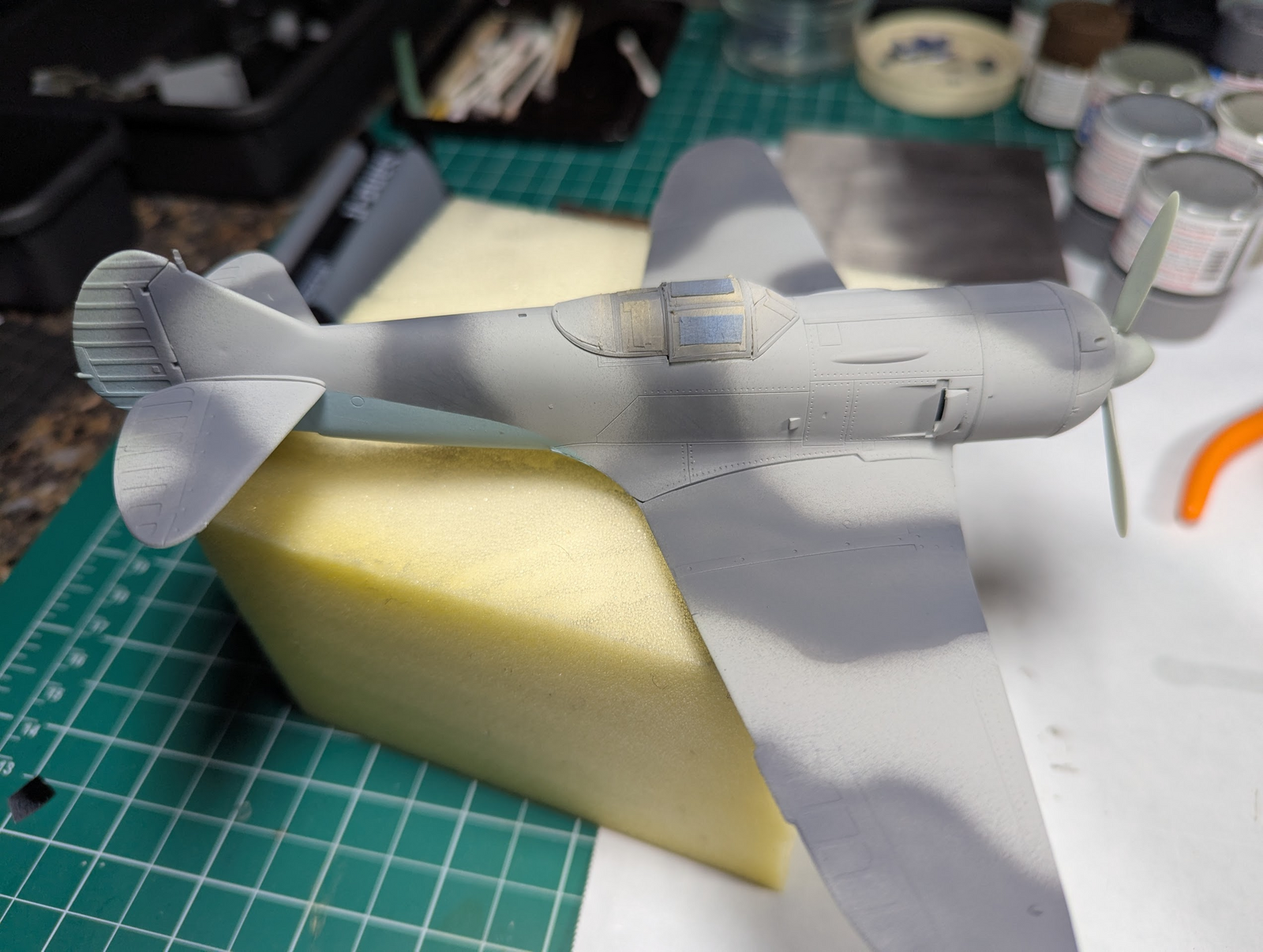

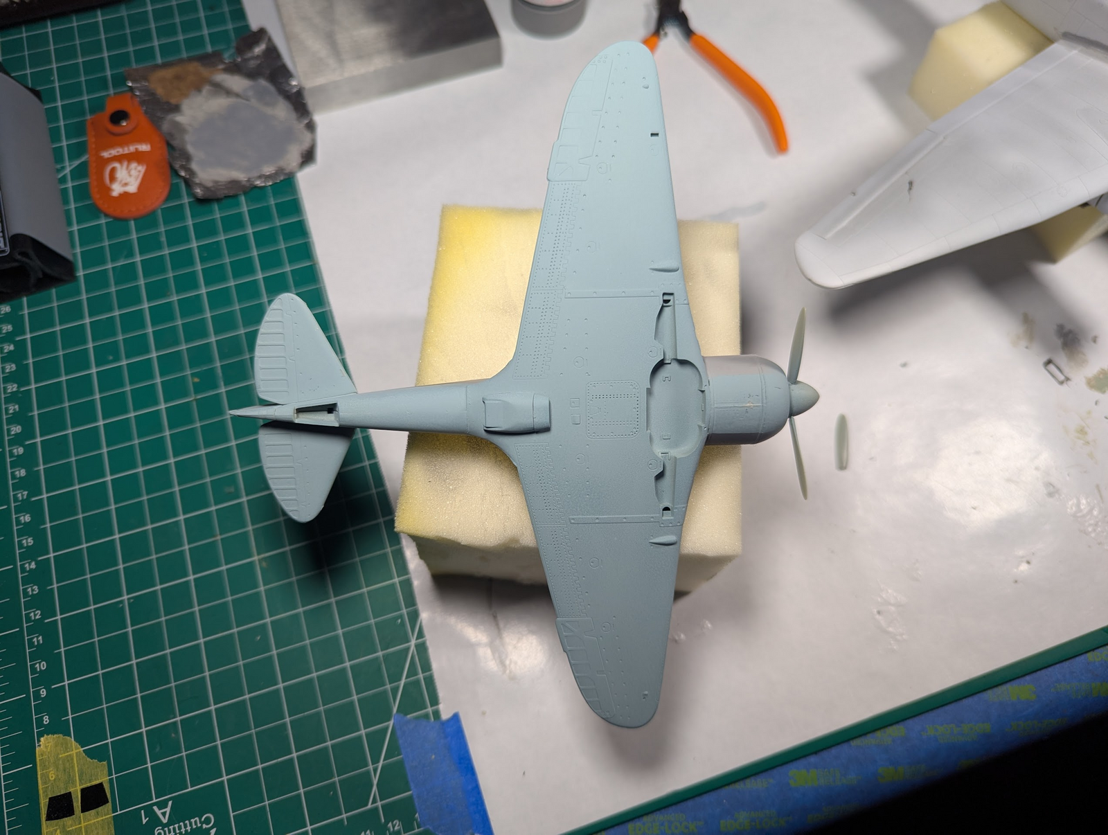

So all one can do is keep going. I spent about a day on the cockpit, plan was to completely knock this little guy out in a few days.

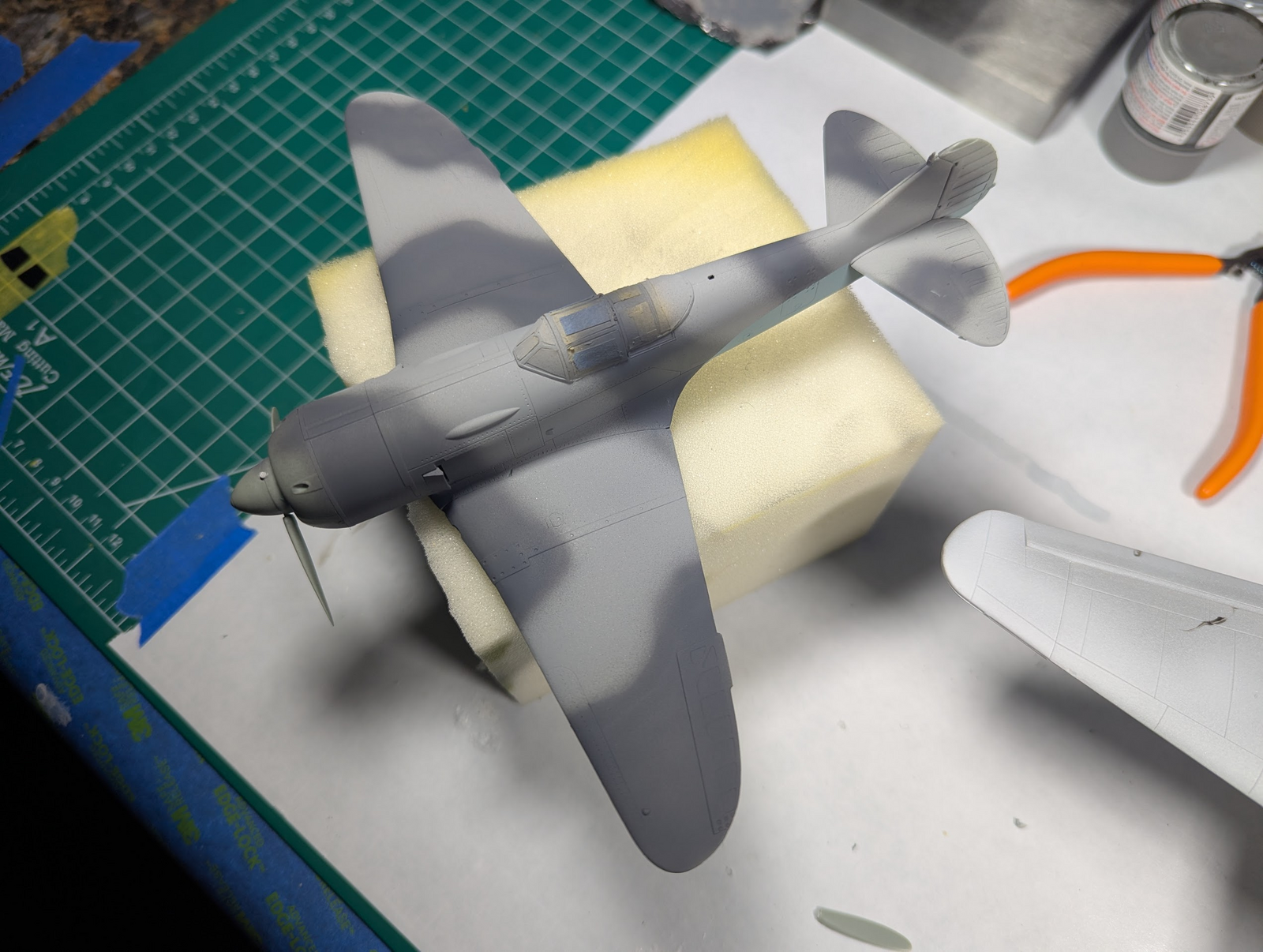

It might look like I totally ignored seams, and some I did, but not all. Just trying to keep with the quickie approach. Can only expect so much from a $10 kit, and the fit of the parts was better than I expected.

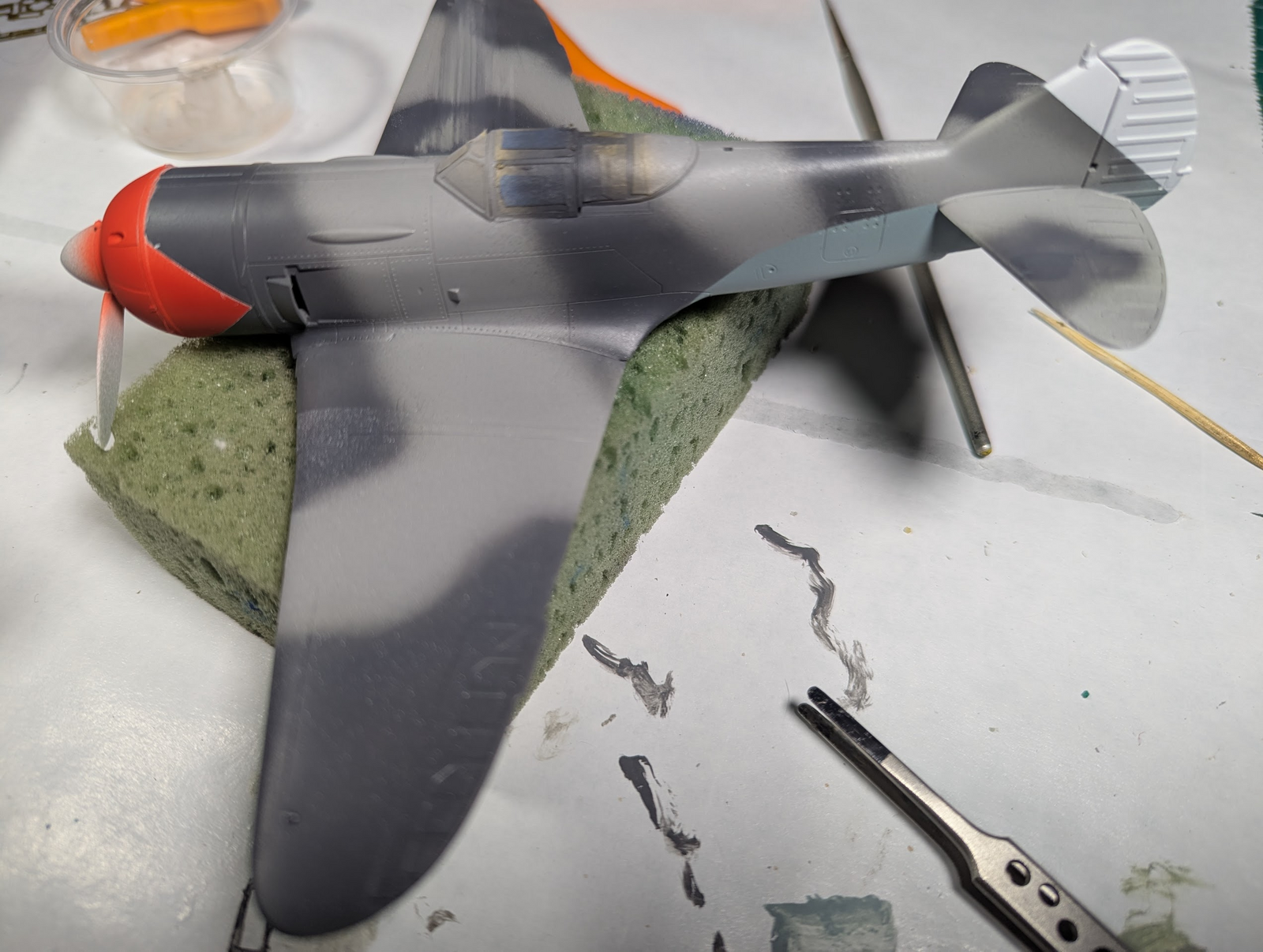

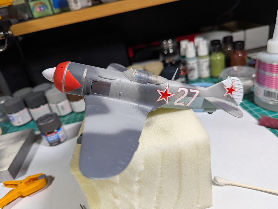

Painted the white bit of the tail, ummm, used white.

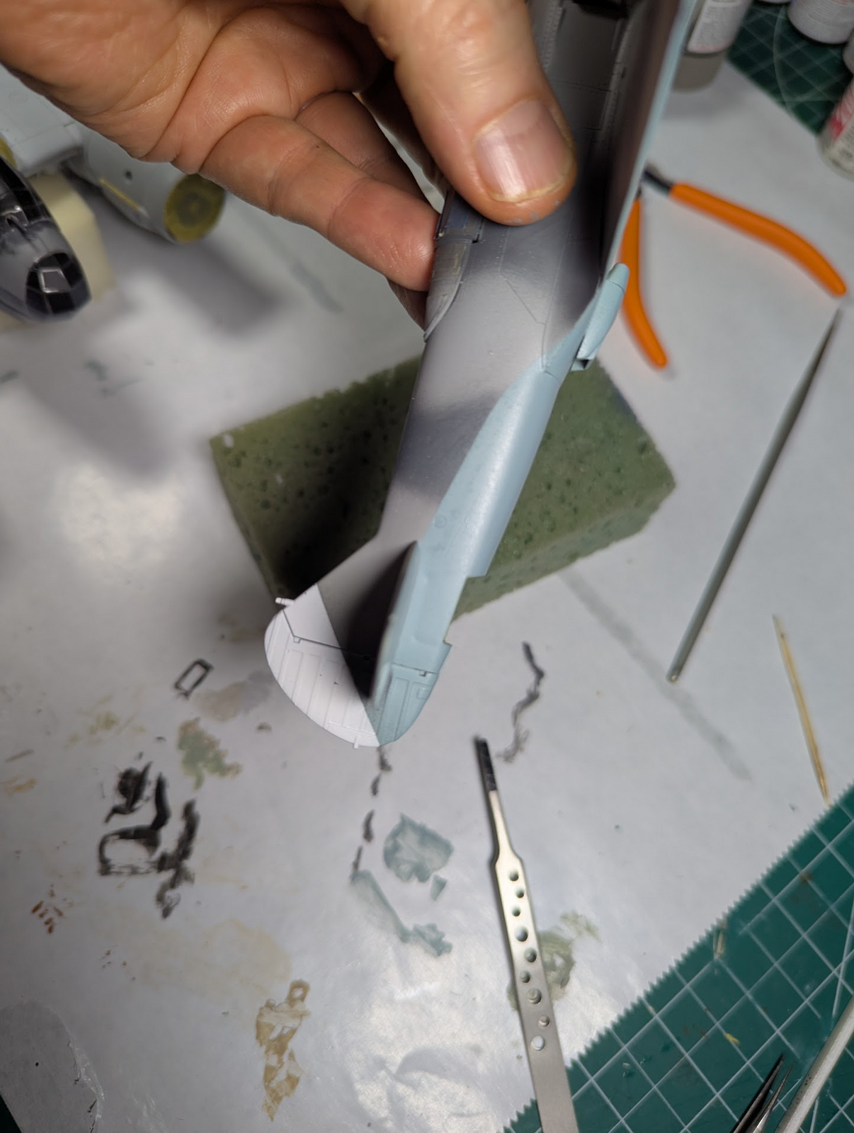

Also added white to the nose, but did not snap a piuc of the masking. Idea was to allow the final color (red) to pop and not see camo underneath. It worked, I can say that. What I did not anticipate was the white leeching through or whatever happened to lighten up the red. I use XF-7 with only thinner.

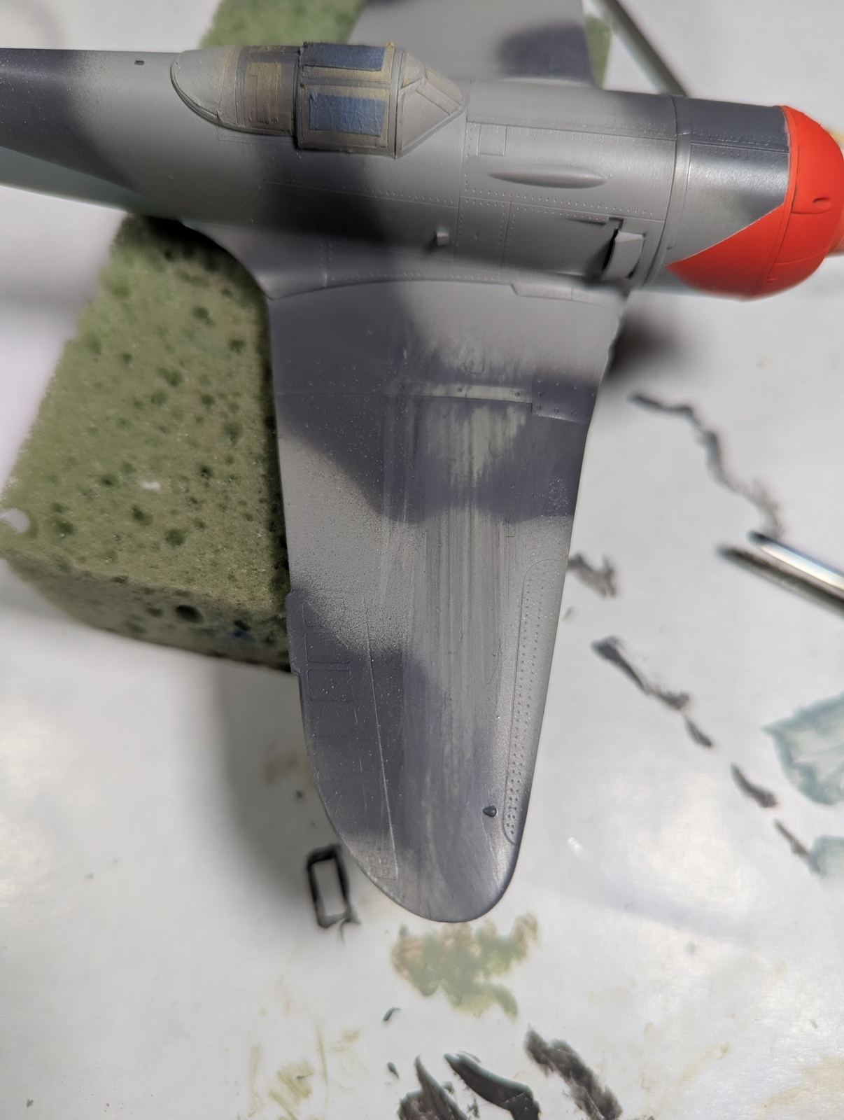

The overspray of the white is quite obvious above, it was on both wings. I decided, hey...there's a gloss coat down, just wipe it off with a bit of diluted alcohol.
I swear, the chemistry of this hobby is my biggest hurdle.
Yup, the clear coat was acrylic!

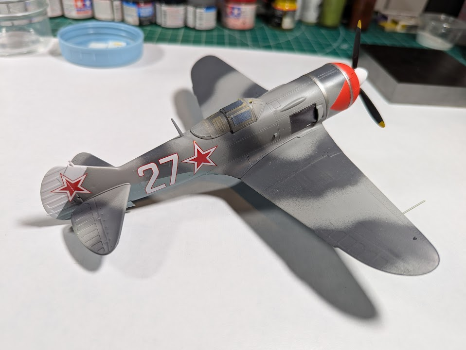

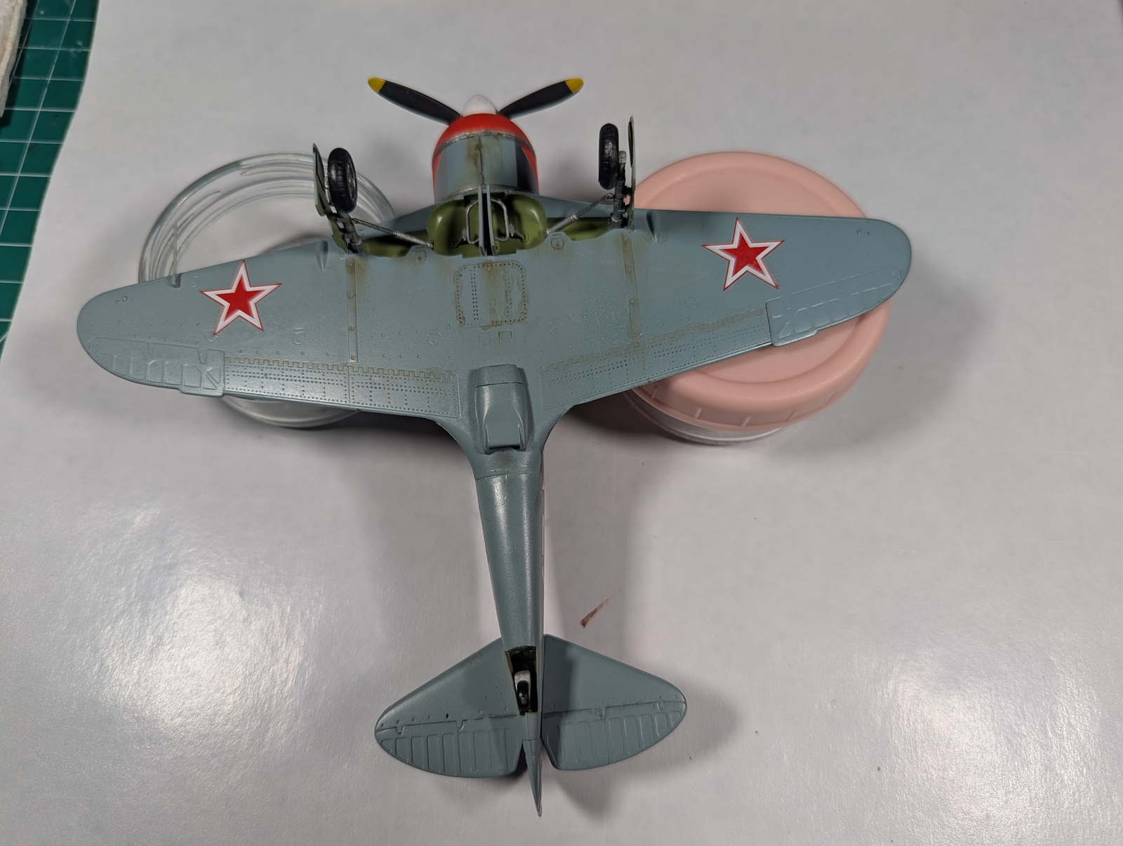

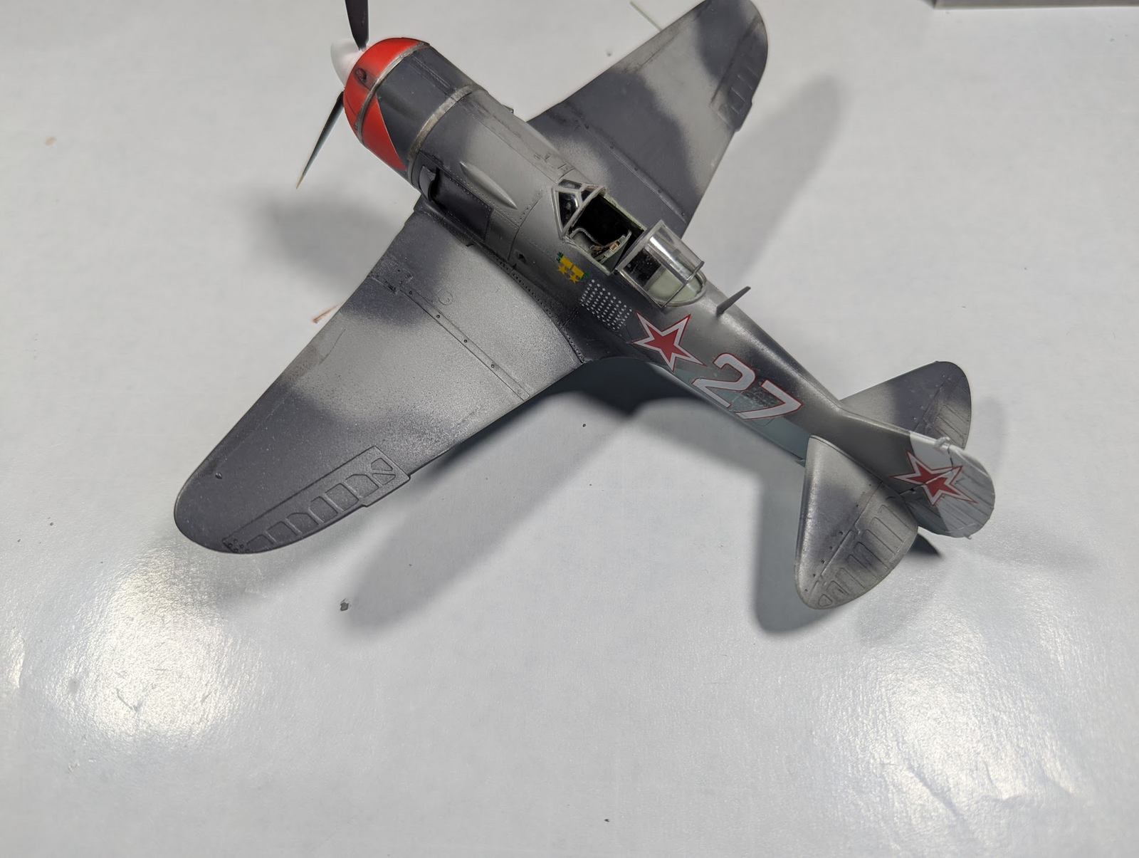

Minor setback, I just had to respray a bit is all. Guess I never noticed before but the Russians did not have insignias on top of the wings, very odd during WWII when all the major powers did.
Anyway, fixing that mistake to a 90% measure was good enough for me. It looks nicer with the stickers on it.

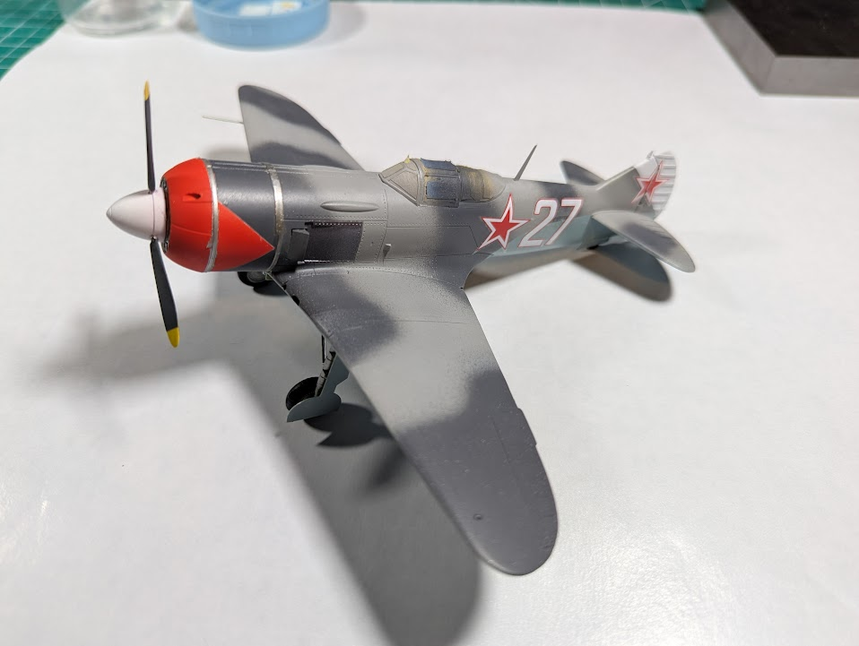

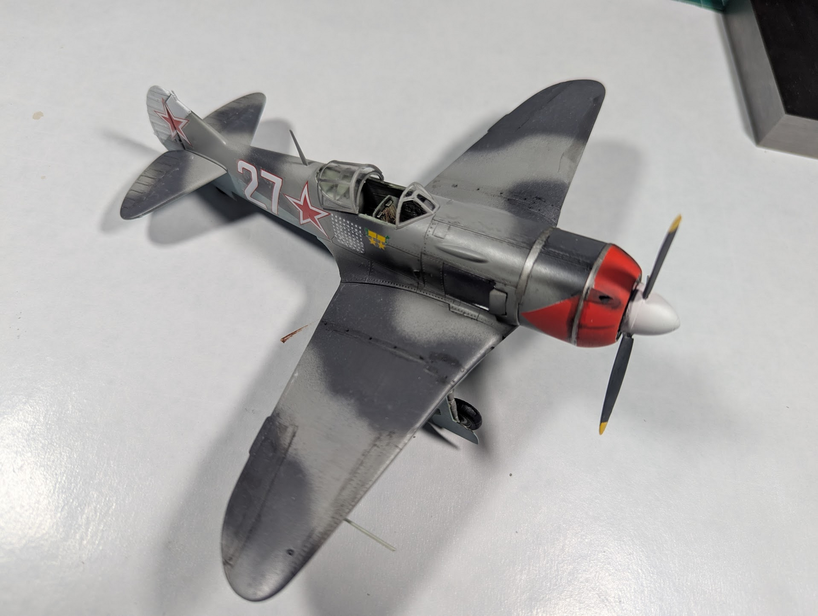

In the theme of the quick/easy build I put modest weathering. I tried to keep restraint. This was the ride of an ace, a star, a hero of the Soviet Union, his plane got washed.
I am not happy with all of it. Some parts went well others not. But push on.
I still need to put some silver on the pitot, and realized at the last minute that the kit engineers did not allow open-cockpit.
GRRR.
Would using a heat gun to spread the center canopy a tad be a bad idea?

Try hot water—much easier to control.
How hot?
Assume one must be able to immerse hands right? Is it wise to slowly raise the temps until movement is noticed?

Not boiling. The Vicat softening point is 194°F (90°C), so using a thermometer is a good idea. Note that clear polystyrene is more brittle than colored, so you want to make sure you get it warm enough, or it will craze. Practice on clear scrap is a good idea. I usually hold the part with fine tipped tweezers, since I no longer have asbestos skin, but you shouldn't have any trouble holding the part to deform it slightly. Like I said, practice is a good idea.
