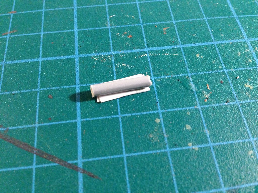

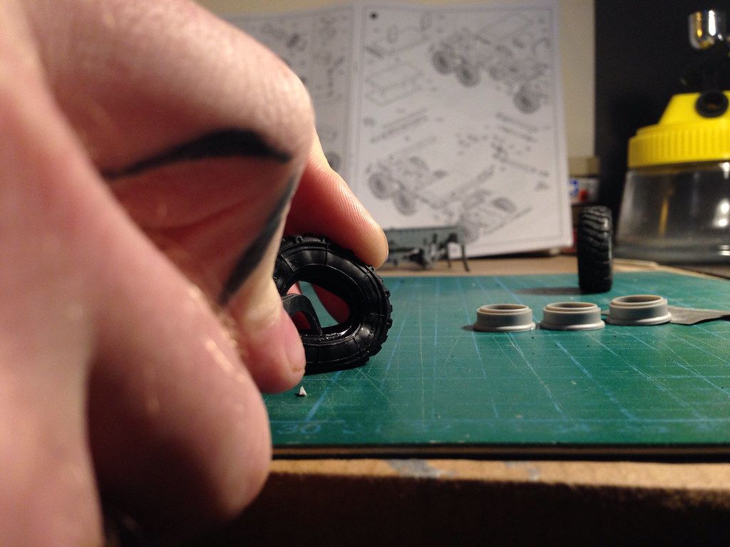

Then make the flat surface we will use to create the weight.

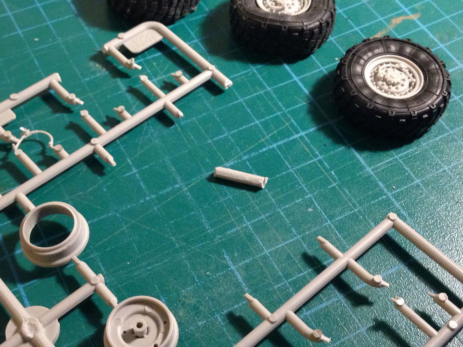

I used some finished sprue tree off cuts:
They seemed strong enough to hold the resistance of he tyre's rubber - so I used 'em

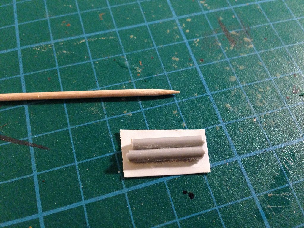

Cut to length and glue those to some plasticard
The length/width you choose here will depend on how 'flat' or 'weighted' you want your tyres to look:
Let it dry for a minute and then put it into the tyre:
This part was a bit fiddly and I tried a number of ways here.
NOTE: Using only super glue wasn't holding for whatever reason but adding some cement to the bottom of the plasticard and putting superglue inside the bottom of the tire held really well (is this a valid chemical reaction?!)
So once you've glued and inserted - you're going to have to hold this here for about a minute or until you're satisfied the superglue has dried.
I did try holding against a flat surface
But I found just using my fingers was better as a I could feel whether the parts had taken hold

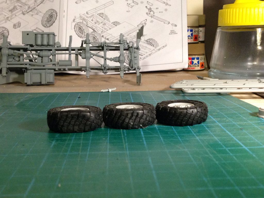

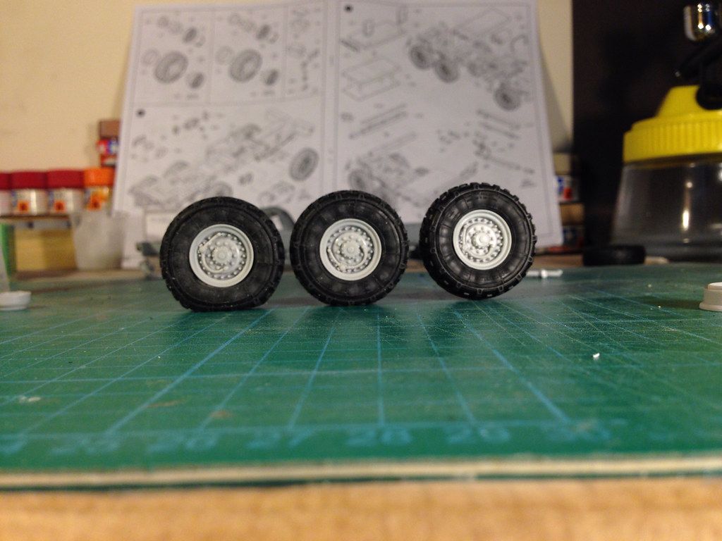

Then pop in the rim and behold your creation.
(the on on the right is untouched)
Obviously the more 'extreme' your weight the little more work you'll have to do with regards to keeping the inner of the tyre attached to it's rim.
hope this has been helpful, also stop me if this is just crazy and there is a much easier way!
Thanks for looking.
