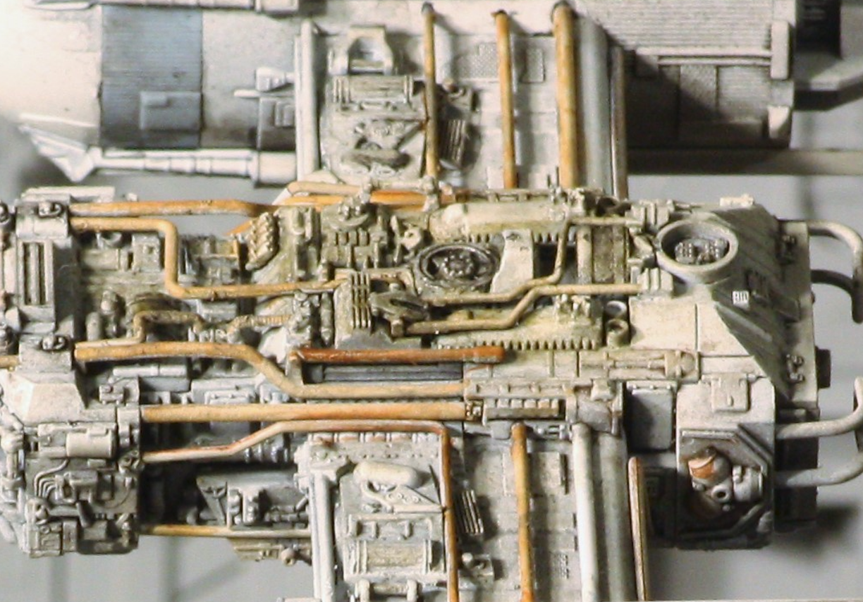

I used a thinned glaze of that color to get the coppery look for these pipes (I wanted an in scale dull old copper look so I did not actually want to use metallic paint)

That looks very authentic, thanks for the pic. The color I need is for a pair of exhaust pipes on a Gloster Gladiator. In my mind this would look comparable to what you've done with heat effect, discoloring and possible moisture markings.

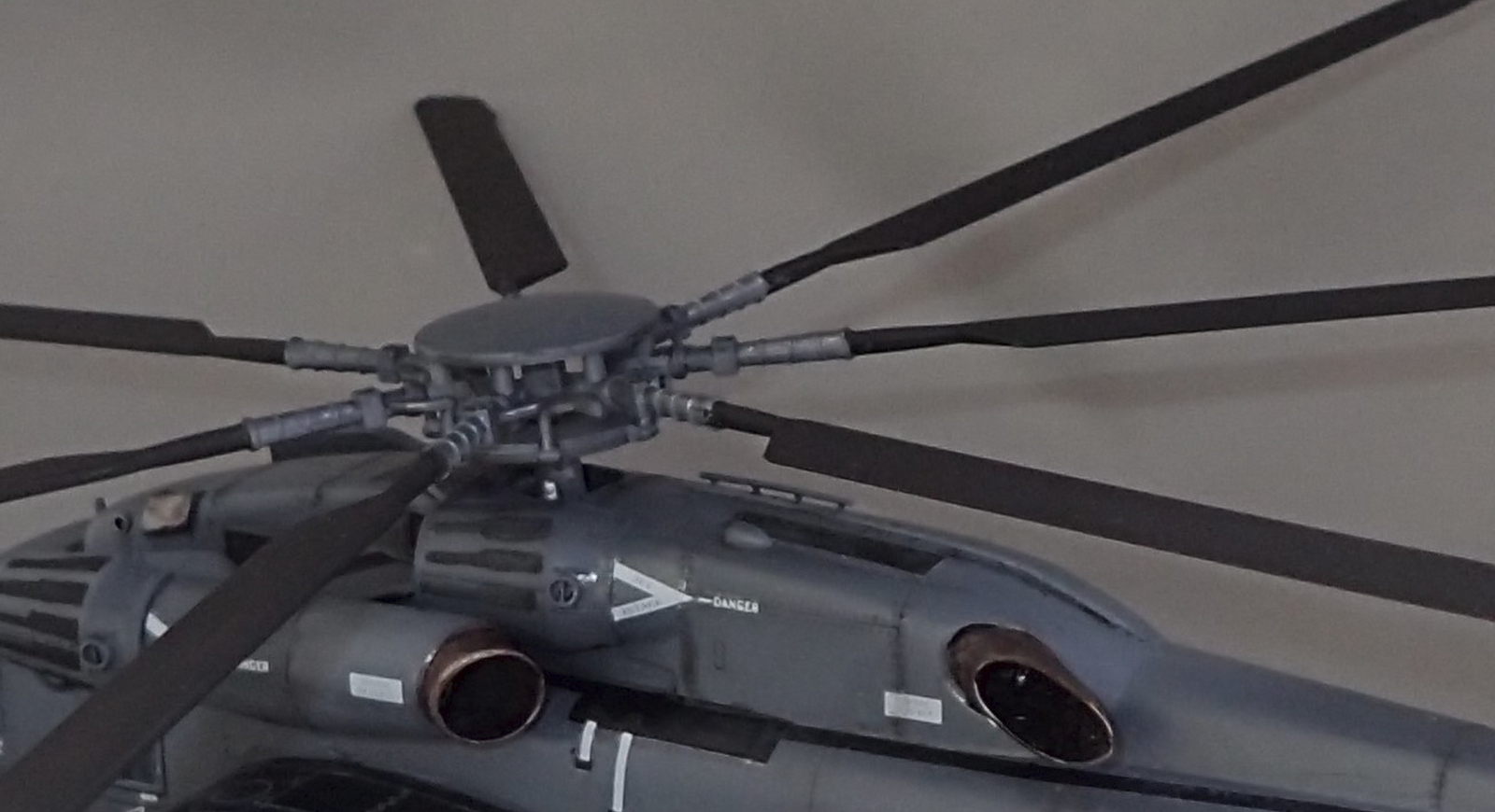

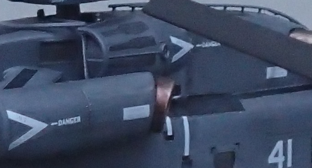

In my case, on my 1/72 Sea Dragon exhaust tube (or whatever the technical name is) I used P3 Brown ink (which is actually a very red/chestnut color more so than brown) and Army Painters strong tone wash over Army Painter Durasteel (although any mid range silverish/steel color would work. )
You theoretically could take the same approach with washes/glazing using similar acrylic paints you have (not sure about enamels). The "glazing" technique is like staining more than a wash that settles into low areas. I do it by mixing in some glaze medium (Vallejo). Inks just make it easier
here are some shots in different lighting of the effect. I also did it in several thin coats. Hard to tell in these pics, but you can get the uneven "splotchiness" which helps add to the effect
Thant looks great, some interesting techniques. Thanks.
