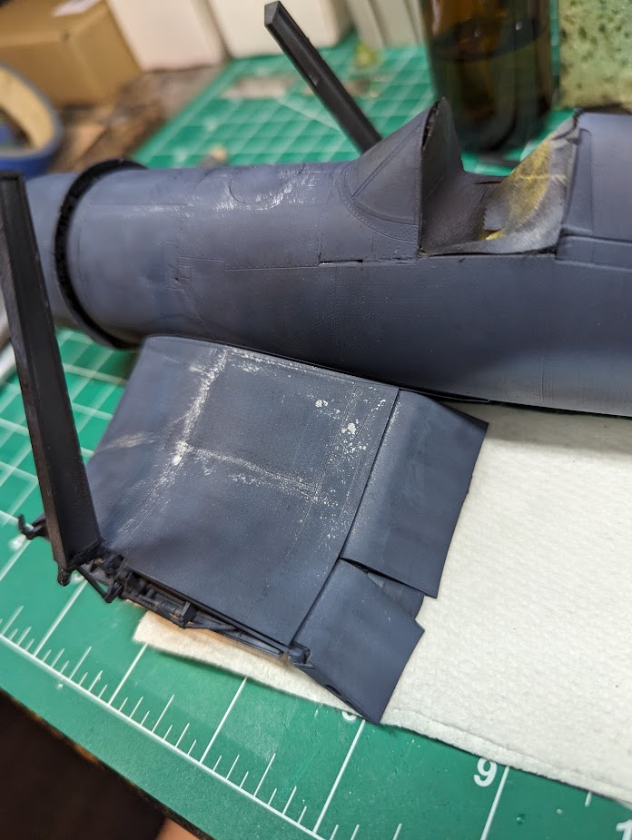

This is not the glossy blue you are talking about, but a dark blue that still shows the pre-shading.
