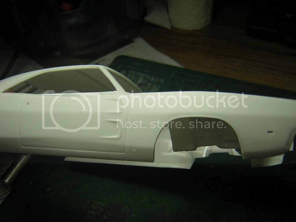

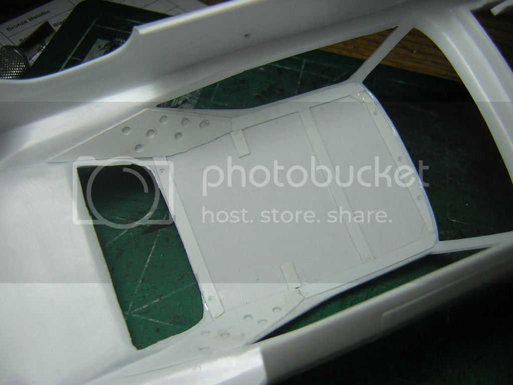

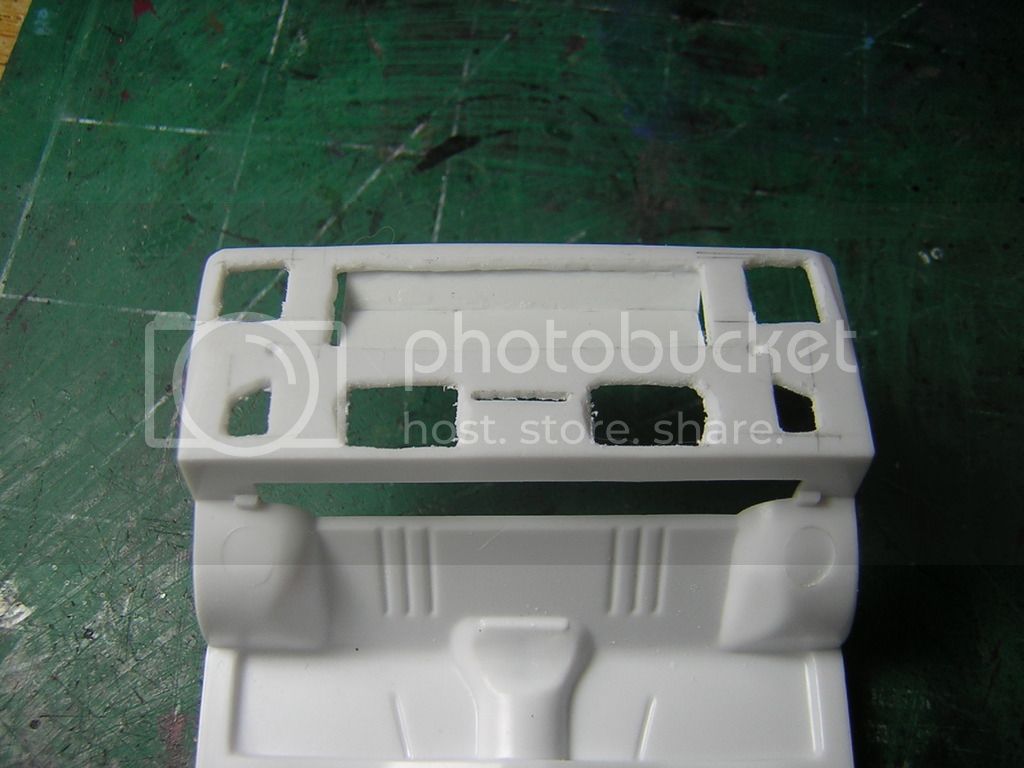

I'm finally wrapping up my current commission so I had time to work on this.
Looking through pics of the car, I realized it has no interior and I wanted to replicate that.
I started with sanding off the headliner texture and then built up something like the structure of the car with .020 plasticard. The work is based on the pictures but not meant to be super accurate.
I also removed the wing windows, drilled out the door handle holes (no handles on this car!) and drilled out the front markerlights. The car has a '69 right fender so I made the square marker on that side and the round marker on the left fender. I also removed the front and rear window chrome.
So far I'm pretty happy with it.
Next up is to tackle the floor pan and package tray.

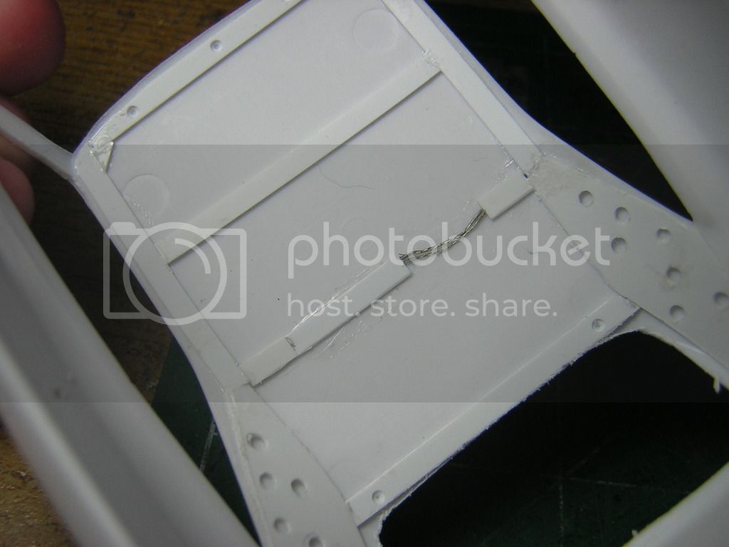

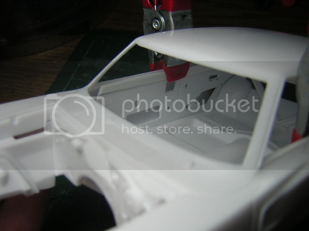

Day 2 of the build
First, I fixed the roof by extending one of the braces and then adding wires for the dome light (again, based on pics of the car). I also filed down the wheel well chrome.

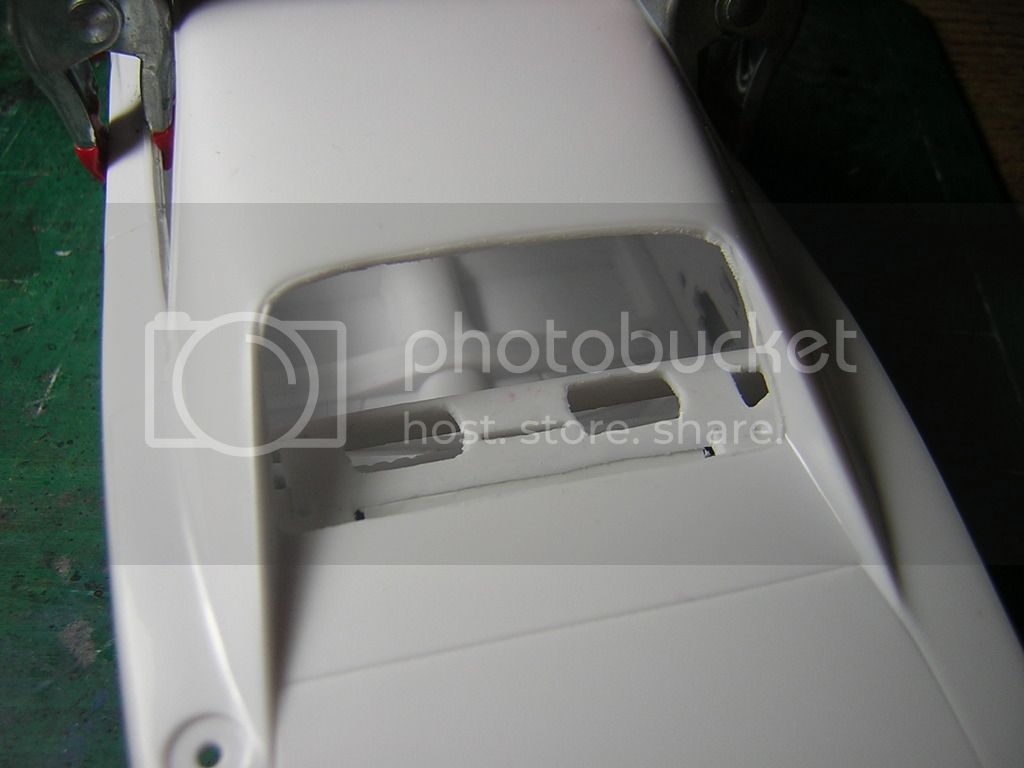

On the interior I spent most of the night sanding down the carpet texture. Then I started on the package tray looking up pics of the actual part online. It still needs some fine tuning but still very happy so far.
For the rest of the floor pan I just need to carve out grooves like seen in the above pic. Not sure how I'll do that yet..

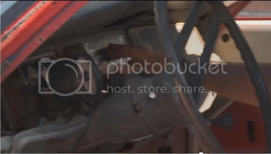

First, the dashboard. Here is the best screen cap from the youtube video

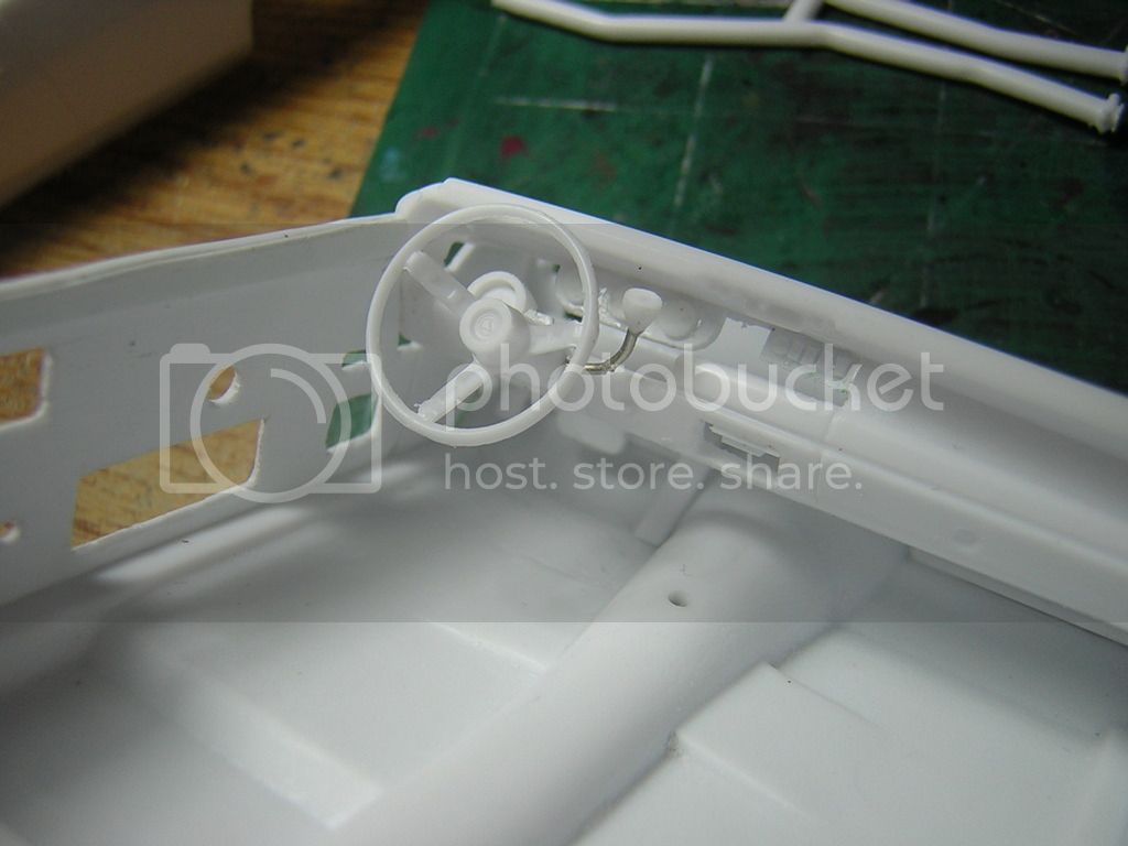

Now my scratch built version
I especially like the Tach which is a 1/8" rod inside a 3/16" tube.
The sides of the interior are separate piece so I copied them and cut new ones out of .030" card and once again looked up pics to try and get a good idea of what the structure looks like.
I really like how the package tray looks through the rear window.

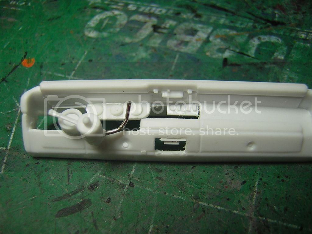

OK finally got back to it a little
Finished the dash by carving out a shift nob from a bit of sprue.
I also had to get rid of the clutch pedal as the General Mayhem is an auto. Yes it means the trans will be wrong but eh, close enough.
Now a question: anyone have any ideas on making ripped seats? Only method I found involved masking tape and that does not sound like a good long-term solution.
Re: Roadkill '68 Charger
Nice job on the column! It's all the little things that will jump out at you in the end!
As for the seats, you can try undermining the plastic from the underside with a dremel until the area you wish to have ripped is thin enough to cut easy and peel open. Possibly some foam (makeup sponge or finer) for the cushioning material.... ;D You could try tissue as well...ct an opening in the plastic, cover the seat with tissue spanning over the cutout. Then when dry, slice and peel open. Also would give a little texture to the seat. ;D Play around with it!! Good luck

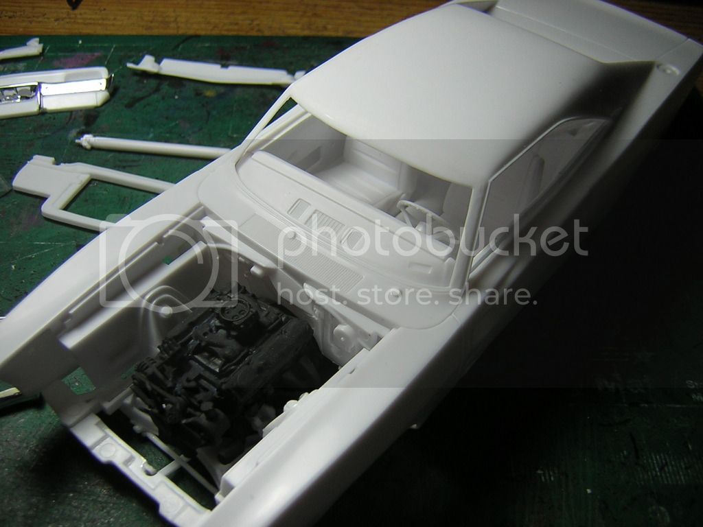

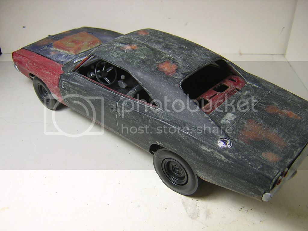

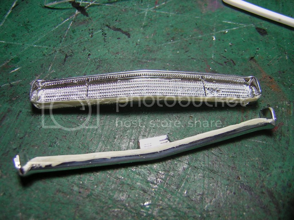

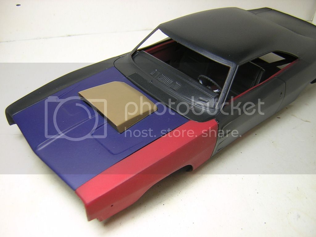

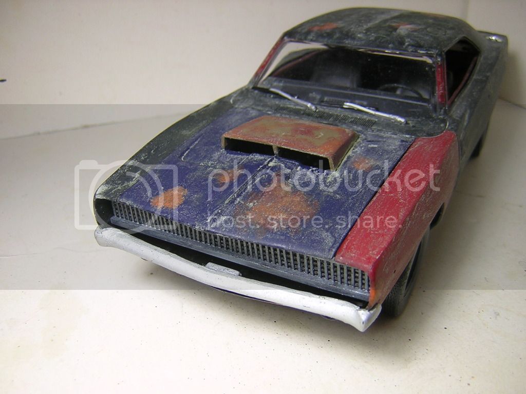

Wow! it's been a while since I touched this with so much other stuff going on, mostly Warhammer commission work.
But tonight I broke the car back out. I carved down the windshield to fit around my modifications, and then cut the front bumper off the stock grille. I was going to work on the exhaust but didn't have anything big enough to make the glass packs on hand.
Engine did get de-chromed, built and primed. Running out of time so I passed on making ripped up seats.
Only fabrication left is the exhaust and front grille. Time to get priming and painting!
