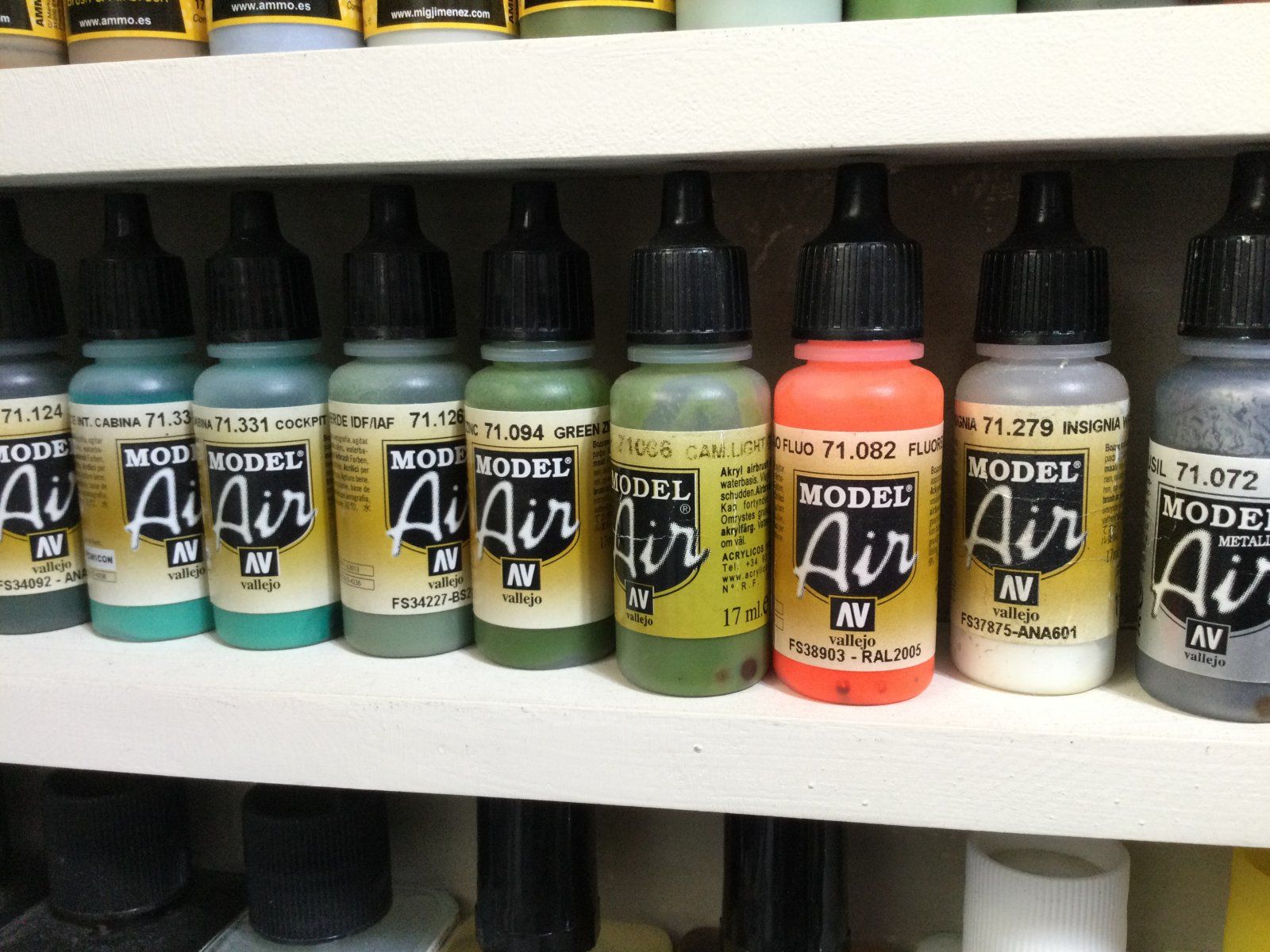

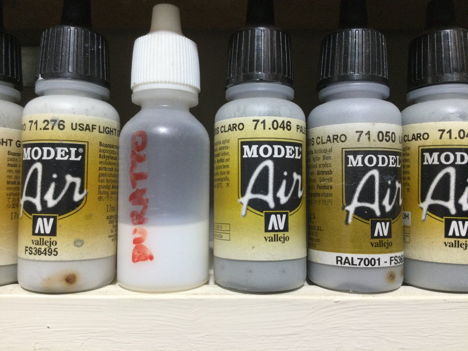

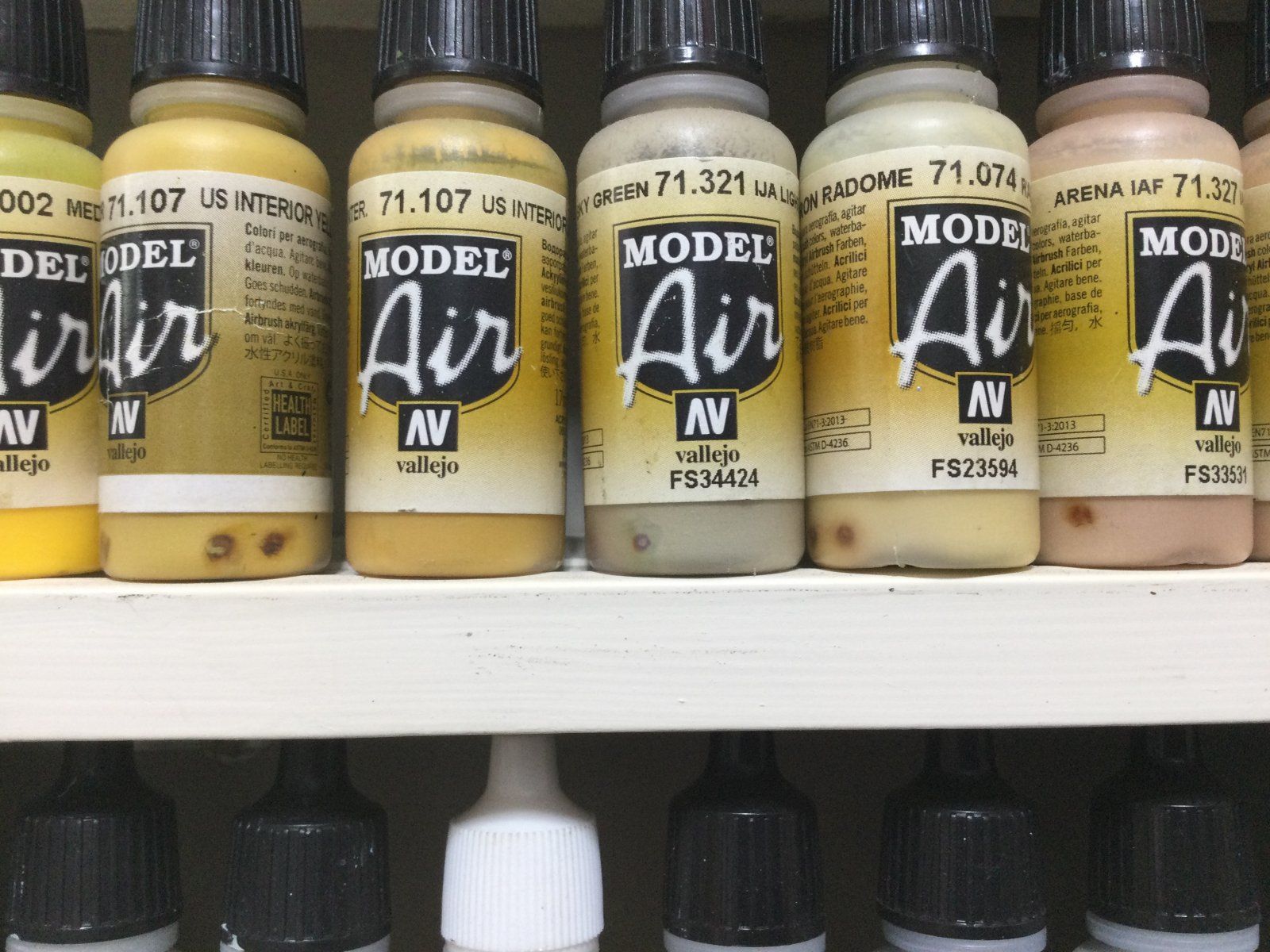

:mad::mad: Despite having been told not to put steel spheres (inox) into my paint jars, I did it anyway… so, this is the result.
Now I can't either pull it out or clean the frigging paint. I have at least 30 bottles this way…That's how you waste money.

There's 100's of formulations for " stainless steel " , high chromium content austenitic steels ( will not be magnetic ) are best for that application .
You won't know if you're buying cheap somewhere .

Stainless will rust . it can also be ferromagnetic ( martensitic stainless steels ) despite common misconceptions .
It depends on the alloying metals and their percentages .( The magnetic property is determined by the actual phase of the iron )
Specific formulations are intended for specific environments .
I'm sure AK specified to their supplier what the intended use was and the proper stainless steel was provided .
You could always do some testing in the future on candidates for the application .
Immersion in water with a Ph of around 9 will be sufficient .
Acrylic paints are usually around 8 to 8.9 max in Ph .
Give it at least a week of immersion . Higher temperature will accelerate the test .
