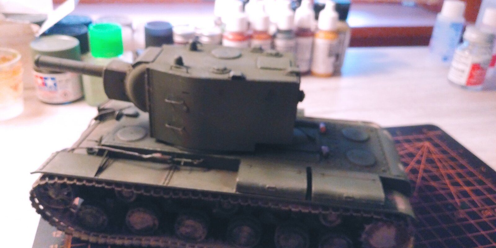

Hi All.
I haven't built a model in 35 years. I decided to build Trumpeter Kv2 and so far so good. I gave it an undercoat of black and white and sprayed Tamiya dark green on top of it. The colors really popped and I was Damn proud of myself.
Then
I decided to seal it all before weathering with x35. All it did was leave a dull sheen on everything and now the paint looks muted.
1.) Don't know if I mixed it in correctly. I did about 60-40 isp alcohol to paint. This seemed to work fine with everything else.
2.) How or can I even fix it.
Thank you for your input and advice

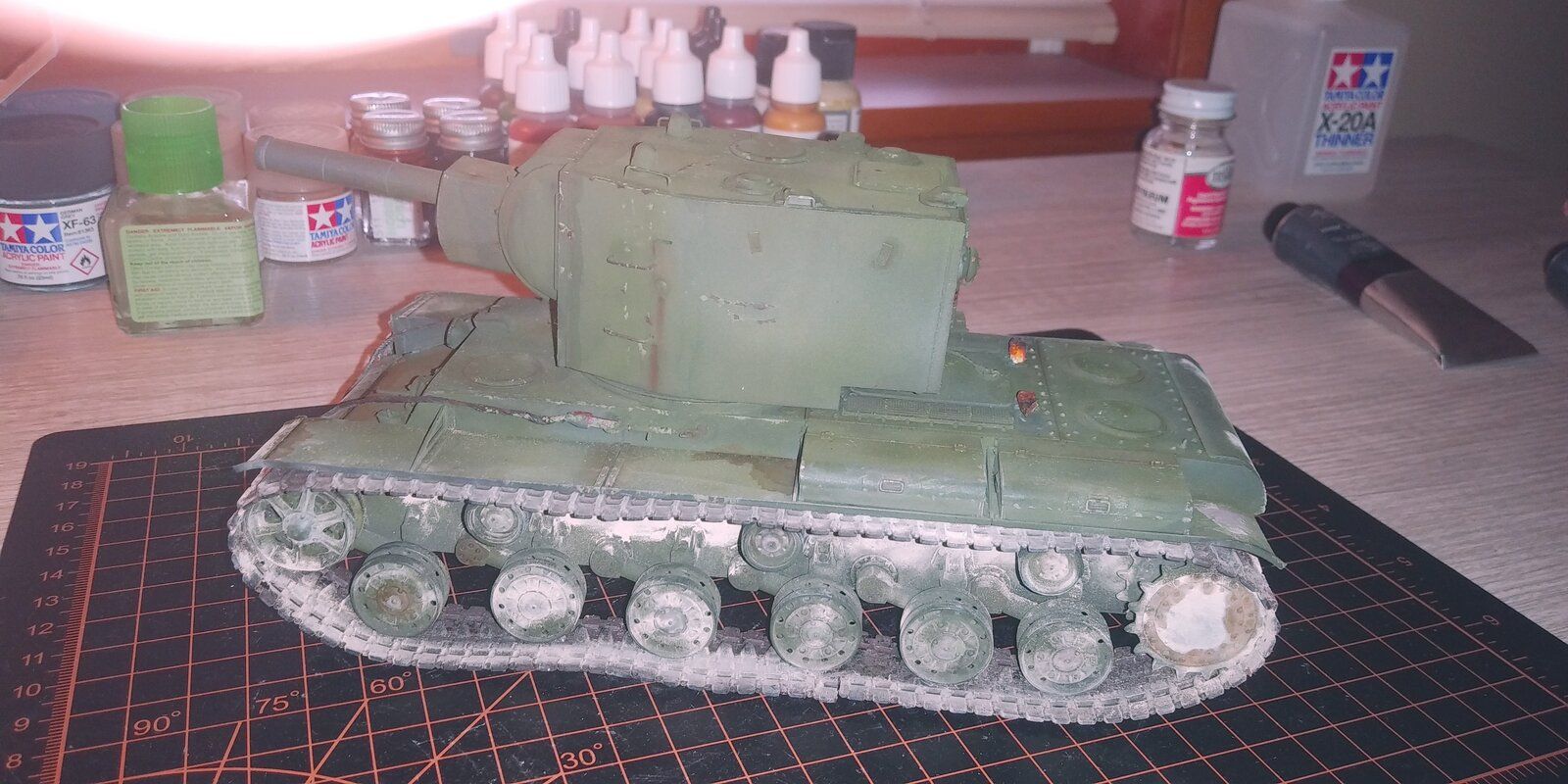

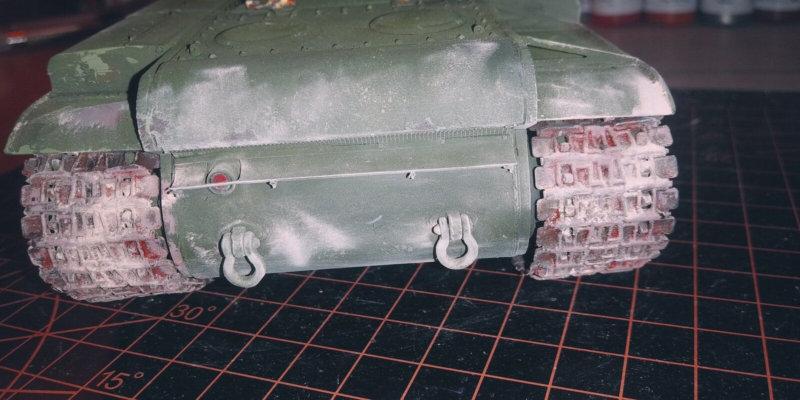

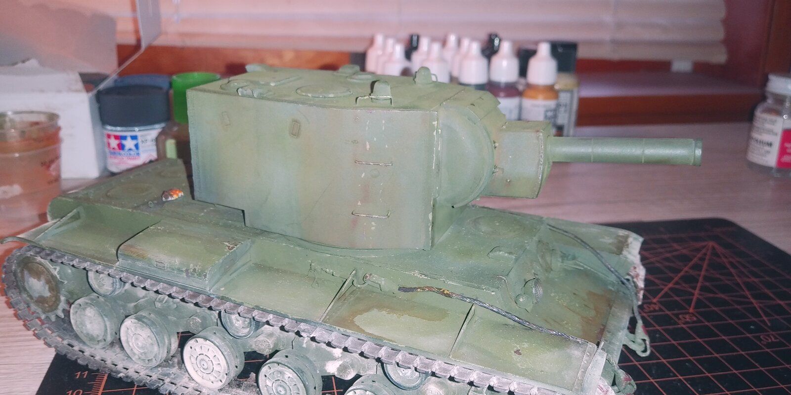

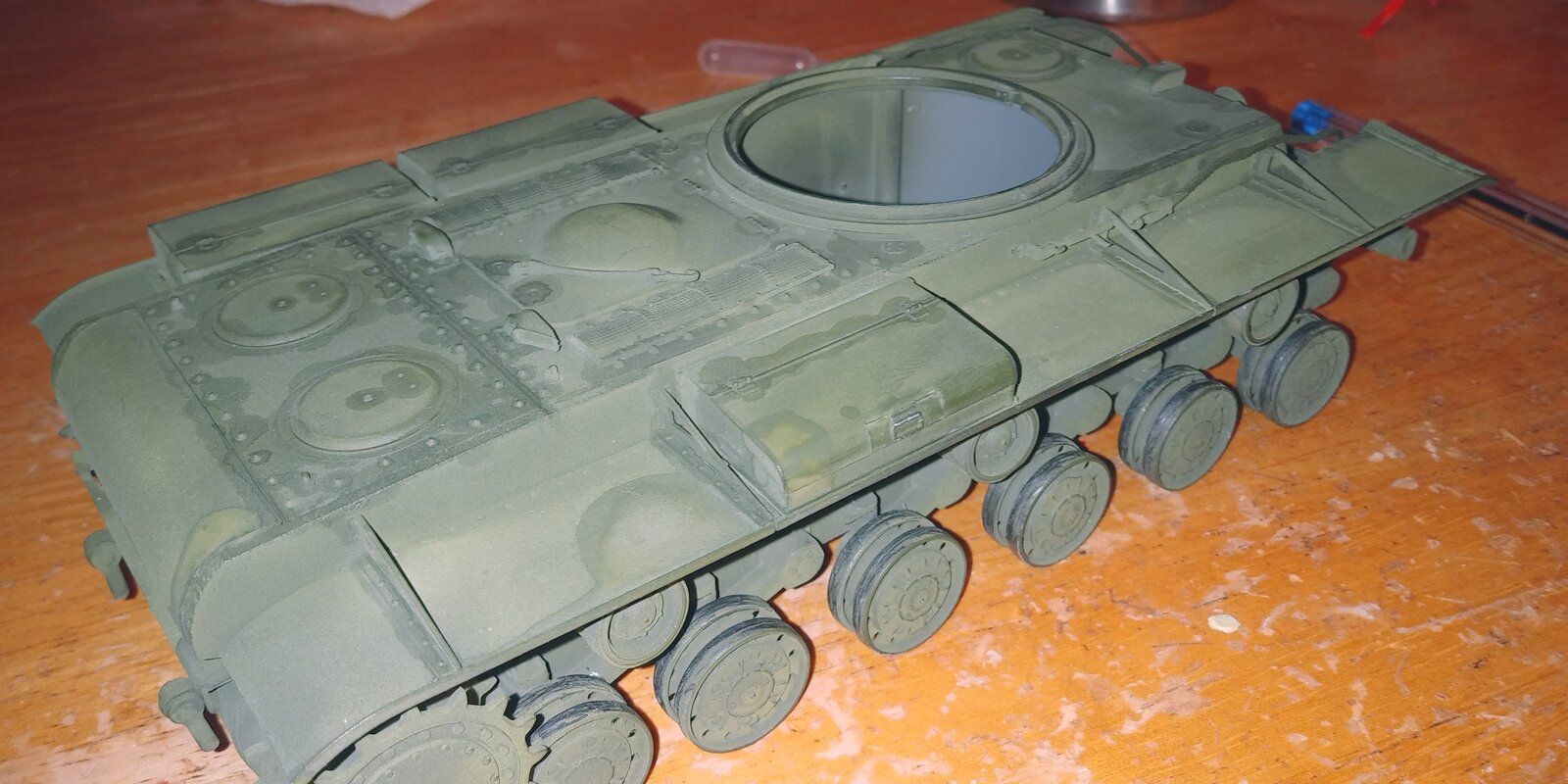

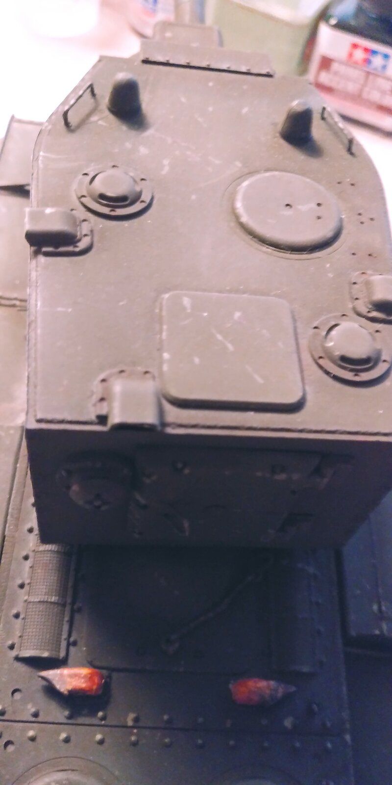

This is a pic of what the hull looks like after washing. I'm really leaning toward repainting the whole thing
You used water, did you? NEVER use water when weathering. I weather using chalk scraped with an Xacto knife - depending on color be it black, grey, rust, or whatever. Then I'll use a Q-tip or makeup swabs or a brush. Other weathering products I use are Tamiya Weathering Powders. Those come with a swab/brush.
Repaint instead of stripping the paint. You won't lose a lot of details on armor subjects if you spray in light coats - but not too heavily or too much. One or two light coats should be suffice.

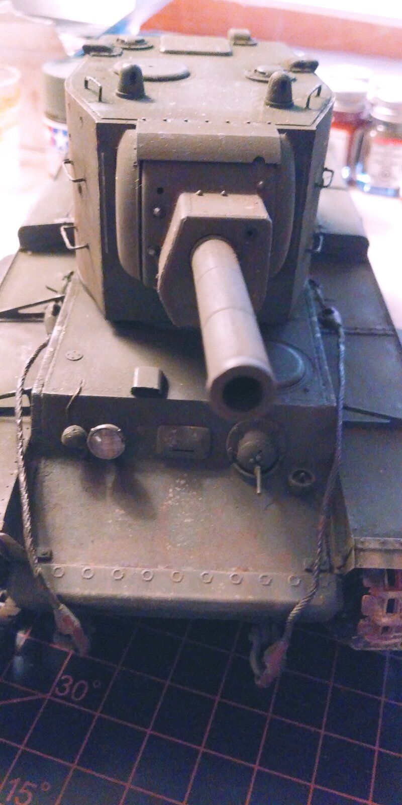

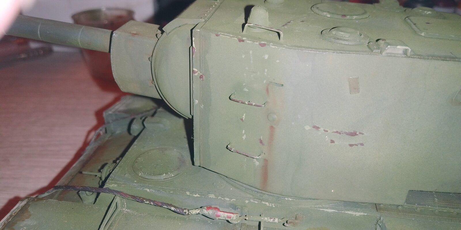

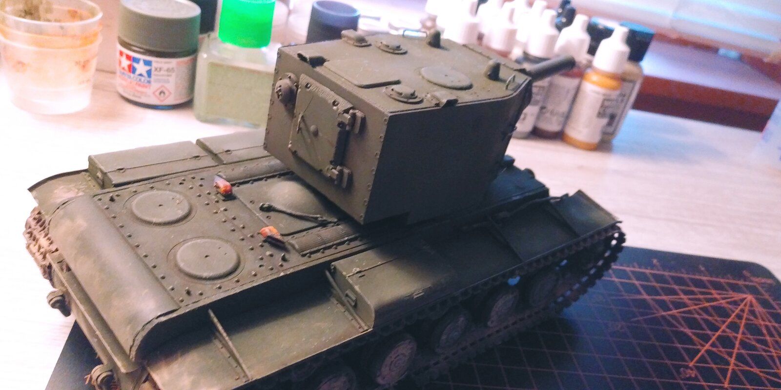

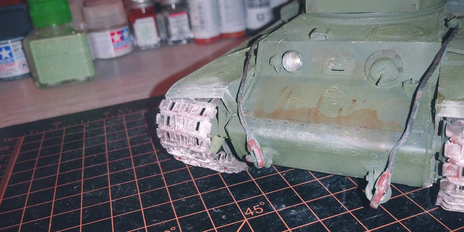

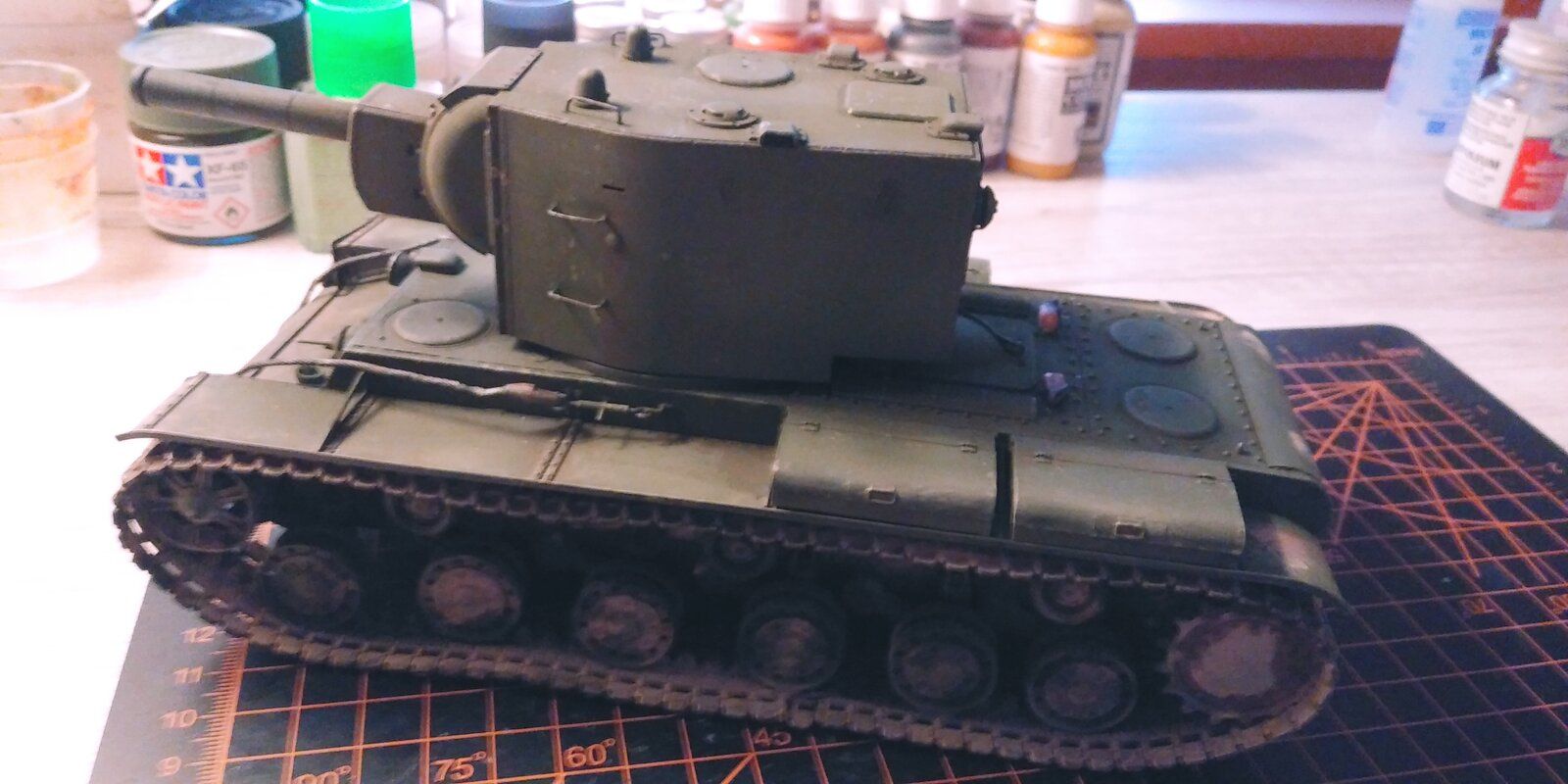

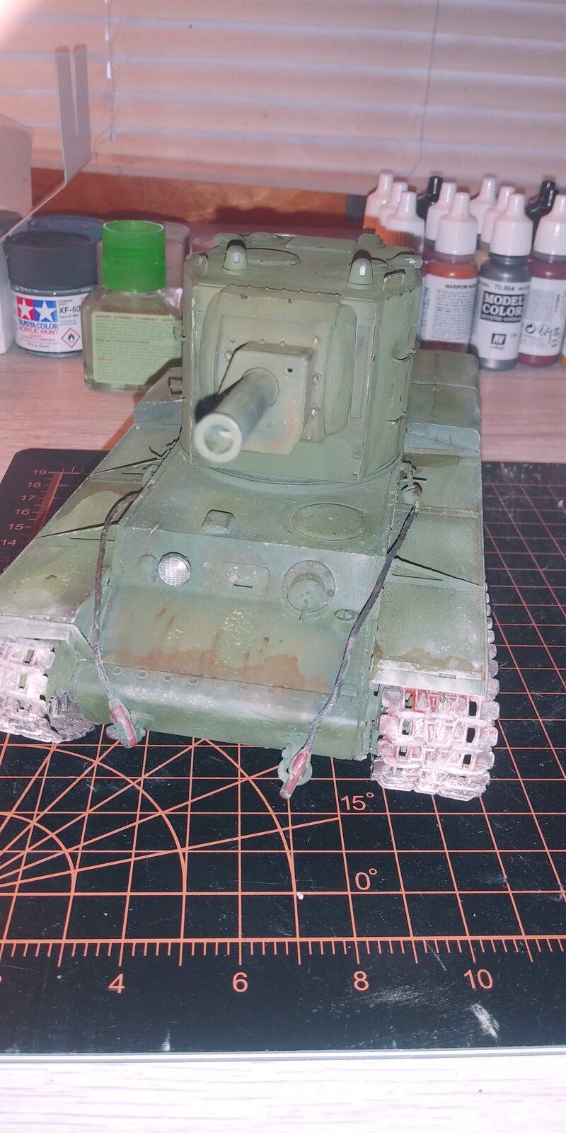

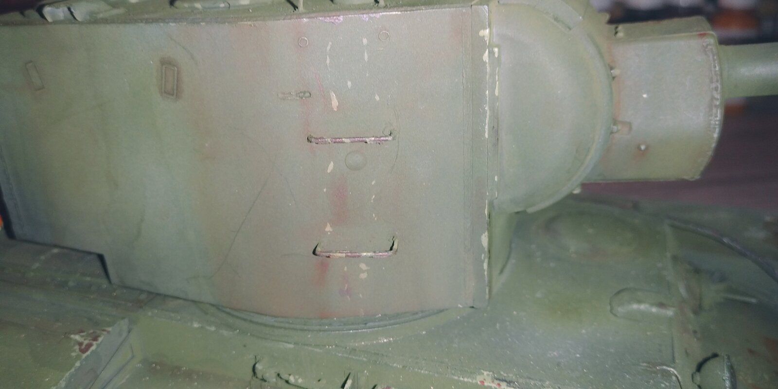

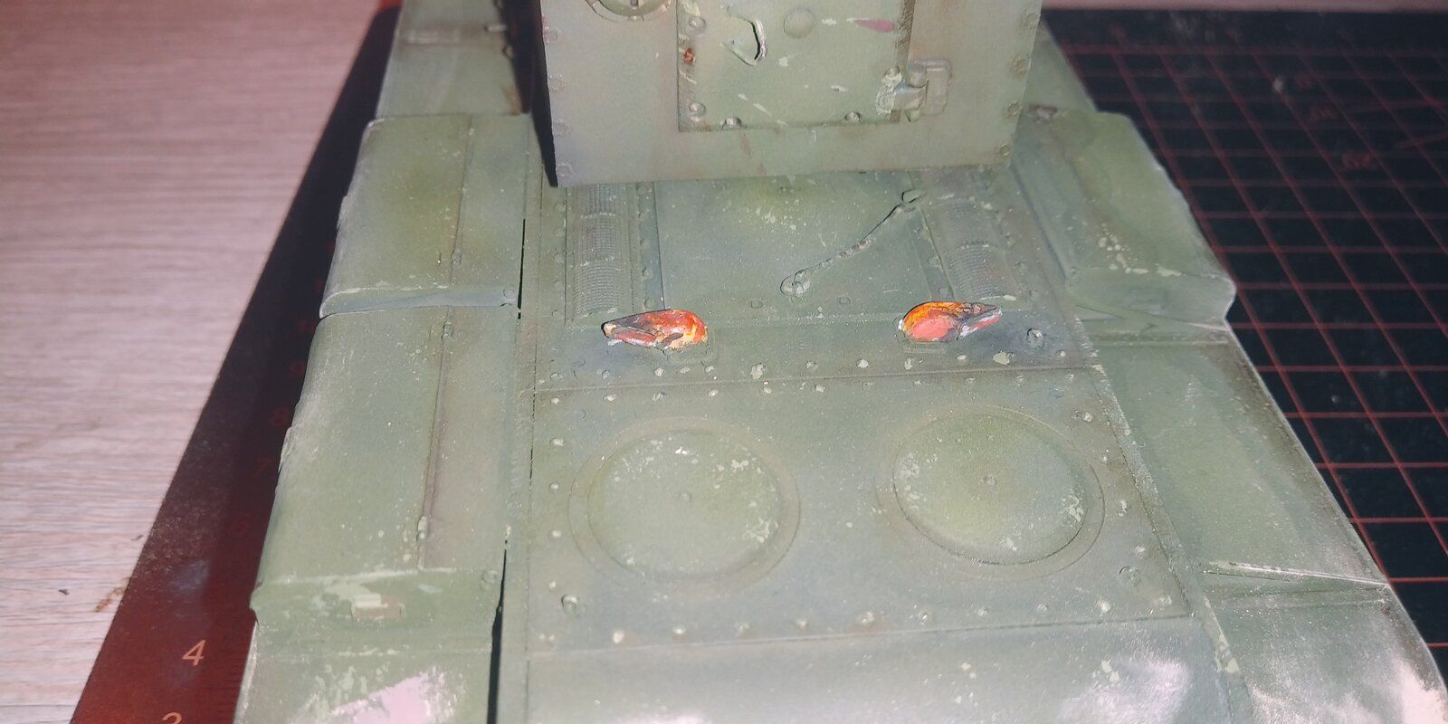

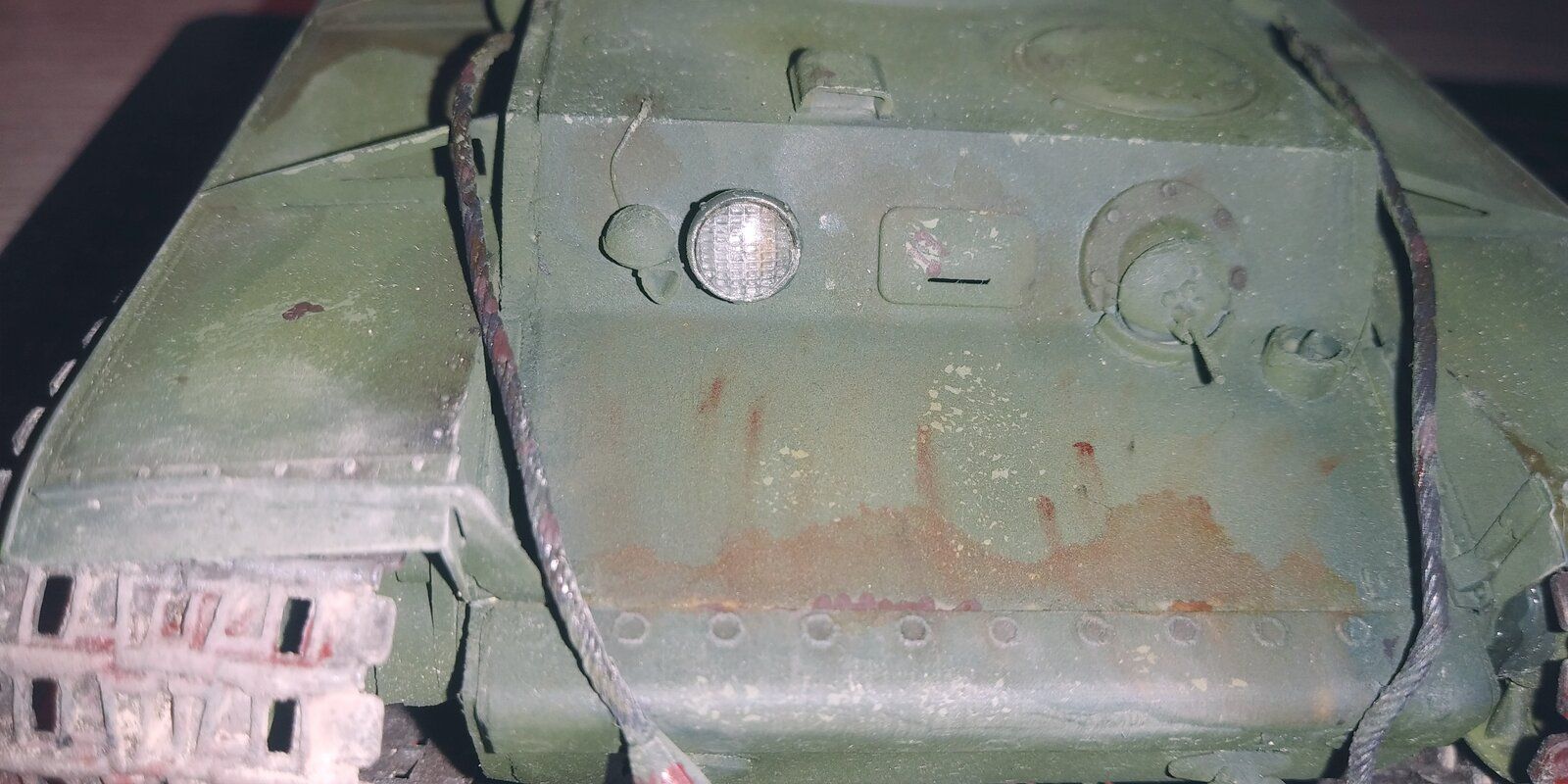

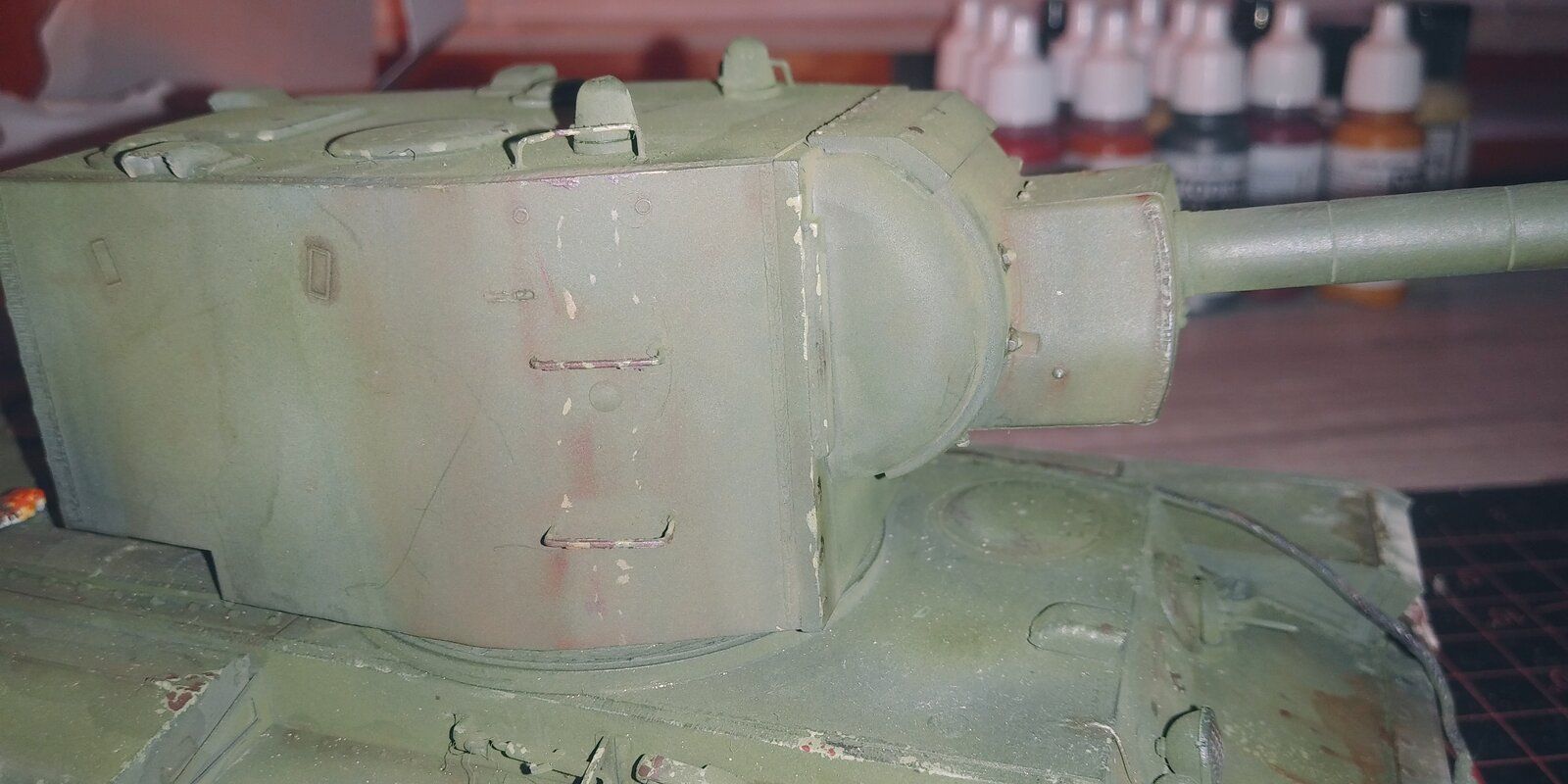

I repainted everything and basically started from scratch. Finished pics attached. I think I went overboard on the chipping/need to refine my technique
...but okay for 1st model in 30+ years.
Let me know what you all think. Thanks
