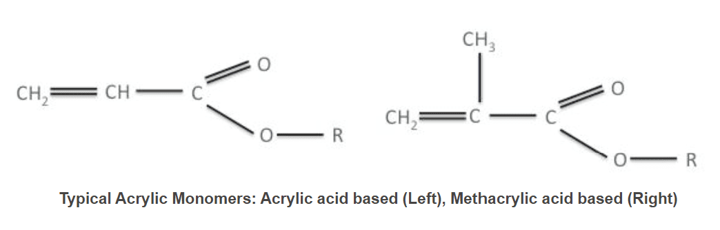

There's many types of acrylic resin .
Some are compatible with alcohols and ketones ( the chief ingredients in lacquer thinners ) and some are not .
They are referred to as " lacquer acrylics " or just lacquers or lacquer based . ( these aren't technical terms )
Enamels used in hobby paints are all alkyd resins .
Unlike acrylics they change chemically thru oxidation during cure .
https://coatings.specialchem.com/selection-guide/acrylic-resins

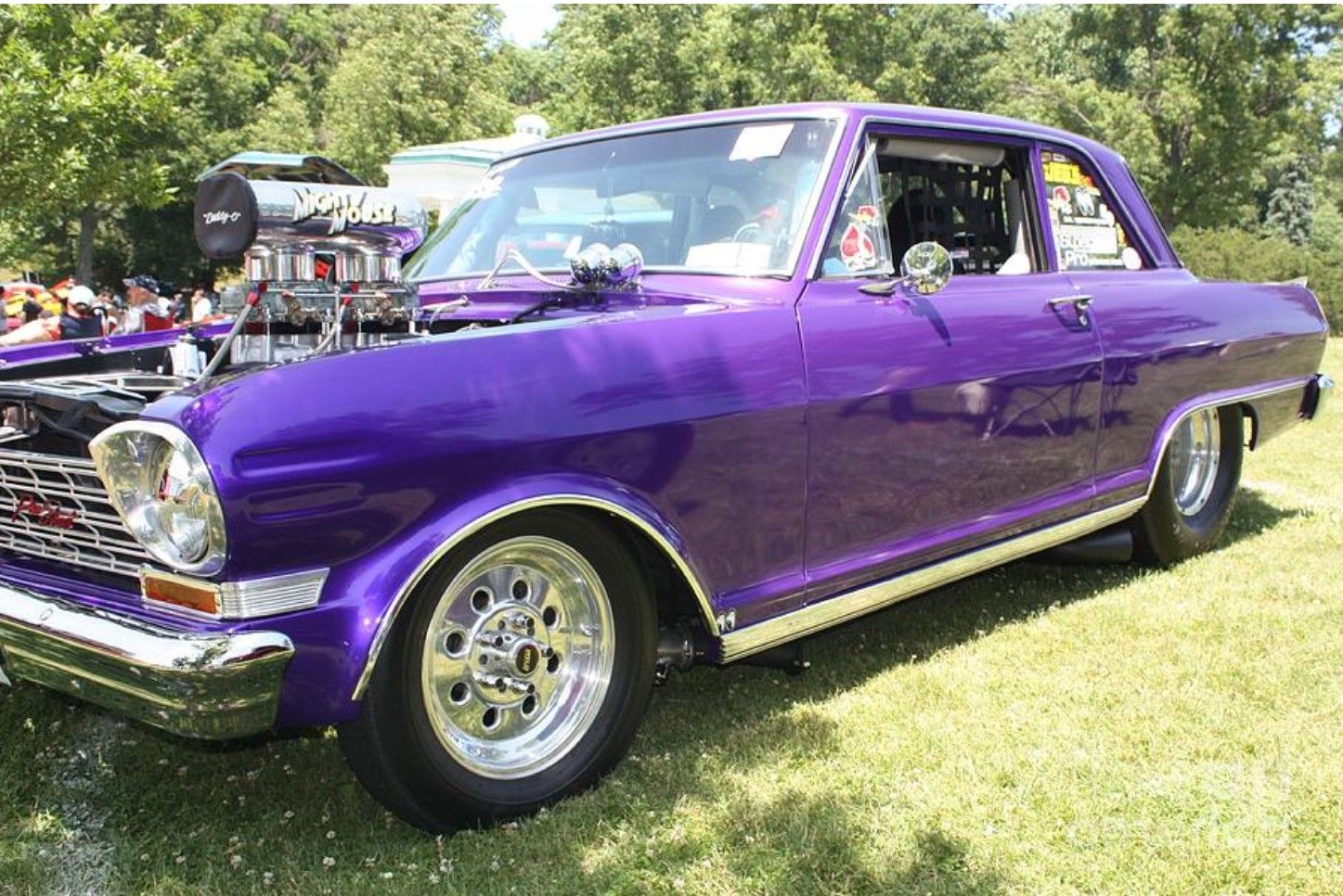

So at this moment these colors from MCW won't work out for a '64 Nova. Too bad. I'm digging on the purple. Is there a "Chevy" purple/lavender?
I know the cap does not tell the tale even in person. So I guess one has to take a guess. I'm not asking about any particular brand per se. Just looking for wisdom to educate my guess. Sadly I can't buy several to try out. Oh, then there's primer. Pink?

Mopar typically uses purple on their cars back then more than Chevy ever did. Either the MCW paint (even though it may not be an exact match) or the Testors One Coat Lacquer rattle can looks to be a close match.
I would use either white or silver basecoat for the purple you’re lookin* to achieve.
