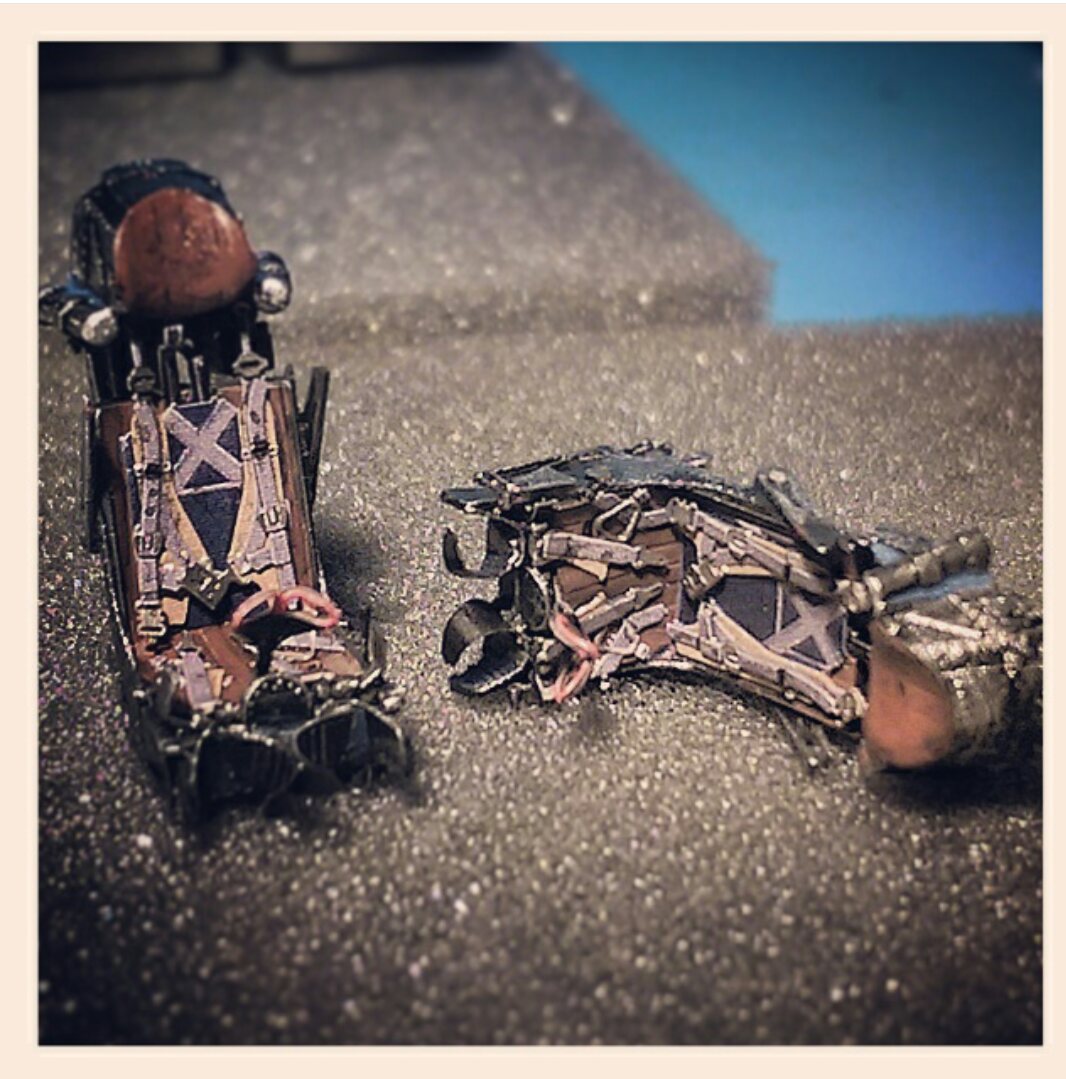

Bang seats. Lots of color PE work and some healthy dry brushing.

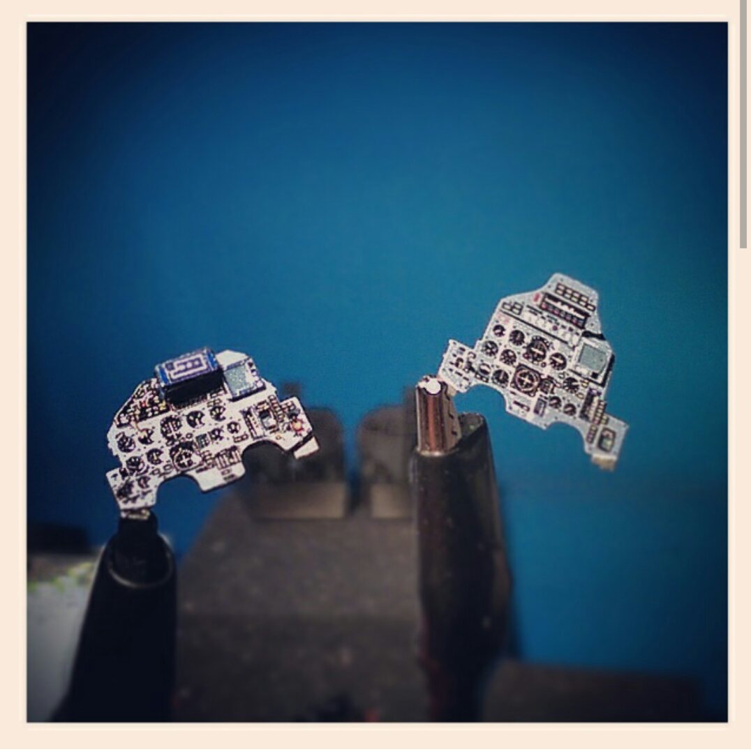

Instrument panels! Flat coated with AK matte then some Future in the dials.
