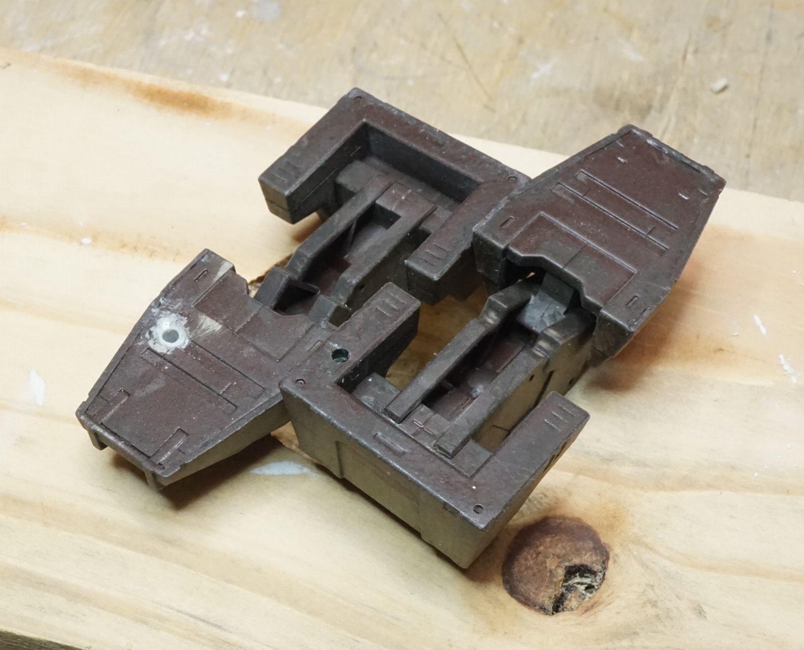

Quick update on this one .
I want it to resemble more a manga illustration than a scale model -- if that can be a thing .
A drop of that thinner when mixing the water color to break the surface tension , then affixed with the varnish when it looks right .
Multiple applications to build color .
These components below are pretty close to finished color-wise . KInda .
Flat coat when they are ready .
Minimal chipping where it makes sense ; at the feet and outboard on the legs etc .

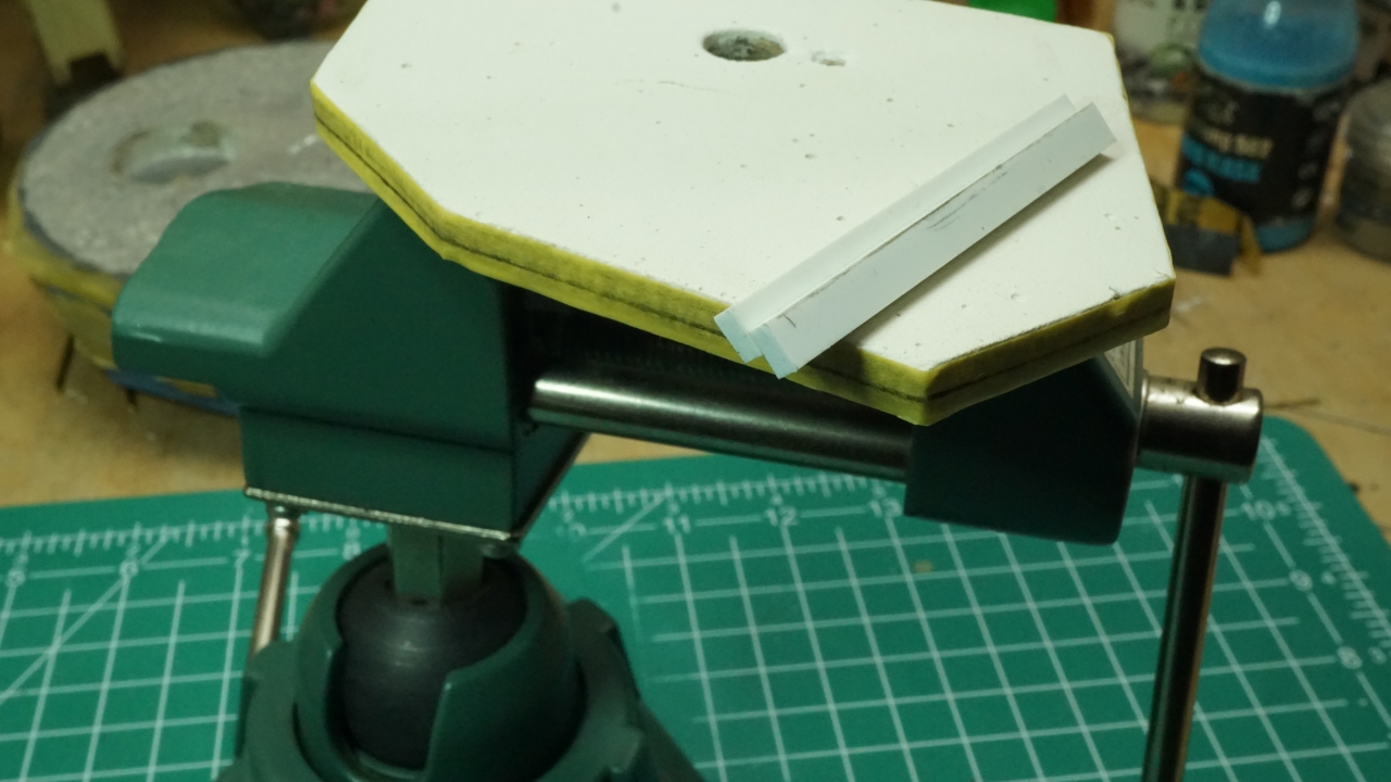

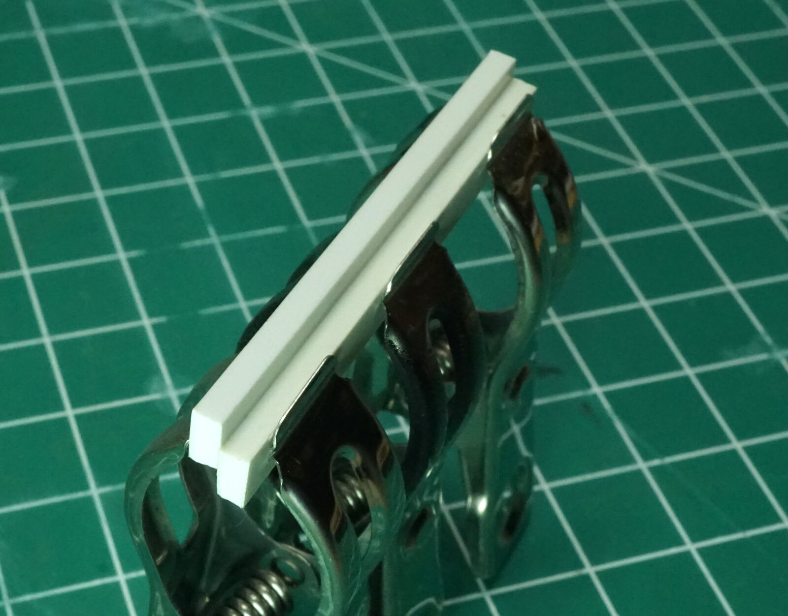

5 mm square polystyrene
10 degree cutting jig :
After it was primed , I discovered that the sides of the square stock were very slightly concave .
Tamiya lacquer putty used to correct this , then re-primed with Rustoleum alkyd primer :

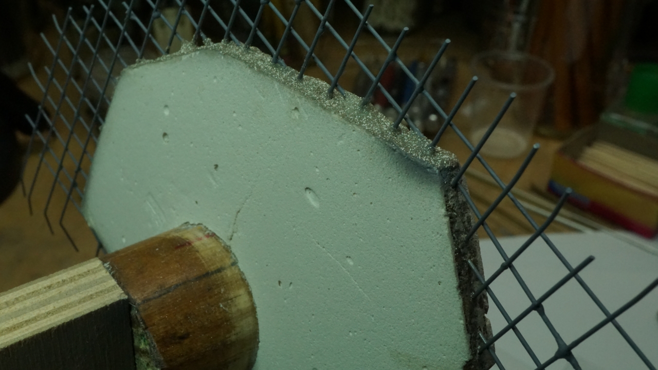

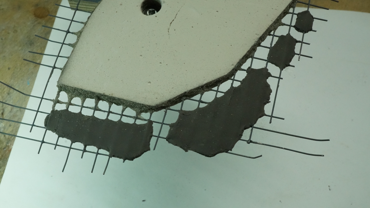

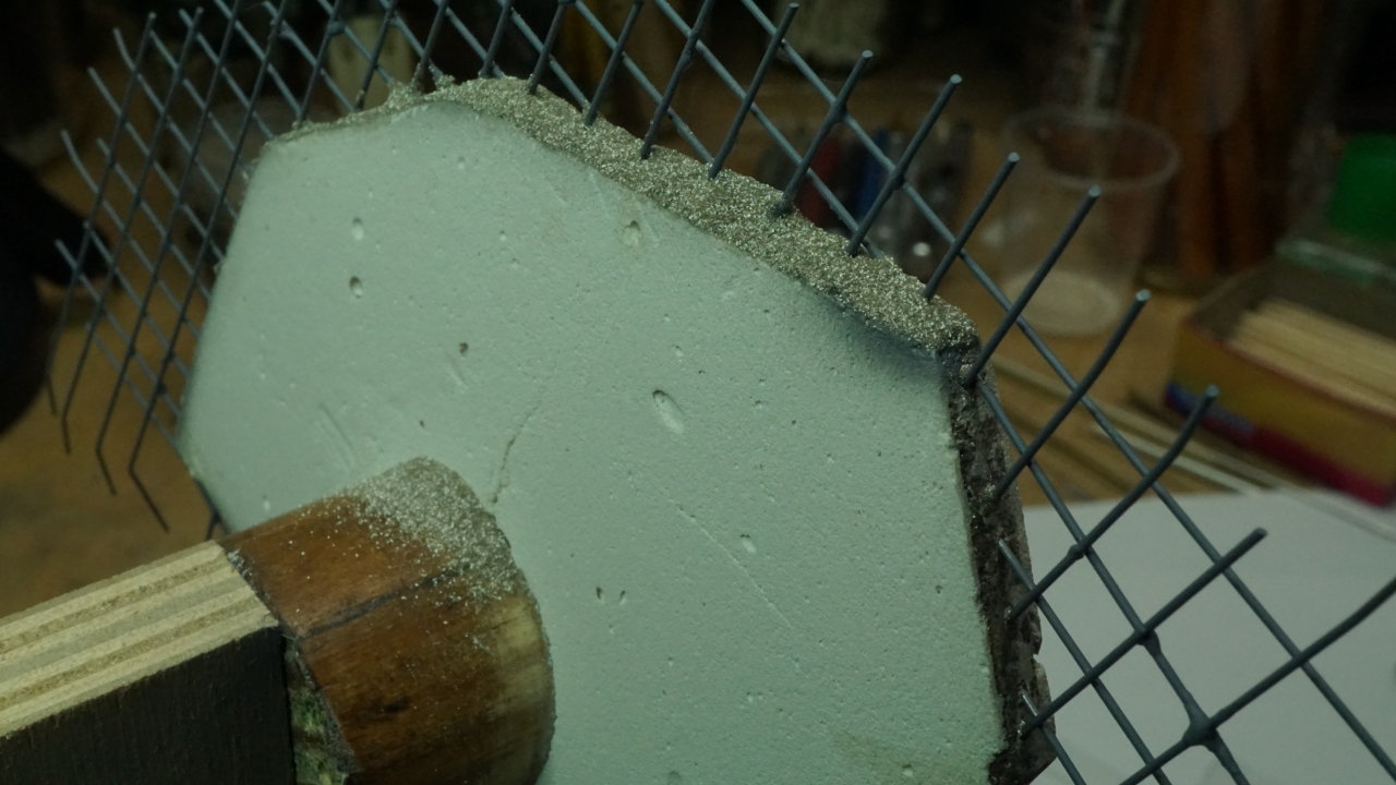

The groundwork / concrete will be drywall setting compound ( gypsum ) . The slabs will have a wood core ,, or possibly aluminum .
The broken concrete slabs he'll stand atop will cantilever out over the perimeter .
That entire " steel " border will remain visible .

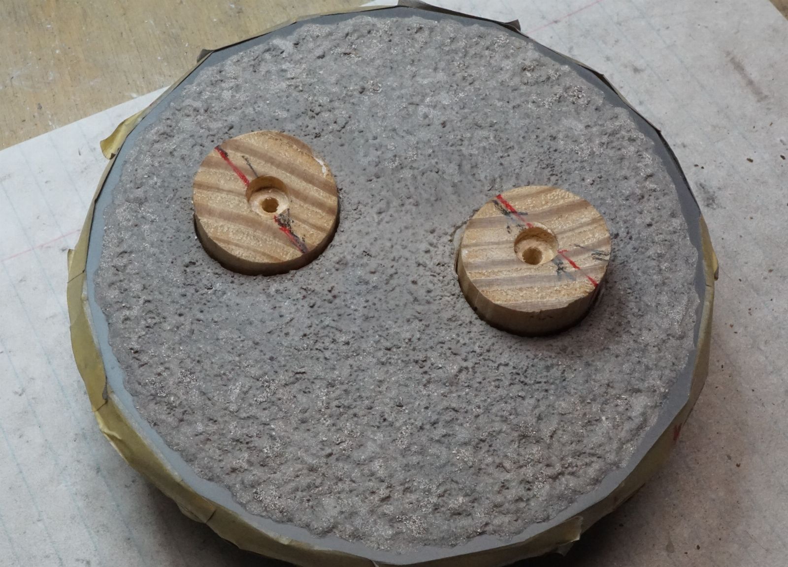

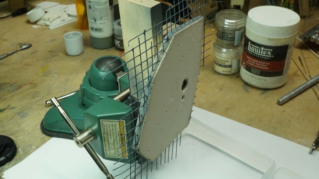

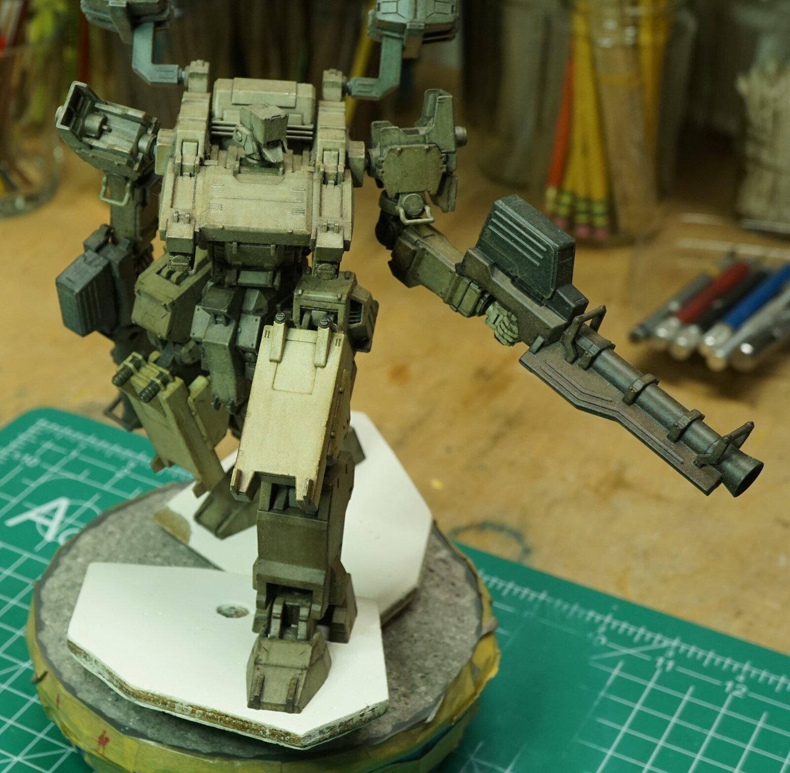

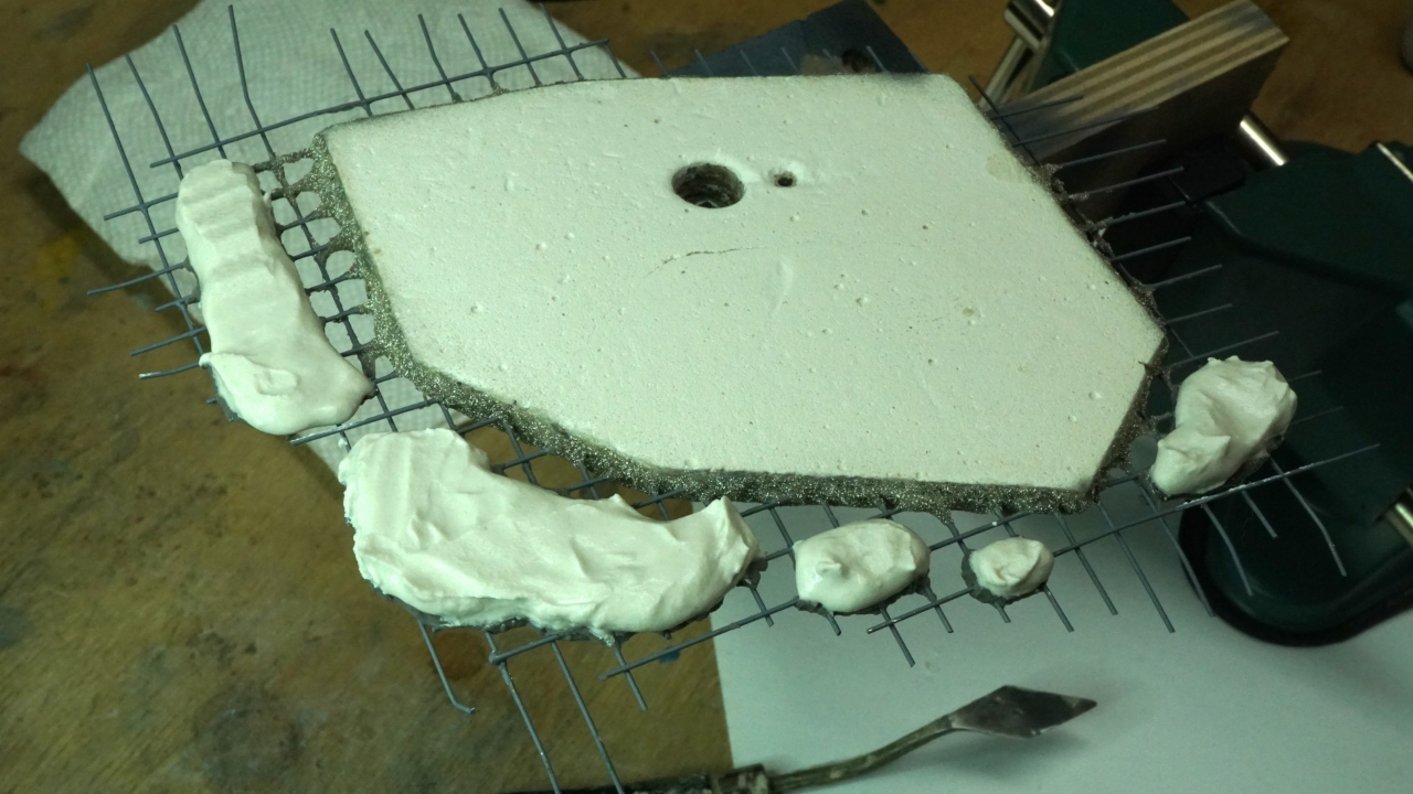

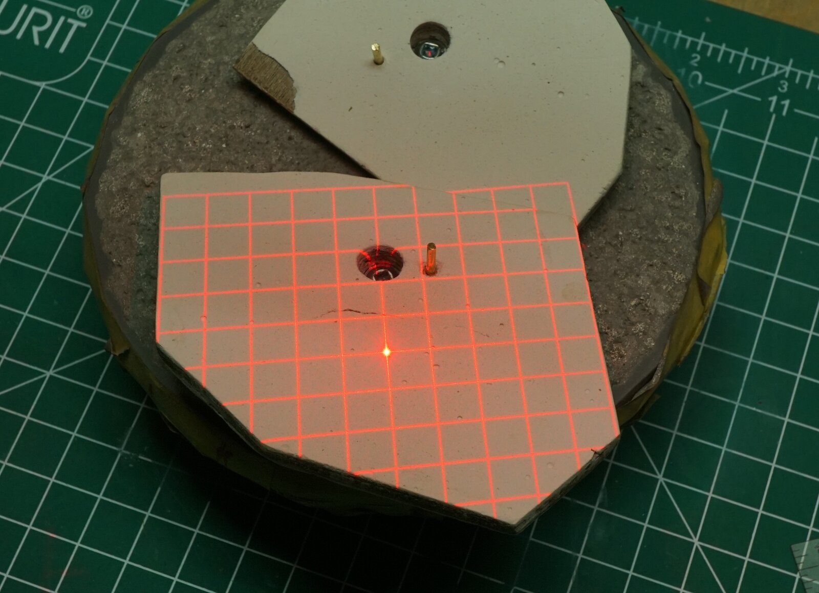

The dowel sections will support the 2 rectilinear concrete slabs he'll stand atop , then the exposed portions of the dowels will be hidden with more rubble . They were coated with Vaseline to prevent the gypsum bonding to them .

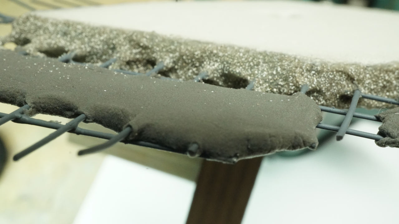

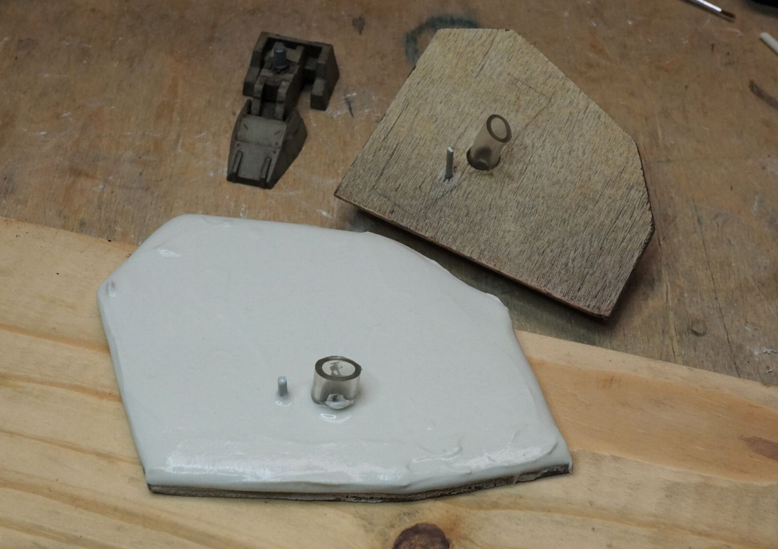

The slab cores will be 3/16 " plywood ( actually 5/32 " ) , and I have to build them separately so I can apply and finish the drywall compound on their undersides ... plus be able to more easily detail around all the rebar that will be sticking out .
They will require only the access hole for the mounting screw to be filled once in place .
The plinth was topped with drywall setting compound with a slight crown in elevation , then coated with multiple layers of powdered and broken pastels anchored with matte acrylic varnish ( Liquitex )

Just trying to catch up on this thread, looking really good, imho. This has more parts than my grandson's Lego kits, sheesh!
If I can add a constructive comment; I see only one thing missing on the battle damage and that would be chipped paint in the "high" action, wear areas. The weathering is looking real good, but I see no paint chipping.
You are braver man than I, let's just say that! Cheers, Ski.
Thanks !

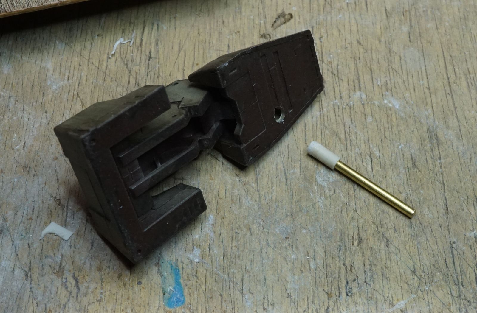

the chipping is coming -- Once I get him on the base , he'll be removable , I'll do the appropriate chipping around the feet / legs , where it makes sense . ( I mentioned this earlier in the thread - it's a big reason I use the alkyd primer so I can remove the acrylic with isopropyl and expose that burnt umber color ,, kinda the hairspray method without the hairspray ;) )
