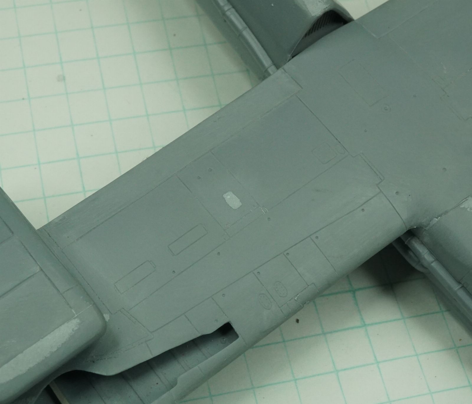

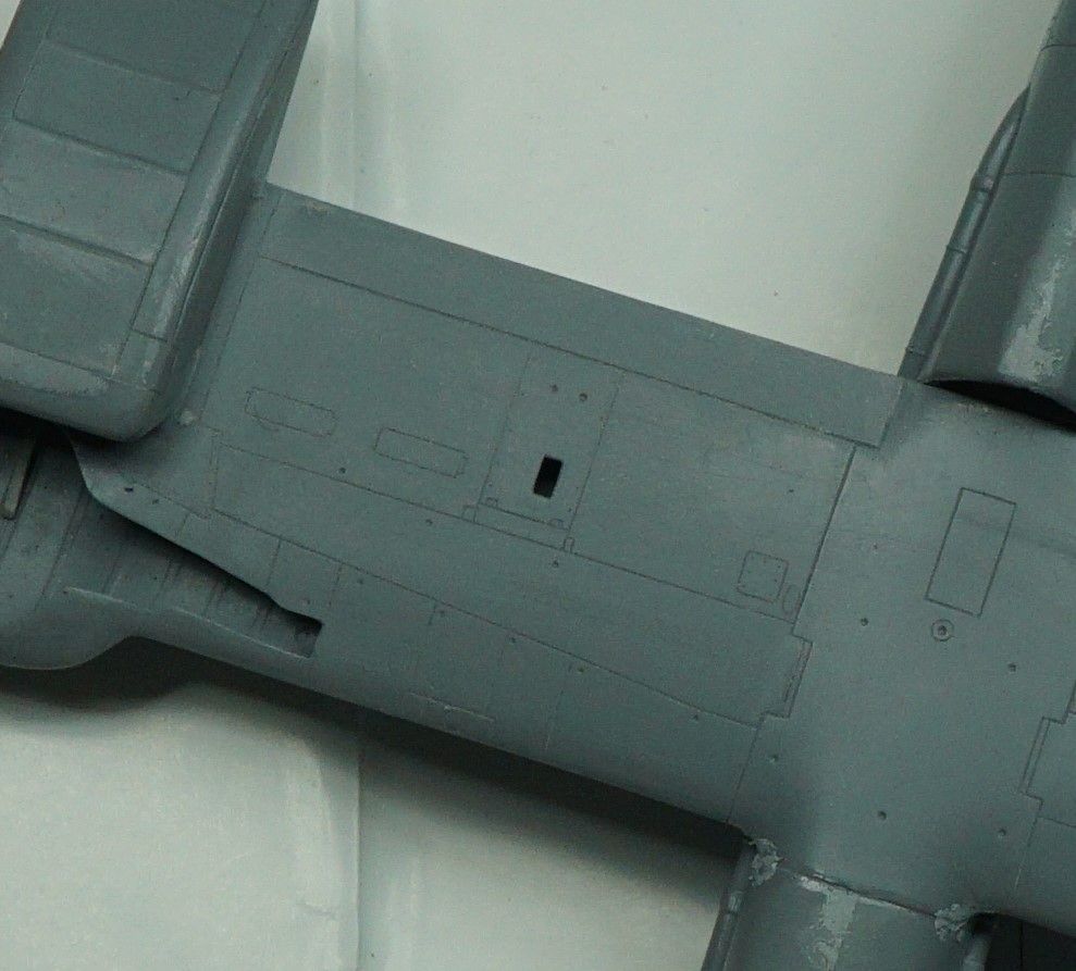

The bulk of this build is going to be putty'n and sanding seams and then restoring panel lines .

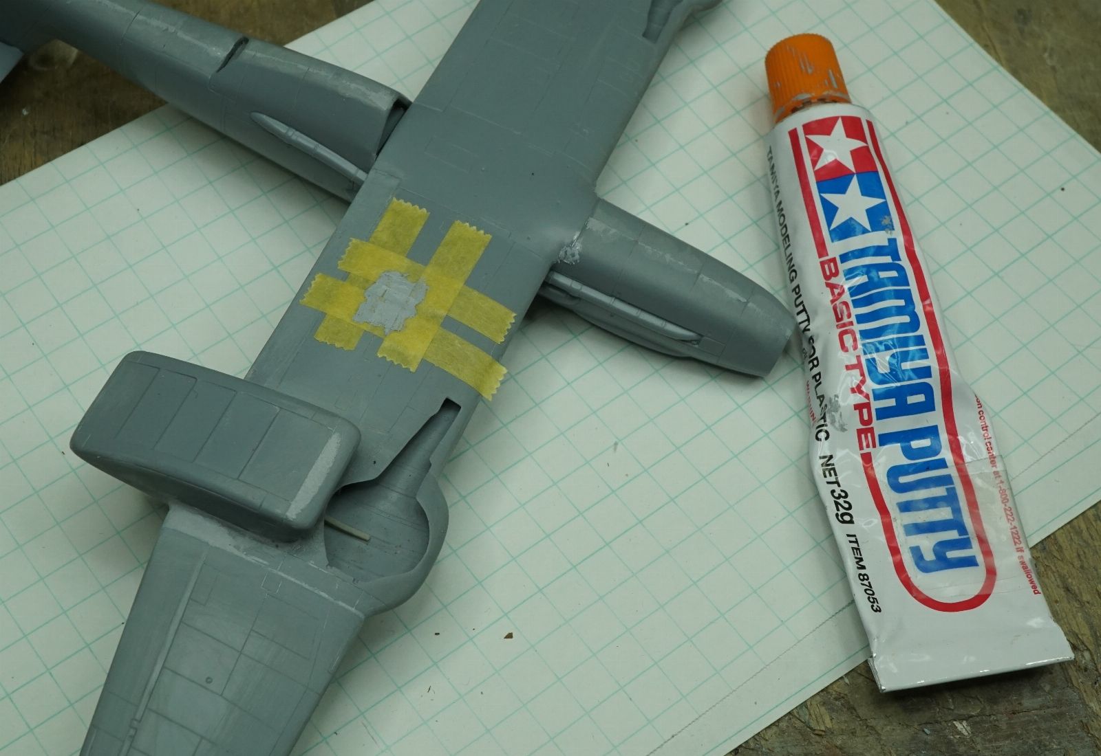

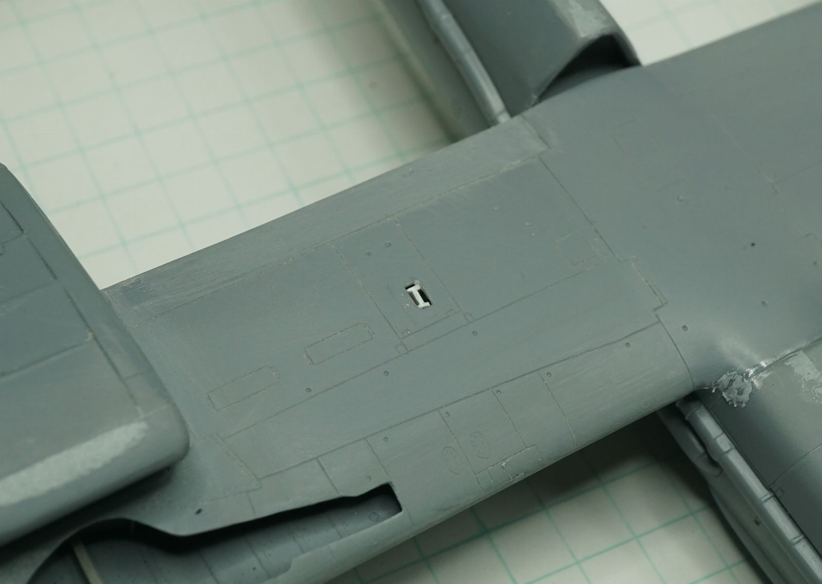

Today will be spent dealing with seams and panel lines ,
There was major-gappage around this intake for the supercharger .
I added some lacquer putty behind it prior to assembly so I could fill it in from the outside using acrylic medium .
Big improvement but it'll probably need more work after the primer hits it :

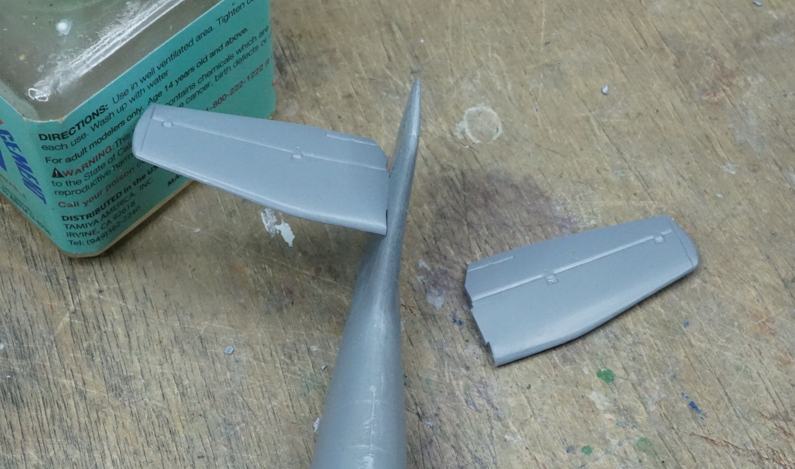

I had to remove maybe 3/4 of each positioning tab ( tenon ) from the horizontals to get them to snug up to the vertical , and they will still need putty :

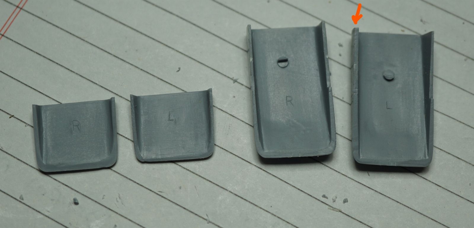

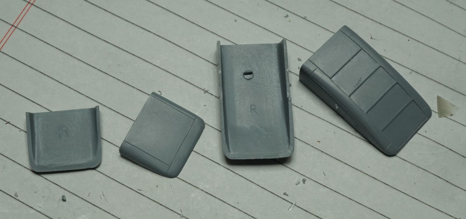

They marked these components for the radiators left and right , but I couldn't see a difference in them at first ,, ,, but the left side is 1/2 mm wider . Maybe .4 mm ,
You can see how the one side of the larger left section is thicker .
Weird .
LOL , who knows what happennated :D
.. with that extra thickness reciprocated on the wing for that left side :
Weird

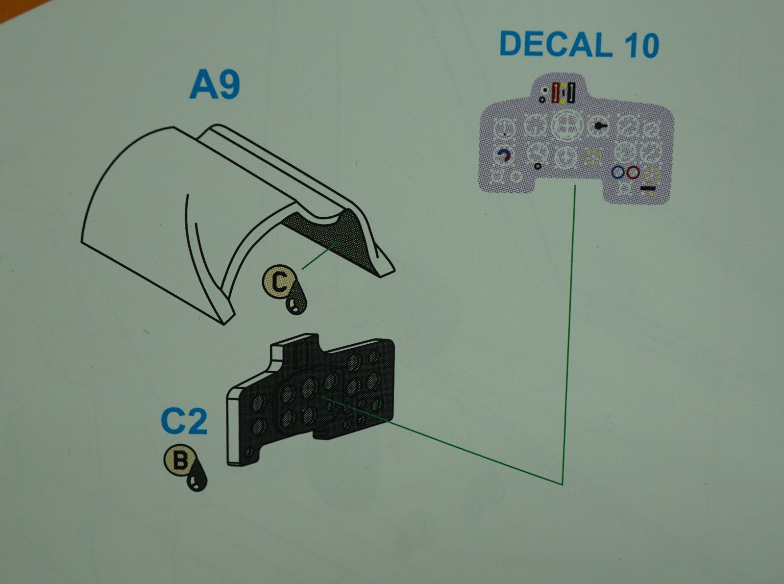

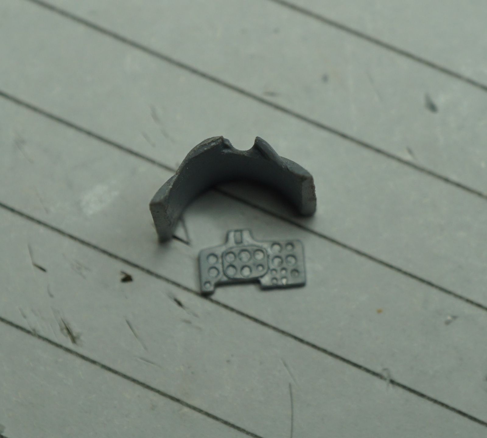

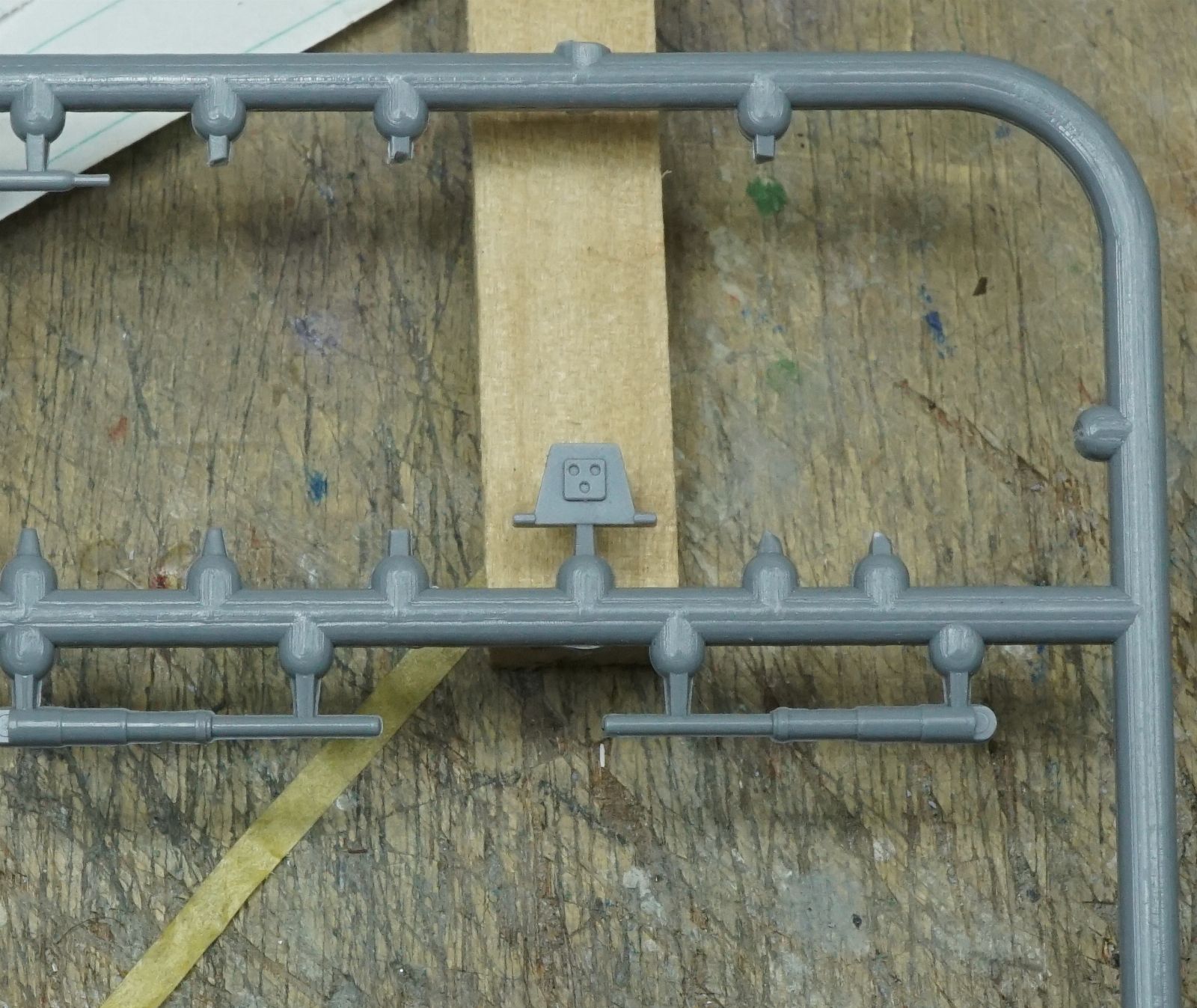

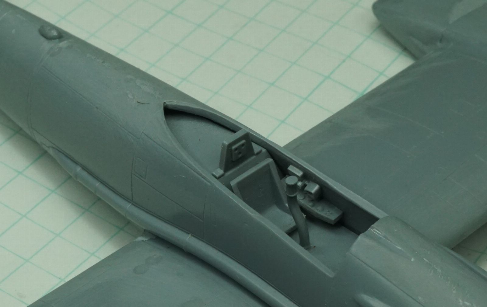

Just like I think they forgot the wheel well bulkheads when they designed the injection molds , I think they forgot a small bulkhead forward of the instrument panel .
The panel goes up into this cowling but it makes 2 points of contact .
Doable but weird :
The kit's plastic is solid & knives , sands and glues well .

Wow that cowling looks like it was found inside your vacuum after cleaning your work area....lol
The strange bird is taking shape
Strip styrene will take care of that. Strange aircraft, it's like a Condor and a Stuka got drunk one night and had an offspring!
Oh yeah , I can handle it .
