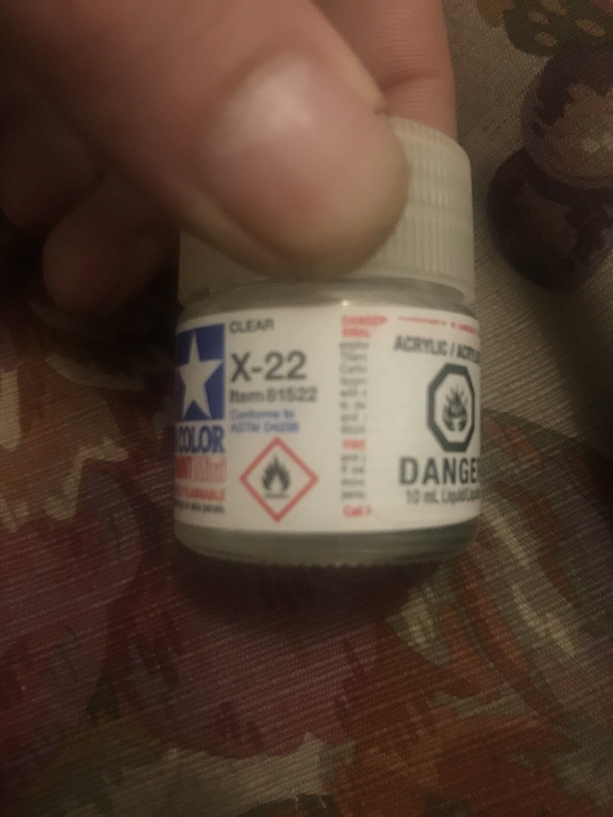

No i didnt thin it at all, its happening on the Tamiya De Havilland mosquito, as you can see from the photo this was a small area I did to test and you can see the paint striped right off
Is that plastic or the surfacer 1000 showing thru ?
That happened instantly ? or after repeated brushing ?

It was fully mixed ?
Stirred well so it was uniform ?
I have no idea how this is happening . It sounds like you're doing everything correctly .
The only thing I'm left with is the clear is not mixed well and you're brushing on mostly the alcohol / water vehicle for the resin ----------- but , judging by what you have said so far , I'm doubting that you didn't ensure the clear was completely homogenized .
... the color coat too .
It's possible you may have gotten a bad bottle of X-22? Perhaps some contamination of some other thinner or water? Those could be probable causes.
