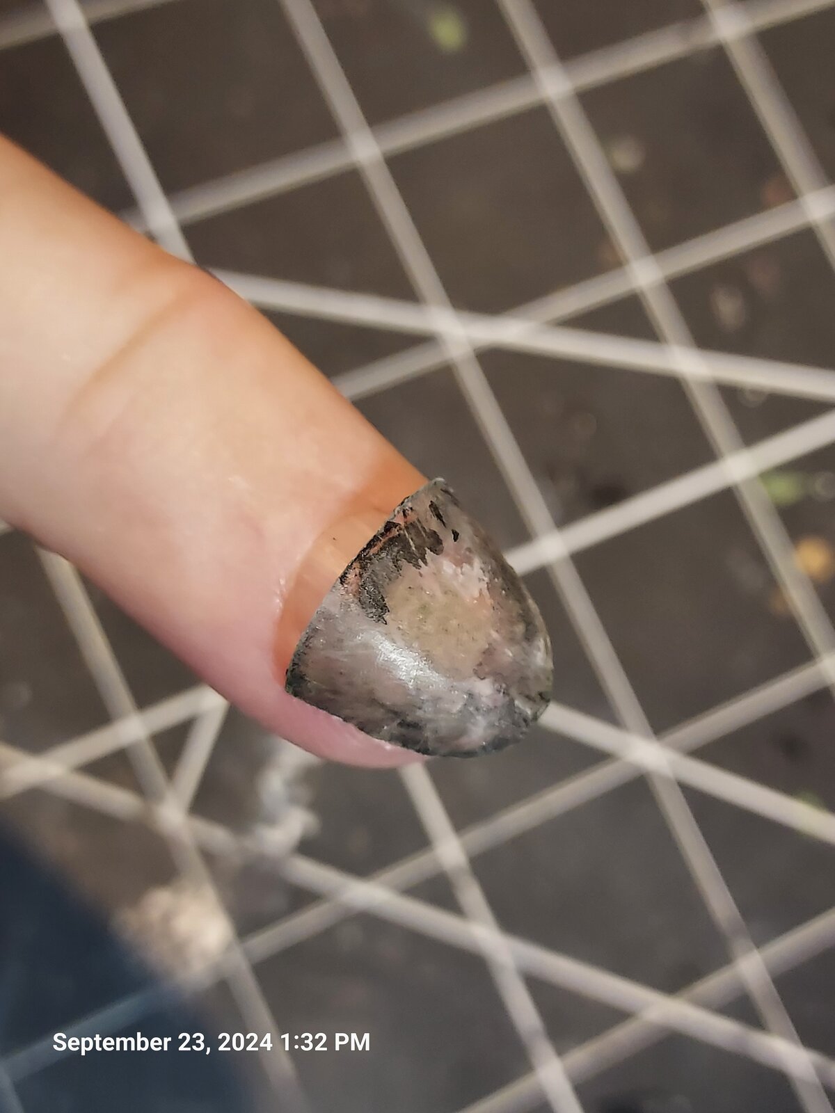

Thanks for the tip. I used a mix of Tamiya Chrome silver and Flat black. I was looking for a flat, weathered aluminum and feel it's reasonably close.
AI said to try hand sanizer, did not work. If i cant make my own sodium hydroxide or buy it at the store, ill go find me a clear fake fingernail and shape it lol
hmmm i have baking soda..
