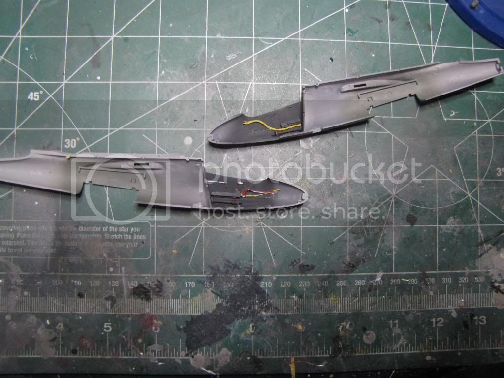

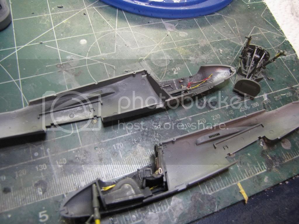

First off, I have been working on the cockpit. The instrument panel and scratch built seat belts where the biggest challenge but both turned out acceptable. Except for some interior weathering , cockpit and wheel well painting is done.

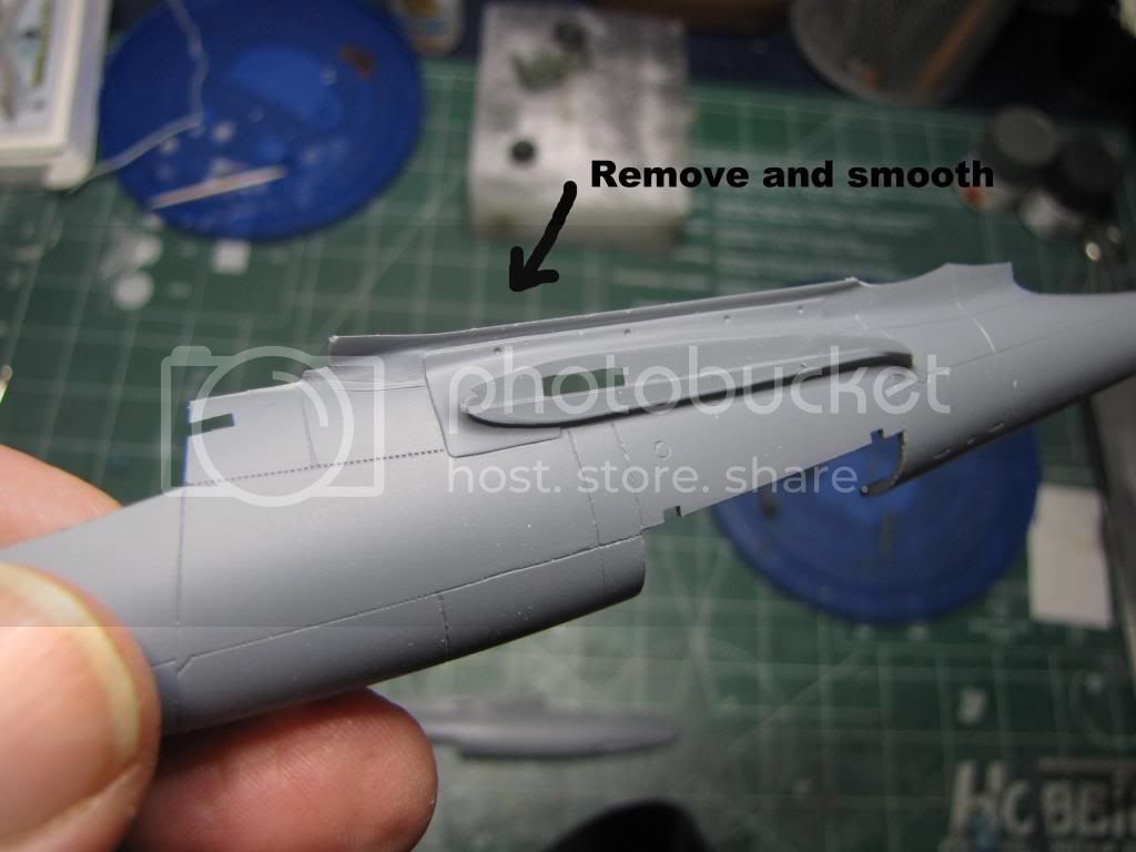

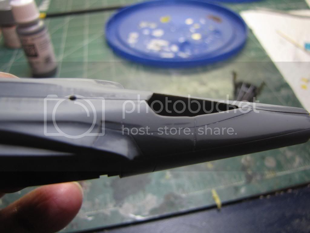

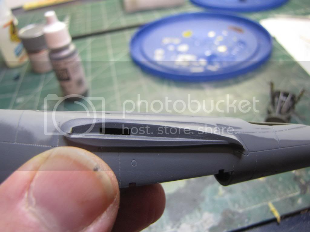

Now for the fun. I am just getting into removing the BMW engine mount on the top of the fuselage. A combination of cutting with my motor tool, grinding and sanding has got the right side close to were I want it. I am just about to start on the left fuselage.
Talk to you all soon!

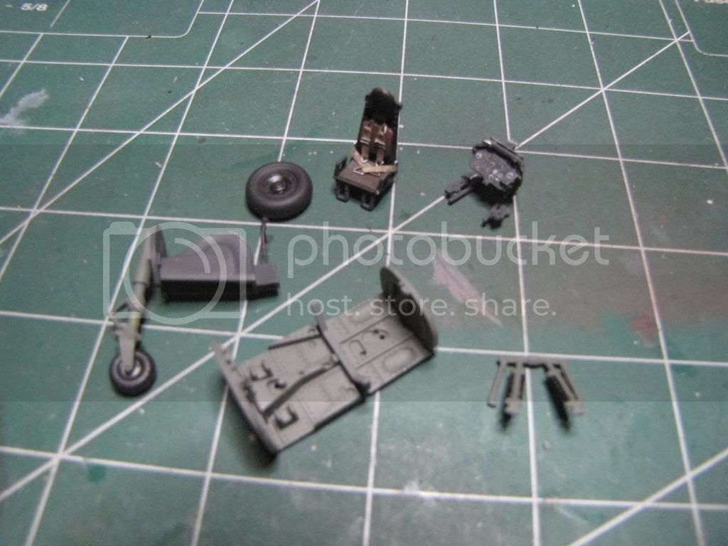

I have detailed the cockpit and wheel wells. There are some tiny pieces in the wells! I have also removed much of the engine / fuselage connection. I will be building up a bit of the fuselage directly over the wing and the hole that came out as a result of the removal. Any suggestions for repairing this hole will be welcome!

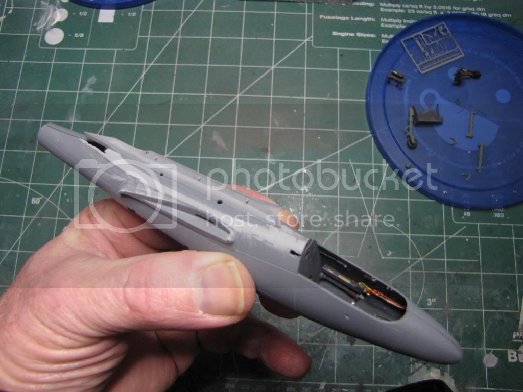

Work continues on the He 162 conversion. In this update we put the fuselage together.

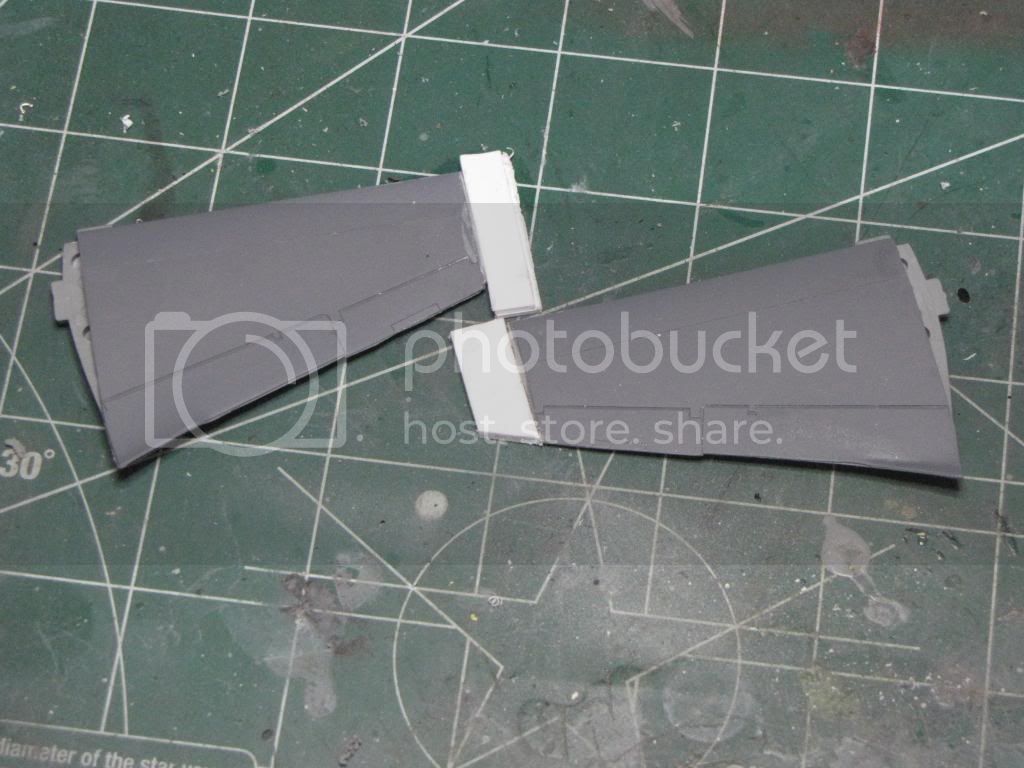

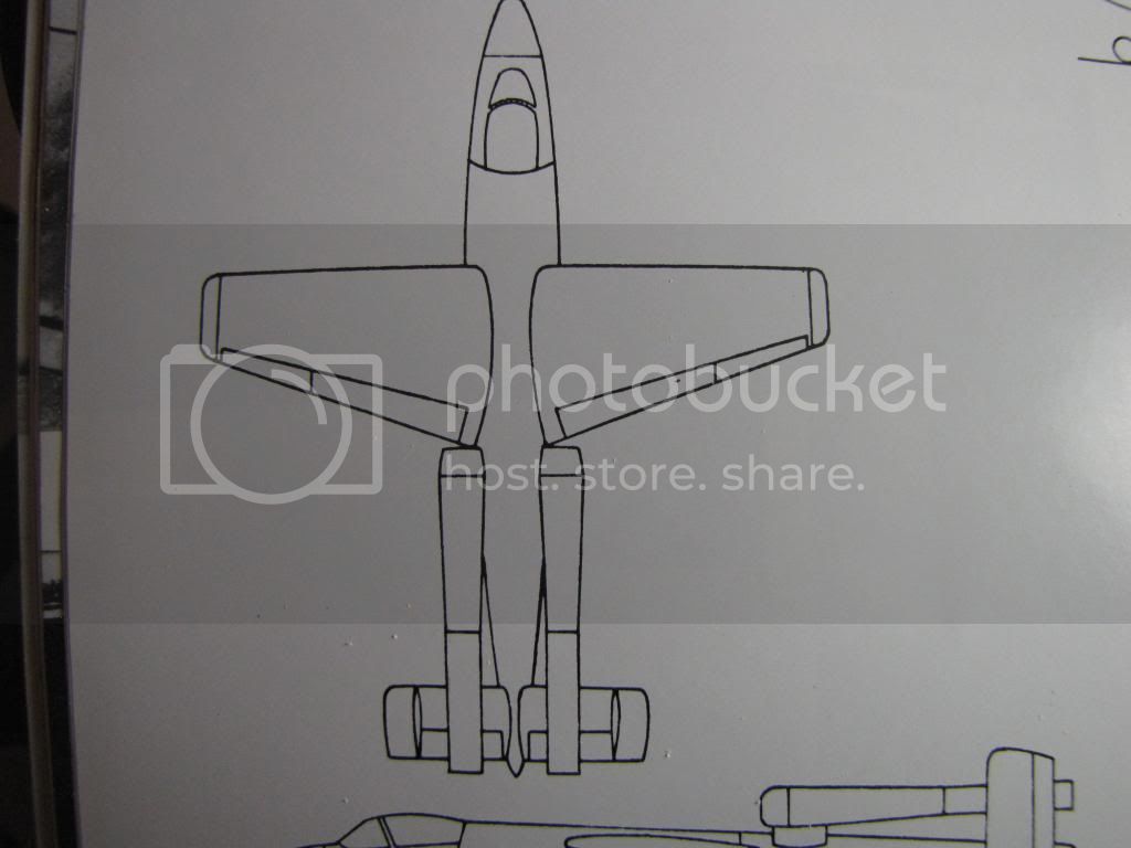

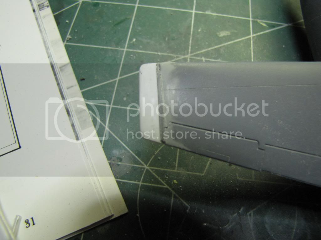

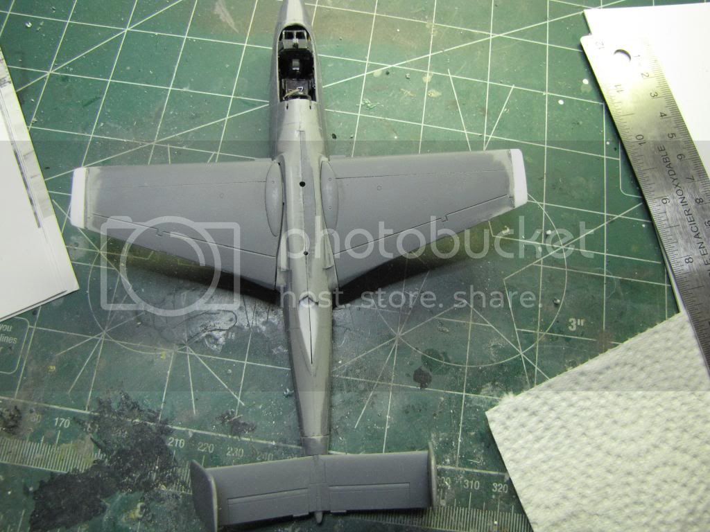

I have done some work on the wingtips. The supplied wings had the drop version that was featured on most 162s but the A -10 had flat wingtips with a bit more squared look to them. I used a saw to cut off the originals. I replaced the tips with some plasticard. The resulting shape matches up nicely with my reference drawing. Since taking these pictures I painted a coat of Mr. Surfacer 500 over the joins to smooth them off. They are just waiting for a little sanding and rescribing.
I doubled up the plasticard to get the right thickness.
After some sanding and shaping.
Reference drawing.
Taking shape!

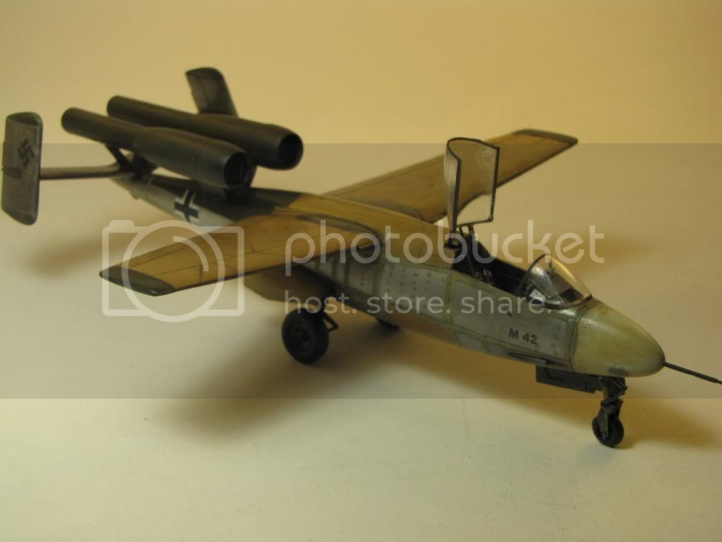

Yet another update... we are finished with the fuselage.
https://www.youtube.com/watch?v=ZwewhWuQ8iQ&

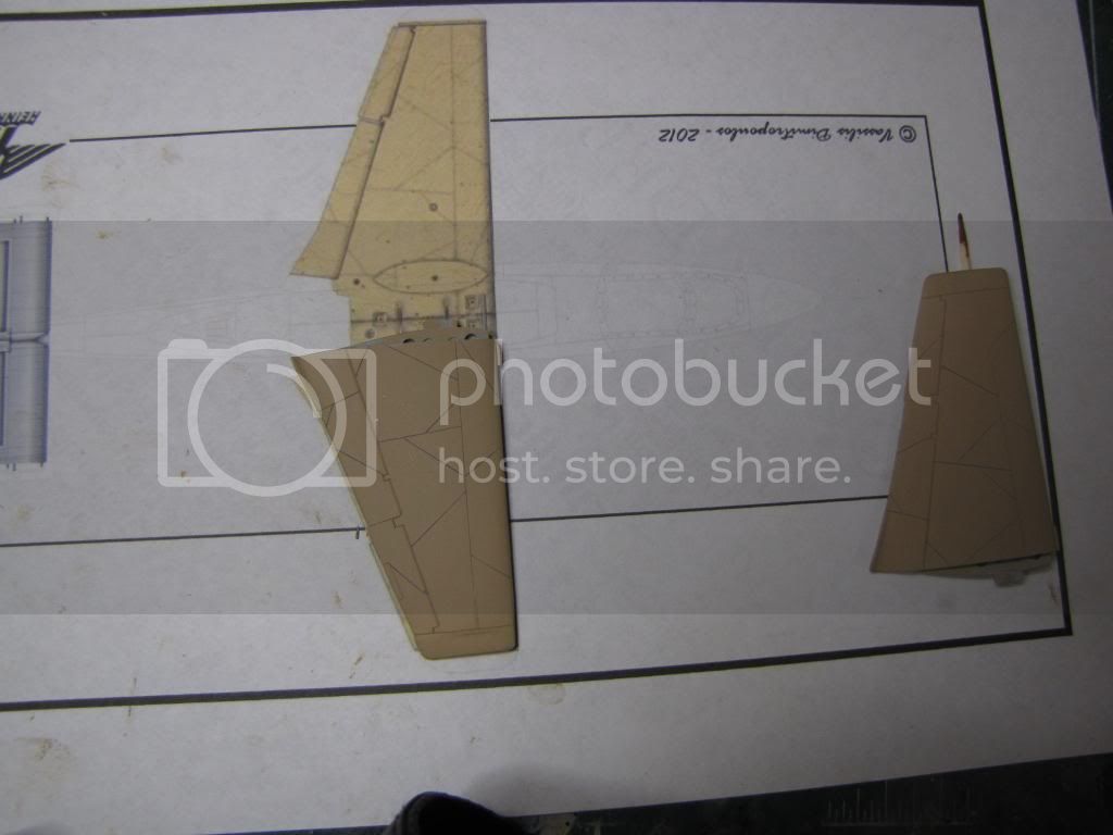

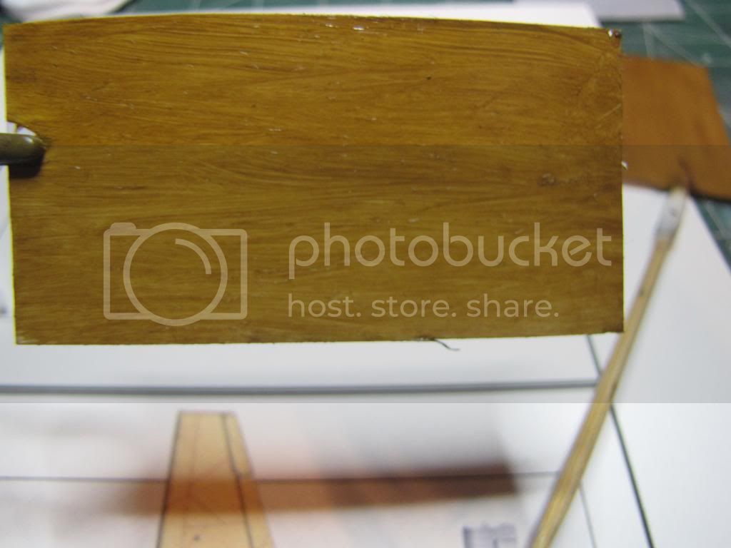

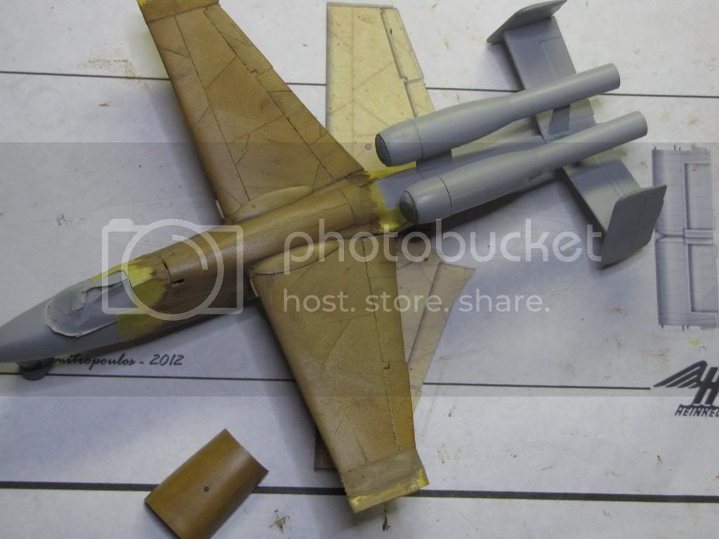

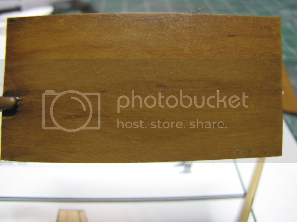

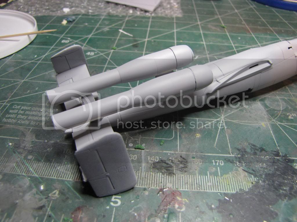

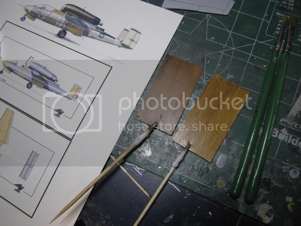

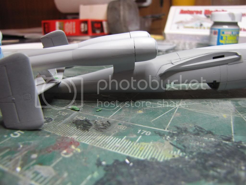

The pulse jet engines have been installed. It was a little tricky getting them lined up and I have a bit of detail sanding to do but overall they are done. I have also been fooling around with some wood-grain finishes. The He 162 featured a lot of plywood, especially the wings. I have decided to paint this prototype version as being nearly complete and partially painted so some wood and aluminium will be showing. The tests that I did were following a tutorial I had found on line. They turned out okay but I need to lighten up the finished product to look more blond.
The pics are some test pieces I painted on plasticard. The results are pleasing but too dark as you can see in the picture with the reference pics in the background. I am going to pick up some lighter tan or yellow oil paints today to see if I can match those lighter tones in the references.

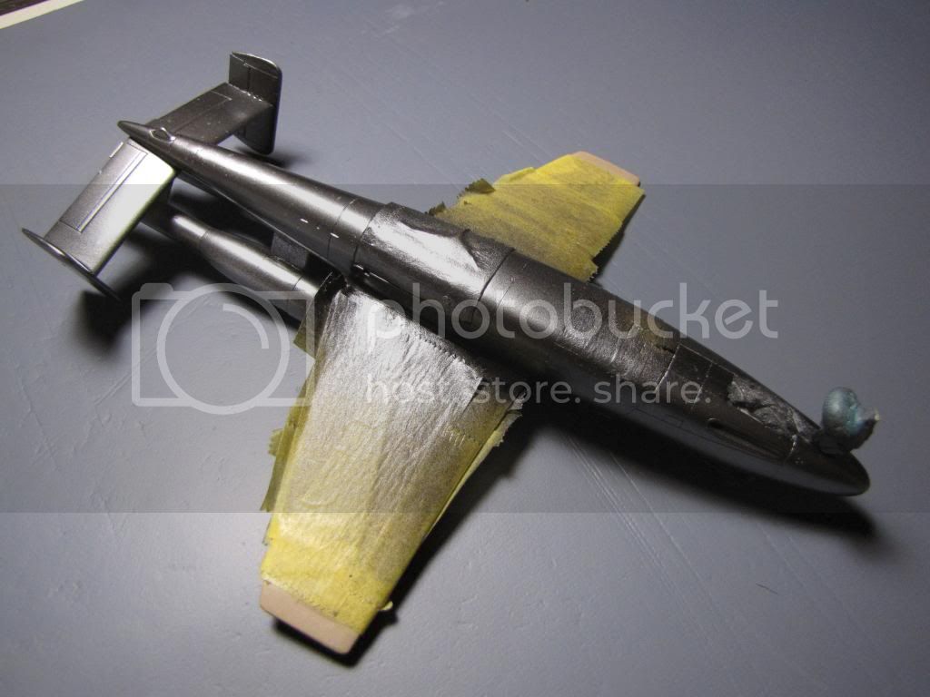

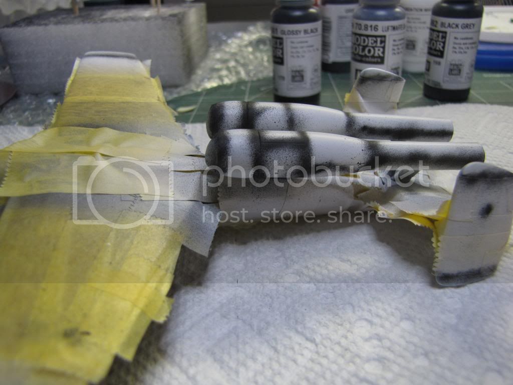

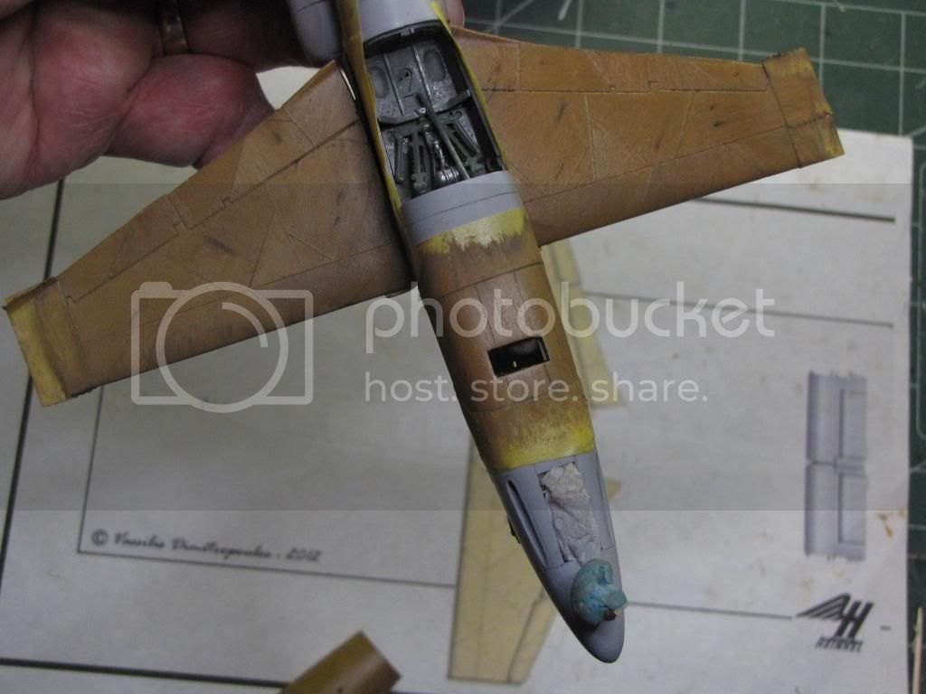

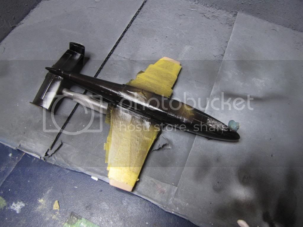

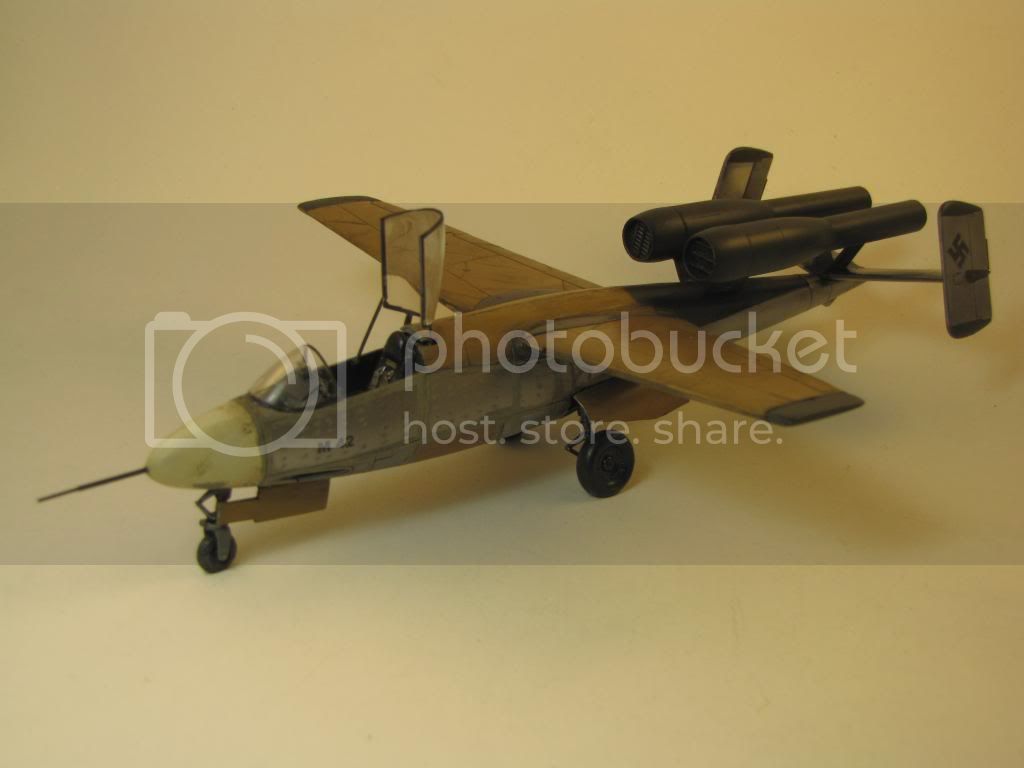

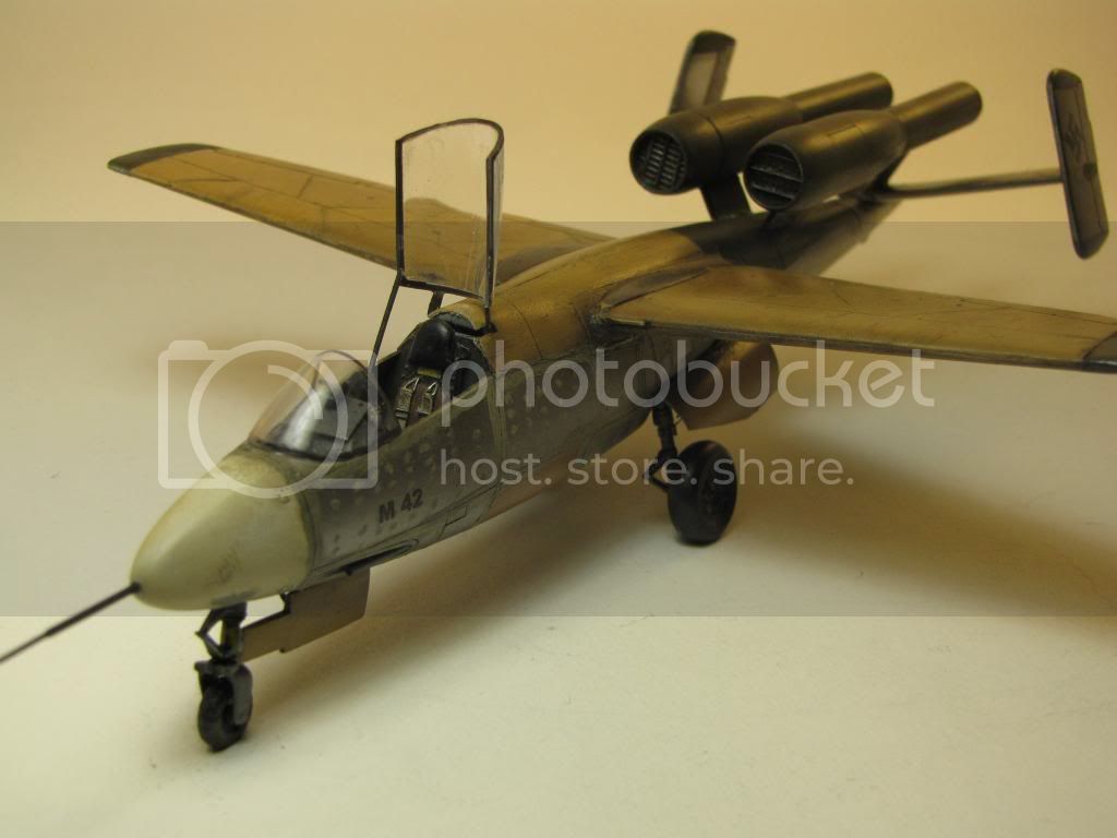

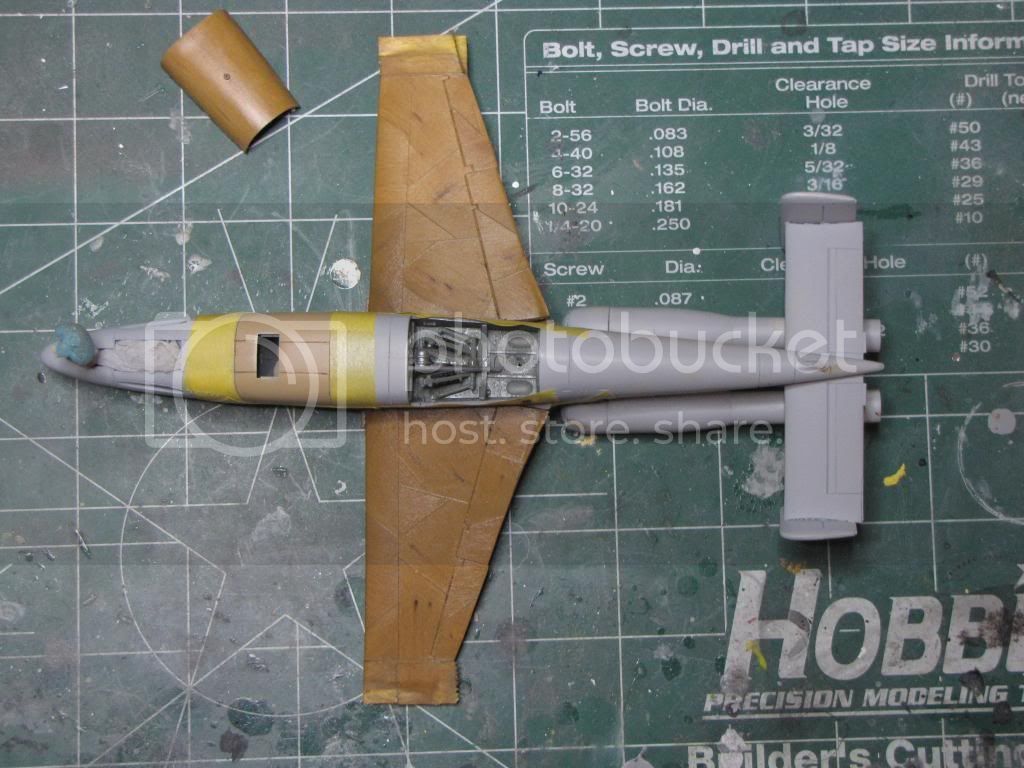

Painting has been coming together over the weekend. Last week, after scribing the plywood edges on the wings I got the wood down on them and lower fuselage. I waited 3 days for the oils to dry and then covered it with a Future/isopropyl alcohol mix and gave that a couple of days. Yesterday I sprayed a black undercoat and then today put down Alclad Duraluminium, and Chrome. I masked that all off and primed the pulsejets and wingtips. After preshading those areas I used Tamiya XF-61 to finish them off.
