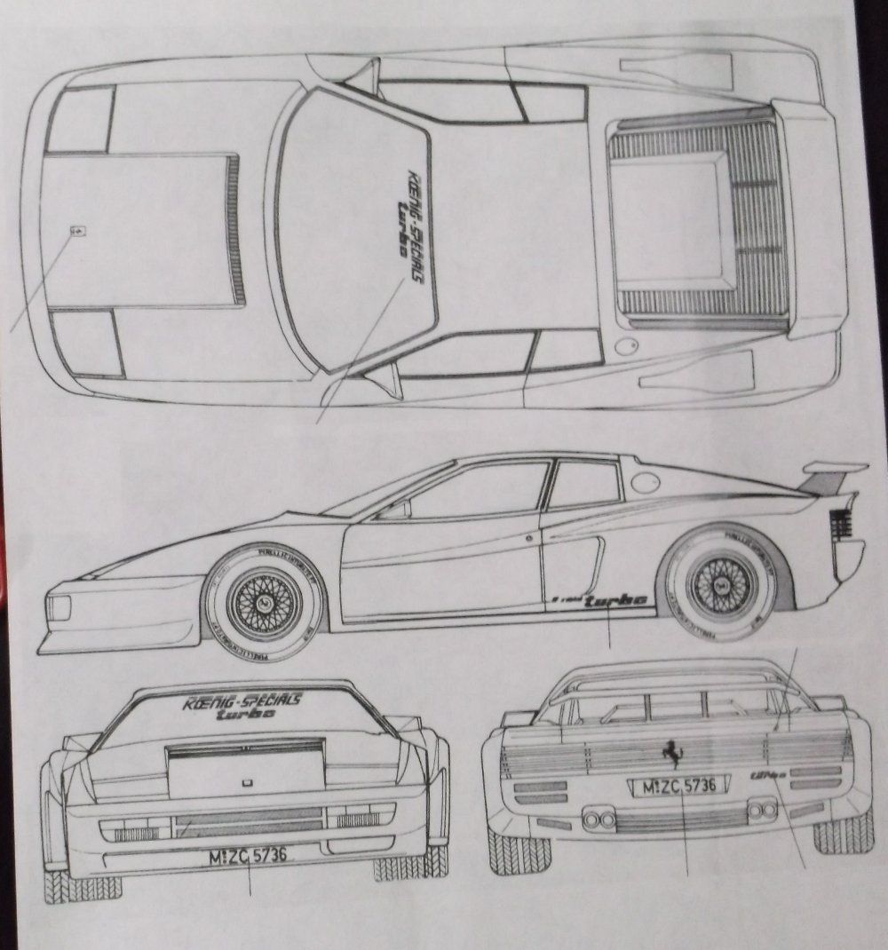

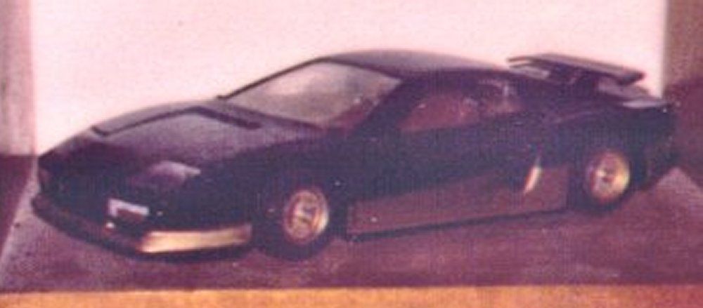

The intended plan:

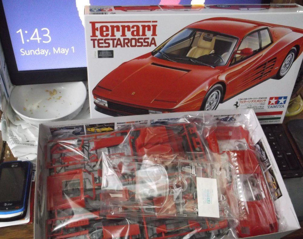

I'll be using the old 1/24 Tamiya kit as the basis for the build

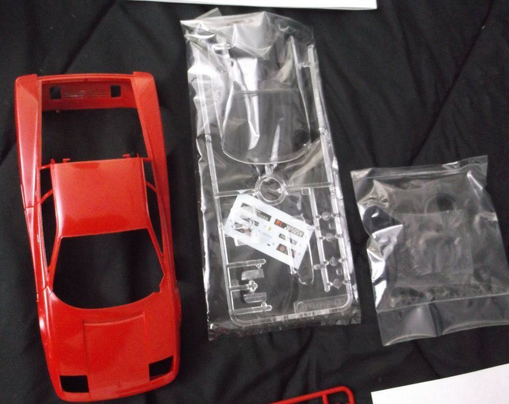

Proof of freshly started kit

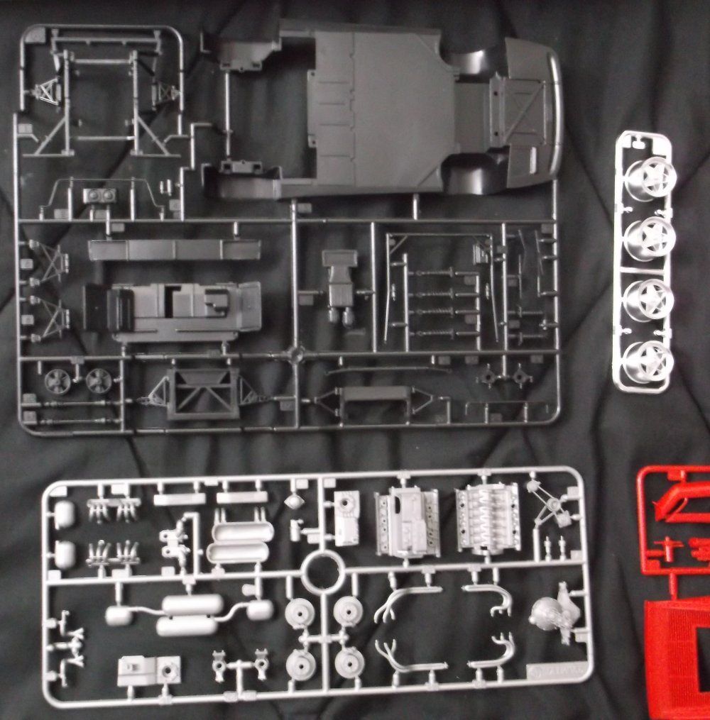

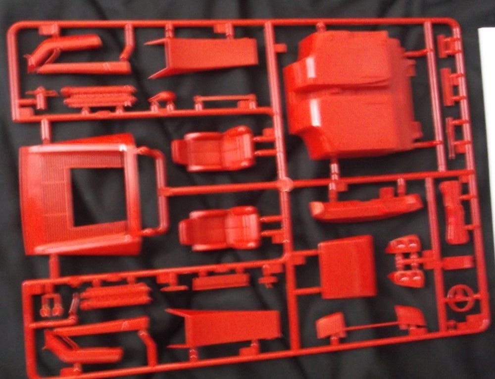

A look at the stock kit contents

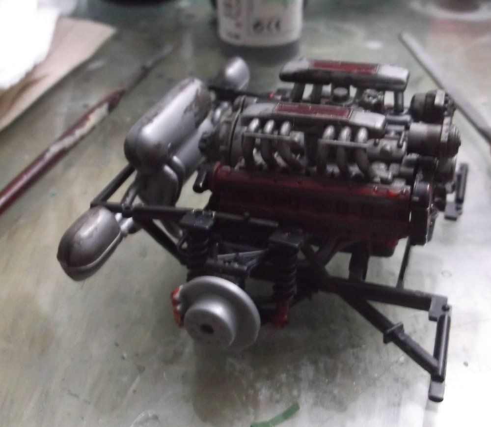

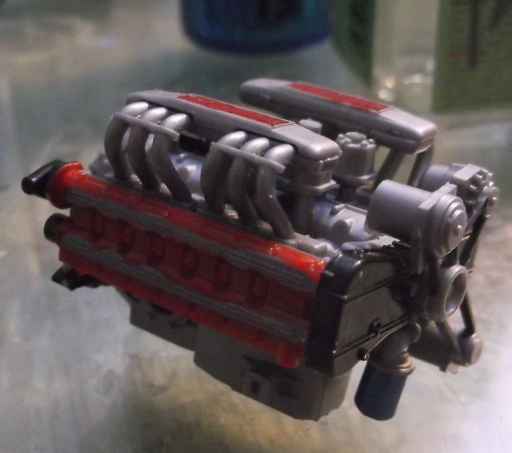

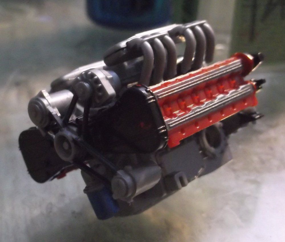

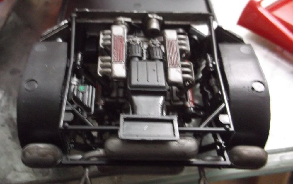

And work begins, as with most cars, on the engine.
All detail paint work has been done by hand with a fine brush
I even painted in the belts with a dark grey primer

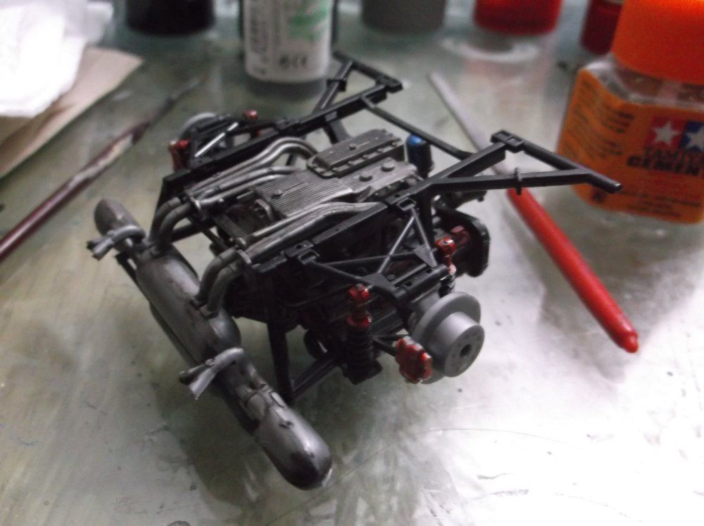

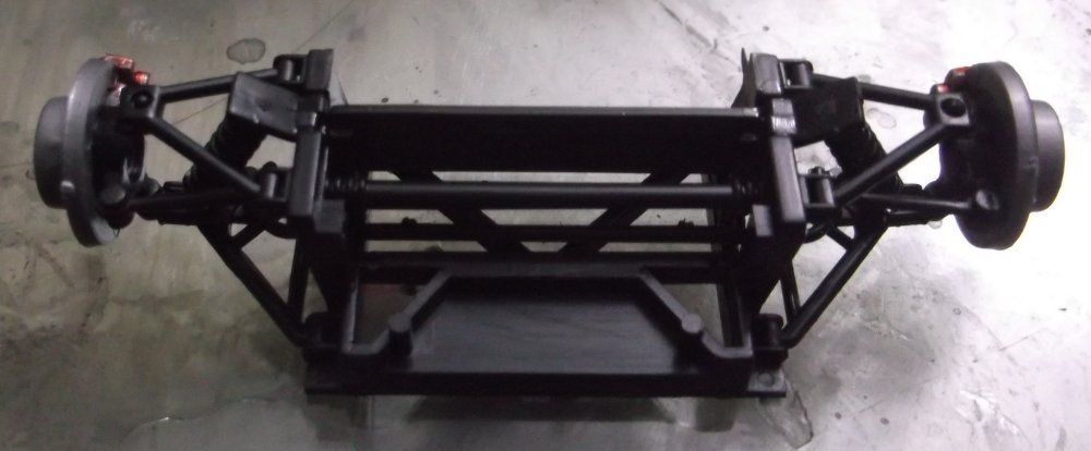

Finished up the engine mount and drive train
Built up the front steering
Installed the Engine and steering into the chassis

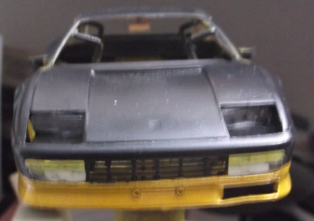

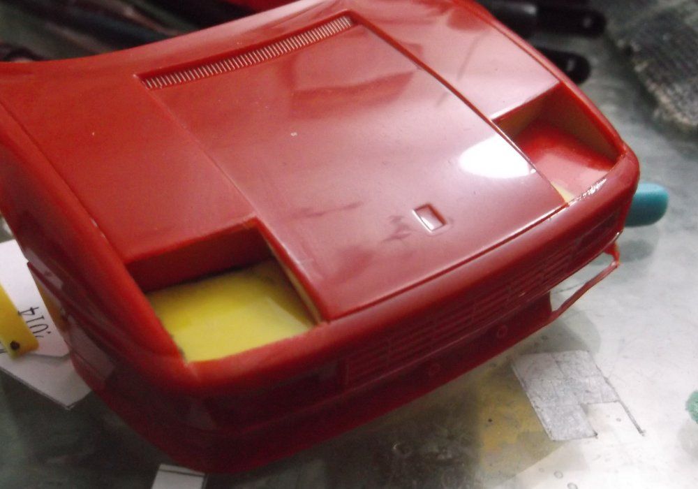

Opened up the headlight openings a little further to accomodate the fixed headlights
Removed the 'cheese graters' from the body as well as the vanes in the intakes and then glued the intakes into place

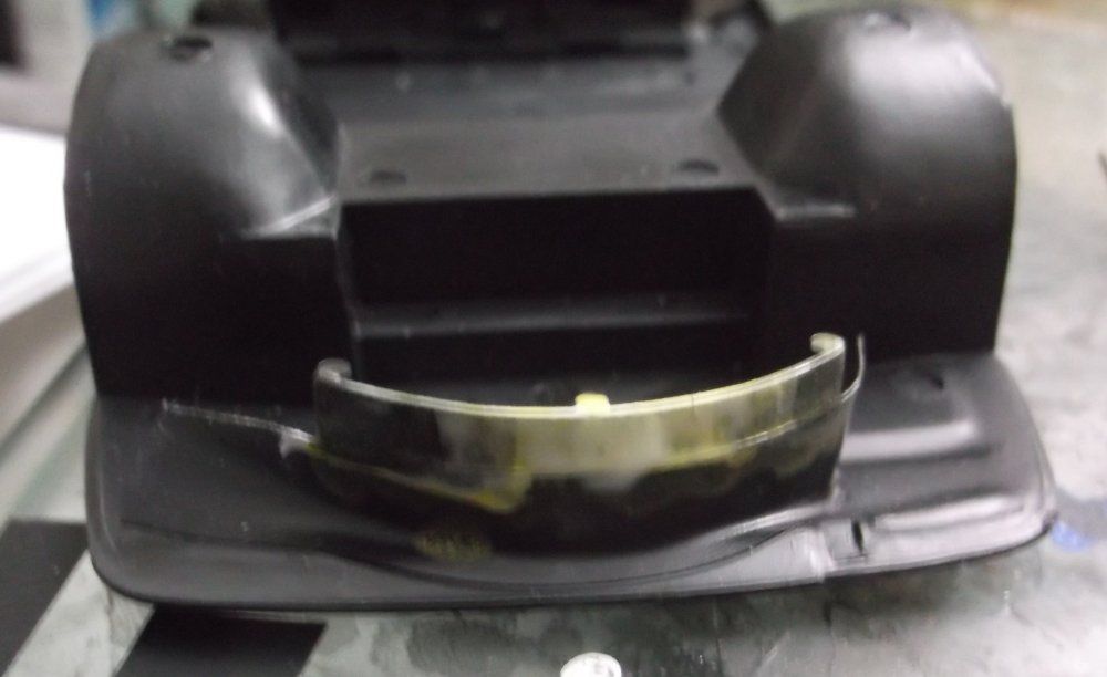

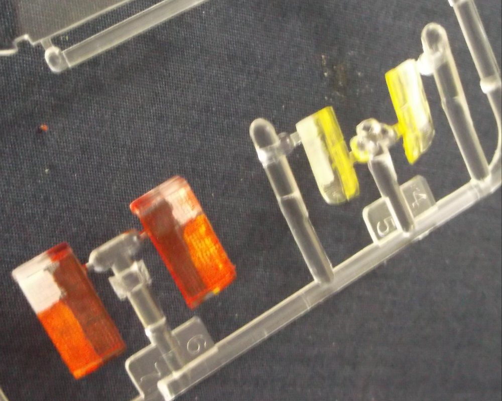

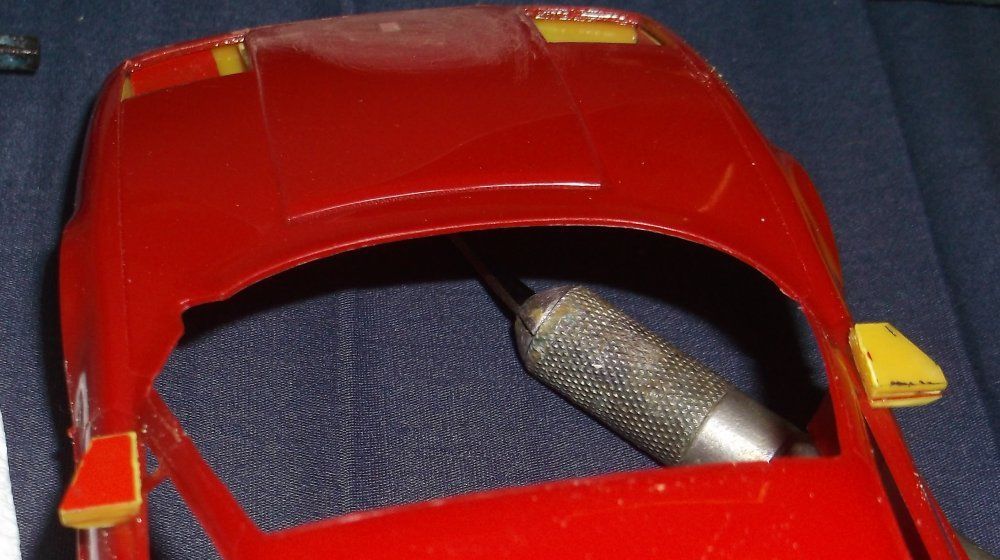

Using sheet styrene, I built the housing for the new headlights
Built up new mirrors from sheet styrene to replace the 'ice cream scoop' versions found on the stock Testarossa

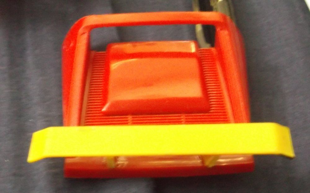

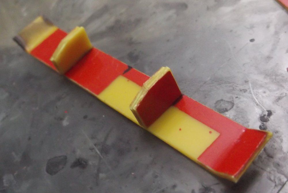

Bent some sheet styrene to make the spoiler for the back deck, then built some vertical mounts for it
Spoiler mounted on the back deck

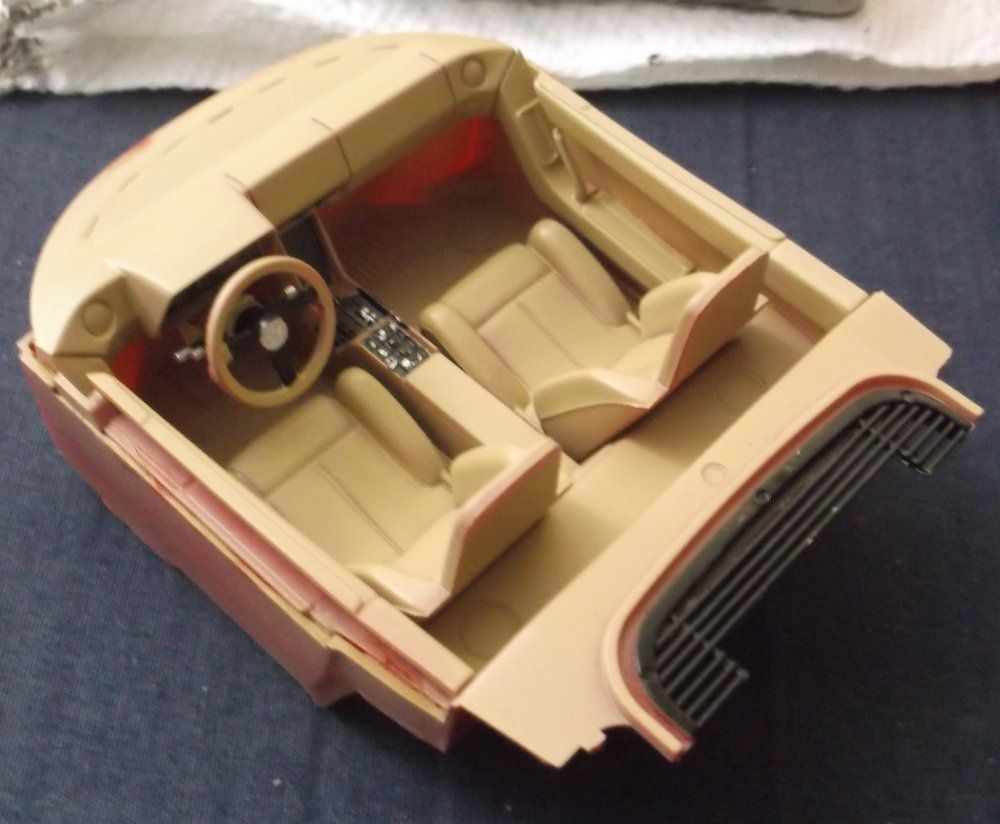

Interior pieces were given a base coat of light sand from Tamiya
Interior was assembled, and detail painted

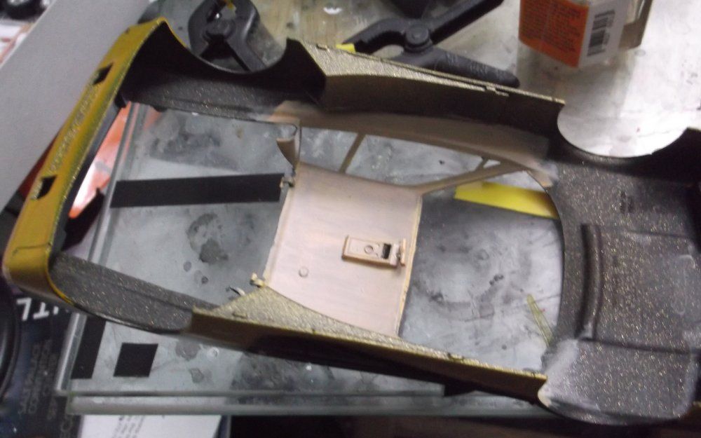

I gave the body a base coat of flat black, then masked off the upper portion to paint the bottom with Testors Inca Gold
This was given a coat of gloss after the masking was peeled off

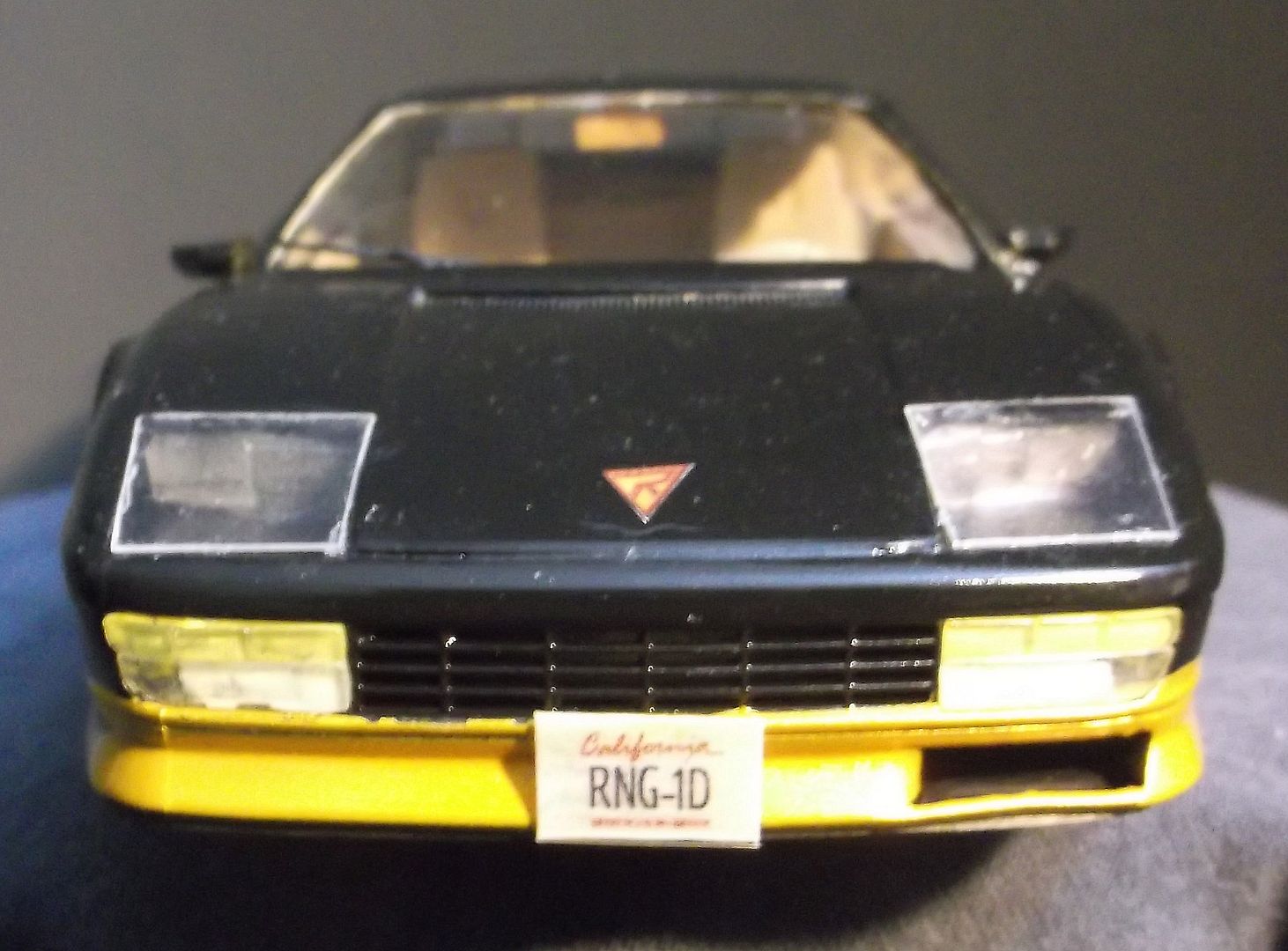

I added the custom markings, as well as installing the clear styrene covers on the new headlights
Finished build pics
