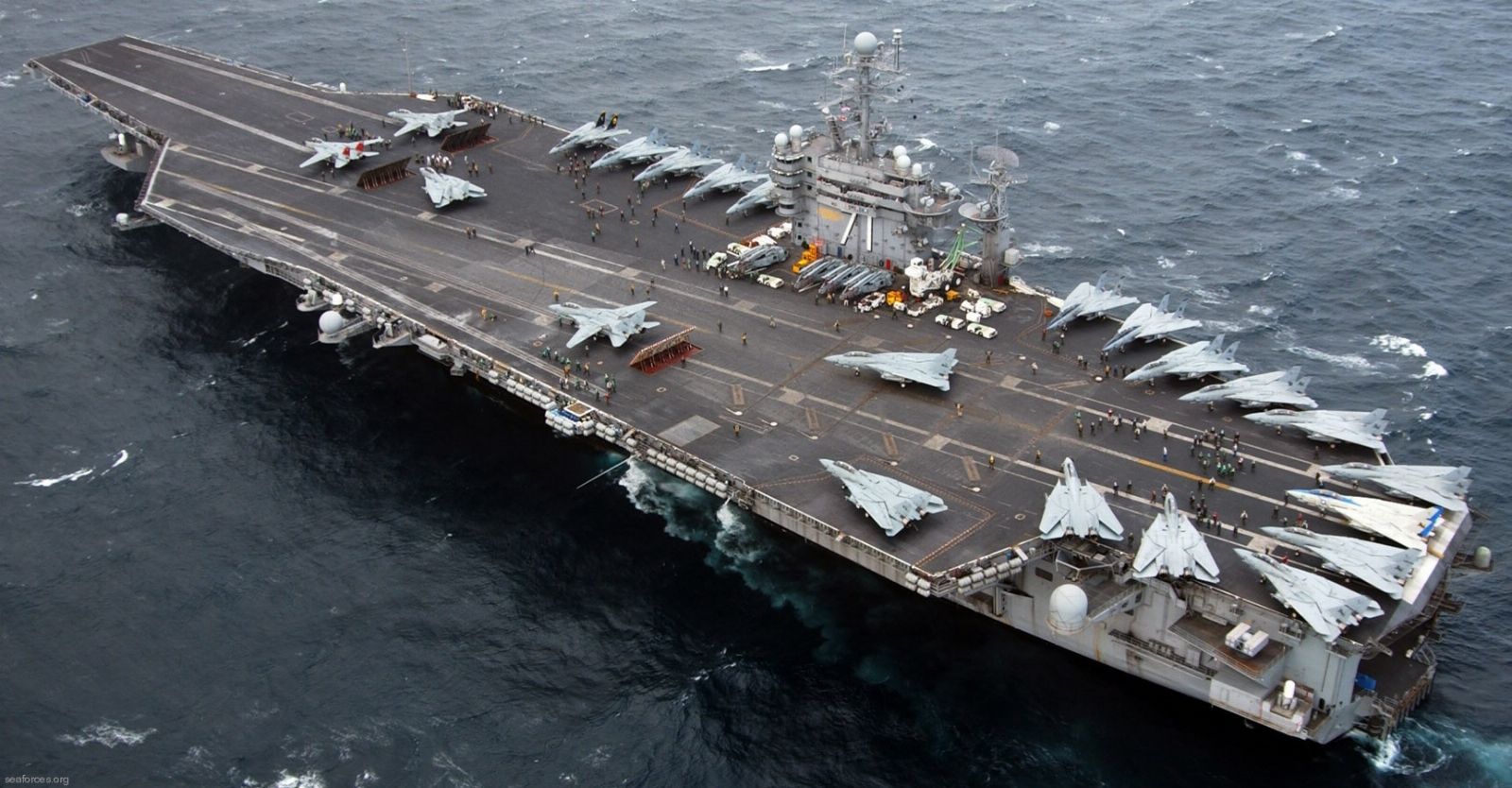

So you mentioned you were around for some shock trials, I've always been curious is there crew on board when the big bang happens? Also they are the first big gamble on the ship builders a billion dollar engineering project which could potentially fail if they failed and the hull cracks wide open during the test
Ha ha , well , we don't expect major hull failures .
They pick one ship from each class to do it to and we were it .
Yes , we are fully crewed and both reactor plants are up , but we are at a dead stop . Ships company , no airwing .
I was down in 2 plant for shocks 2-4 . It was 4 detonations of equal magnitude but they move it closer to the ship each time .
You really couldn't even feel the first one .
Everything broke that was going to break on the 3rd one .
We only had a couple of welds pop loose on some steam drains .
It was quite unsettling watching the main steam piping moving around though . You then realize why all those pipes are hanging from spring assemblies , since they never move at all under normal circumstances .
I had a good friend in Ordnance and he said on the 3rd shock all kinds of crap like lights was falling off the island ,
He's somewhere behind that line of deck equipment in this photo , hard to see but they have a line of plane tractors in front of them :
What looks like a torpedo trail is the control line from the Apache snapping up in the water .
The USNS Apache :
