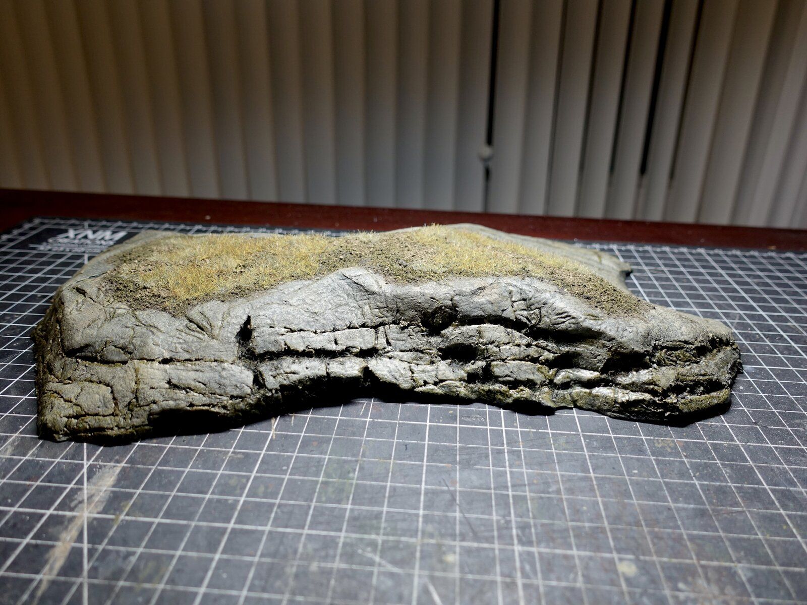

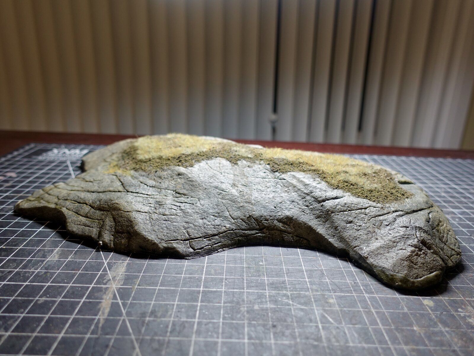

My first rock cliff
I'd ask you if that was a real piece of granite, but the fissures are too perfectly scaled down.
It looks exactly like a giant piece of ledge along an old highway here, except no drill marks.
How did you do that?

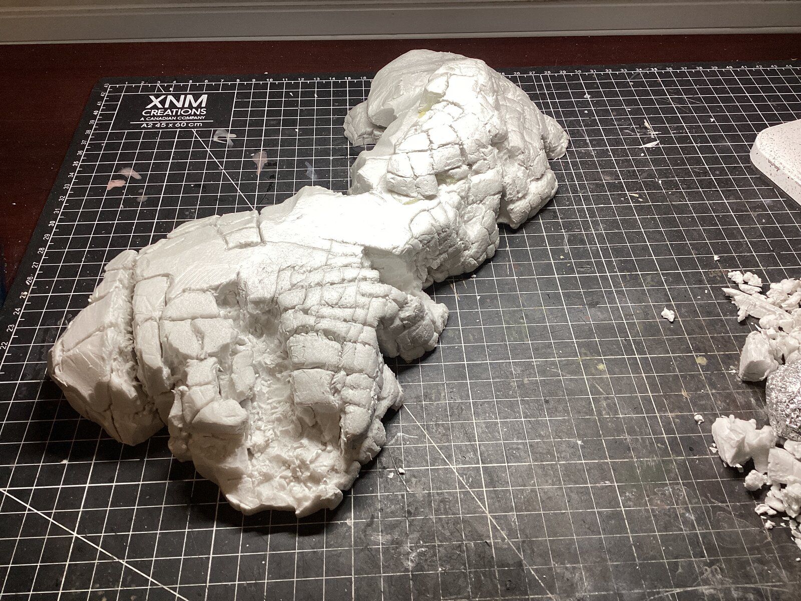

I cut a piece of styrofoam and carved it. Then, when I was satisfied with the look, I rolled an aluminium foil ball on every surface to add texture.

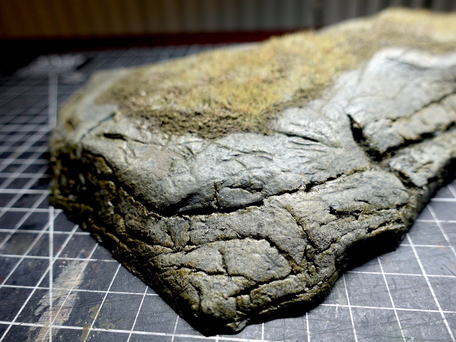

For the painting, I began with mixing Mod Podge with black primer paint to make my rock more resistant. After that, I painted most of the rock with a dark grey acrylic paint. Then, I drybrushed it with a lighter grey and finally I lightly drybrushed with a light beige color.
After the painting was completed, I add a black wash on all its surface and let it dry.
I then decided to sprinkle some clay on the top. To make sure the clay stayed in place, I use an eardropper to cover the clay with a mix of 50% water and 50% white glue. I let it dry and add another layer of this diluted glue. Once everything was rock solid, I added some static grasses. I mixed different colors of static grasses because in nature all the grasses are not from the same species.
And that's about it. I am now building a second rock, a little bit different this time.
