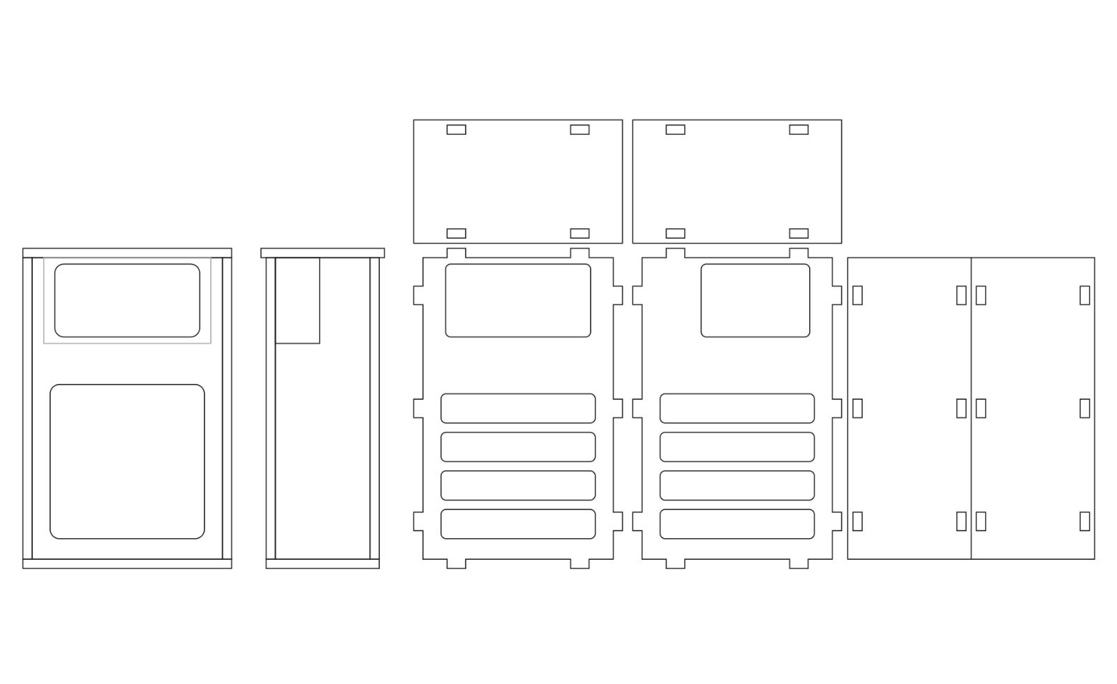

Here is the drawing to make the drums. I started with the bass drum as a proof of concept, and it turned out so well I will be able to use it. I cut the drum body parts from several thicknesses of various materials and 0.015" polystyrene worked the best. I use inexpensive for sale signs from the home improvement stores. I still need to cut out the remaining parts and assemble them. The laser helps, but it's still a tedious assembly. Also thinking about how to form the cymbals from brass sheets. I also want to build a "pvc pipe" drum for the set.

The level of detail on display here is breathtaking. Just the drawing you did for the various drums is amazing. And don't get me started on the guitars.
I pride myself on detailing but your stuff is on another level man!
thank you!
