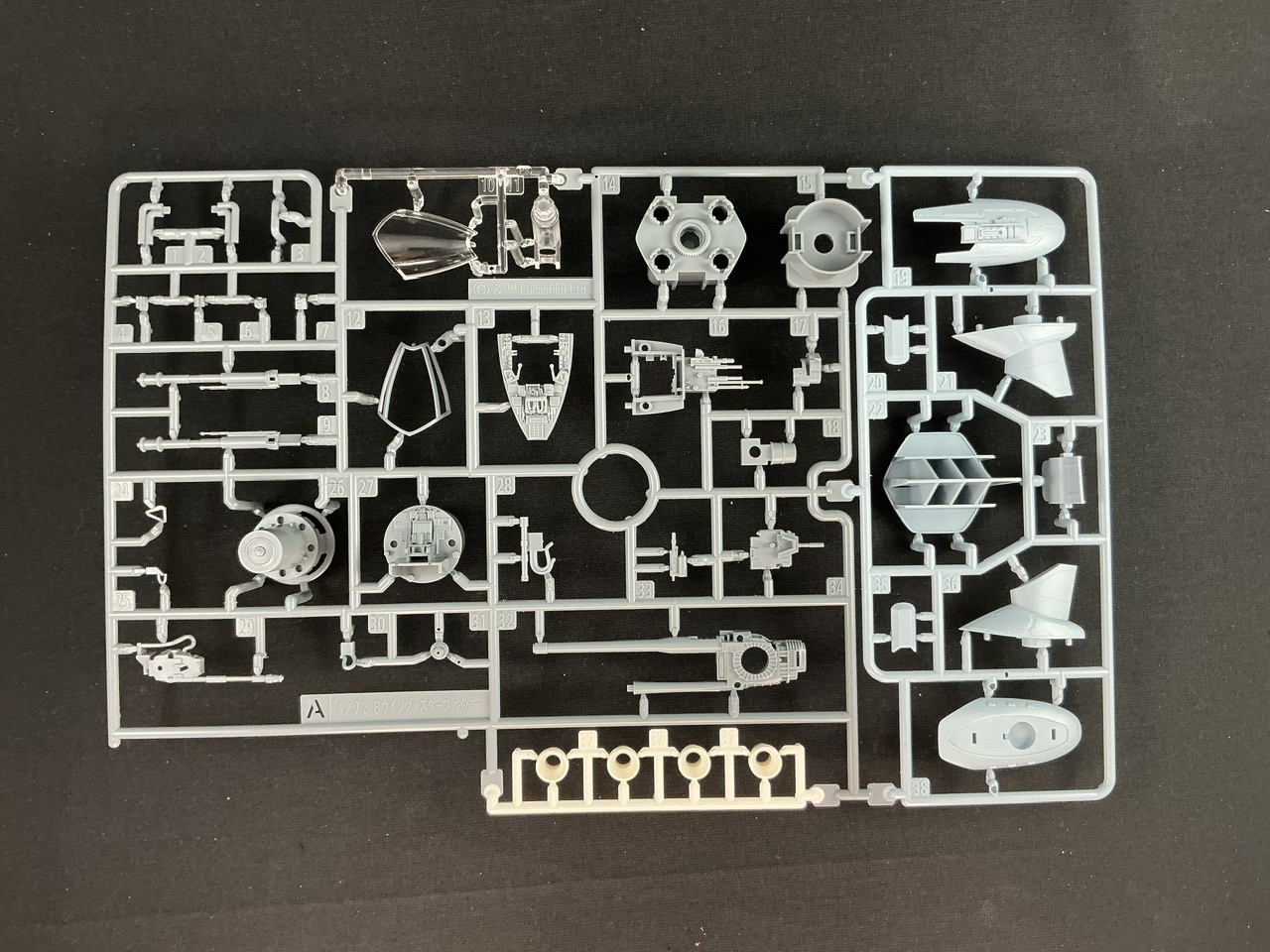

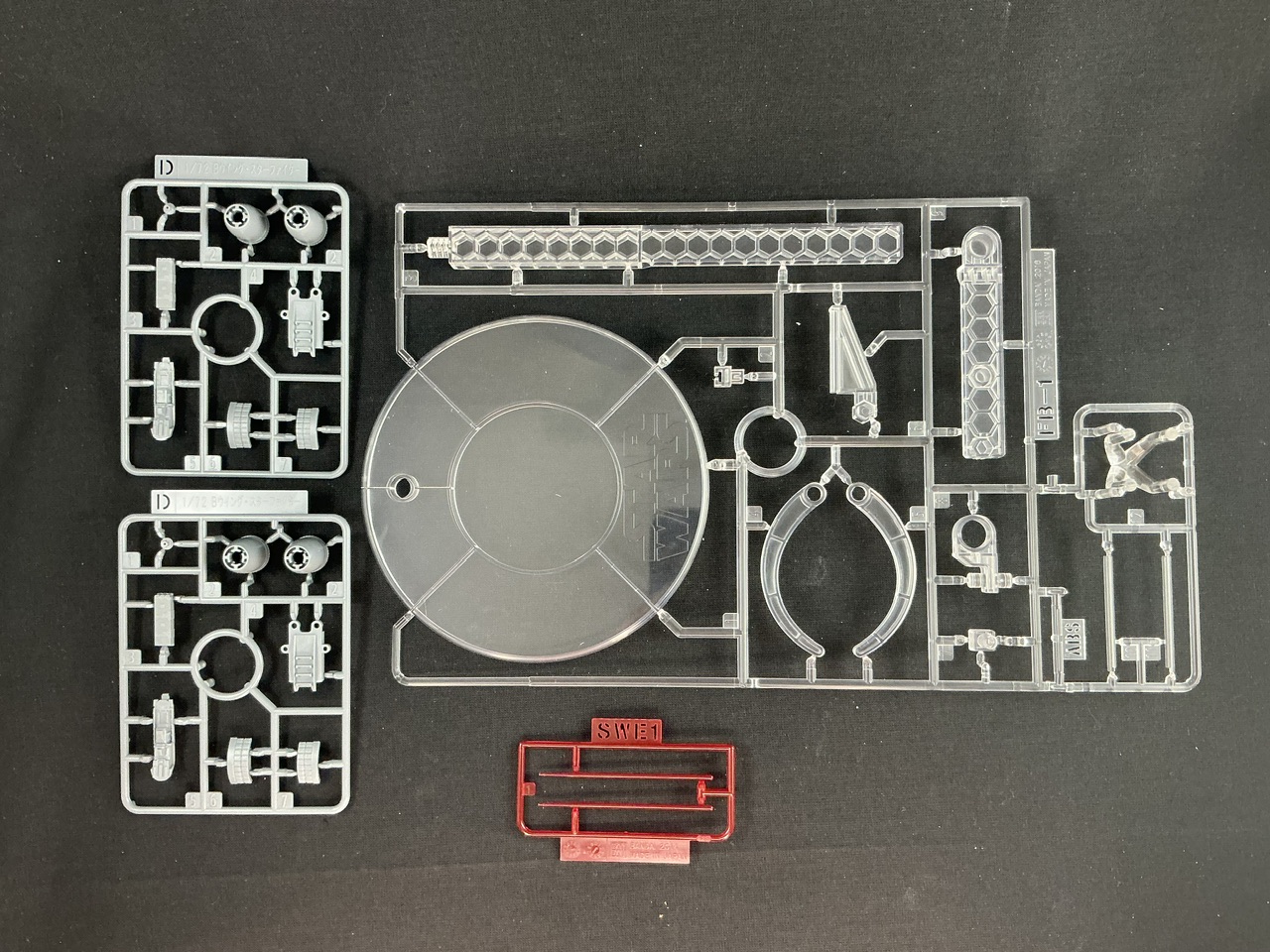

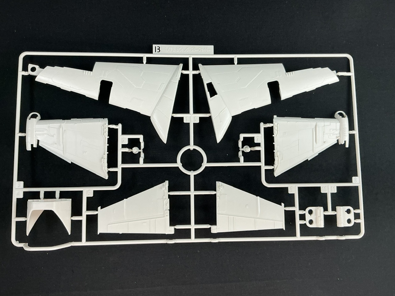

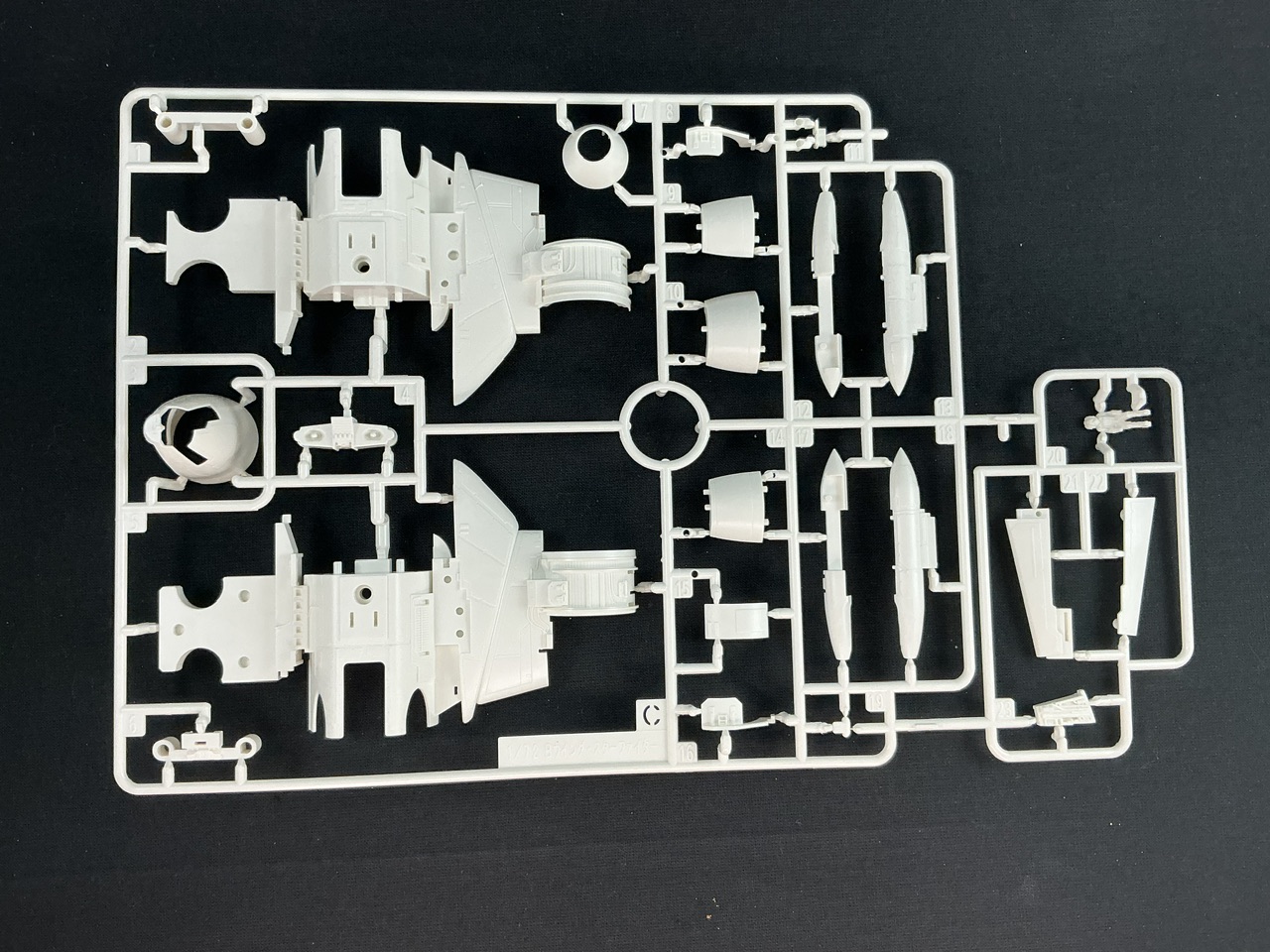

Instructions can be found on Scalemates, so let's start with some sprue shots:
This is only the third Bandai kit I've ever bought, and must say the moulding quality looks very good. Still, I don't quite see the point of the multi-coloured sprue A. It feels like it's something they're doing because they can, not because it adds anything to the model.

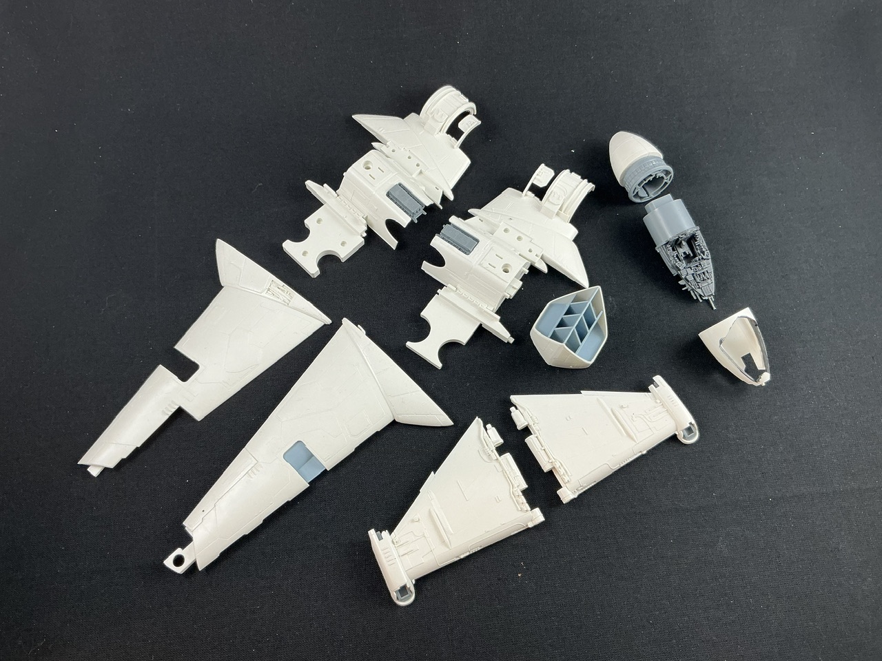

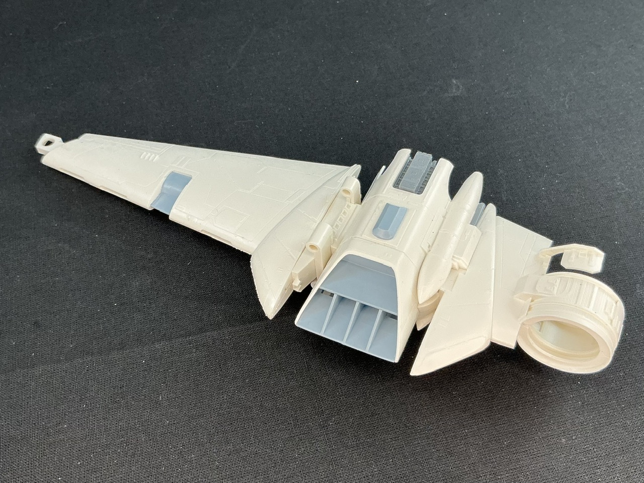

Well, these don't take very long to put together. It's not finished yet, but here are the major parts:
Before I can put these together, I need to finish painting the cockpit and especially the pilot, because the cockpit goes between the main fuselage parts so it can rotate relative to those. Once that's done, I can put the fuselage together and attach all three wings to it, then just add the detail bits like the guns and engines.
Though you can't see it very well in the photo, I painted the cockpit grey with shading and highlighting. It seems it's mostly grey in the movies, but I can't find any good pictures of it — the main things that pop up when I try to search for it are screenshots from games and pictures of other peoples' builds of this kit, plus things like the Kenner and Lego versions, none of which really helps for accuracy.

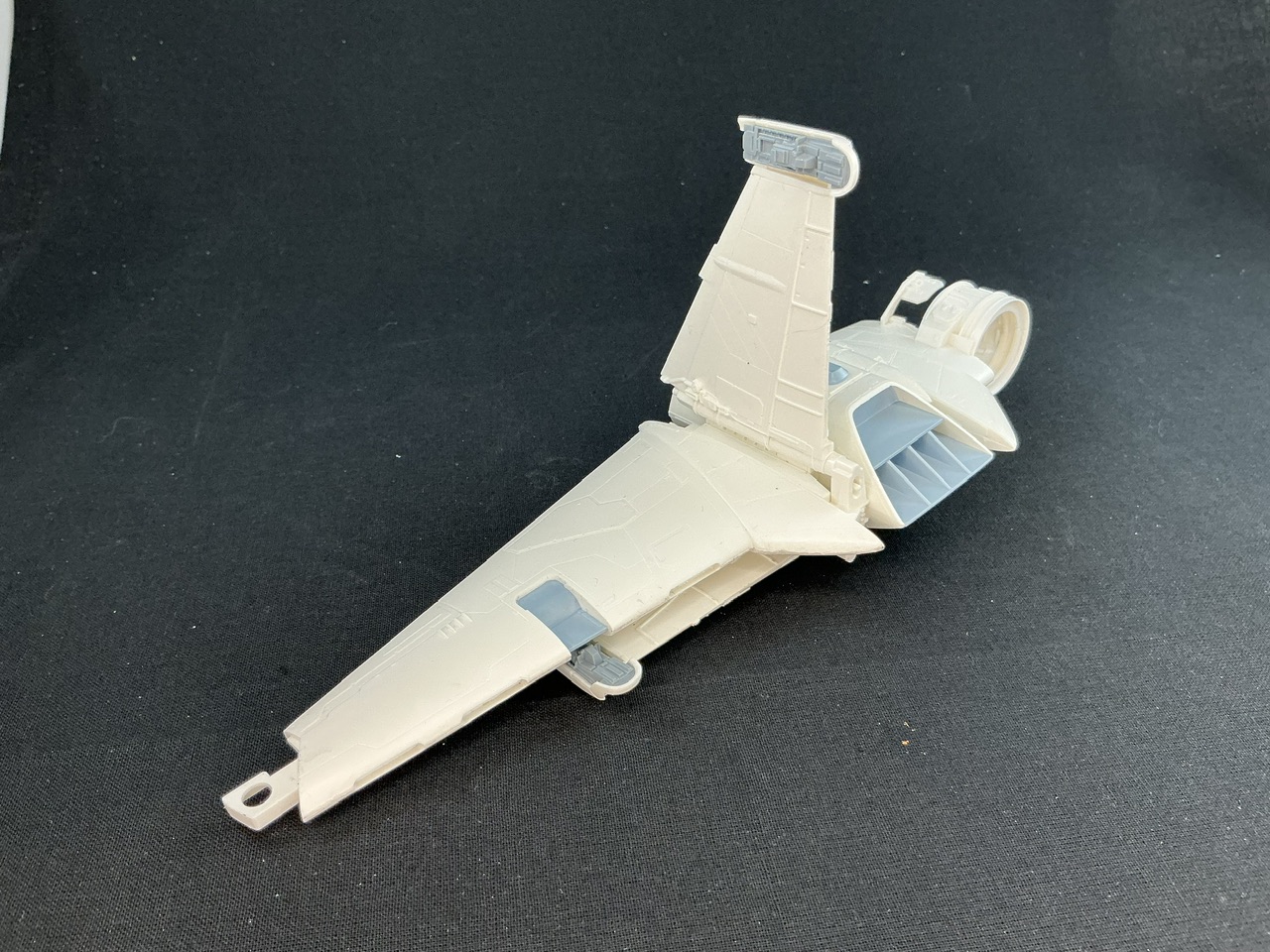

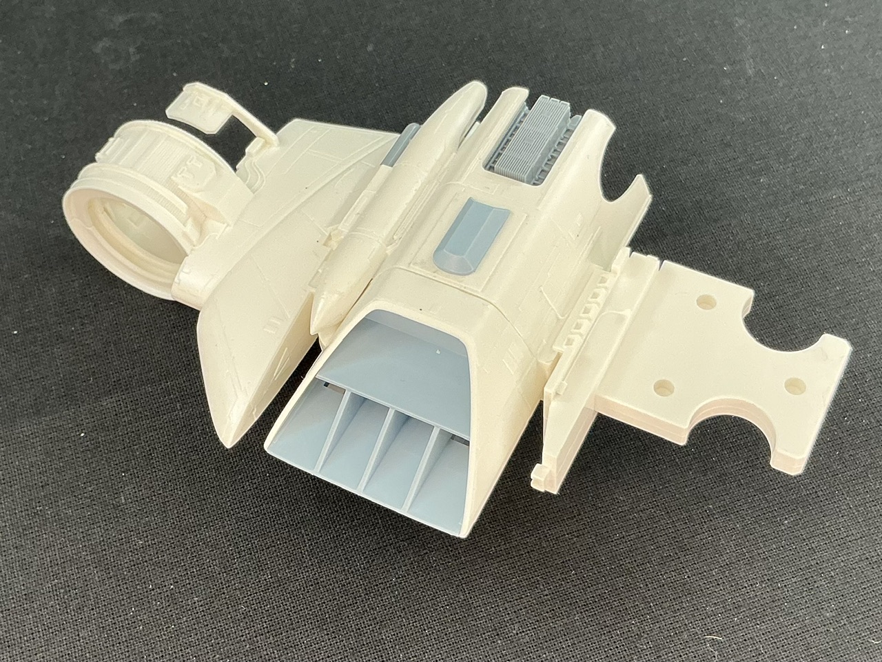

Dryfitting things (carefully so they don't stick firmly enough that I couldn't take them apart again), I found that you can fit the cockpit after assembling the fuselage, so I put that together first:
Then I attached the main "wing":
This turned out to be a bad idea. The instructions tell you to fit the folding wings first, and I discovered this is because their hinges (C1, C4 and C6) need to be fitted before the big wing is. As a result, I had to take it off again and fit C1 and C6 hinges first, then I added the big wing once more, fit the folding wings, and then found out that C6 also couldn't fit because its locating lug should be trapped between the big wing halves … however, cutting that lug off let me put it in place anyway:
The hinge mechanism is interesting. On the sprue with the stand, you get two hinge pins for the wings as well. Since the stand is made of ABS while the rest of the kit is polystyrene, chances are you can't accidentally glue the pins to the model if you do glue the parts together, because model cement generally dissolves polystyrene but not ABS. (Tamiya Extra Thin does seem to dissolve it, though, but not very well.)
This is the quickest model I've built in years, if not decades …

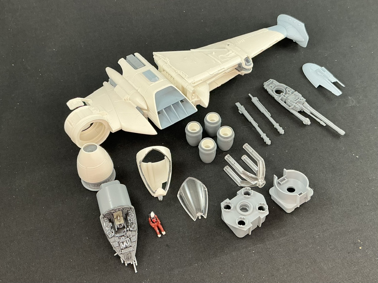

Two parts still missing here, but you can't see them in the photo, because I can only install them after painting due to the way I've made the model into subassemblies:
Of course, since this is a snap-together kit I could have built it without any glue at all and taken it apart completely again, but the photo above shows everything that isn't glued together :) The pilot is partly painted, as is the cockpit, but I can basically now start painting the model — though not yet, I want to wait for the glue to dry first :)

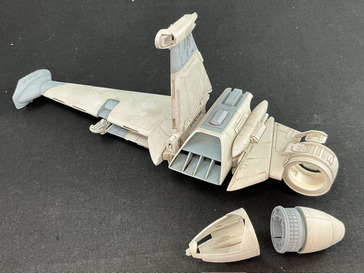

It looks like I might be able to paint the model today, BTW. The wind has gone down a bit, which is important because I have to open a window to put the spray booth's hose outside, but that faces the prevailing wind direction. If there's too much wind, especially in winter when that wind is cold, I don't want to be spraying models.

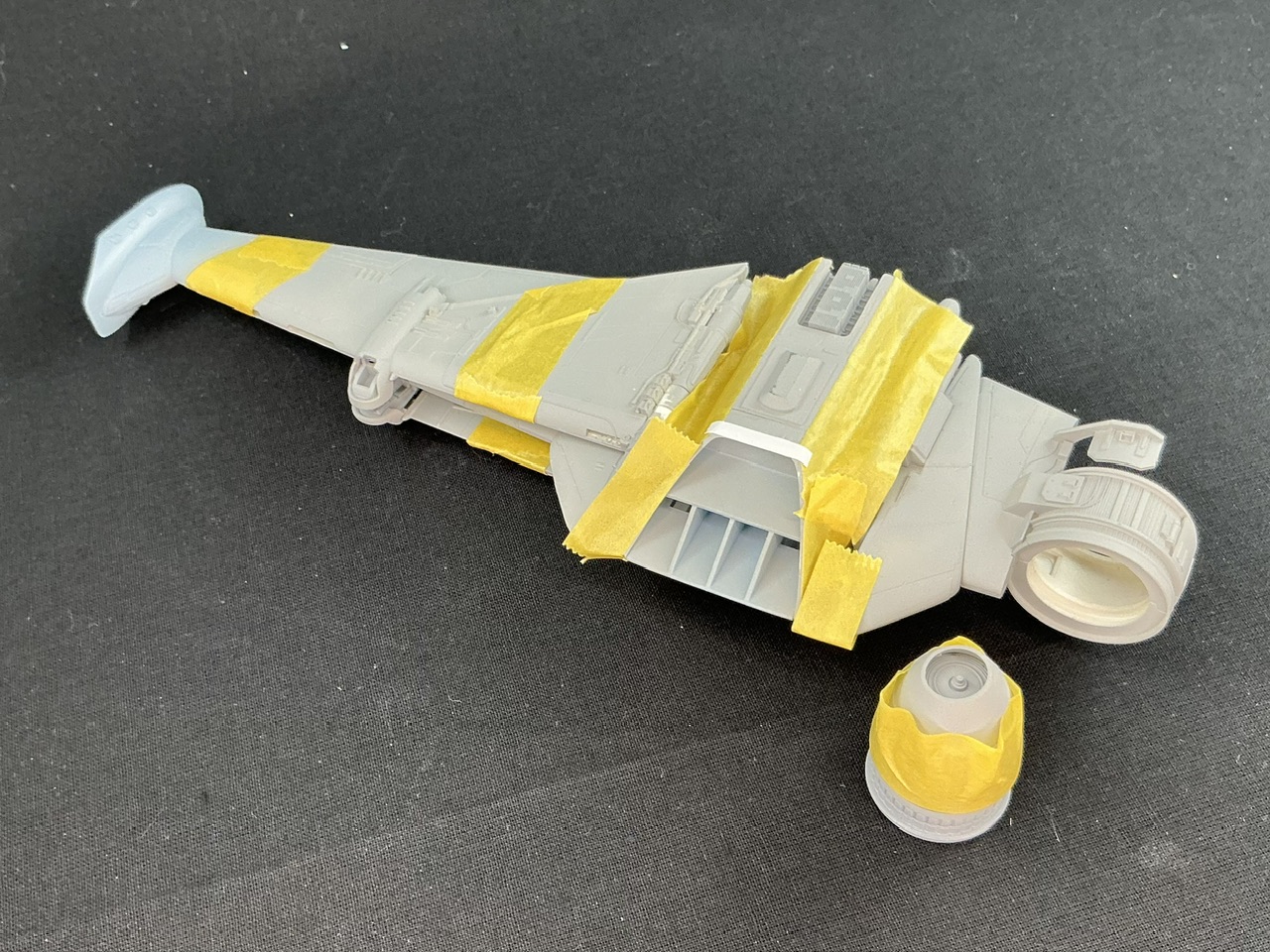

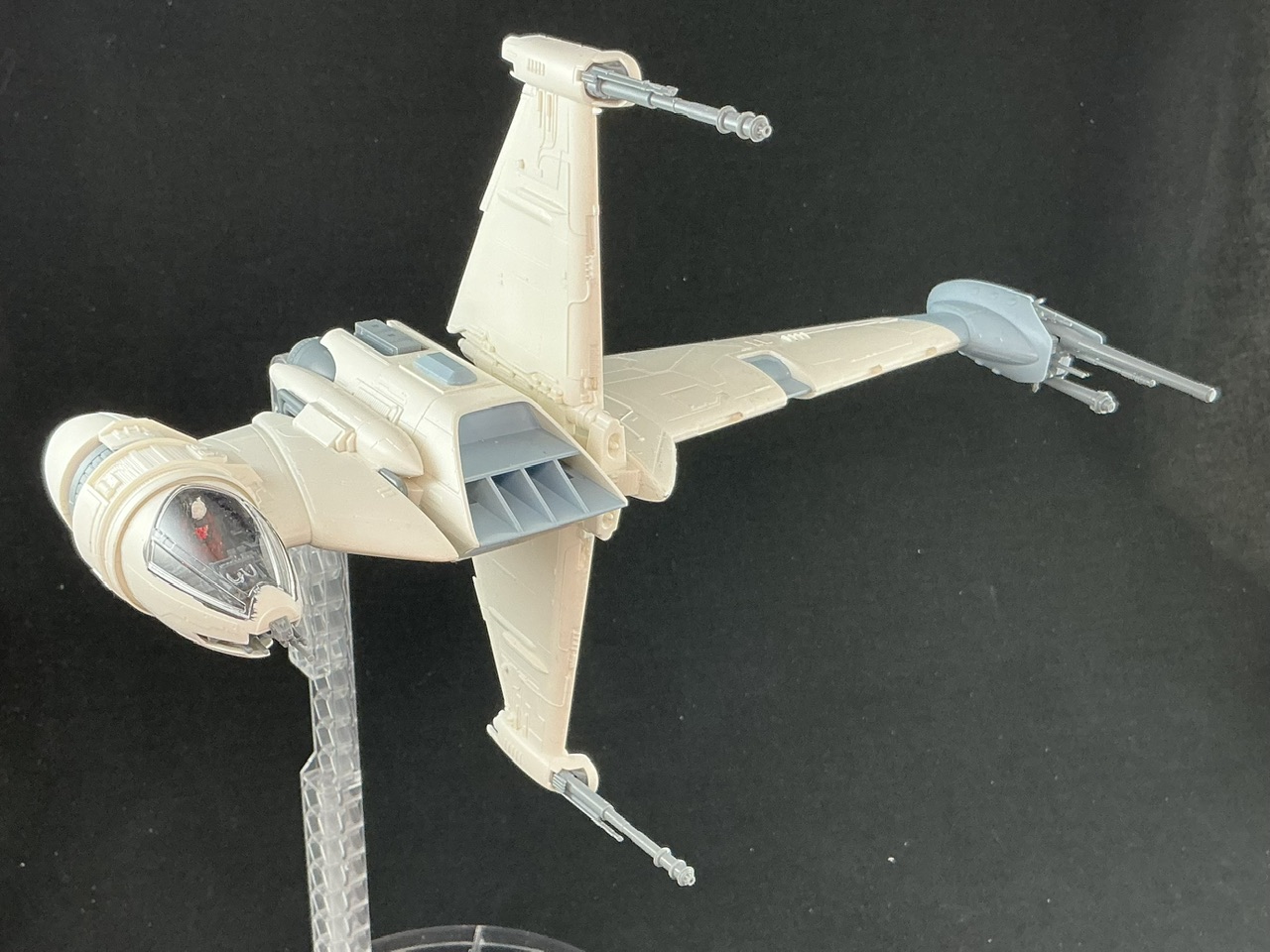

I did paint the model on Wednesday, but forgot to take a photo of it before I applied masking tape today:
The whole model is sprayed in Tamiya XF-80 Royal Light Grey here.
I forgot to mask the recess in the middle of the leading edge of the big wing, so I did that after taking the photo, and then sprayed the darker grey parts with a mixture of the same light grey plus XF-18 Medium Blue, approximately 1:1 I would guess but I just poured blue into grey until it looked good to me. This is a science-fiction subject, after all :)
The gun pods at the ends of the folding wings also should be light grey, but they're very tricky to mask so I decided I wouldn't bother and just touch them up later.

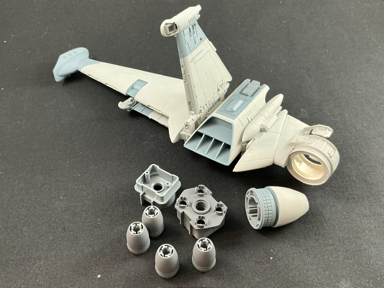

The engine nozzles and the block they go onto, are XF-24 Dark Grey. The lighter part next to them is unpainted, to show the difference (that part is the holder for the optional lighting kit for the exhaust nozzles).
I do need to do some touchup
By the way, if you're reading this because you'll be building this kit too, don't make the mistake I did. I hadn't looked at the painting instructions closely enough when building the model, and so had glued parts together that I would have better left loose. Specifically, the radiators D4, the intake (?) grid A22, the gun base parts D5 (in the wingtips) and the whole gun pod A21/A36/A38. By leaving them loose, you will save yourself masking, touching up and tricky painting later on.

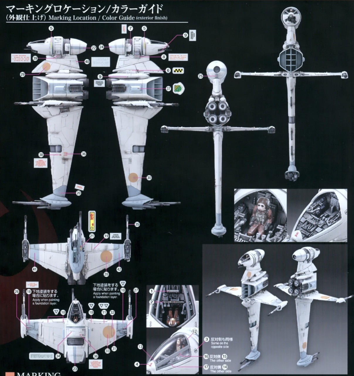

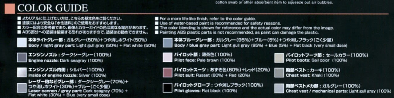

I shall defer those question to the honourable researchers at Bandai ;) I followed my interpretation of their painting instructions, which are somewhat vague:
I recognise names such as "light gull gray" and "dark seagray" as probably referring to US and British aircraft colours, but since there is no mention of any paint brands, your guess as to the exact shade is as good as mine :)

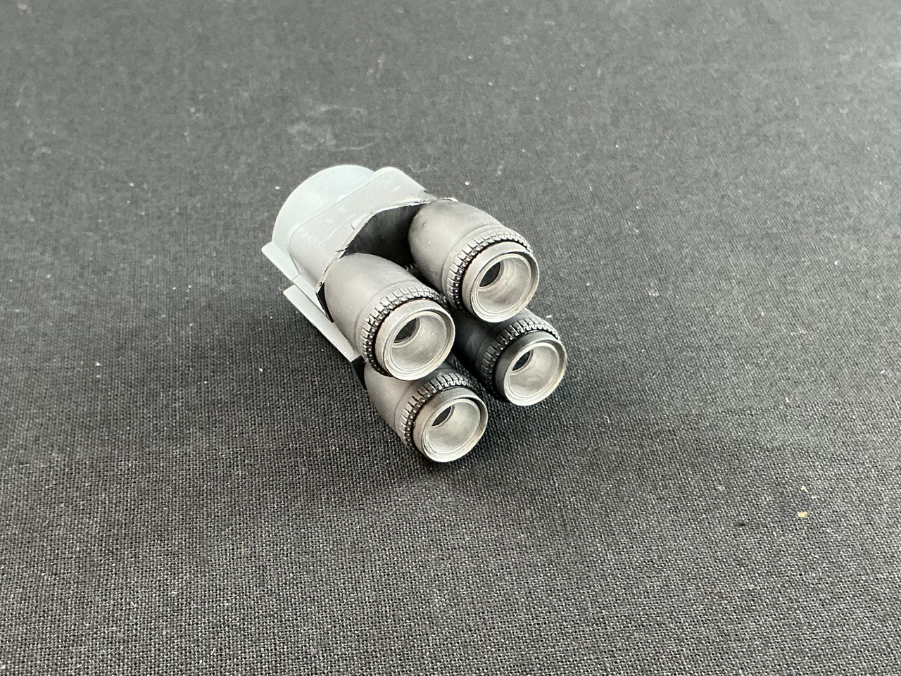

And the engines:
These were given a wash of Army Painter Dark Tone, unthinned, and then drybrushed with dark and medium grey. The silver is Vallejo Model Air Aluminium, which is airbrush paint that I applied with a brush.

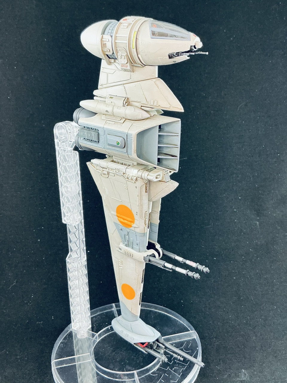

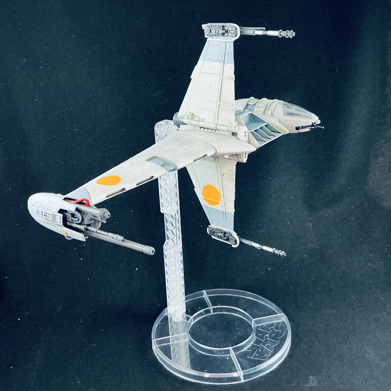

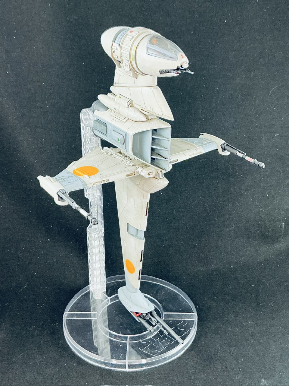

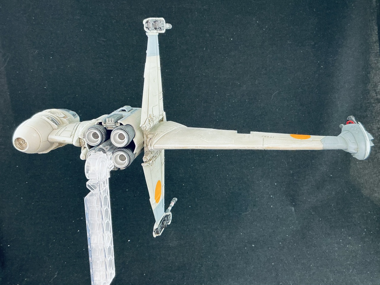

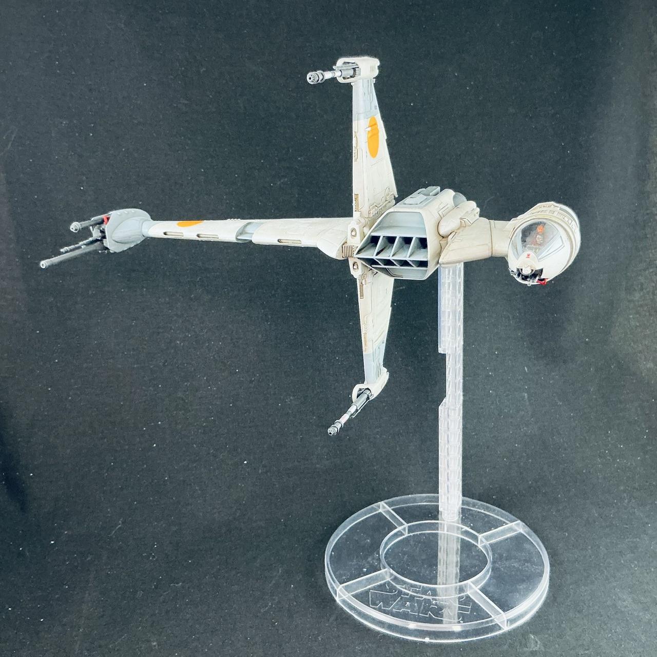

After doing some more detail painting, completing the cockpit and applying the decals, I'd say this model is done.
The cockpit rotates and the wings fold, but because some paint has rubbed off on one of the hinges, I'll probably display the model with the wings unfolded. The engines also still come out, in case I ever want to add a light to it. Cockpit rotation is very heavy, though, despite smearing vaseline around the part that's inside the fuselage.
View attachment 137736View attachment 137737View attachment 137738View attachment 137739View attachment 137740
Excellent work
I think that RAF color worked out nicely
Thanks, I'm pretty happy with it. A bit darker than you see them in the movies, perhaps, but hey, it's a SF subject :)
That's what I had to do here too! Not because the colour as such is so dark, but because my iPad's camera app adds all kind of colour "correction" that is probably very helpful if you're photographing people or scenes outdoors, but not for models. I had to put a predefined filter over all of the photos to get them reasonably close to the real colour.
