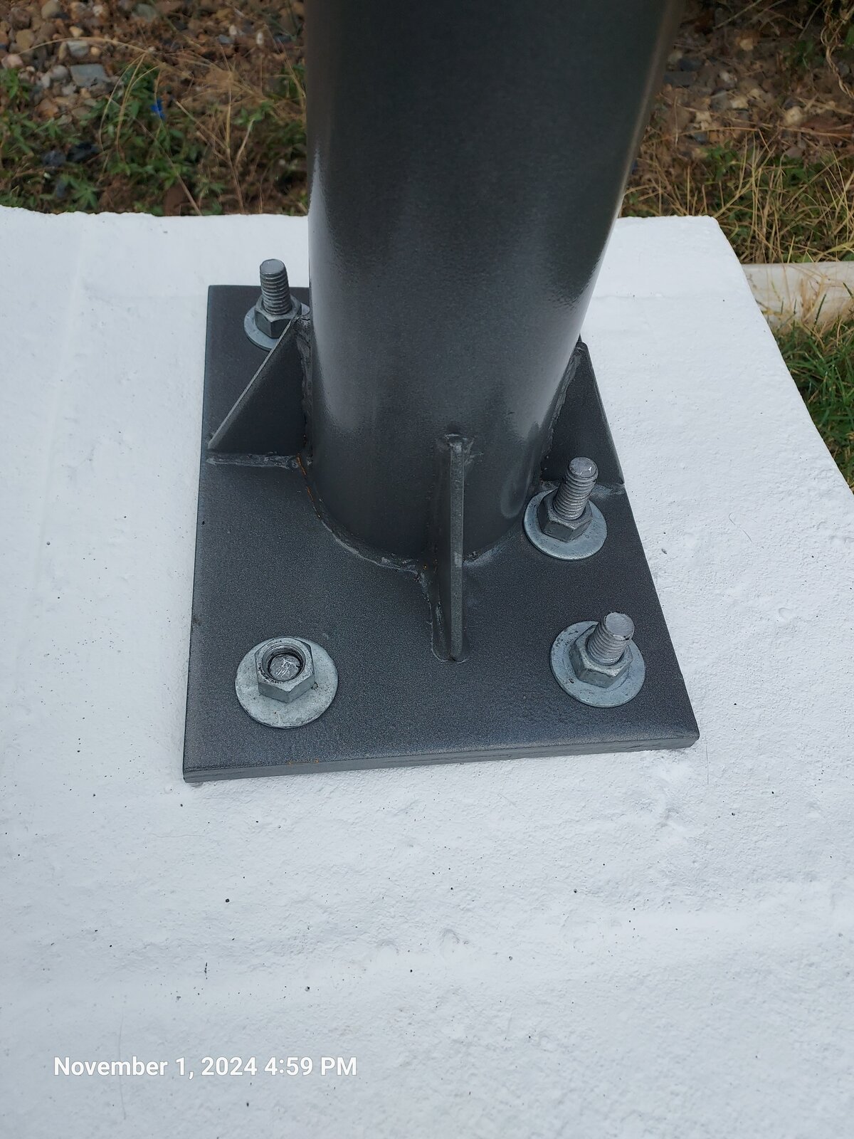

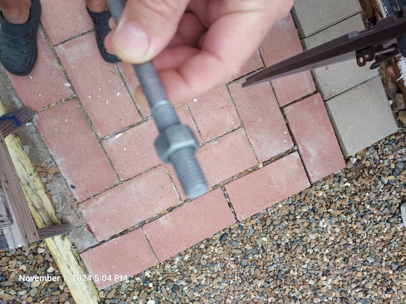

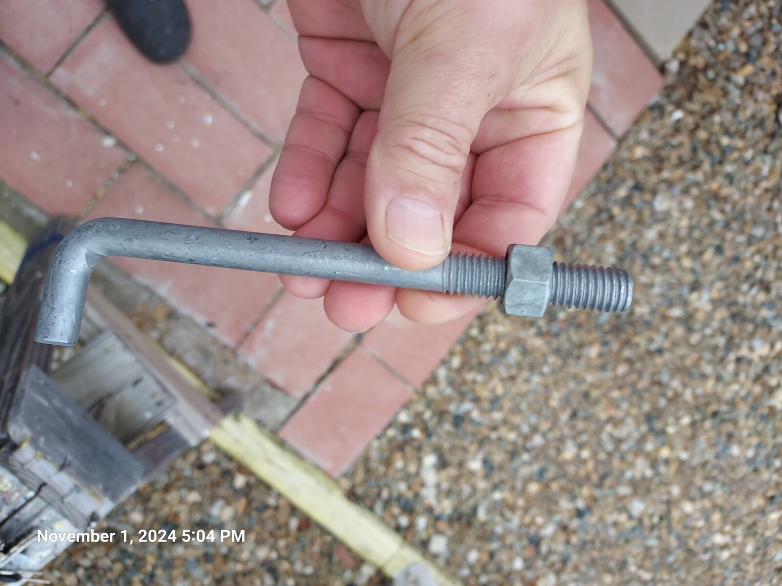

Preface: It appears one of the galvanized L anchor bolts i used for my hoist is too short to get a grip on (front left). The bolts are rated for 60 foot pounds and i am only using 30 which i believe is enough. But this one bolt being too short i cant get even 5 foot pounds of grip on before it begins to fail (i can feel it), so i backed off to not make it worse, the last thing i need to do is to strip it totally. Right now its just finger tight.
So i feel i have a few options here:
1. put it as tight as i can get it and weld the nut in place.
2. drill a new hole beside it and use a tap in (wedge type) anchor bolt.
3. drill out the bolt enough to use a wedge type bolt in its place.
4. cut a section of threads off another bolt and weld it to this one extending it, then grind it and use a die to restore the threads.
My preferences in order are 4, 1, 2, 3

I'm not sure I understand exactly what you're saying .
That one anchor bolt is loose in the concrete ? Or the nut is only engaging a single thread ?
remove the washer .
Is that the side that will be in compression ?
the side toward the load ?
If so , you probably don't even need it if all those other anchors are solid
Sorry, the anchor itself is solid, the nut is only engaging a few threads which is the issue. I read that i need at least the full nut + of engagement in order to hold properly.
Even if i remove the washer its not enough, at first i tried a thinner washer then removed it and still not enough.
The load will be on all sides as i will be lifting a boat motor (400+ lbs) from the right and swinging it around to the far left to set it down on a pallet.
I was planning on welding one of the nuts on there anyway to keep someone from stealing the lift, so maybe i can just get it snug and weld it and that would be enough.
You could just weld it as is .
no washer , twist the nut on " tight " and hit with a bead across the nut and into the base
Thanks cool that would also keep anyone from stealing the lift. I would like to leave the washer as i dont want to mar the protective finish on there and introduce rust. :)
There is probably a chart somewhere on the internet ,
but I'm guessing a single thread of engagement with a 1/2-13 is good for waaaaay more than that will ever see .
Hit it with that cold galvanizing spray afterwards
I will yeah those threads are pretty meaty. I will also be careful not to breathe the fumes, i have a fan i can use to blow on it while i weld it. I will have to remove the galvanized for welding so yeah i will spray it again afterwards. Thanks :)
