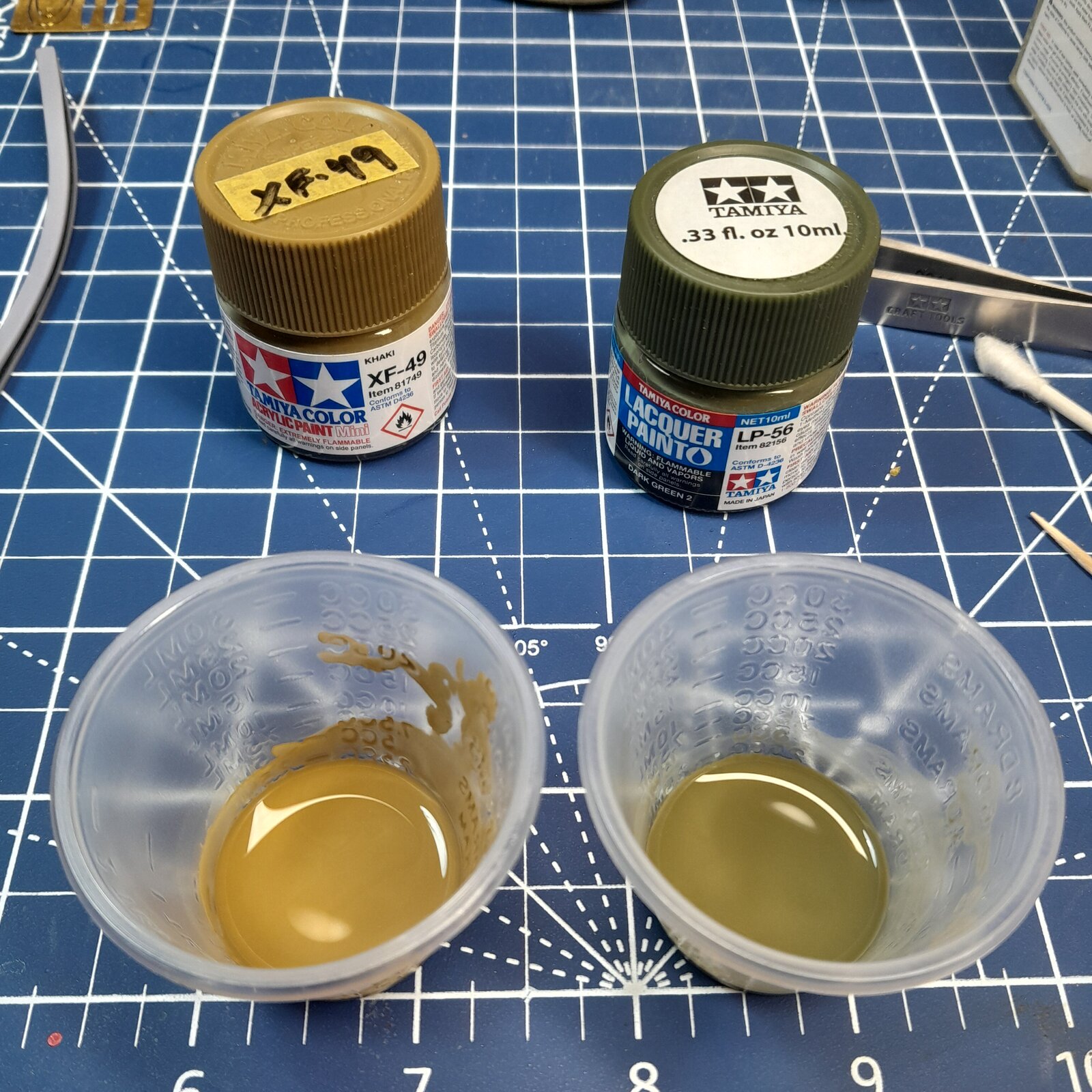

You can thin Tamiya acrylics (X and XF) with 90% isopropyl alcohol. Don't use 70%, which is more commonly available, and contains 30% water. Also, if you thin with alcohol, using their acrylic retarder is a must. My only problem with their proprietary thinner is that it's rather pricey, but if that is not a concern, you won't need the retarder.

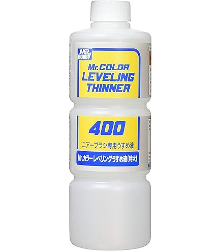

I use lacquer thinner exclusively, except on certain paint brands.
The problem with "lacquer thinner" is that it has no specific composition. Some of them contain other hydrocarbons besides alcohols, and will have unfortunate effects on the paint. Even using the same brand for years won't necessarily prevent this, as the manufacturer can put anything they want in the mix. The lacquer thinner I have on my shelf will curdle Tamiya acrylics. So it's a good idea, if using lacquer thinner, to read and keep track of the ingredients on the label in case the formulation changes.
So I always recommend either 90% isopropyl alcohol with Tamiya retarder, or use the Tamiya thinner, X-20A.
