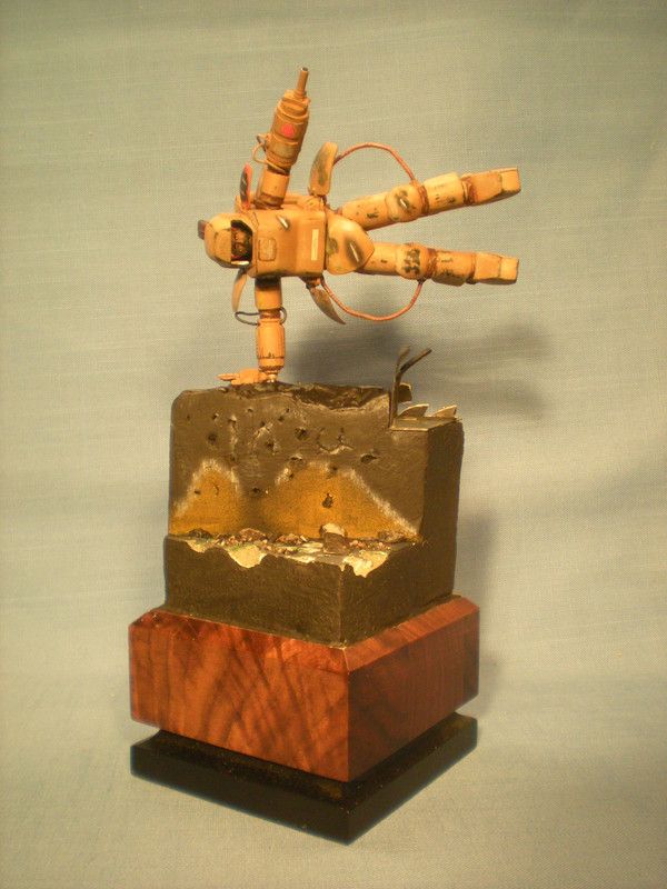

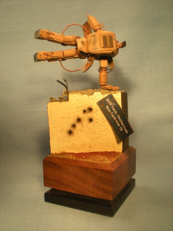

Here is a dio base I made a few years back, with foam as the core for the base, and the building, and coated with wood putty:
You can see some different finishes here-concrete, stucco, dry bare earth.
I stuck the wall piece to the base with toothpicks and white glue, and the whole thing to the wooden plinth with white glue.
Hope that helps!

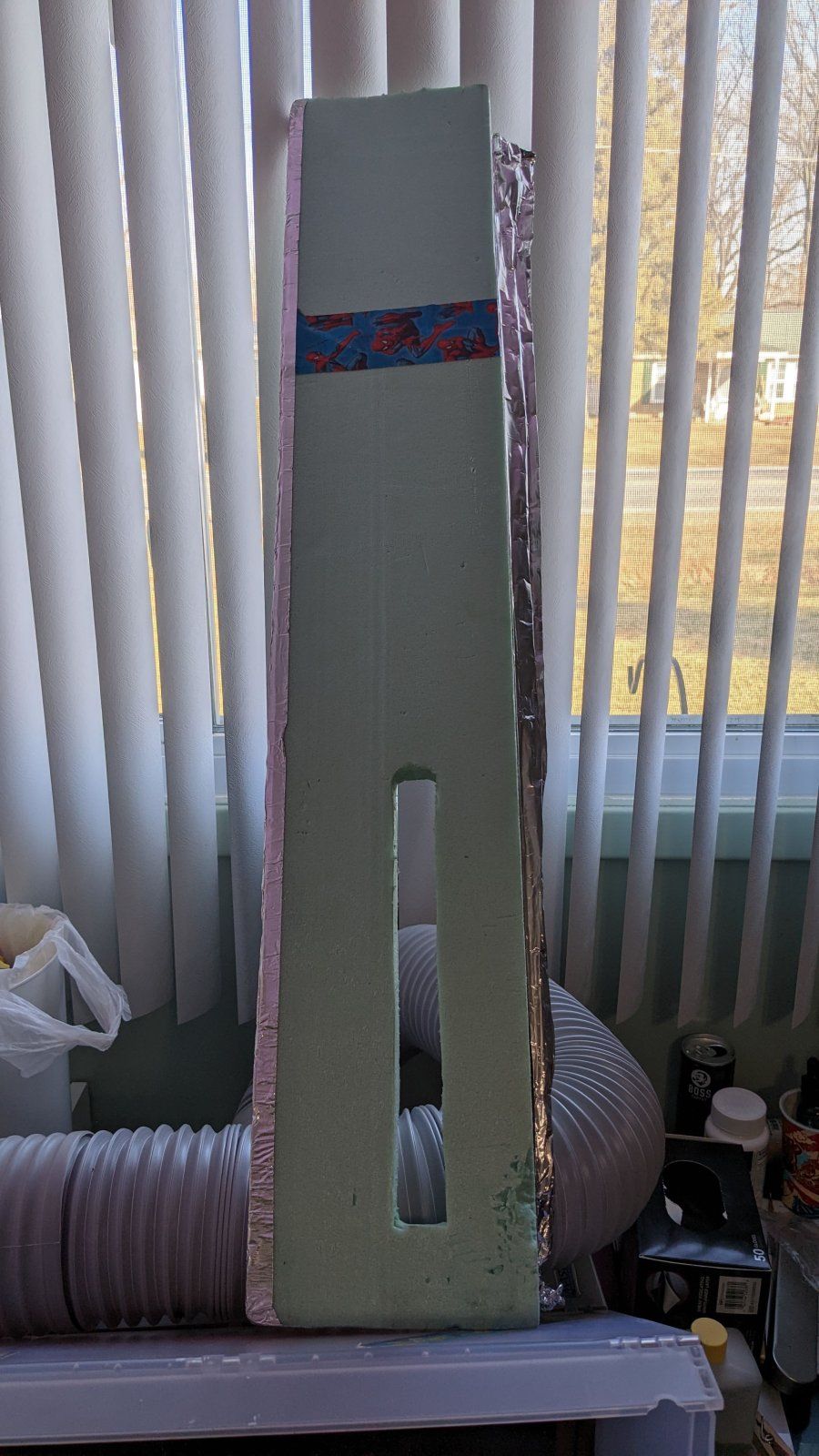

I love insulation board for so many projects. I bought a bundle of boards a handful of years ago and haven't made it through them yet.
I even used one to makeshift a window buffer for my spray hood vent outlet.
I think I originally picked them up to carve into headstones for Halloween, which is a project I'm glad I never finished because I use them for almost everything else, lol.
