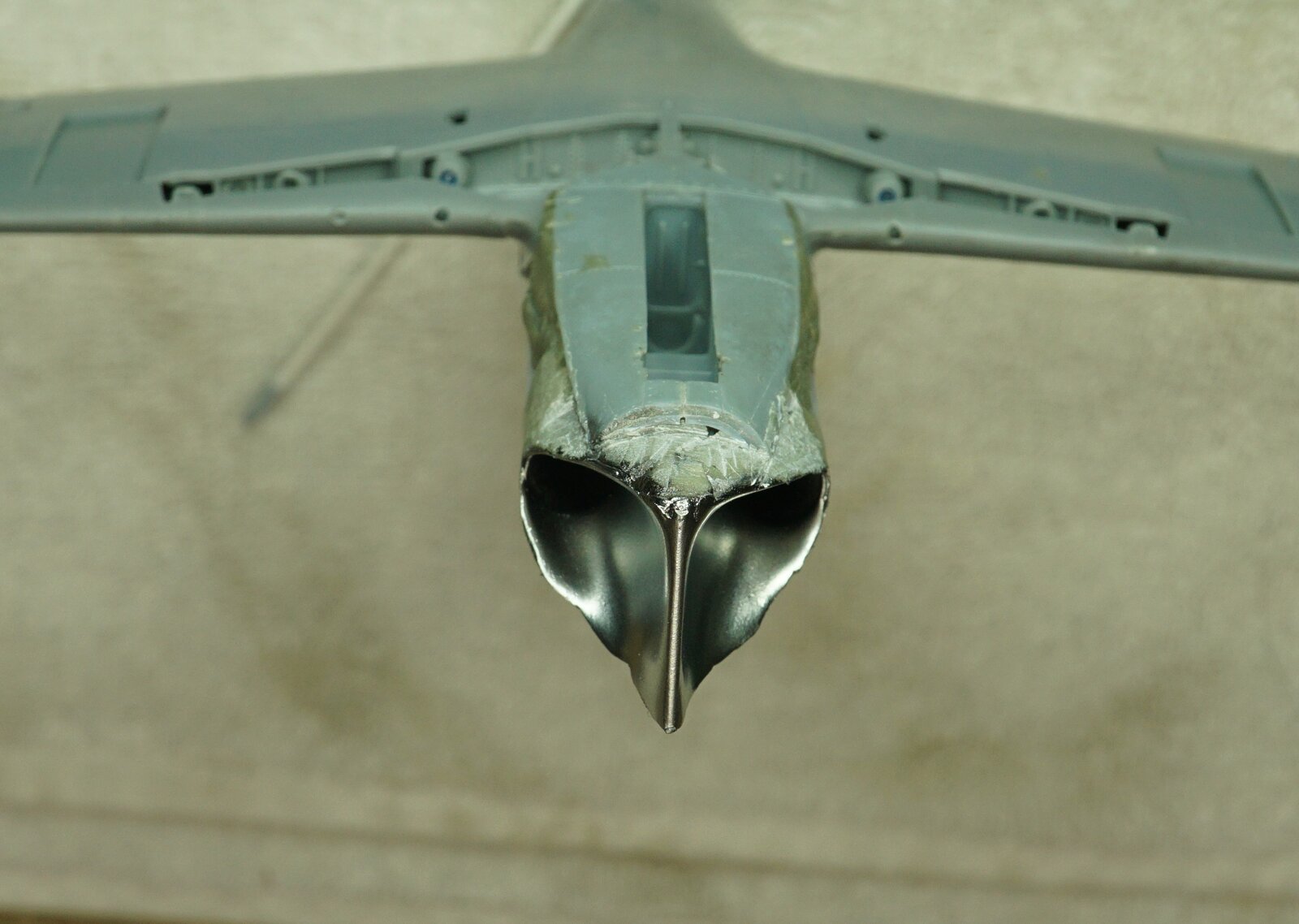

Form follows function , so once the cockpit tub is attached I'll see how much ducting will fit , what size and profile , still allowing for frames and stringers .
I need to completely finish out that main intake before going any further . That's going to be the trickiest part of this whole thing ,, I think .

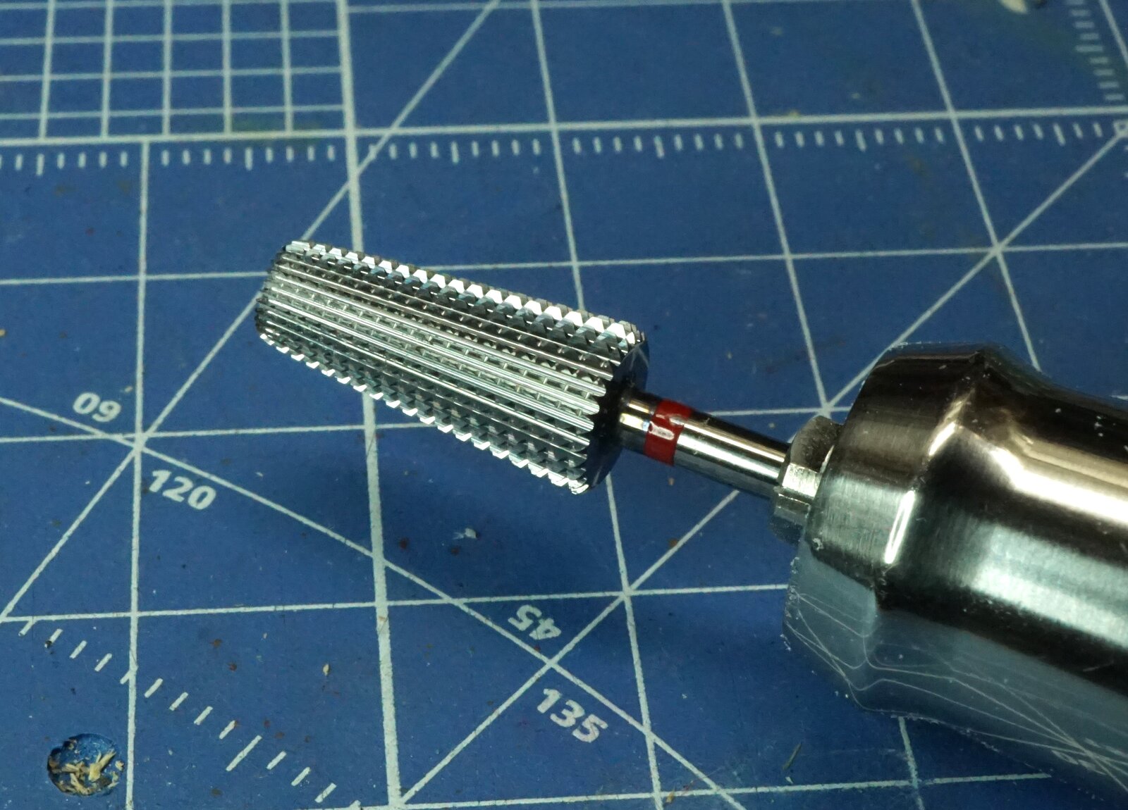

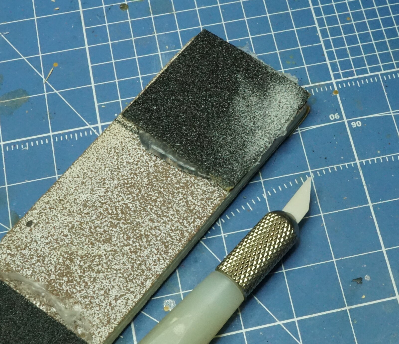

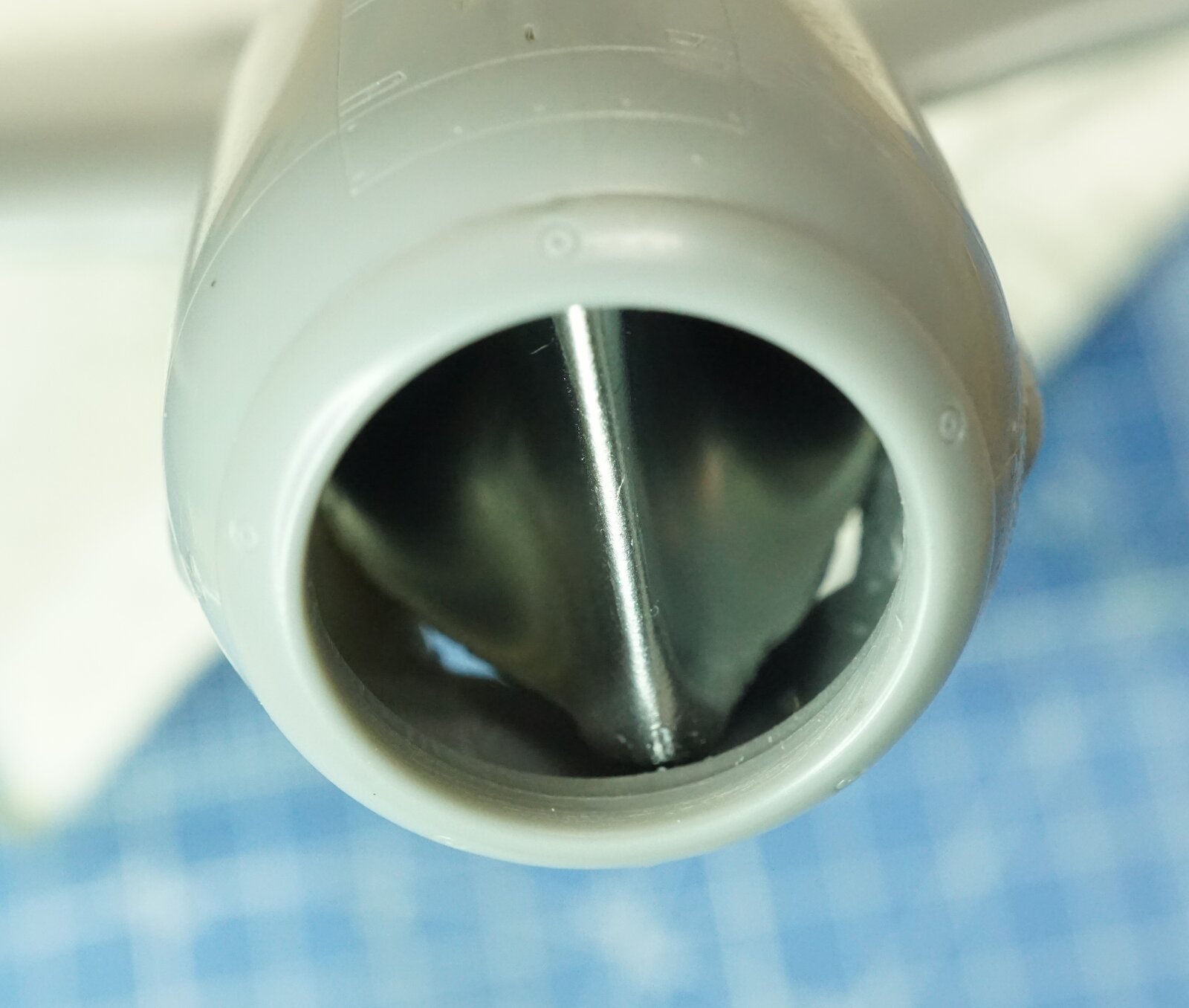

It was fairly easy sanding all that , finishing it off with that cowling in the way is going to be a bit more challenging .
The Aves will be paper thin in a lot of areas .
I'll be making some task specific tools for it , no doubt .
The cowling isn't epoxied in yet -- still debating the whole panel line requirement ,, if I have to do the outboard panel joints working thru the cowling , I can just do the inboard ones at the same time .
Thinking up a process to guide the scribe , I don't want to start a cycle of repairs inside there , lol
but ,
you can see how the Aves feathers into the lead tape ,
haha , happy for the audience .

Are you concerned with water intrusion ?
Last night I was pondering the duct geometry to shed water on it's way back there .
Dog leg trap action .
.. or a duct inlet door ,
of course , the radar would be useless in heavy rain
pulse doppler is at least weeks away , lol

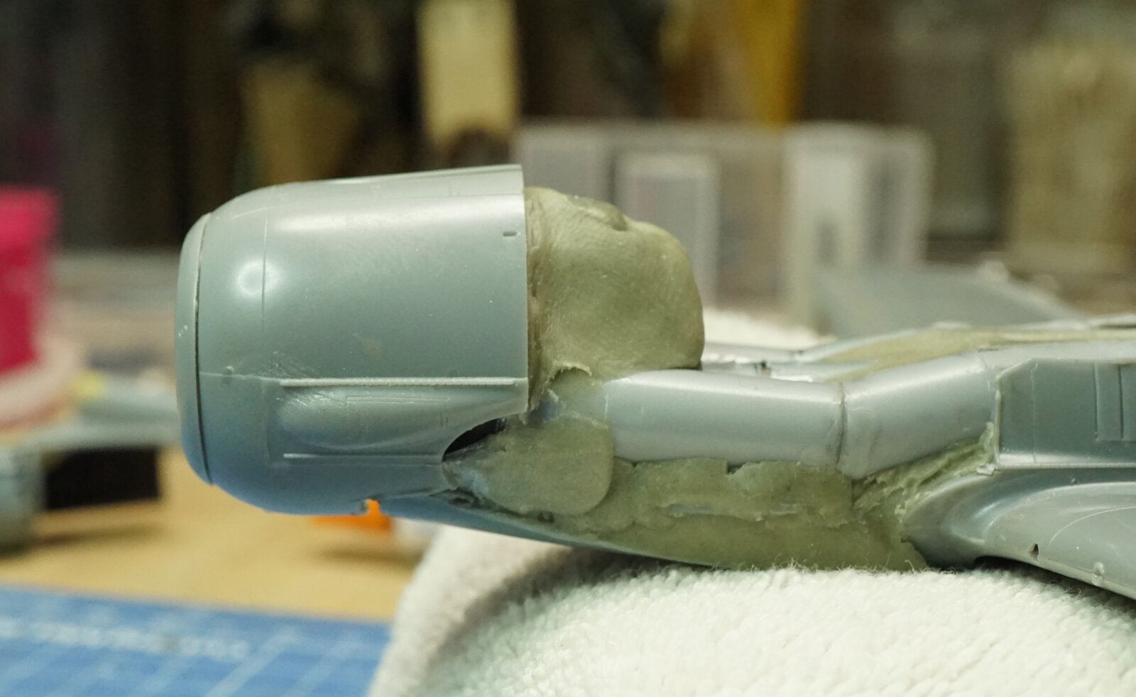

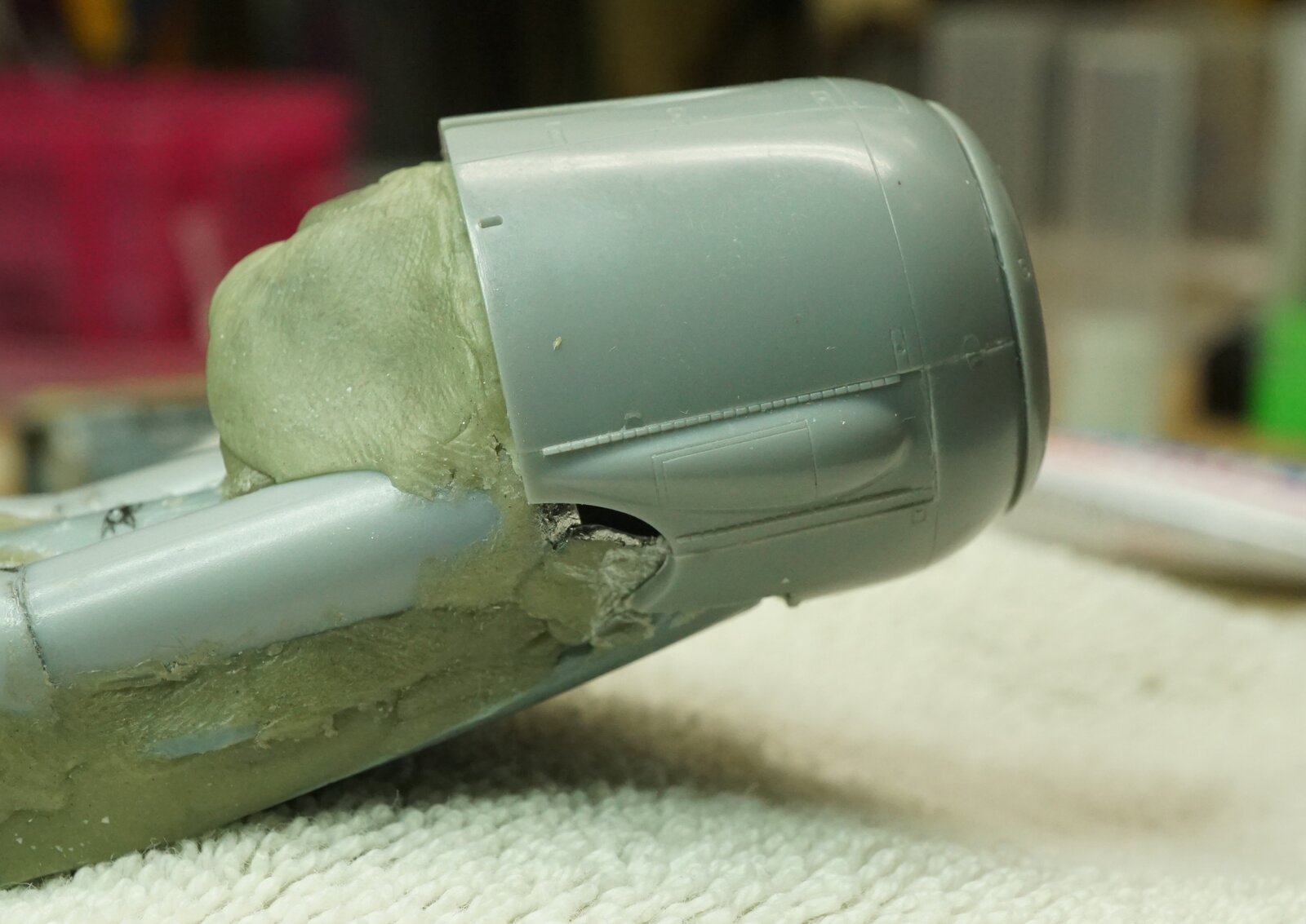

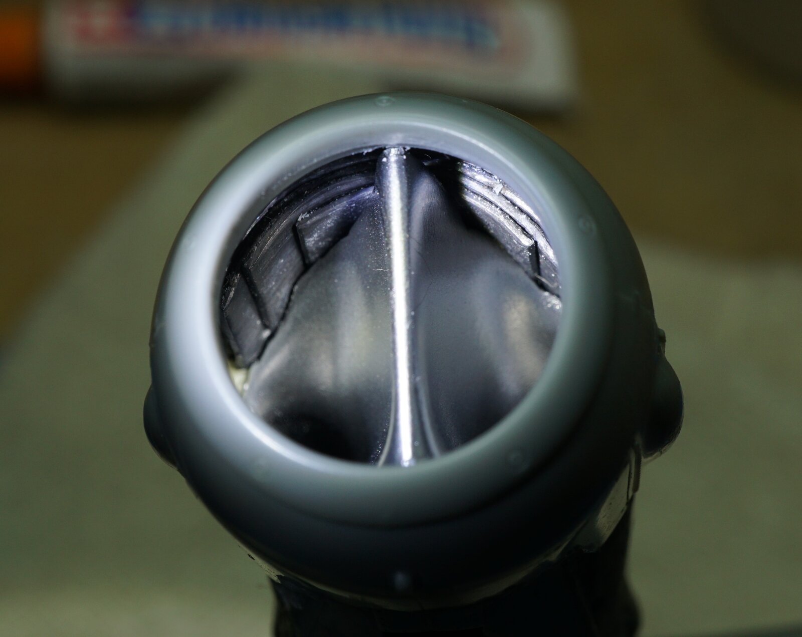

You can really see in these pix below how horrible a fit that trim ring is at the front of the cowling ,
from Hasegawa .
That Hobby Boss kit is a better kit .
Cowling is ready for the interior work ,

I now have a plan to easily and accurately scribe the longitudinal joints inside .
One easy jig and I'll need to make only one cutting tool .

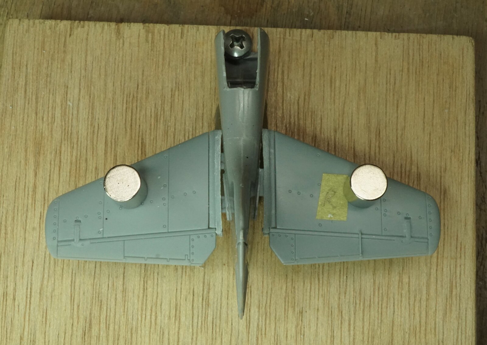

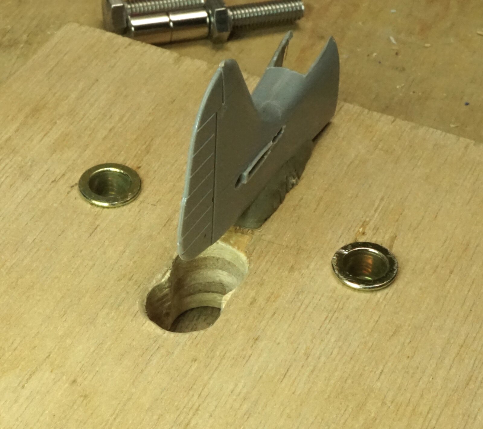

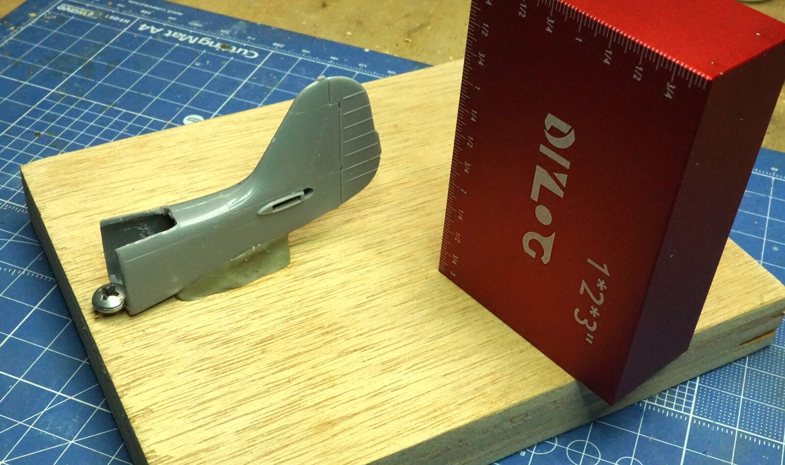

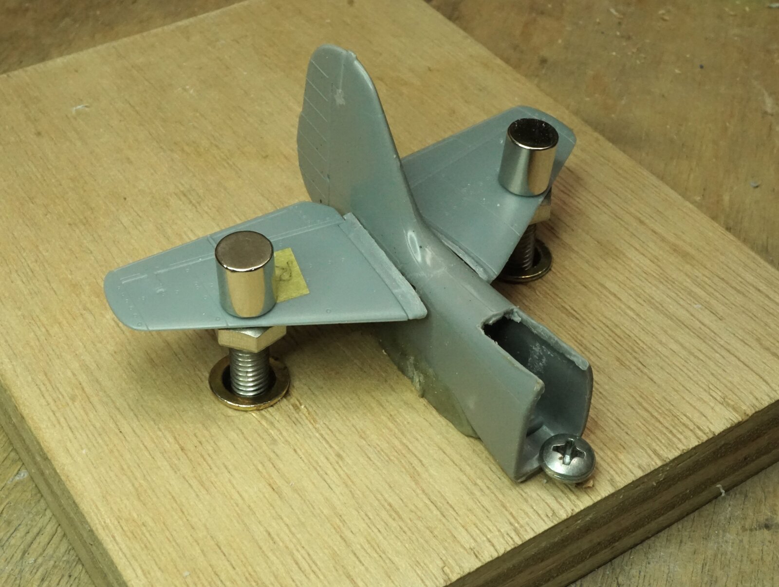

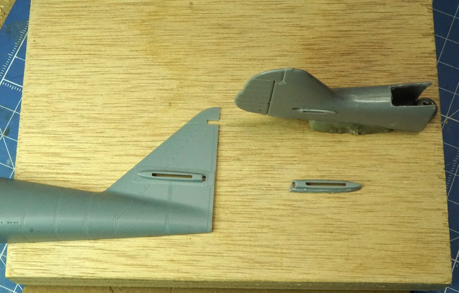

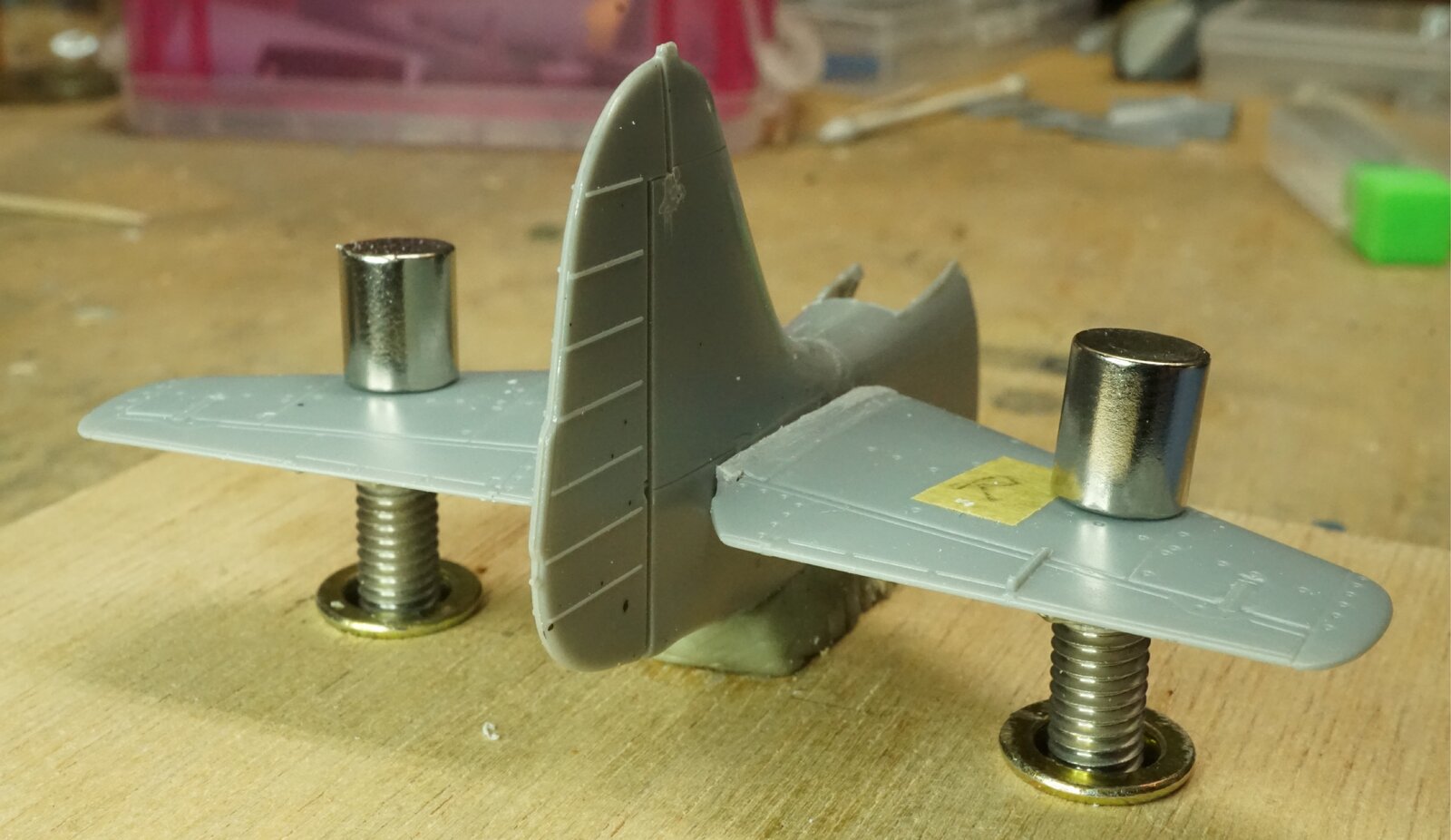

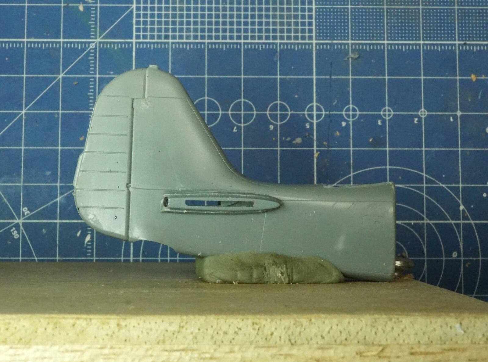

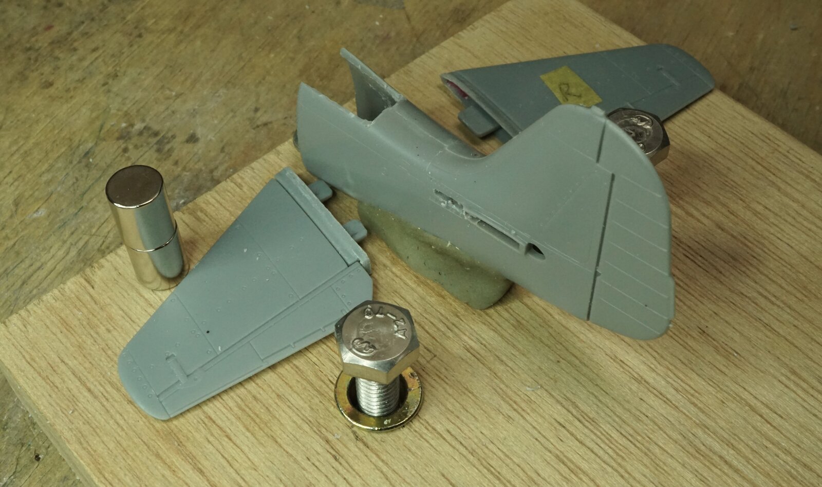

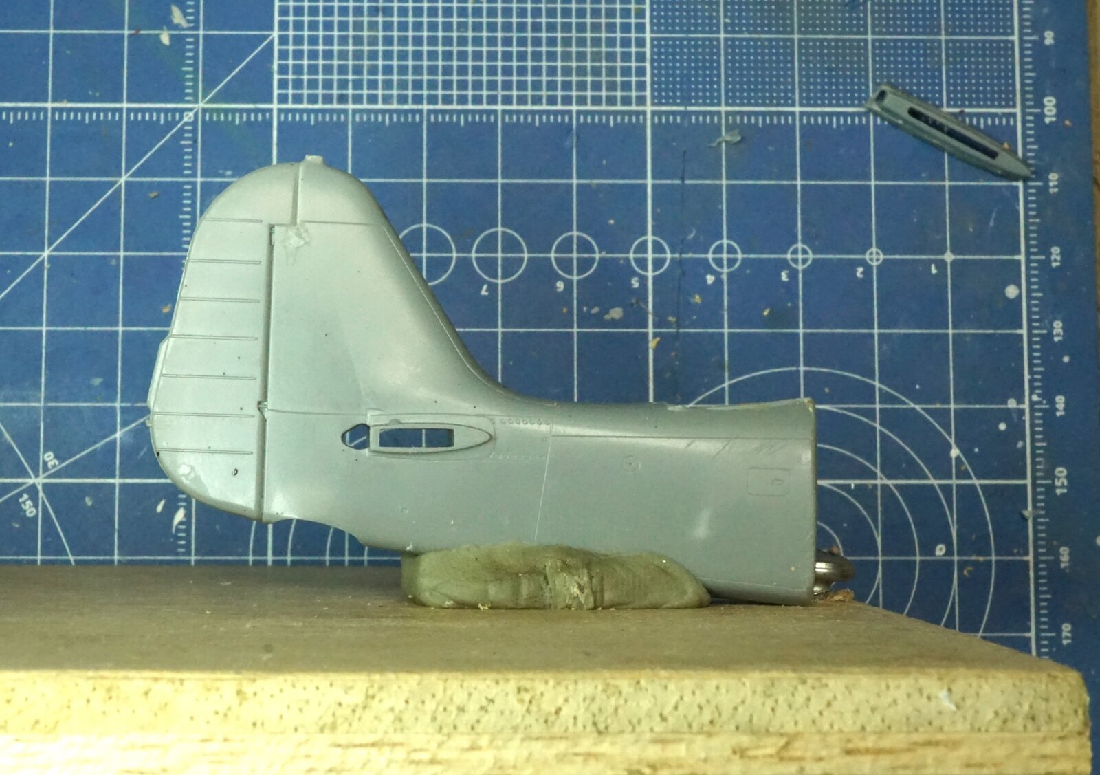

Last night I securely mounted the tail to Mr Plywood Scrap so it sits level and plumb to facilitate installing the horizontal stabs dead-nut square and in plane :

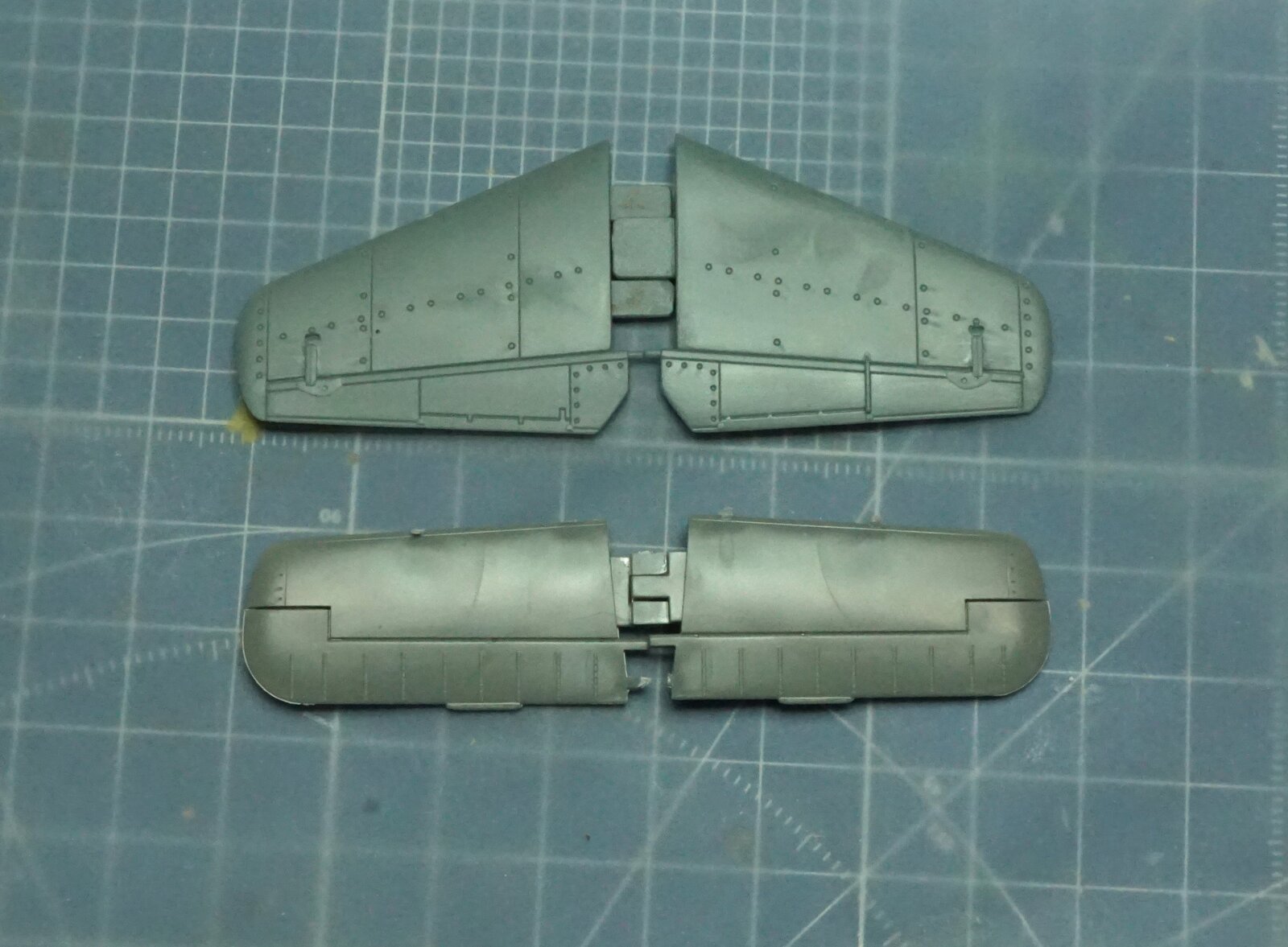

It gets the 262 stabilizers ,
Just roughed out and sitting there to show the position .
