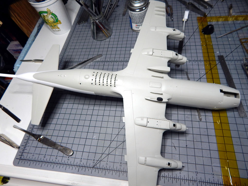

Starting off on the cockpit I needed to first fill in some mold marks on the seats and the cockpit floor. For the seats I used some 3M cloth tape to create the light tan seat pads and the dark grey seat belts. The kit supplied decals for the instrument panel and center console. However these were just outlines of the gauges and control boxes. I made a template of the decals and painted the background with the various colors so when the decals were applied the color was correct. The kit allows for two different versions of the nose cone. The solid one and the other version has a small canopy on the underside. The scheme I am doing has the solid nose so the instructions call out to fill the void with putty. Due to the size of the void I applied putty in layers so that each layer cured correctly. I also added two weights behind the cockpit assembly and one in the nose so that the model will sit correctly on the tricycle landing gear.
The fuselage was then assembled. Surprisingly for such an old kit the fit was very good. I then assembled the engines and main wing. The propellers all had mold marks on the backside which required to be filled with putty as well. The only portion of the aircraft that gets painted white is the middle and topside of the fuselage. I installed the windshield which also fit very well. I then began using kapton tape to mask off the windshield sections. I am now working on masking off the areas so I can spray the white section. I still need to clean up the wings and engines so they can be installed onto the fuselage. Then I can mask off the white areas and spray the gull grey. I am also working on the squadron specific decals that I will need to make. I am also going to make a copy of the kit decals just in case I have issues. The kit is from 1979 and the decal sheet looks its age. If the decals start to break apart (especially the larger ones) I will be able to create new copies.

For the second week of the P-3C Orion I masked and base coat painted the fuselage with the white over gull grey paint scheme. I used kapton tape to mask off the windshield and the fuselage. While the white was drying, I built up the propellers and painted them to match the reference photo.
I then installed all the under wing hard points and the two inboard pods and attached the wings to the fuselage. For as old as this kit is the wings to the fuselage was an excellent fit. The white sections were masked off on the aircraft and the gull grey base coat was applied. The nose was painted black and the latches were painted gull grey.
I then spent two nights creating and scaling the specific VP-8 scheme decals. I had a difficult time locating the tail logo but I was able to use a reference photo and recreated the tiger head. I am unable to print in white so the grey area will be printed on white film decal paper then trimmed with w hobby knife. I went to apply the propeller decals and realized the kit decal sheet had a section that was slightly off register. (Colors not aligned within a single decal) so I made the propeller manufacturer decals as well. The propeller decals were then applied and the top coat of clear was done.
I am currently working on the landing gear and the bays. The bays have very limited details so I will be adding some. Also the landing struts and the wheels have a lot of mold marks so these needed to be filled with putty. I plane on getting the landing gear installed and then I can start applying all the decals.
