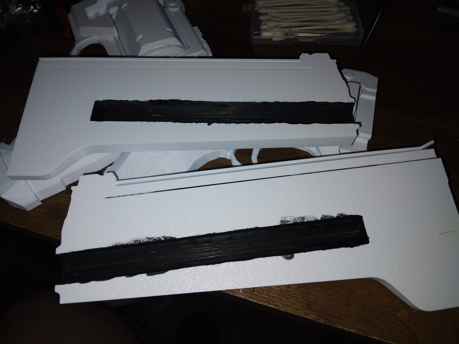

Clean up was a pain with all of the supports and I have already started the paint process by painting the barrel black. next step is to assemble the guns. It should be easy, only 4 parts and he provided the glue for it. However I am not looking forward to seam filling.

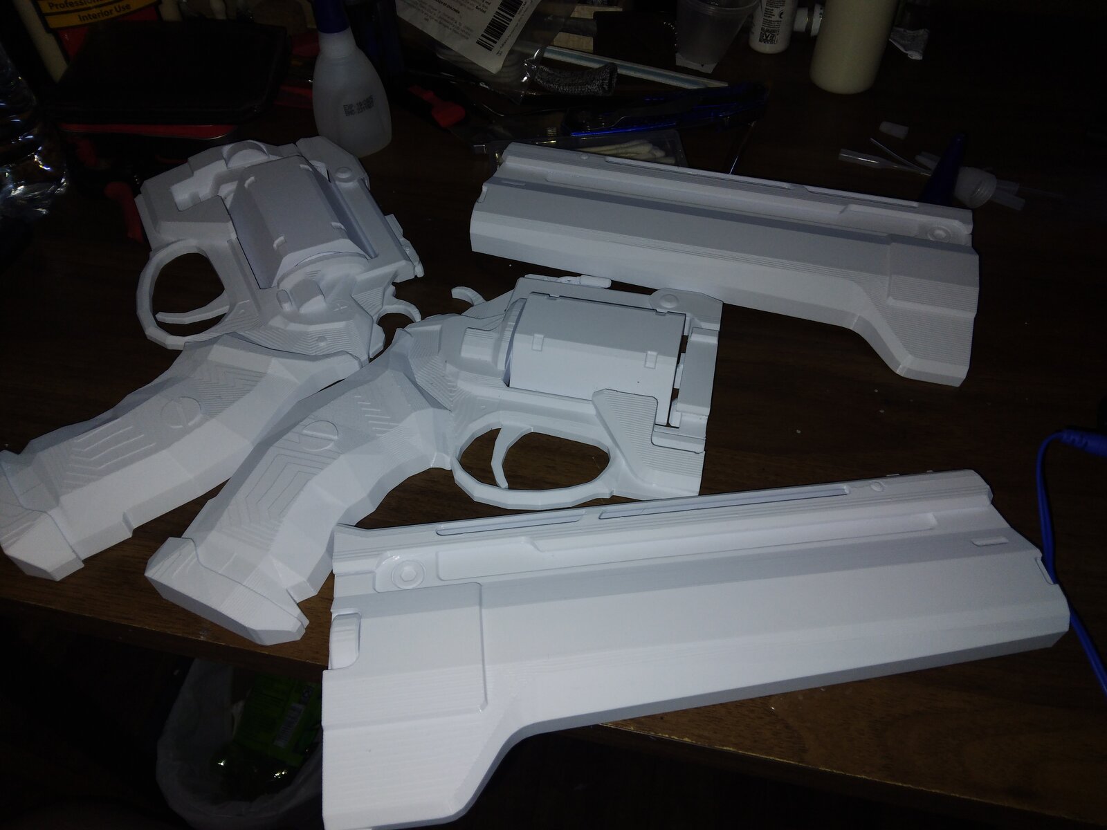

I got the parts together and here is how it looks.
A little more sanding and a little more putty and the seams will be filled.

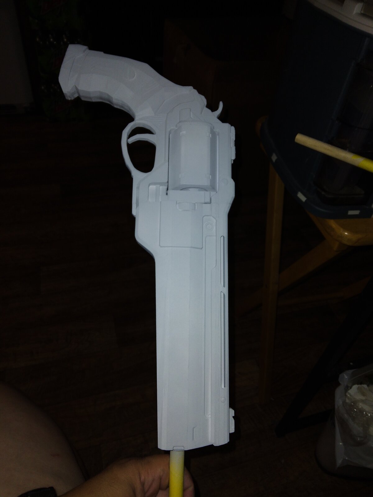

I have filled and sanded the seams, and they are looking good so far. On one of them there is a little more filling and sanding to do. Some how there were voids in the putty I used. I've never encountered that before, I think it is because I hade to use so much to fix a mistake I made.

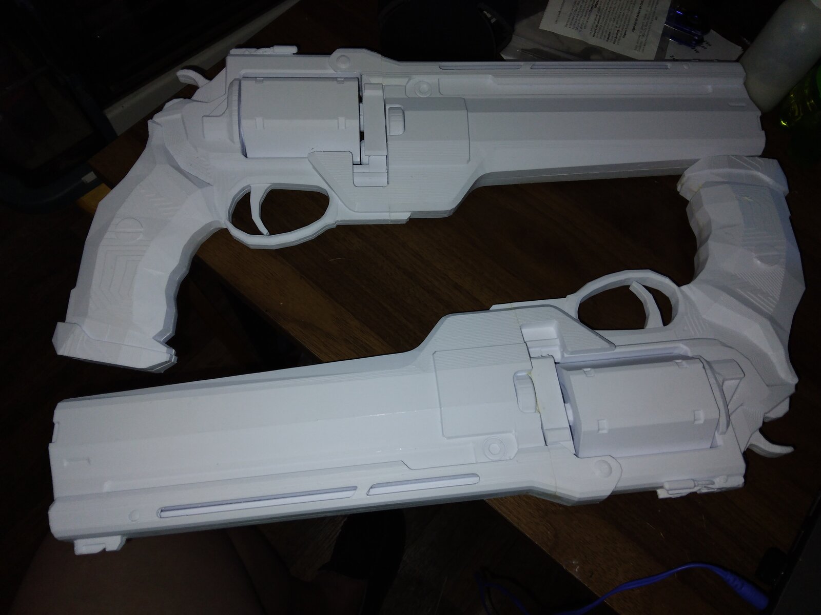

As promised-photos

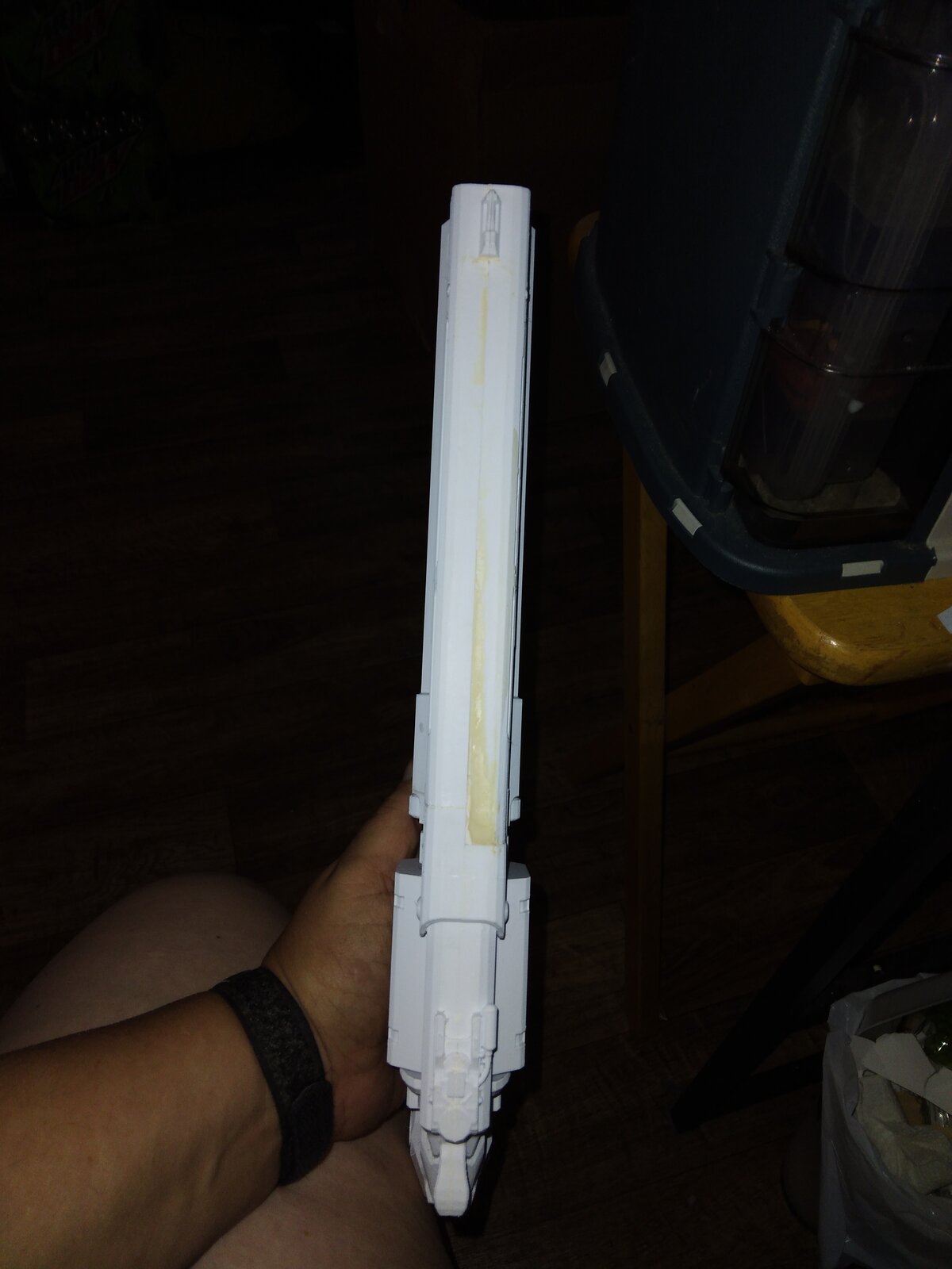

Finished sanding and filling the seams. Some of the seams were a fair size, up to 1-2 mm
With this gun, the barrel halves kicked just a bit when I went to clamp the halves together. I saw right away but the glue had already set so the halves were about 2-3mm from being aligned. It was here that I was getting some voids in the large amount of putty I used.

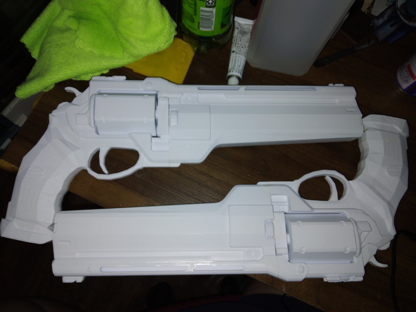

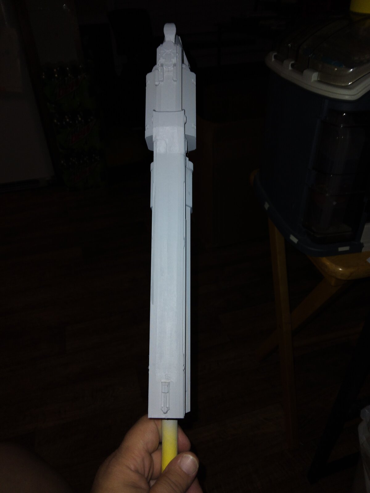

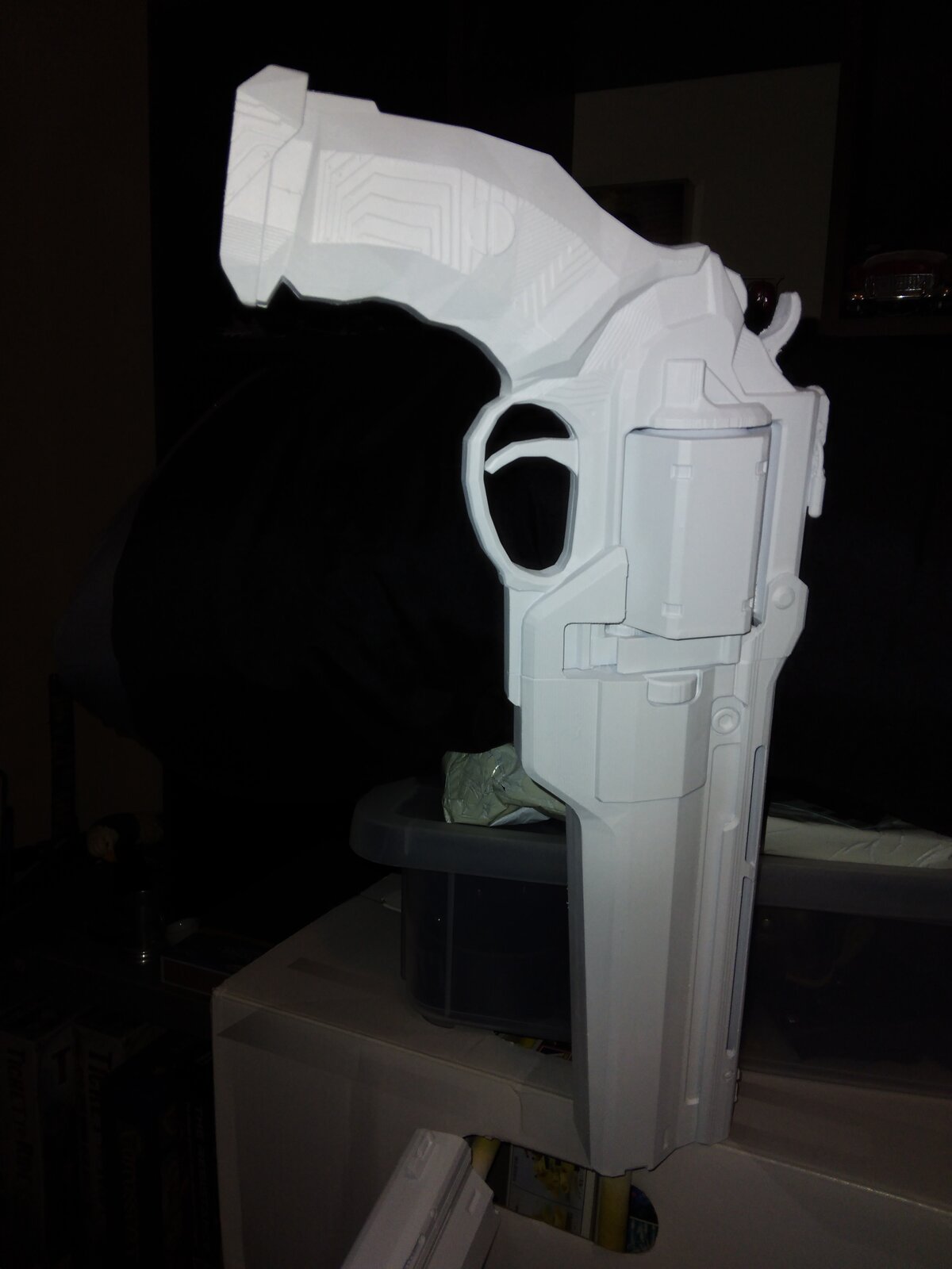

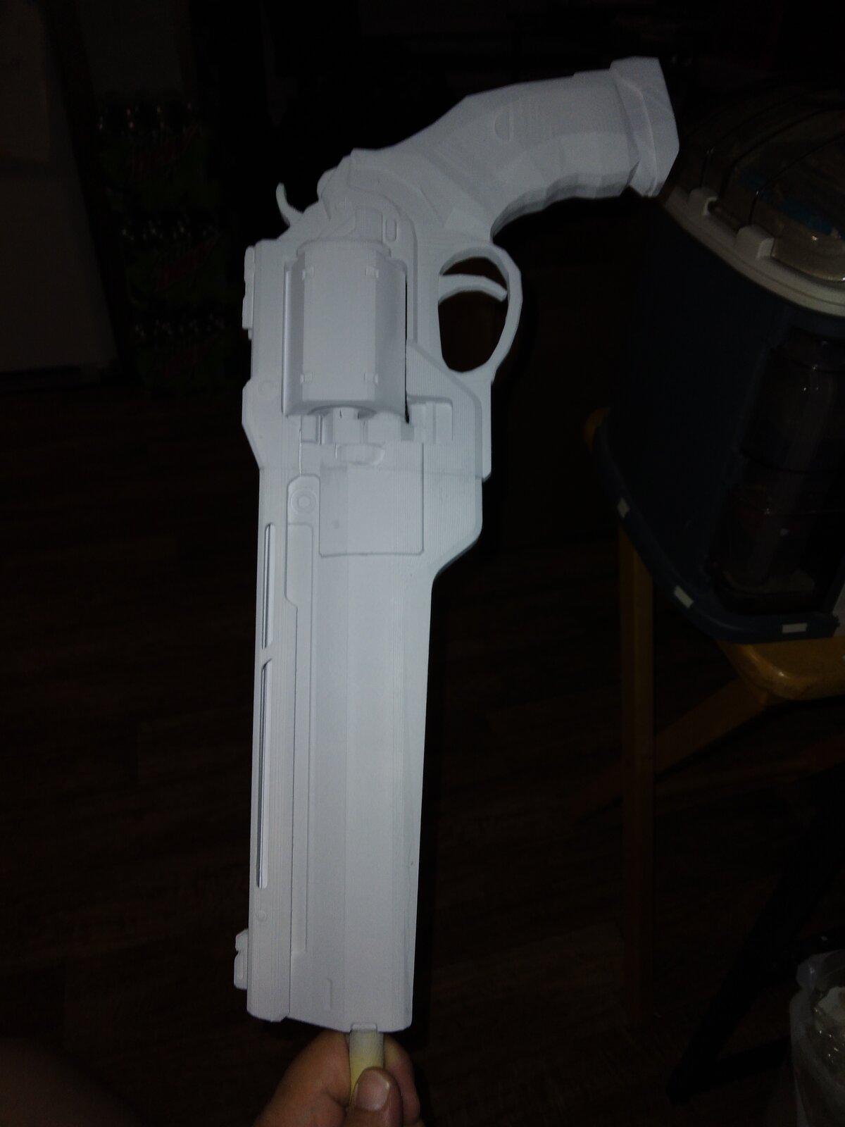

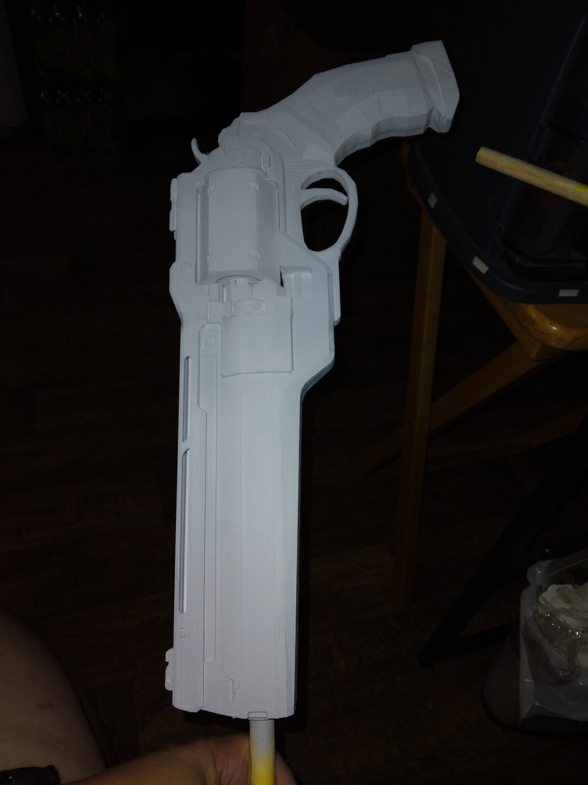

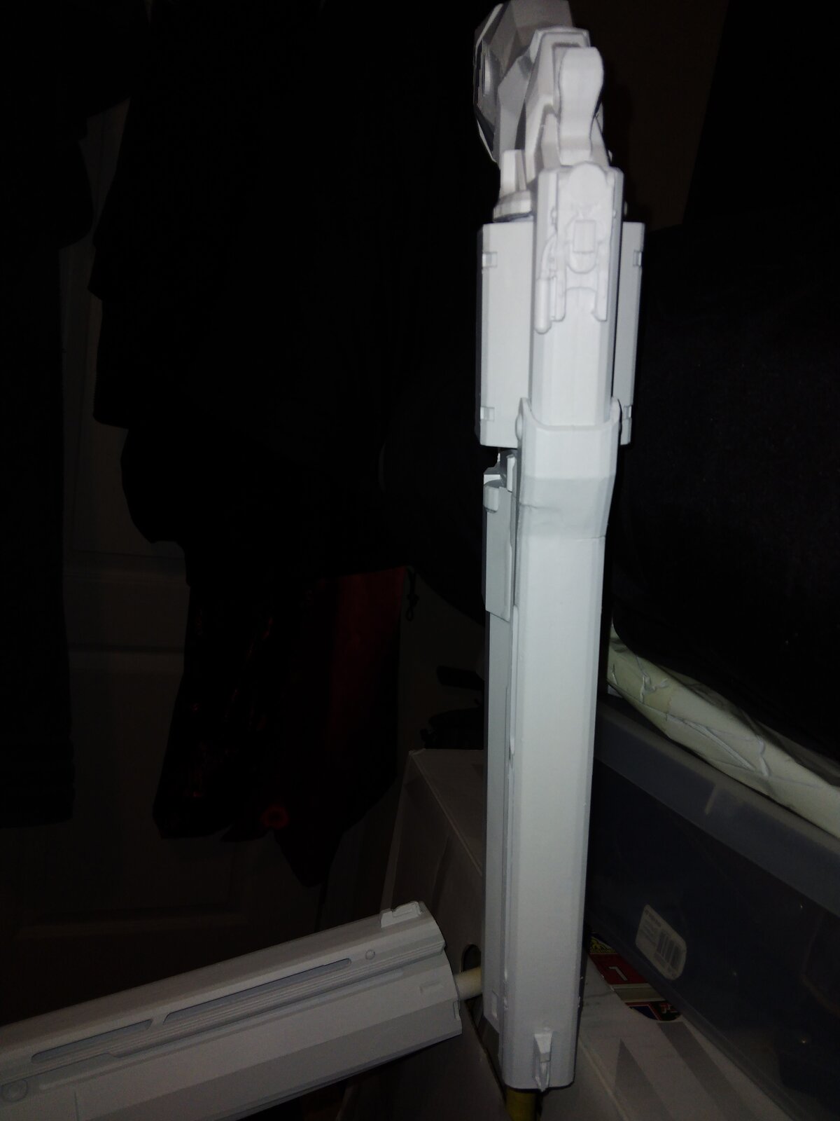

Here the guns have primer on them
Next is to get the black and white paint so I can finish the paint job, then a gloss coat over that to seal it all.

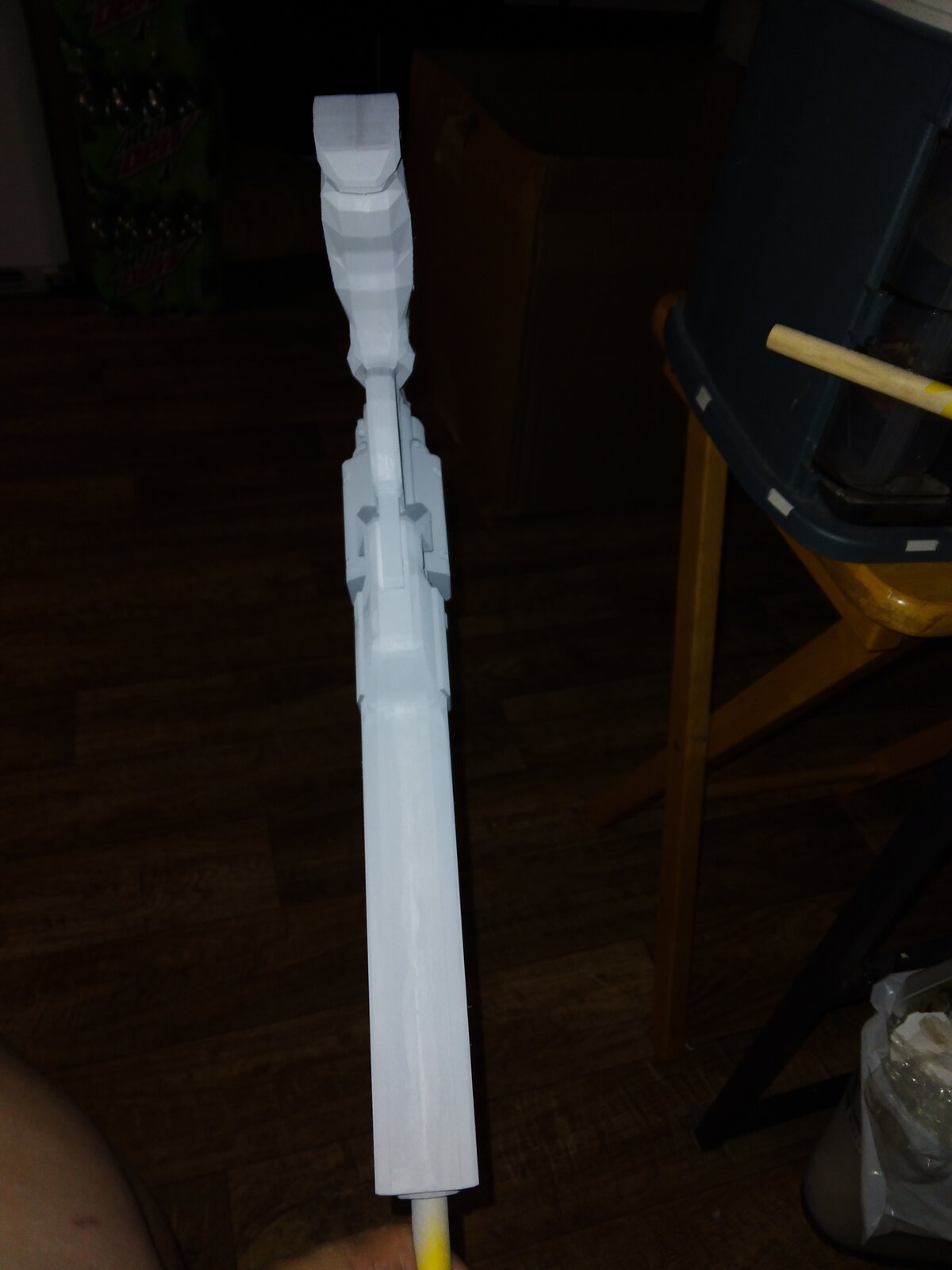

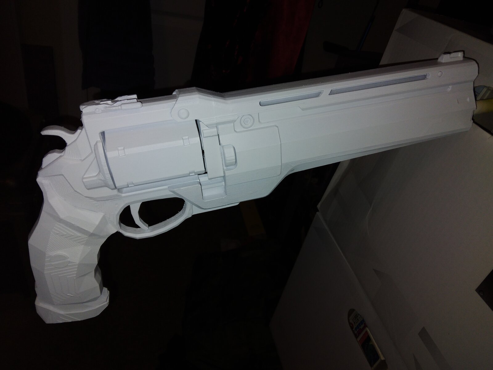

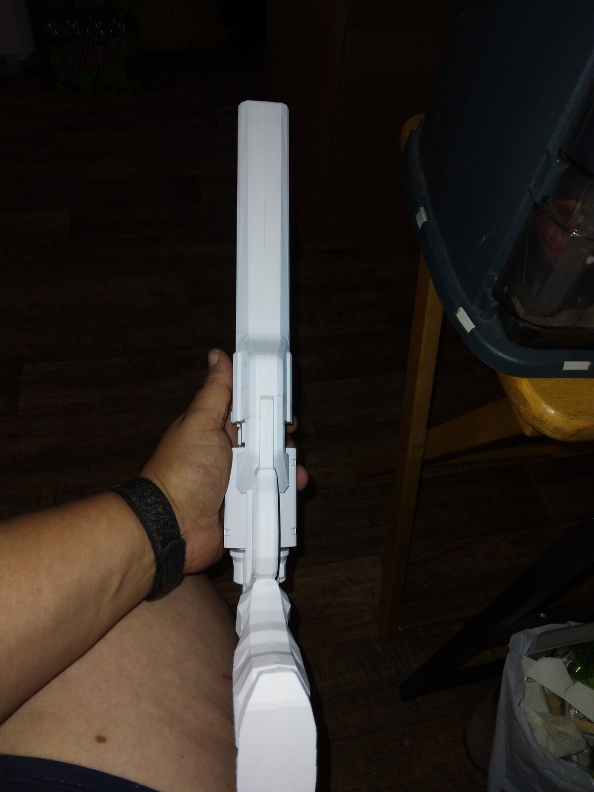

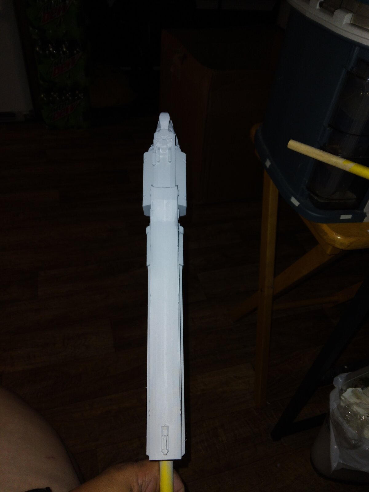

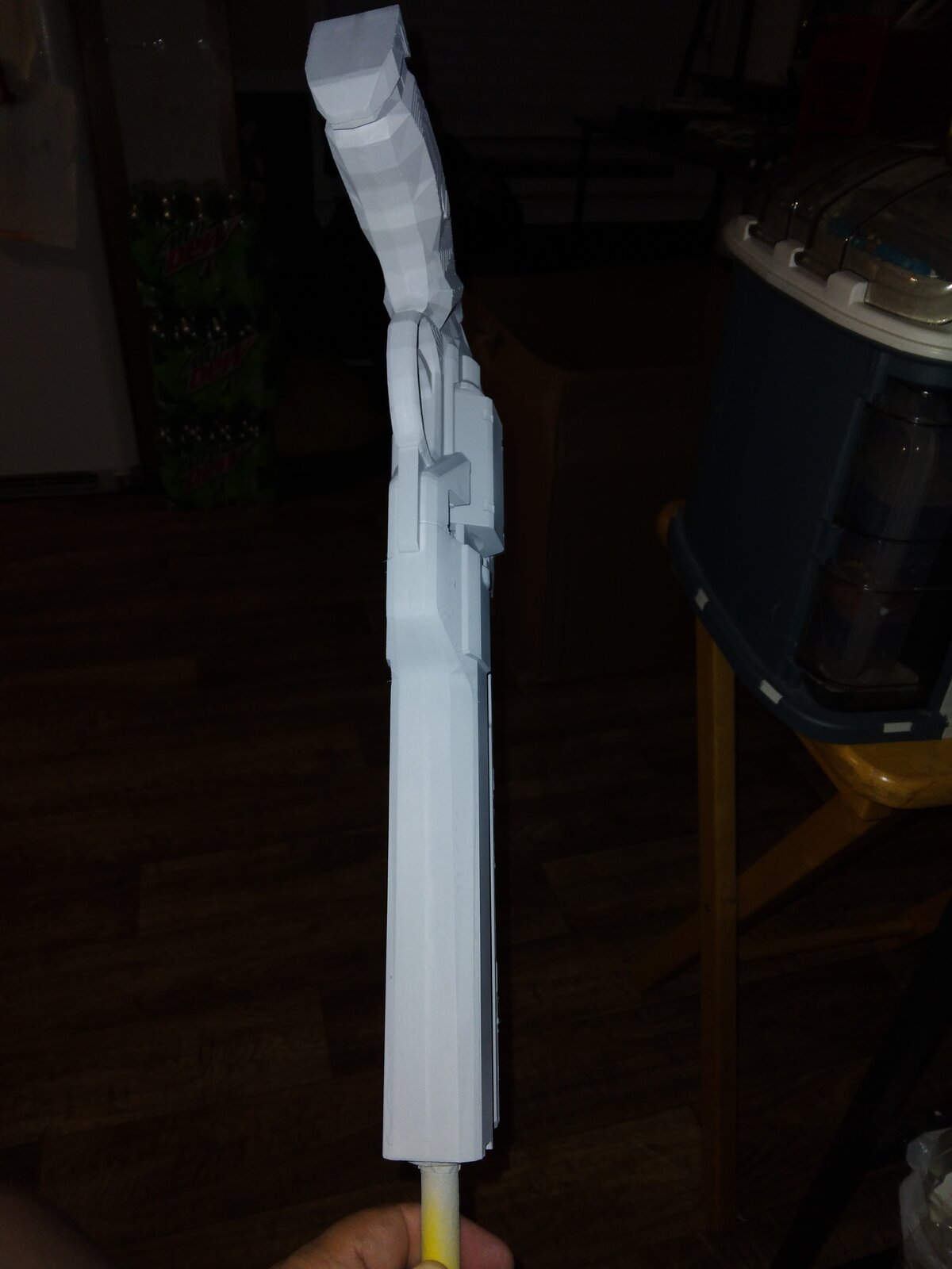

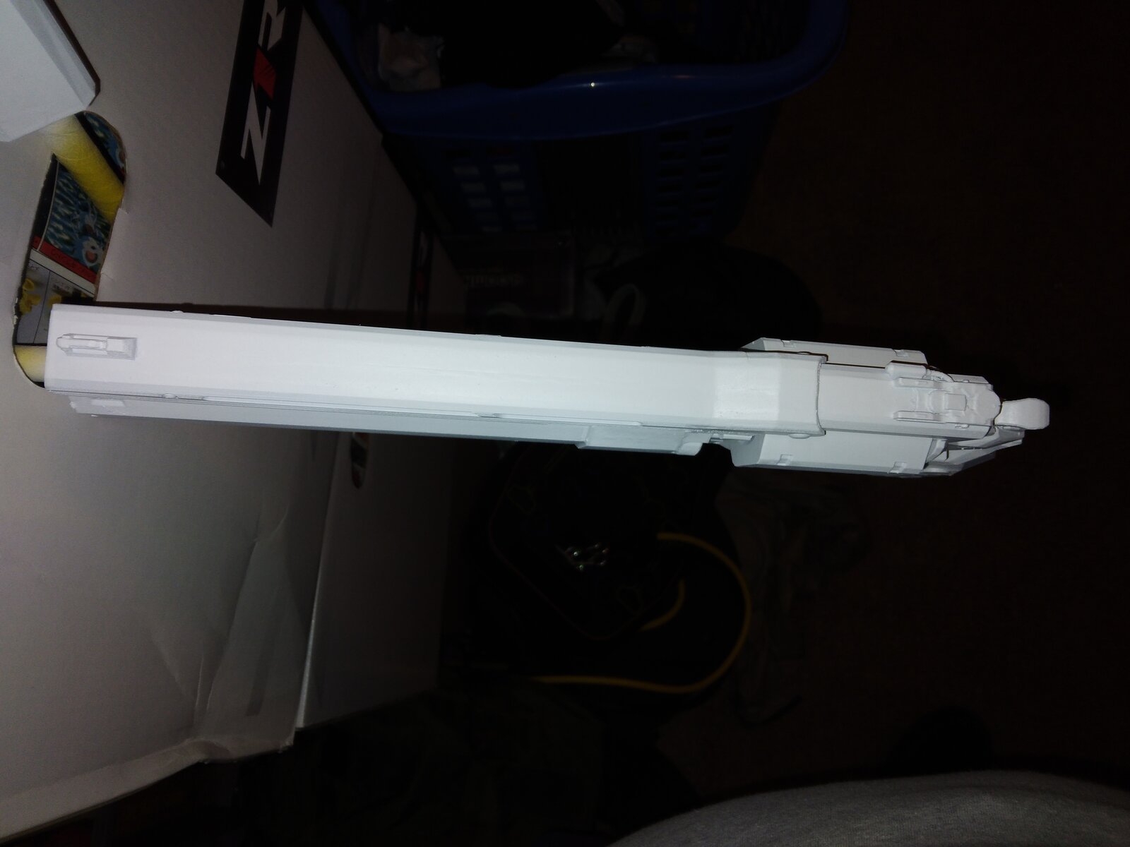

Well I got the white base layer down this morning before work, after it dries I'll be posting a photo or 2 of them. The white didn't go as I had hoped it would, it took almost 6 coats for full coverage. Now what I am dreading is making the stencils for the spade symbols that go on the guns. I'll keep you updated
Here are the photos. I was going to post them last night, but after my shower I just fell asleep in my chair watching a show, snapped awake about an hour later and decided I should sleep in a bed, so I did.

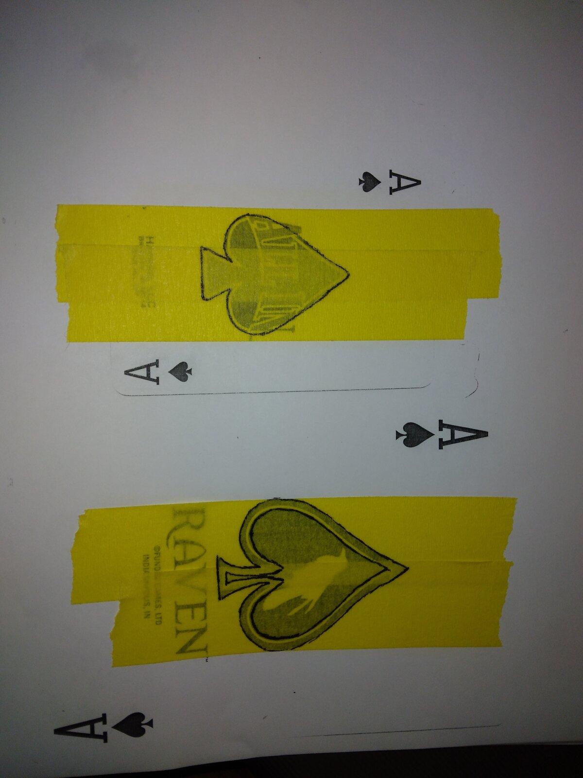

Here are the stencils I am making for the spades on the gun. I spent almost a week looking for decals or stencils, but everything I found was too small or I wouldn't be able to use it due to it not being flexible enough.
I then looked through my collection of playing cards until I found ones that would work, photocopied them and making the masks out of masking tape (what else would I use :))
I have 4 sheets that I made, all that is left is to cut them out and apply them to the guns after making off all the areas that are to remain white.

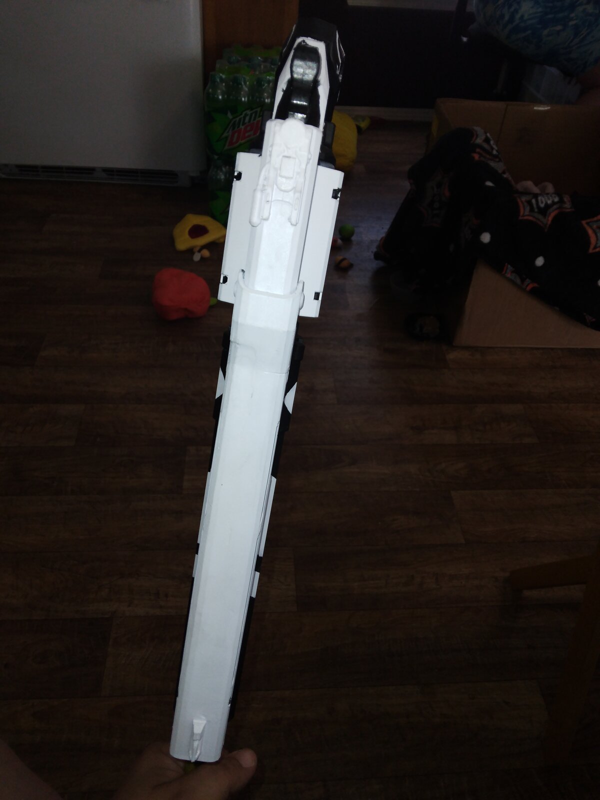

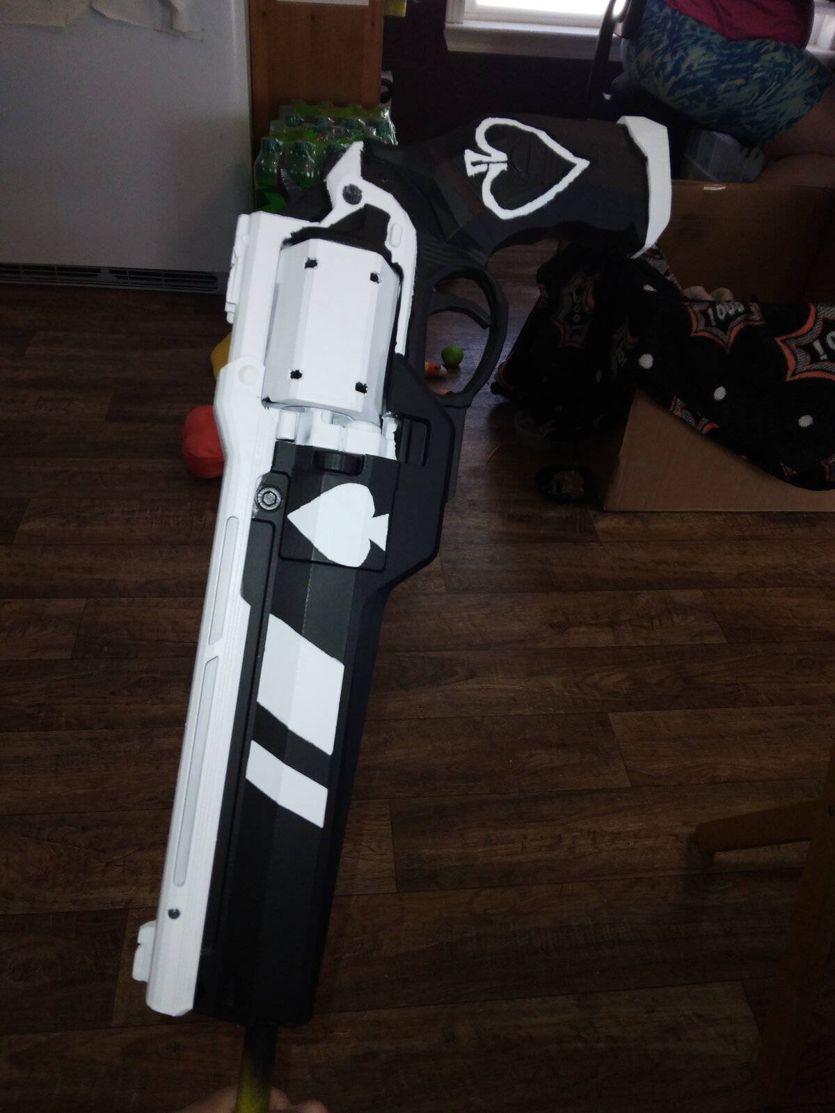

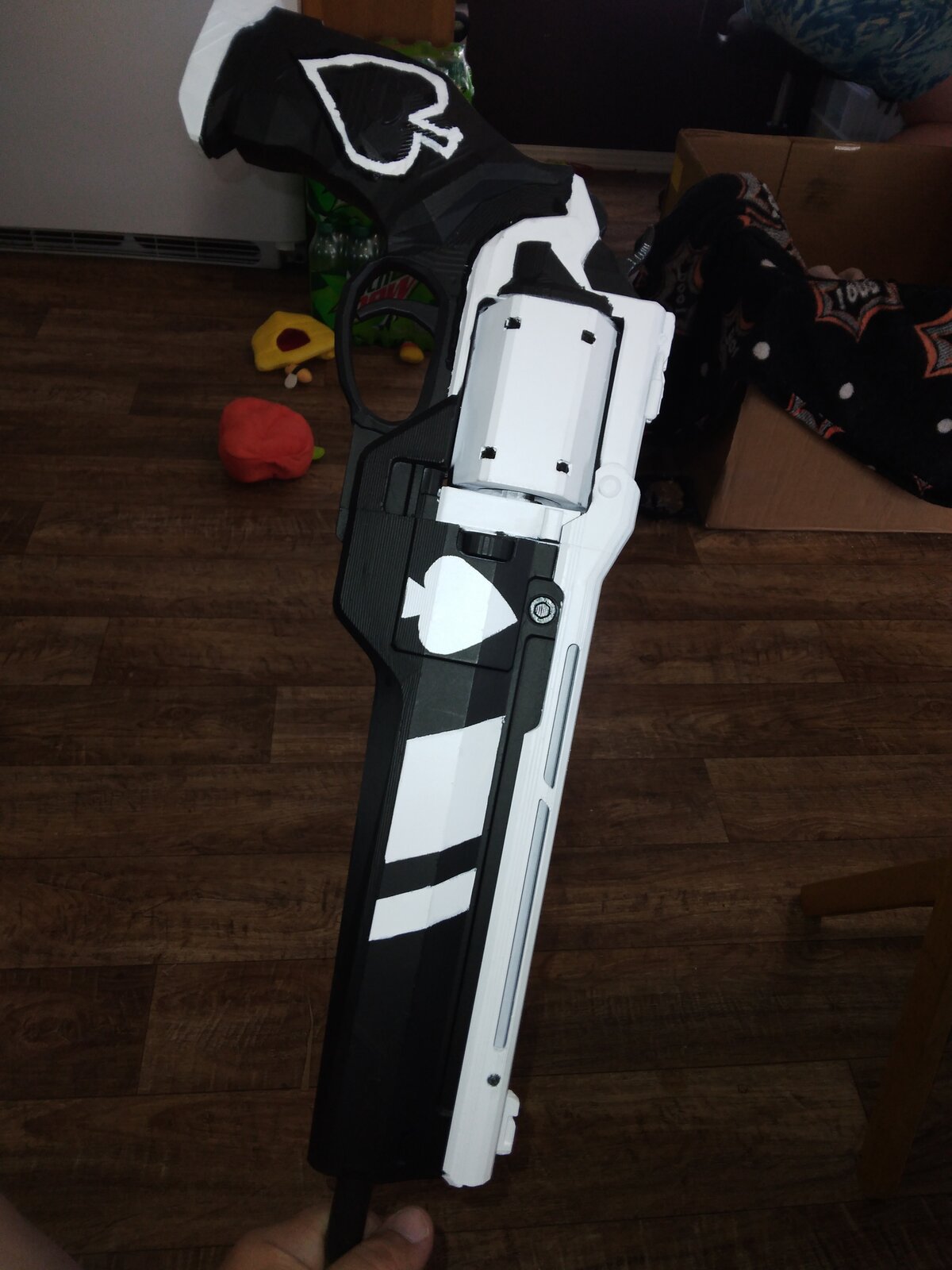

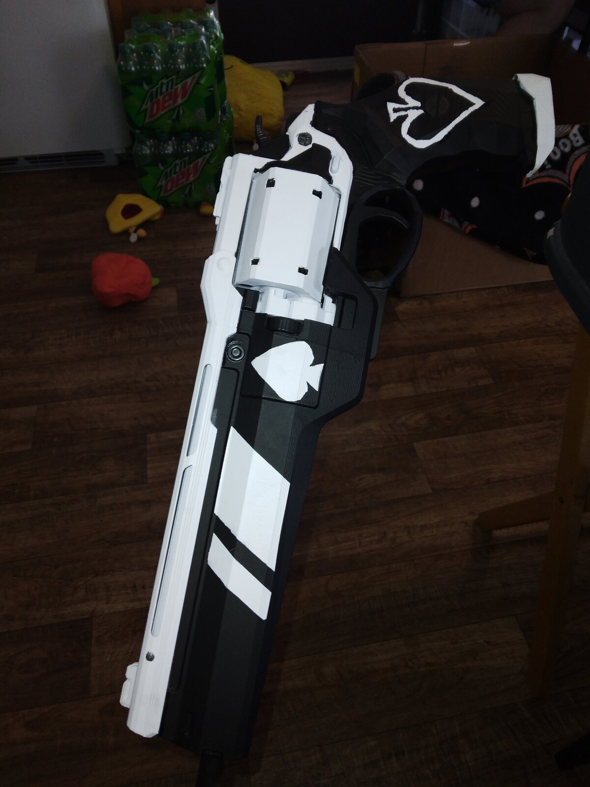

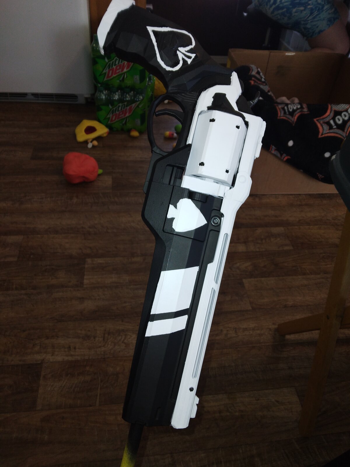

And I am calling this one done. All that is left is to apply the satin clear coat and let it cure.
The only problem I have with the paint is the spade outline on the grip. My original idea did not work in the slightest, and I tried 4 different methods before I free hand drew them with a liquid mask. Afterward I touched up the rougher area with white and black paint.
All that said I am pleased with how well they turned out.
