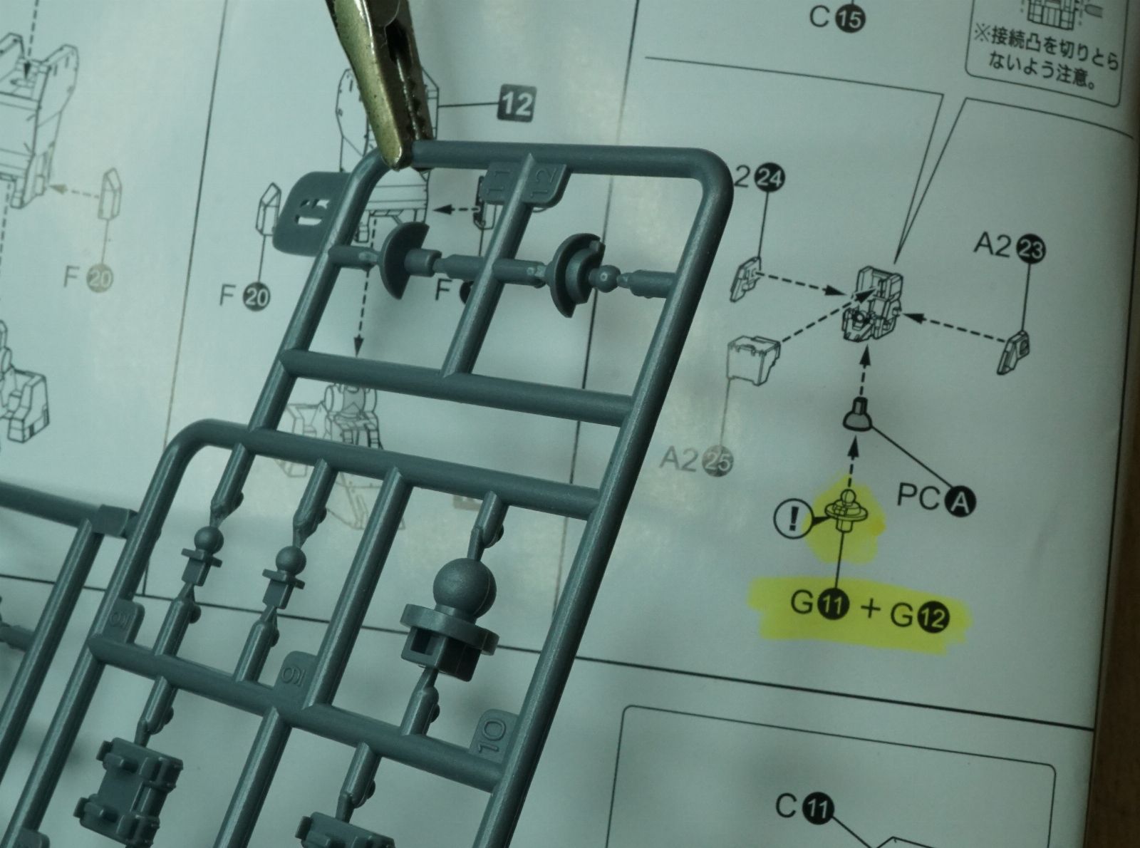

First step in the build .

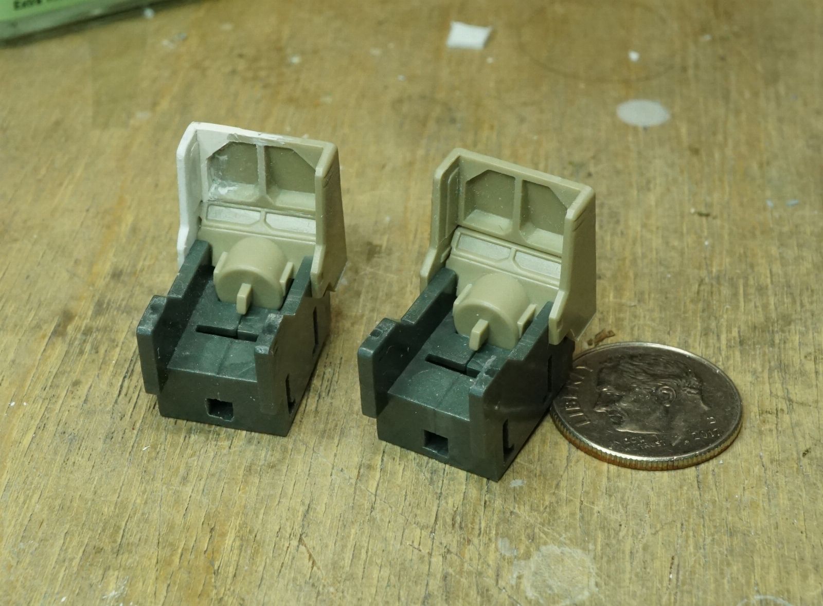

Notice anything wrong with the piece on the right ? :D
That broken off chunk wasn't in the plastic wrap , so it was gone before it was bagged .
Well ,
at least it's hidden for the most part once complete ..
Oh , wait
guess I gotta scratch it out
One day I'll build a kit that just goes together .
One day .
Maybe :D
Hopefully no more surprises ,

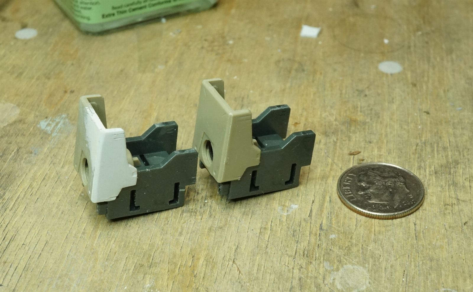

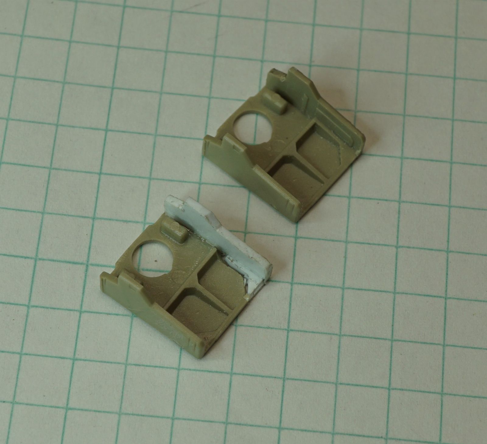

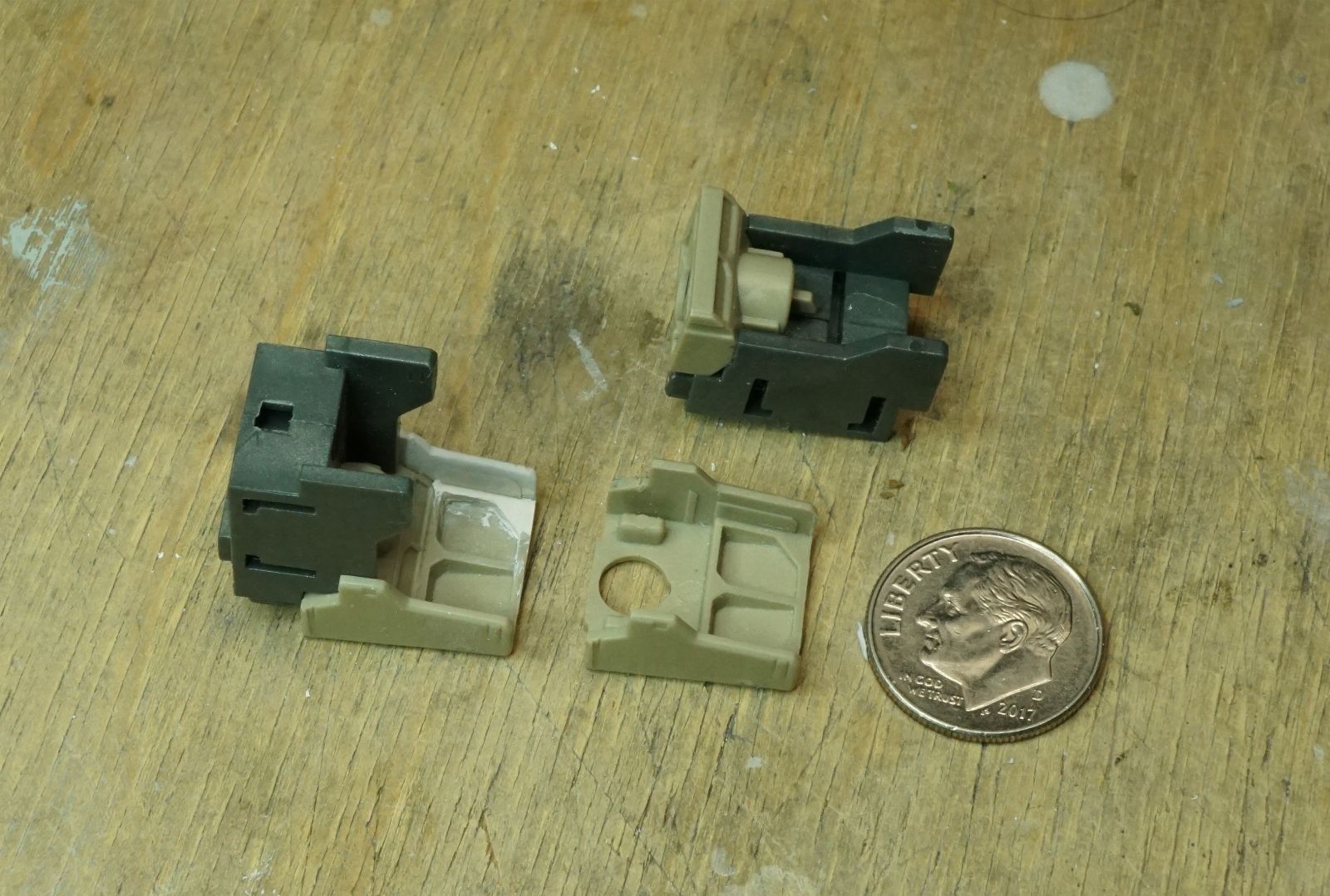

1 mm and 1/2 mm styrene , plus 1/10 mm clear sheet for that tiny , raised panel on the interior side -- finished with Tamiya lacquer putty . Then some knife and chisel work for the exterior details :
Roughed -in
Then pushed up against the good one to sand it to the identical profile ,
