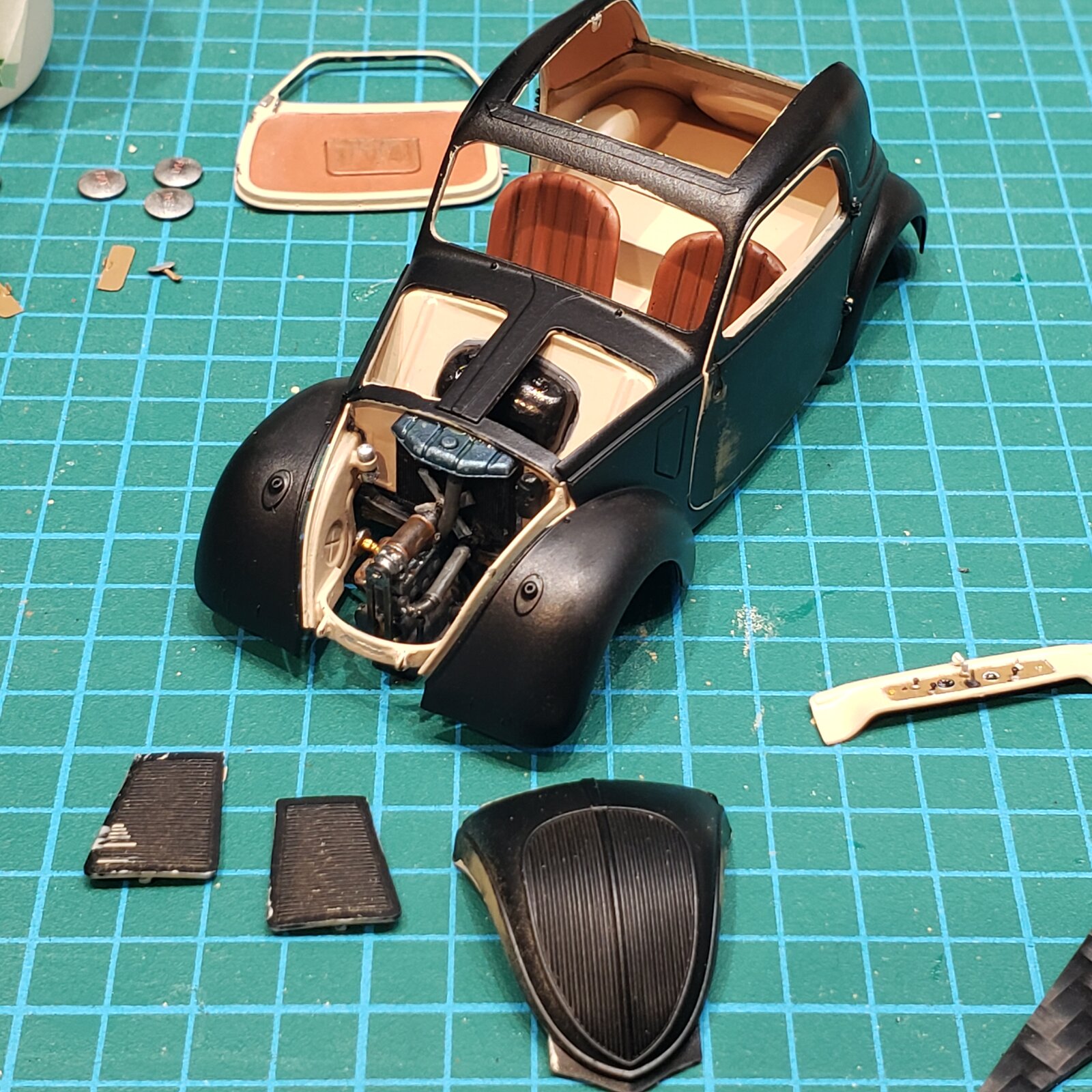

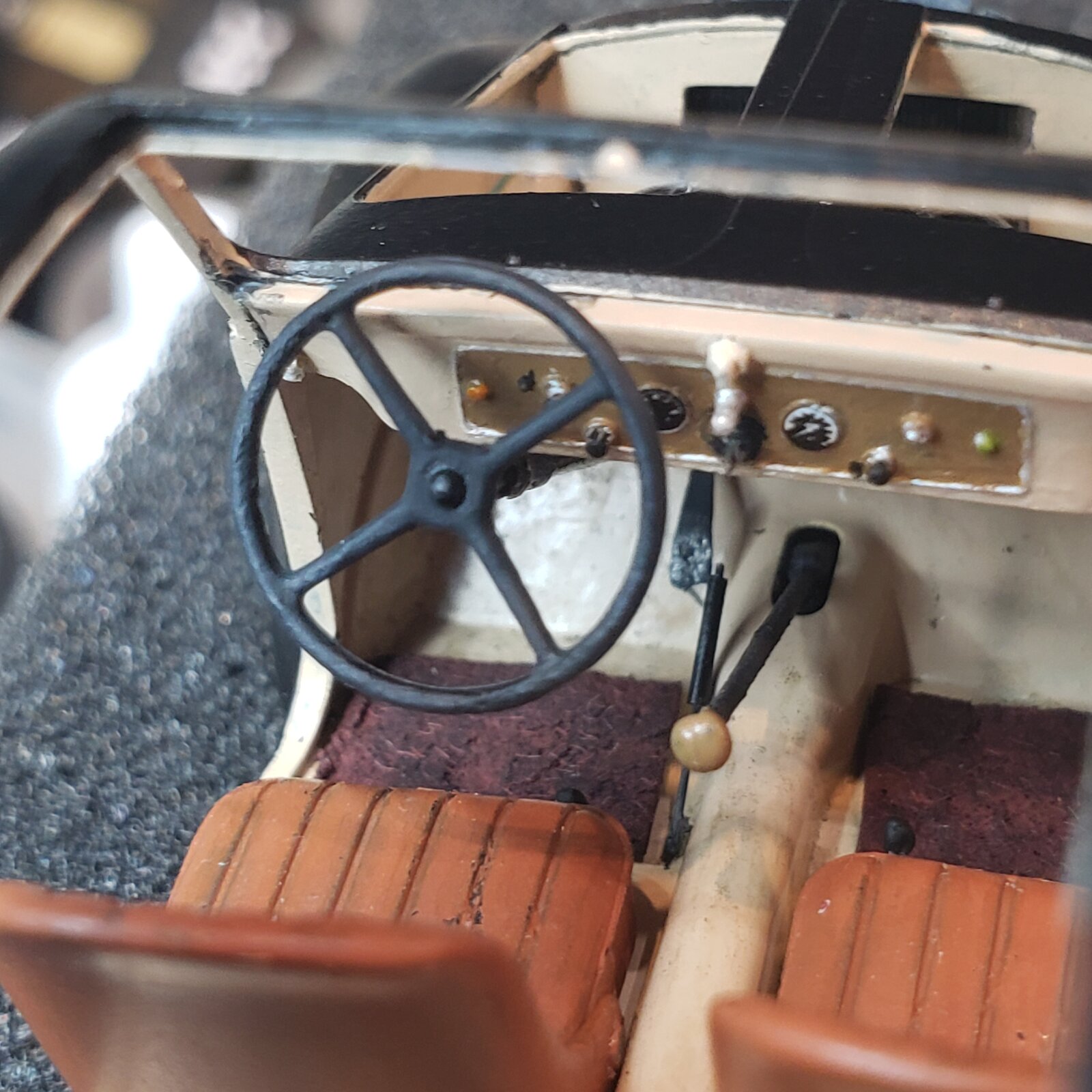

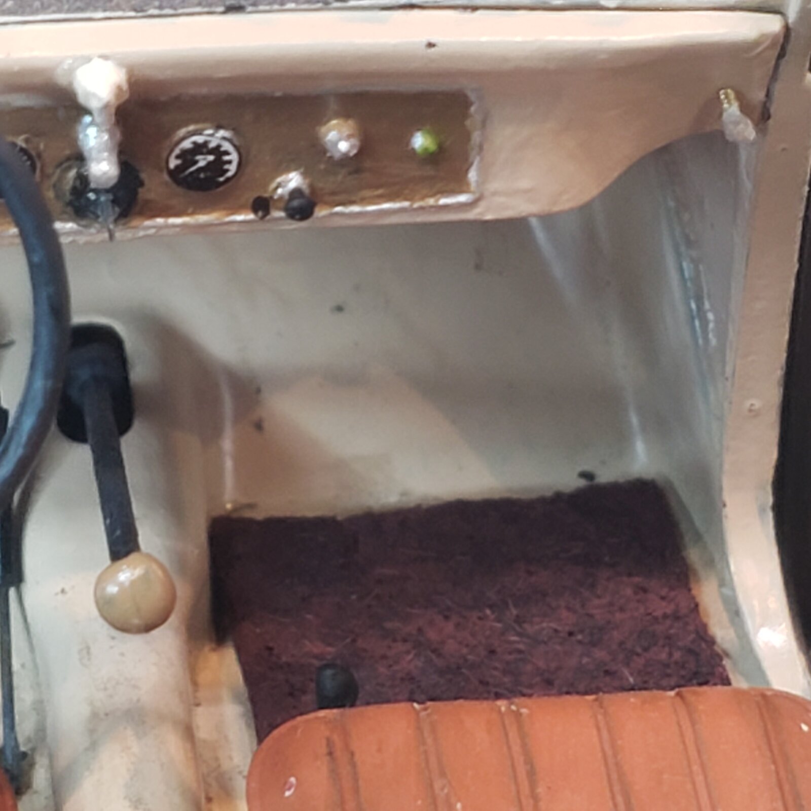

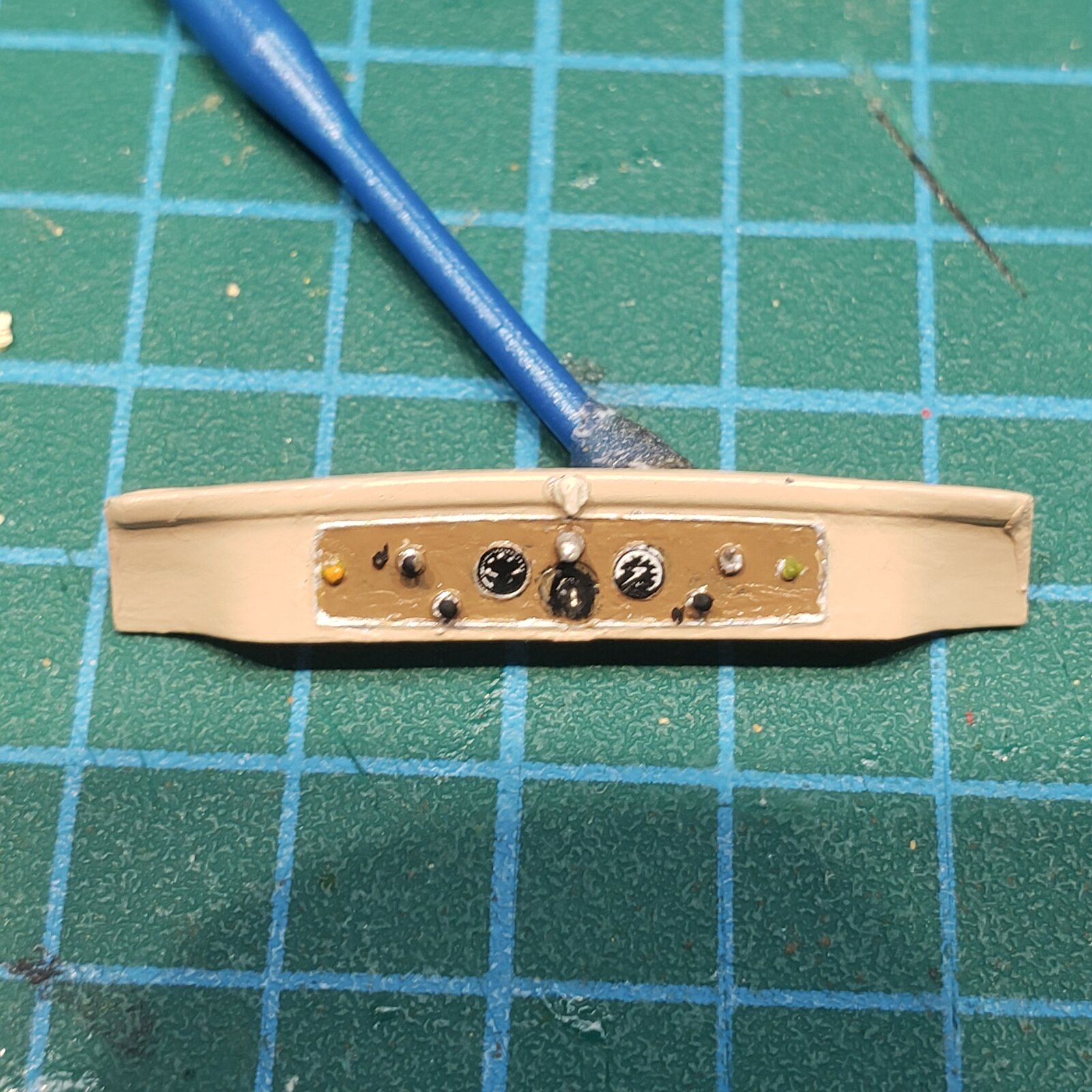

So I have three design problems related to my Topolino:
1. Improve the dash
2. Build a reasonable semblance of a roof mechanism
3. Find a suitable material for the retractable roof fabric
(1) Looking at the aftermarket dials and knobs from my stash, I may revert to my original idea of using resin rivets as the rivets better mimic the pull knobs of the Topolino
(2) I think I've got a solution for the mechanism that I prototyped above with brass rods. May need some tweeking, but feeling good about it.
(3) Lastly, the material for the roof.
The three current options are lens cleaning cloth, heavy gauge ziploc bag, and the 'finished' layer of a black leather belt.
Now to test their suitability. (Prototype)
