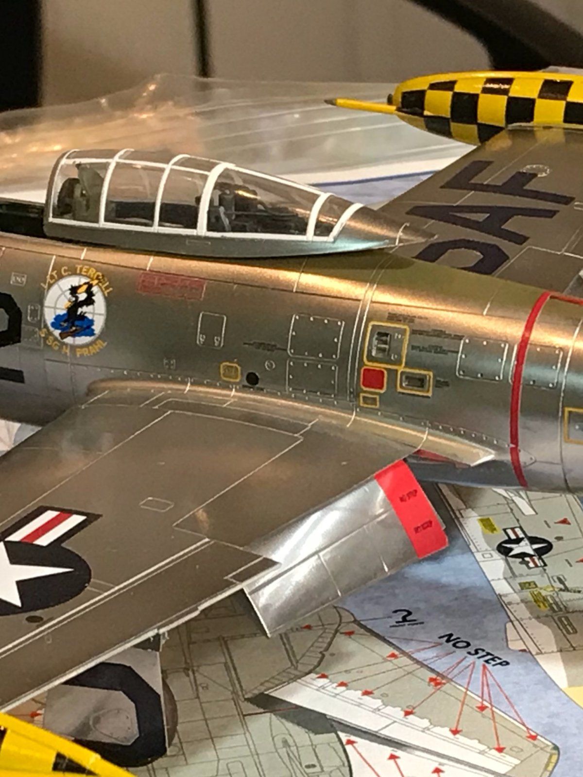

Gloss black as a base let dry overnight. Then shoot Alclad Chrome lightly just leaving a hint of the black peeking thru. This will give you a realistic chrome look specially on auto parts.
If you want to clear coat it use AK Gauzy Shine Enhancer. It will not affect the metallic sheen as evident on my F84 below sprayed over Alclad Polished Aluminum.B0079798-A178-406A-8B5B-2F9F2885CEE5.jpeg

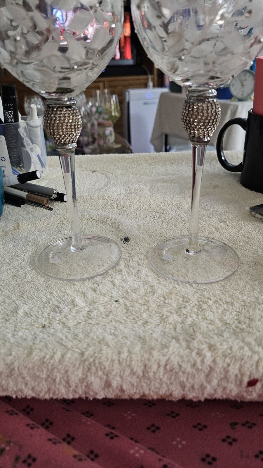

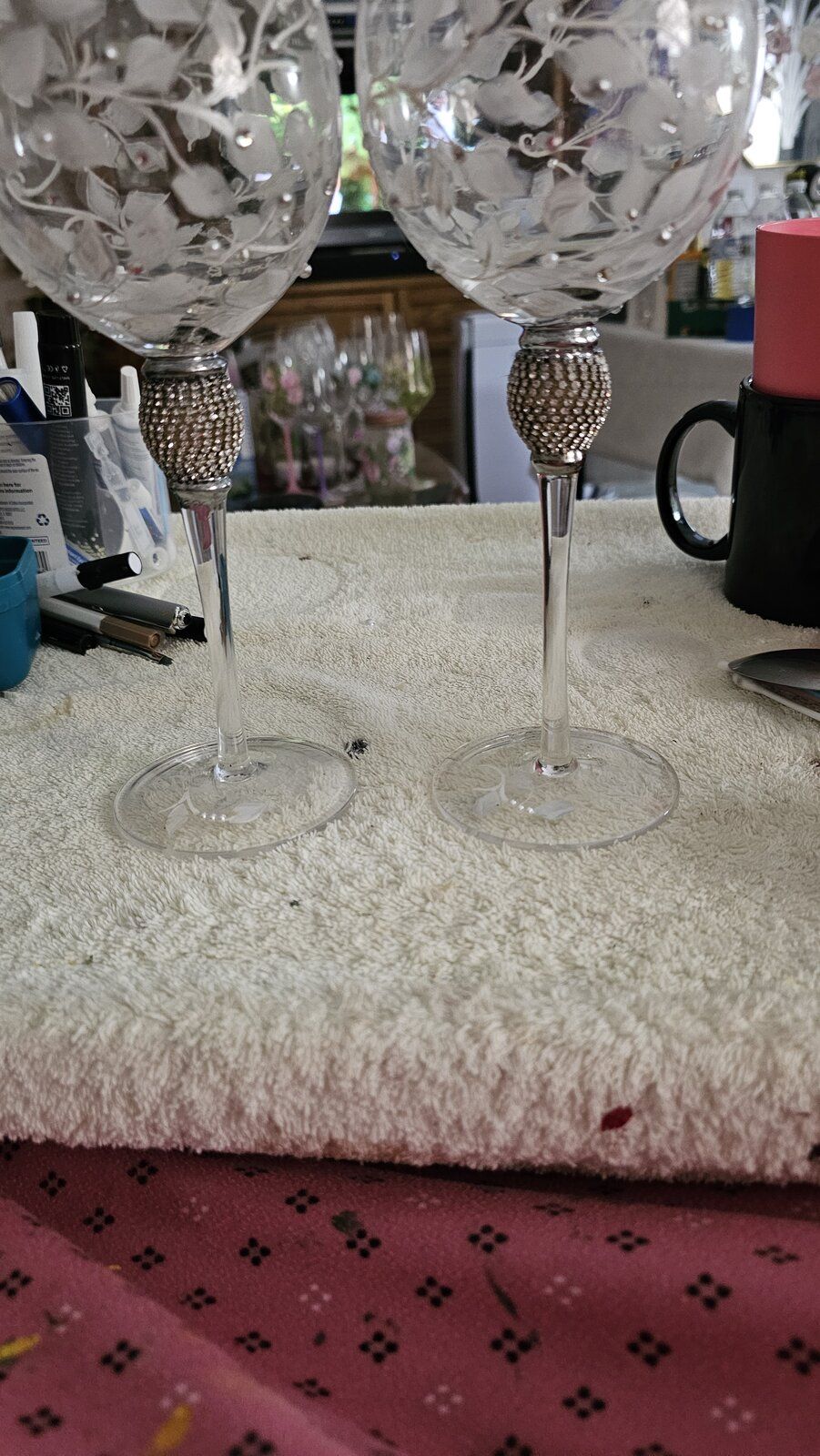

I have use my fluid chrome marker after I painted a design on wine glasses. I baked them in the oven I thought to set it and yet it was still not dry afterwards and remained untouchable. I used it on a pair of wine glasses to cover a Chrome area that was bare of chrome. It's was a custom order and I have to get it to the customer and yet, I have repainted that area at least 25 times because in painting the top of the glass bowl with my design, I kept hitting where the chrome was brush on.. It just won't dry!

How long does it take to dry and how do you seal it?
