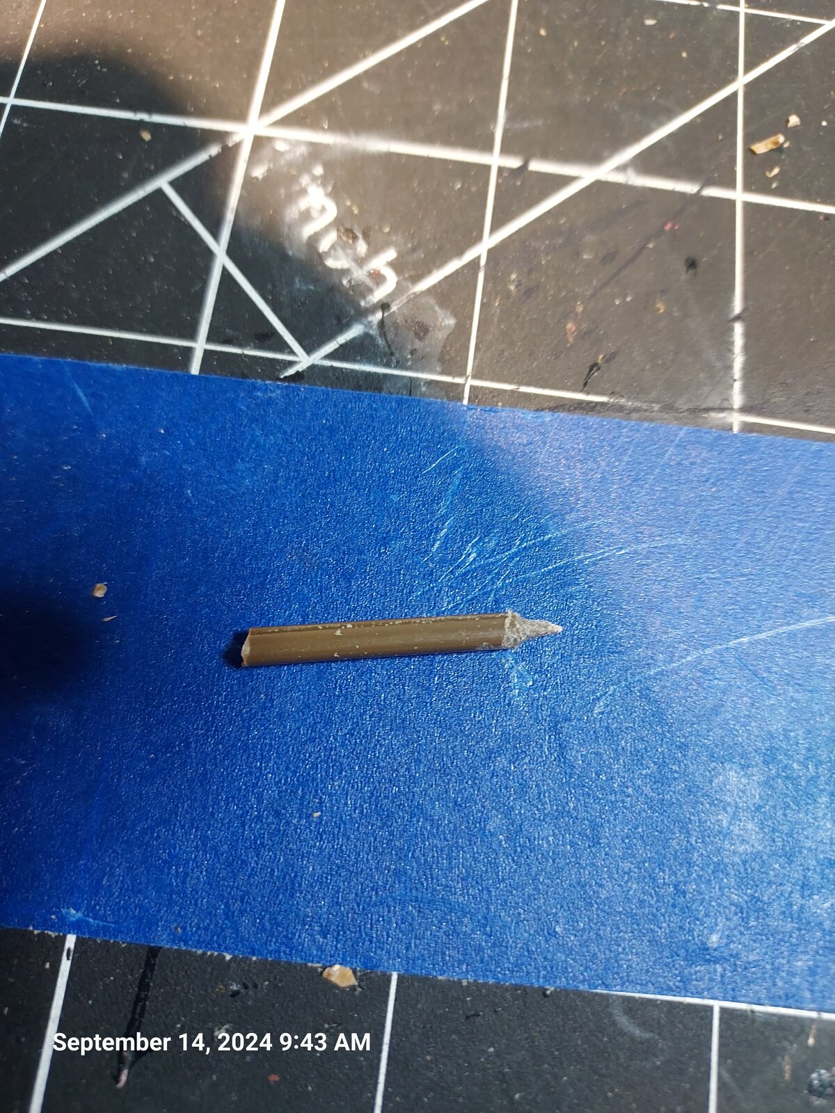

I am using old sprues to make some things. In the process i have to create nipples on the end of the sprue to connect it to a part. This takes alot of time to manually cut each one and none are exactly the same.
Someone needs to create a nipple creator tool. Maybe like a pencil sharpener which will make a consistant nipple. Maybe a special drill bit accessory.
By nipple i am referring to the little nipple on plastic model parts that inserts into a hole for glueing.

Here is a pic

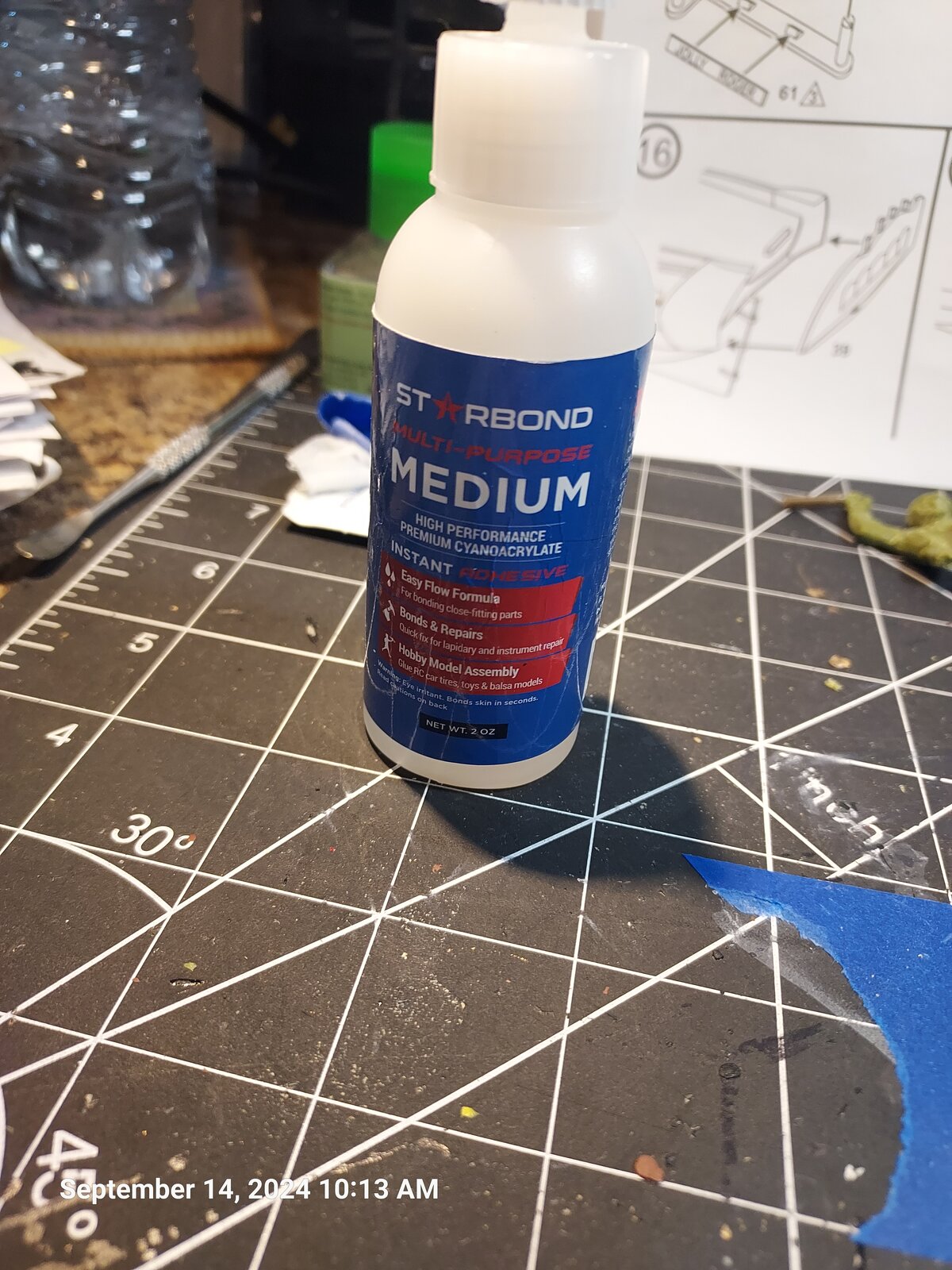

Could you just CA the part in place? Maybe use a 60 second type just to give you time to get it in the right place. Pantherman
That first photo of that piece you're working on ,
it appears you're sanding material away ?
I would slice out the mounting tenon using a sharp #11 blade .
Cut downward only , with the part firmly on the cutting mat .
rotate the part around to facilitate each set of cuts ,, it can be left rectilinear , or once it's the size desired you can quickly round it using fine grit sandpaper to match a drill bit size .
