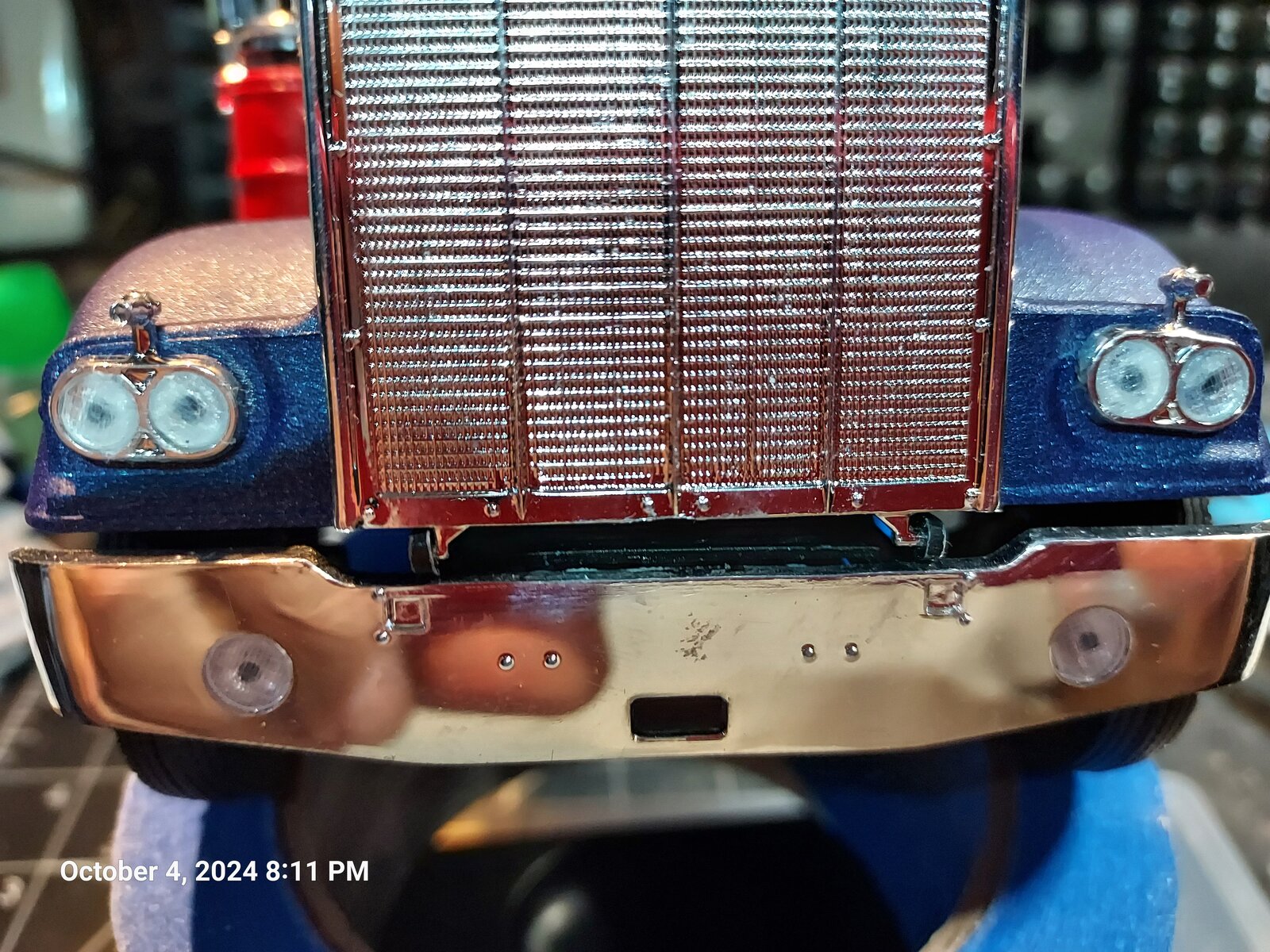

when i glued my windshield in the glue ran onto the clear plastic.
Superclean does not work, should i use my plastic polish
Yeah, the glue etched the plastic. SuperClean is a degreaser, a solvent, basically, and it won't undo the chemical etching that the glue caused. Like Momo and others have said, you have to polish it out, as fine as you can get it, then use a clear acrylic to fill in the fine scratches to make the surface as smooth as possible. That will let light pass through again with as little scattering as possible.
it came pretty clean after polishing and the window frame hid the worst of it. Just a small foggy spot remained and i can live with that.
To elaborate on this original post let me explain the reasons behind it. I was so excited that the progress went from very slow to wow im almost done seemed like in a flash. Then this happened even though i thought i was being very careful.
So what is the normal reaction when something happens, STOP the damage STOP the bleeding. I panicked and squirted it with superclean as fast as possible, not realizing that the damage had already been done and i was not going to STOP anything :( I was thinking in the moment "delute delute delute". I hope that makes since.
Now that i understand that fact and things make more since now, i can learn that there is no deluting anything. Chemical damage happens faster than the blink of an eye. Much different than working with metal or wood.
I went from excited to panic mode and crashing in a hurry. I hope this explains the post and my reaction. I do sincerely thank every one of you for your replies good and bad as its all a part of learning for me.
Now that i understand that fact and things make more since now, i can learn that there is no "delute delute delute" deluting anything . I hope that makes since.
