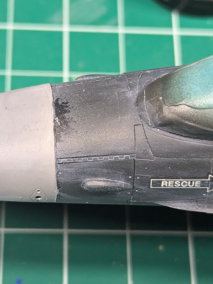

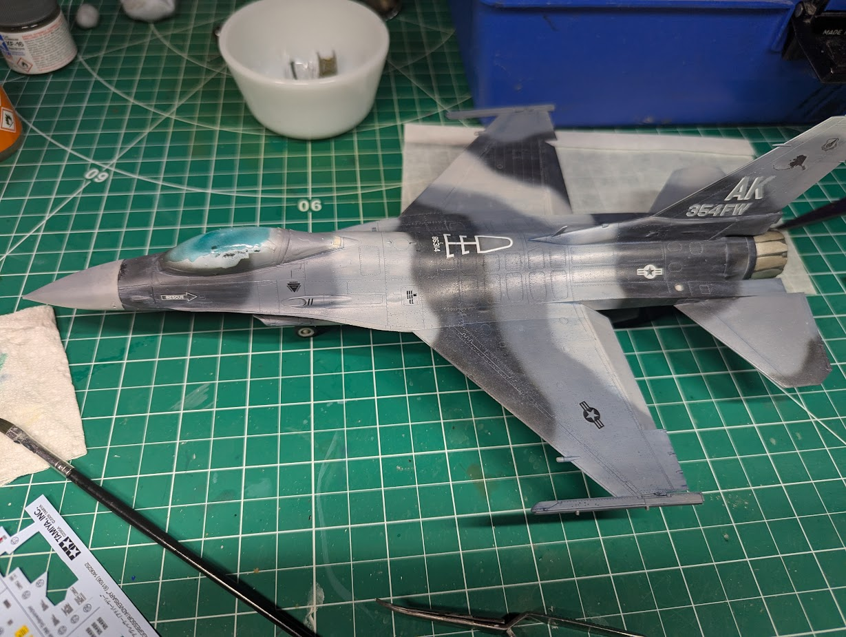

I ruined a paint job several months ago. My wash technique is that of a newbie, and I ate through or dissolved my base layer down to the lacquer-primer layer. I was hoping to remove the paint without harming the cockpit and to a lesser degree the landing gear and bays.
Here's the thread, and since you don't need to read all that, here's some pics showing why I cannot submerge the entire thing.
The light gray in the 2nd pic is artist-oil. When trying to use thinner to remove the excess I wore down the color-layer as seen near the radome. I'm hoping to spray the thing with the cleaner, and do it daily for however many days it takes to not ruin the cockpit. In fact, I'm considering post-shading and cleanup with an airbrush. It might be the best route. As I mentioned, the decals are done, in fact some are damaged already.

I'm happy with, it has been a bit ago but I think very happy with, the cockpit. As well as the exhaust, including the interior chambers I should add. If I were to fully submerge it they would be destroyed, landing gear and the bays are a lesser concern, but all I need to fix is the camo and decals.
Frankly I think if I intend to strip the exterior paint I'll have to give up that nozzle though.

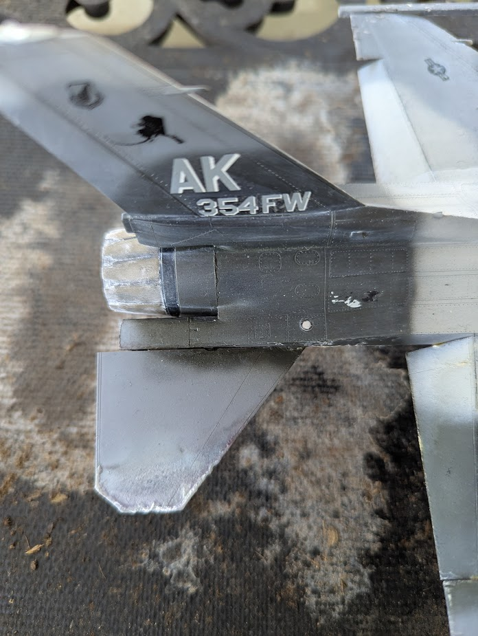

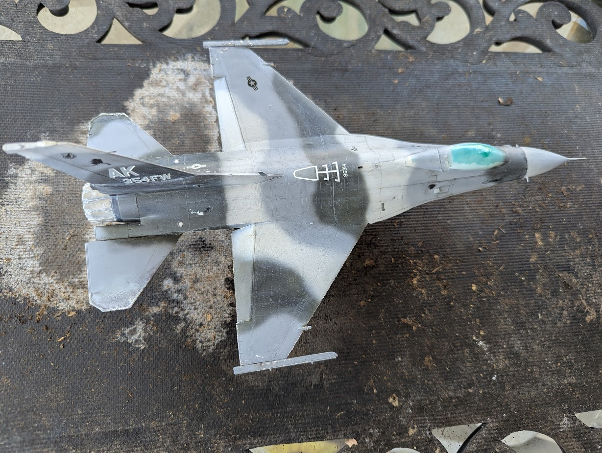

I'm going with the milder approach 1st, the super-clean comes in a spray bottle. So doing this outdoors (it was almost 80 today, two days before new year) and on a surface I can give up, I am making multiple trips to the backyard to hose her down. I'm concerned about the cockpit but not the canopy. However leakage around it is giving me the skeeves.
I think that after a day or two of this, if the paint is not loose enough for a toothbrush I'll have to get stronger stuff.
If that doesn't work I'll scavenge the interior and have a paint mule.
