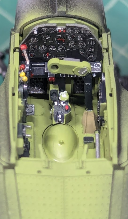

Really nice looking build. I have this kit kicking around in the stash - I think I started painting up the cockpit about two years ago and kind of forgot about it - I really must pick it up again.
