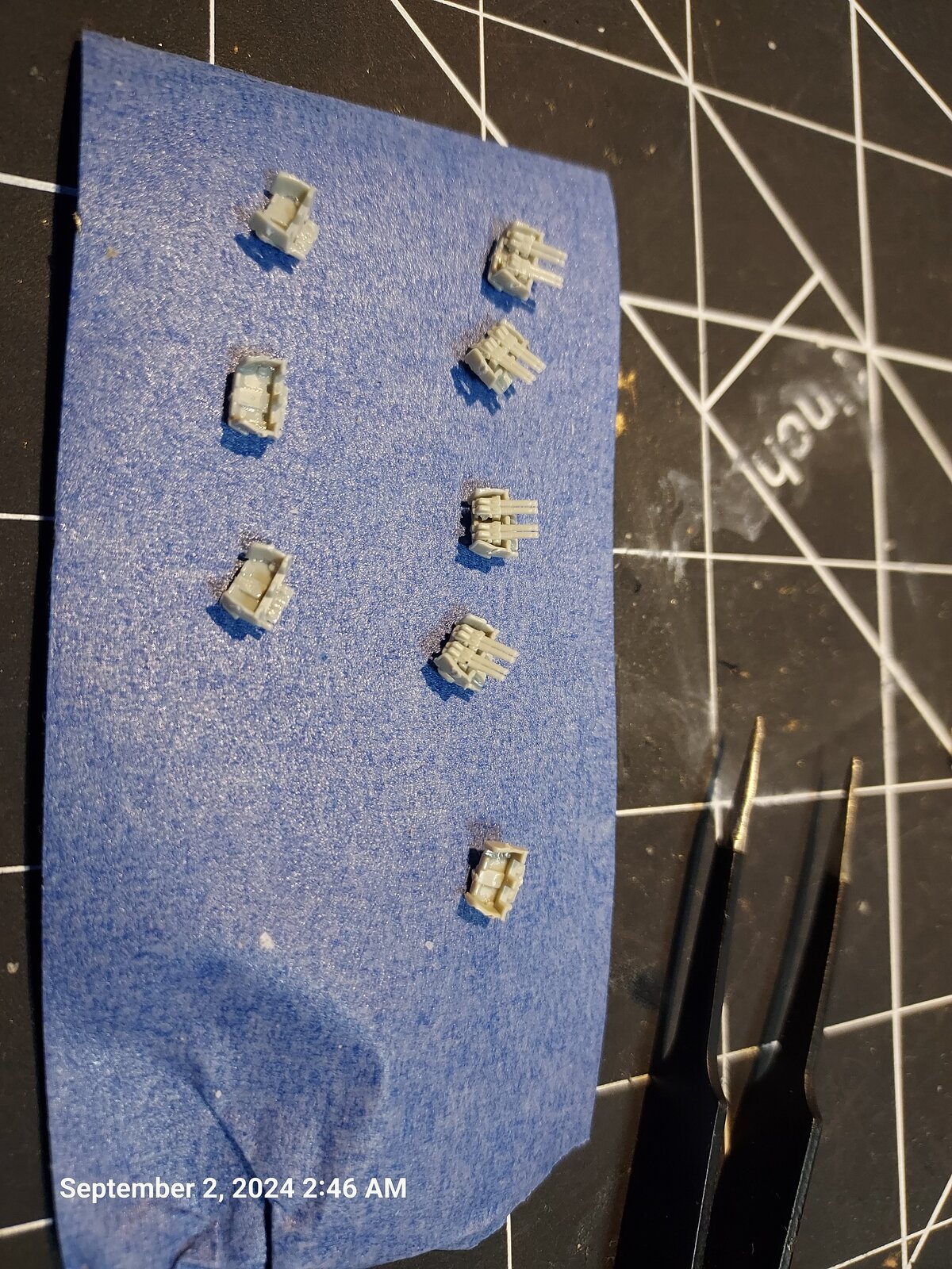

i tried that method @urumomo on the hull n deck of this ship thanks so much it works as you said
I also think i have solved part of the reason parts were flying. Seems my tweezers had gotten a buildup of hard gunk on the inside where it was supposed to be flat but it was rounded over. Once i shaved the gunk off which made it flat again, these guns are going together quick n easy. 4 parts, base, supports, and two guns. That was certainly part of the issue.
