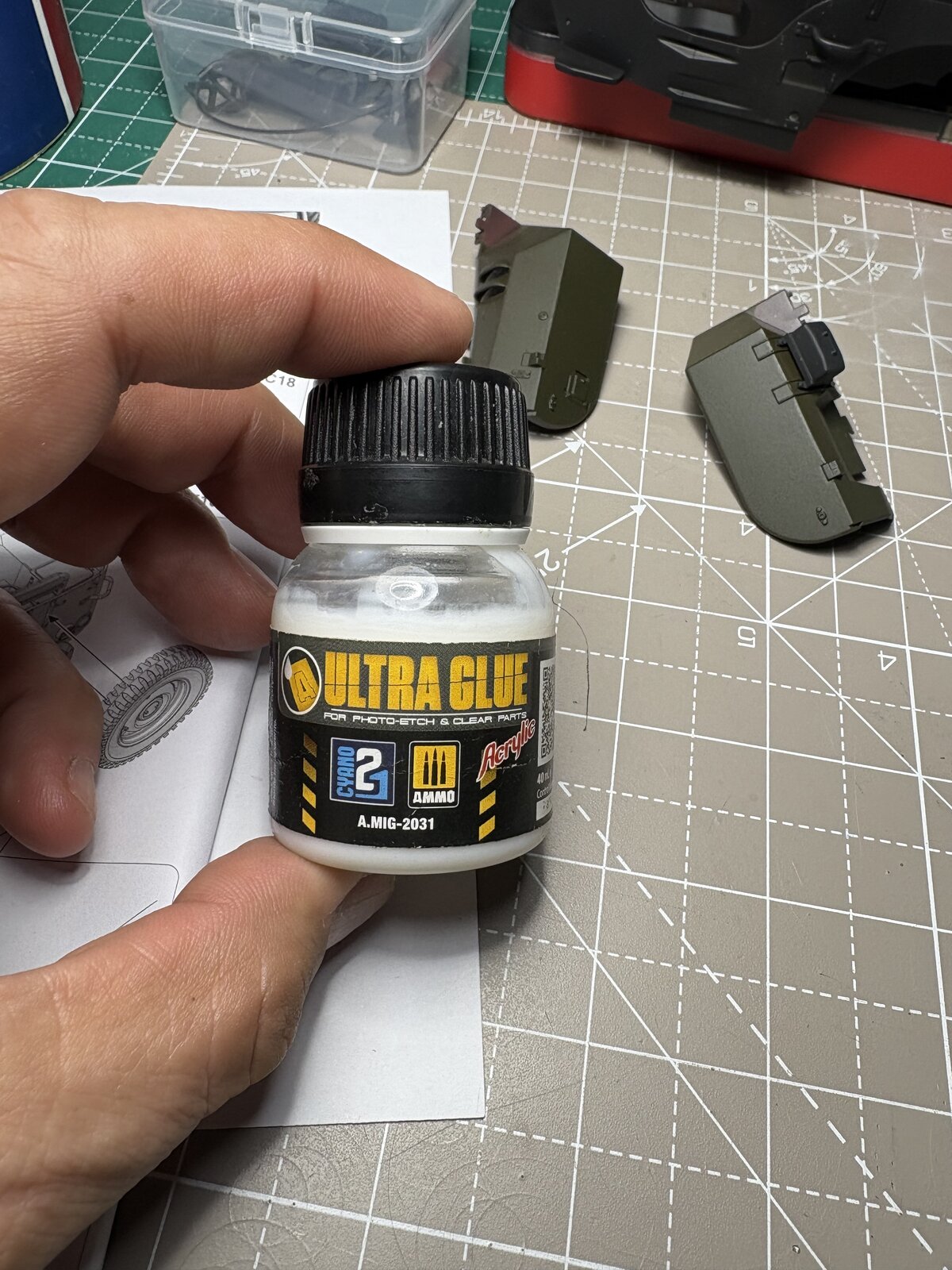

Thanks for those tips. Speaking of the glue I was wondering what to use to attach PE to clear parts. I use CA almost always on PE to plastic, but I know it will fog the clear.
This is what I use for attaching canopies and clear parts, as well as not-clear (unclear? ;)) parts to clear parts. (This reminds me, I need to buy more.) It behaves exactly like Micro Krystal Clear™.
