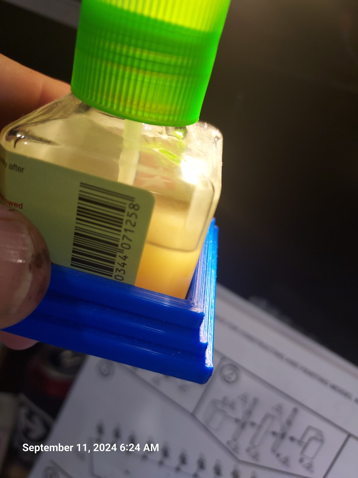

With me glueing alot of painted surfaces, seems my glue is getting a bit dirty.
I know this most likely wont work because its glue but the thought crossed my mind about using a coffee filter to filter it. Probably just make a big mess.
Is there a way to clean it or is this a common thing?

After applying the cement to the painted surface you need to just quickly wipe the brush on some paper towel if it has picked up any paint before you put it back in the pot.
The best thing to do would be buy another pot of cement and use the discoloured one for sprue goo (yellow sprue in this case). Pantherman
You're really into inhaling all that vapor aren't you . ;)
I've never heard of anyone even attempting that ; there's really no need .
Like I said earlier , it's half acetone and half butyl acetate , so that turbidity would require a super fine filter to remove since the resin in there has been totally dissolved .
A coffee filter would probably catch some of it ? , maybe ? lol .

Here's a hint…. liquid glue (or tube glue) and paint don't play nice. Why? They leave a mess, glue don't stick to paint.
My advice is scrape any area where glue needs to adhere and set.
Don't bother with coffee filter to get dirt residue out. Most likely they'll be settled at the bottom of the bottle. You only making more of a mess than what it's worth.
