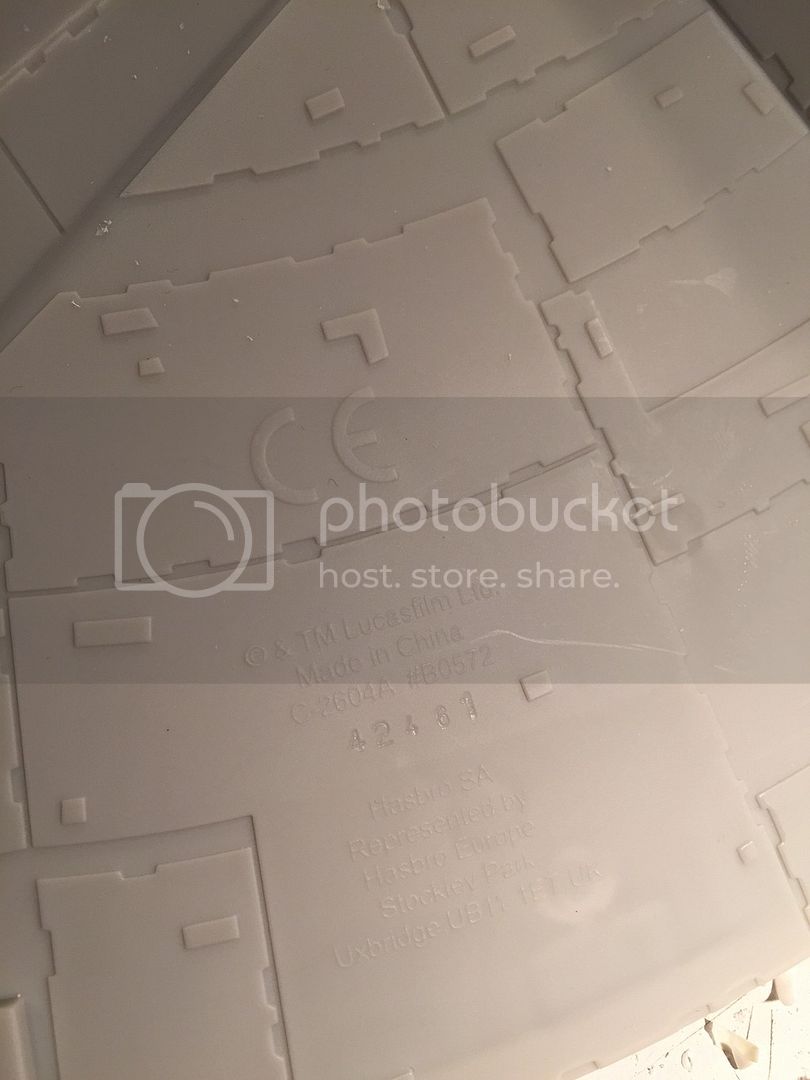

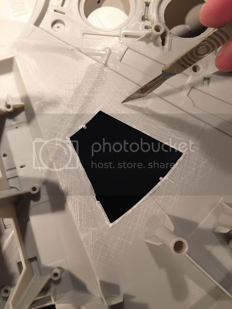

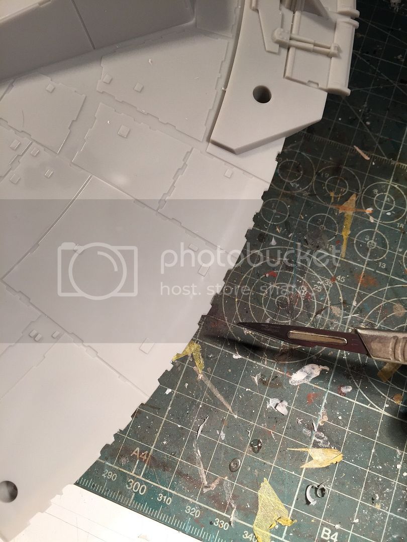

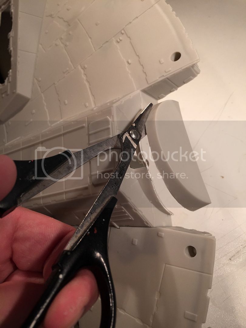

At the beginning cutting out the windows and inserts I just cut everything with a sharp scalpel,....but now when removing engine deck details, I cut away as much was I can with side-snips,...then remove the rest with scalpel,....to get all surfaces flat I sanded with different grades of paper finishing with fine wet & dry,.....wet the paper to get the plastic really smooth again.
If an area like a window frame gets all messy,....the plastic looks all furry,...give it a blast of adhesion aid,.....then you can put a thin layer of super-glue on it.....and you can work with that then.....sand smooth with wet emery paper
J

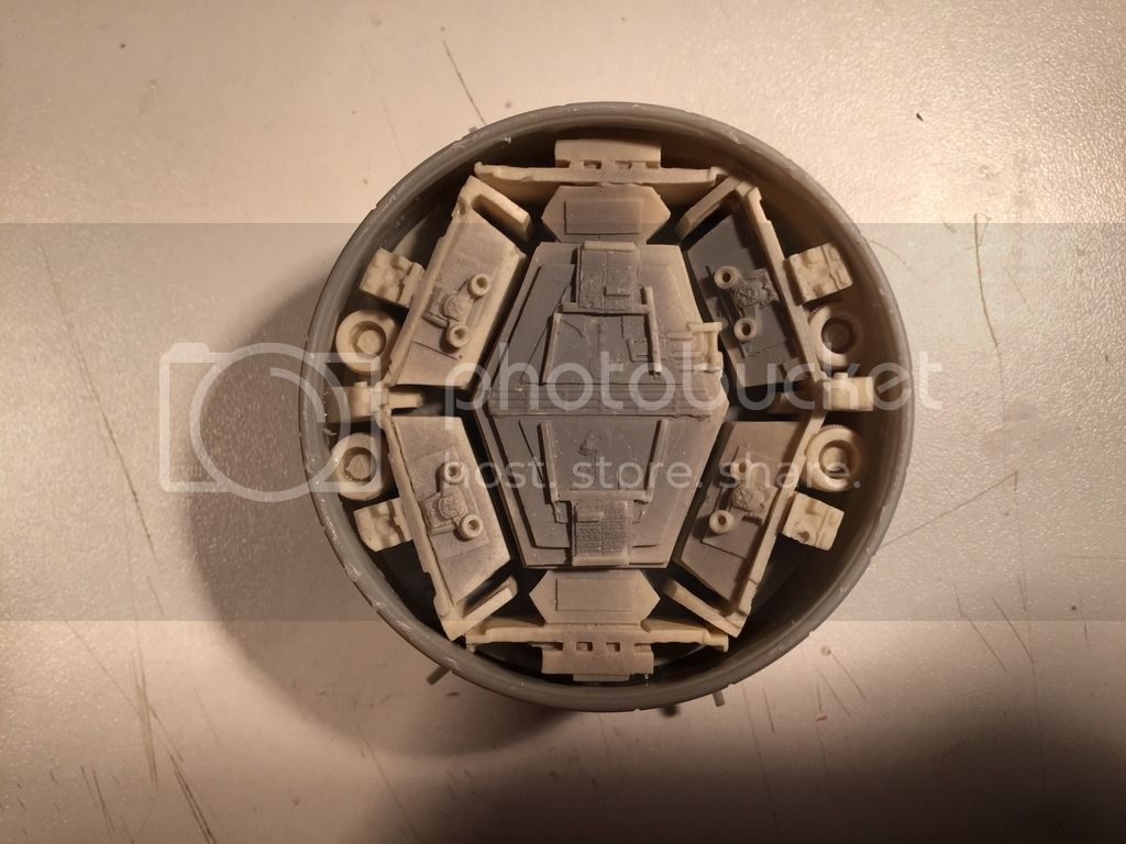

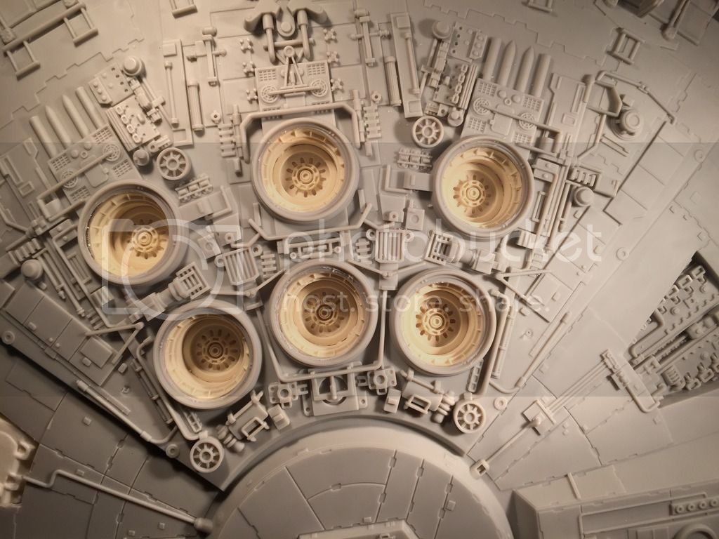

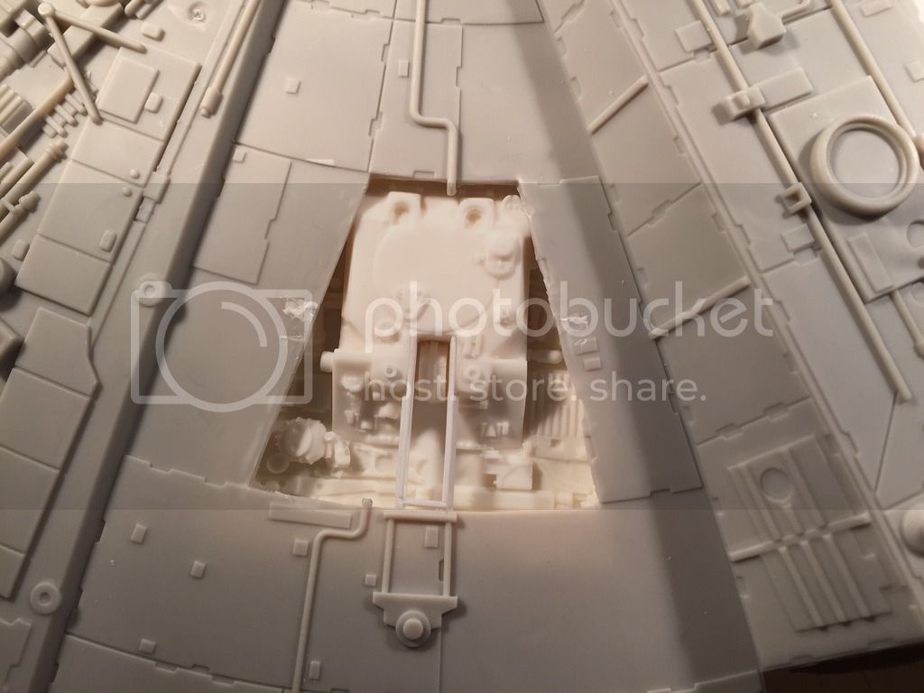

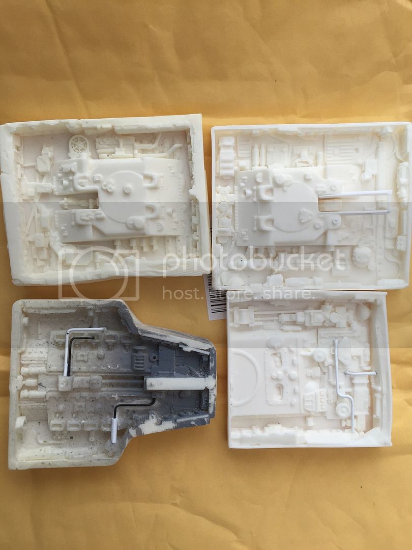

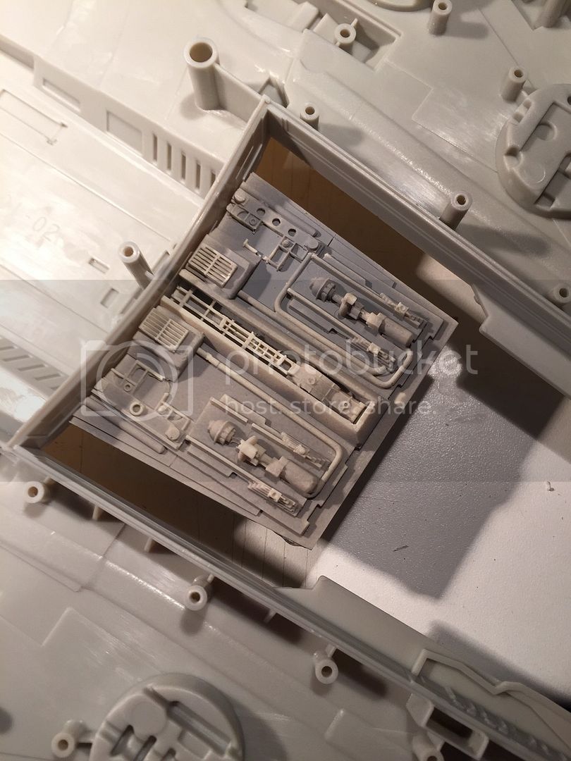

Thank you John, I've nearly put all that into practice and it does really help mate. Ok so here's tonights update, got a nice package through the post!
And it does look good, and very different to the kit part:

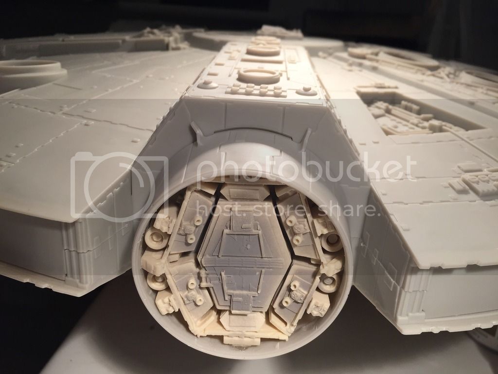

Then it was time to cut out the engine grills, I used a inch and a quarter round saw bit:
And all done:

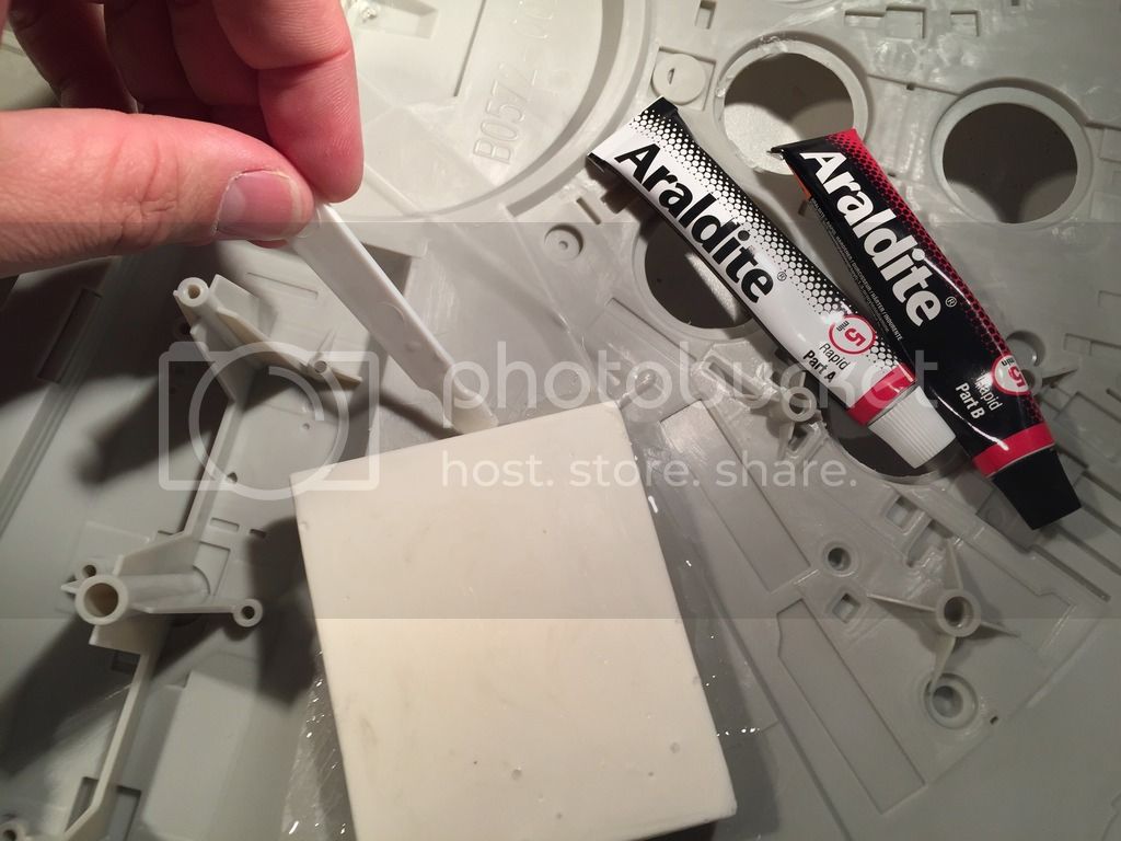

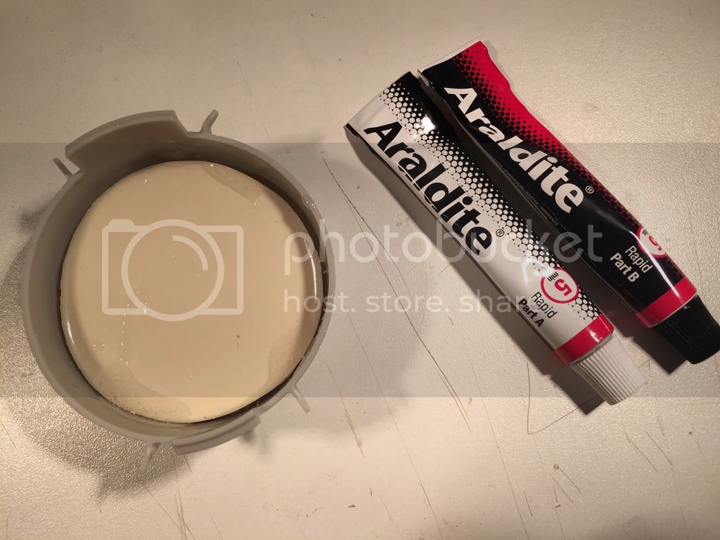

Yeah hopefully the primer will be ok, I test glued a resin part of Randys on the old cockpit (as that is being scrapped) and it has appeared to have stuck well using two part epoxy 5 min glue. No primer just bare resin to plastic.
