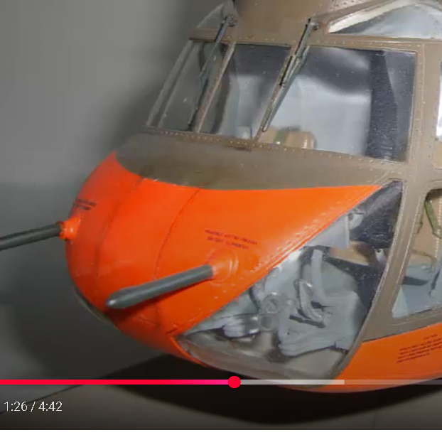

Orange DOES look better after I gave it some dry time, I even have some black models to play with so I will be trying that

I'm greatly dissatisfied with the Orange. I might just leave the orange out. I just put a third coat on the wheel and we will see what that looks like... I realized that the wheel might be difficult to paint with all it's little indentations. Water cleans out the brush easily and I think I finally got the paint to the right consistency like milk like somebody said on here. I have another wheel and if I can't get this wheel to look good I will try the other side of the wheel without the indentations. I found that using a brush that's too big causes the paint to thin too much wasting the paint. I also found out NOT to use paper plates with a Thinner in the paint brcause the plate melts.
EDIT:: I wish it looked like the paint on the paper... THe green is just fine and covers well.
It's dry but the paint thins out across the top areas and gathers in the indentations.
