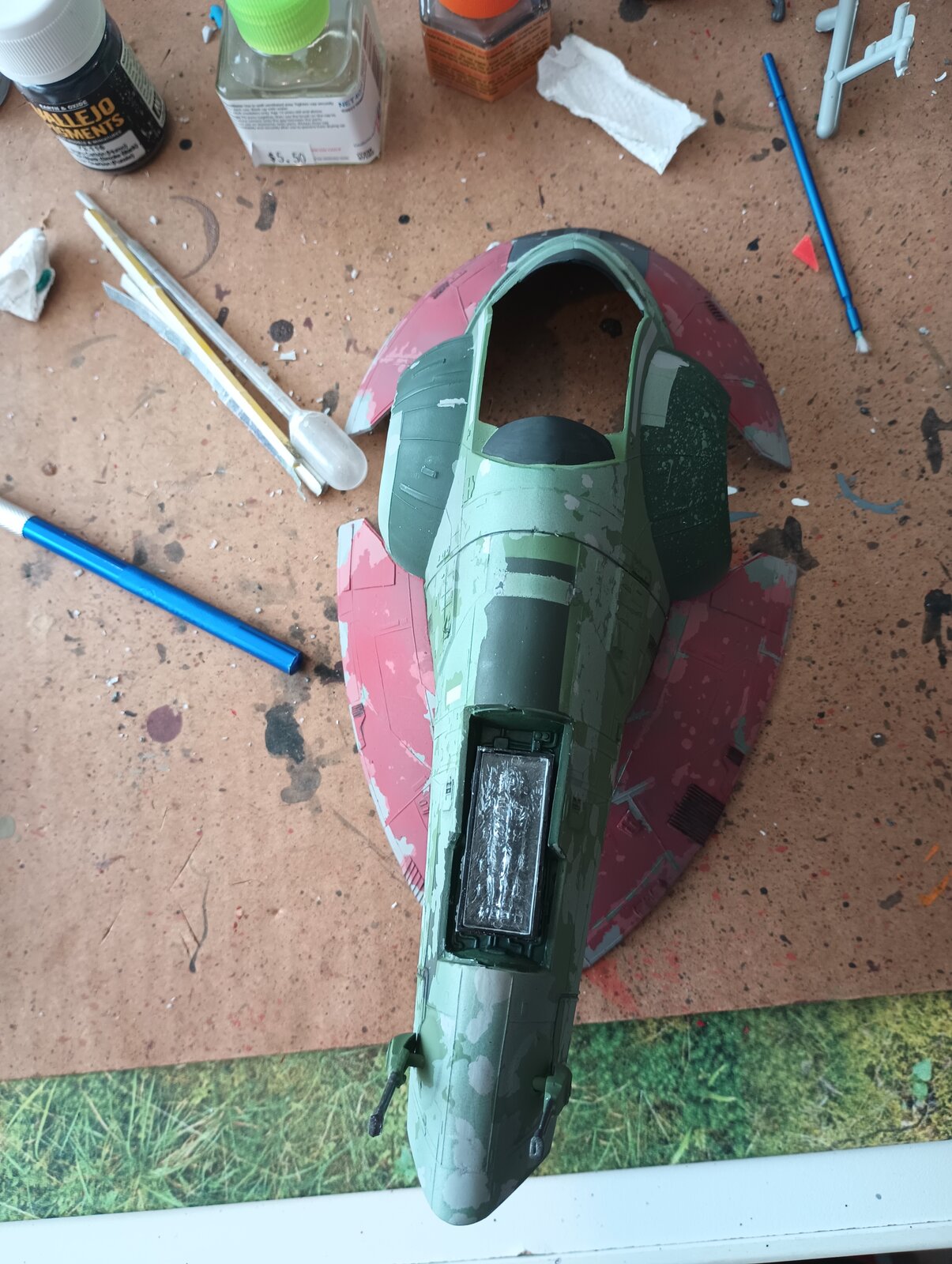

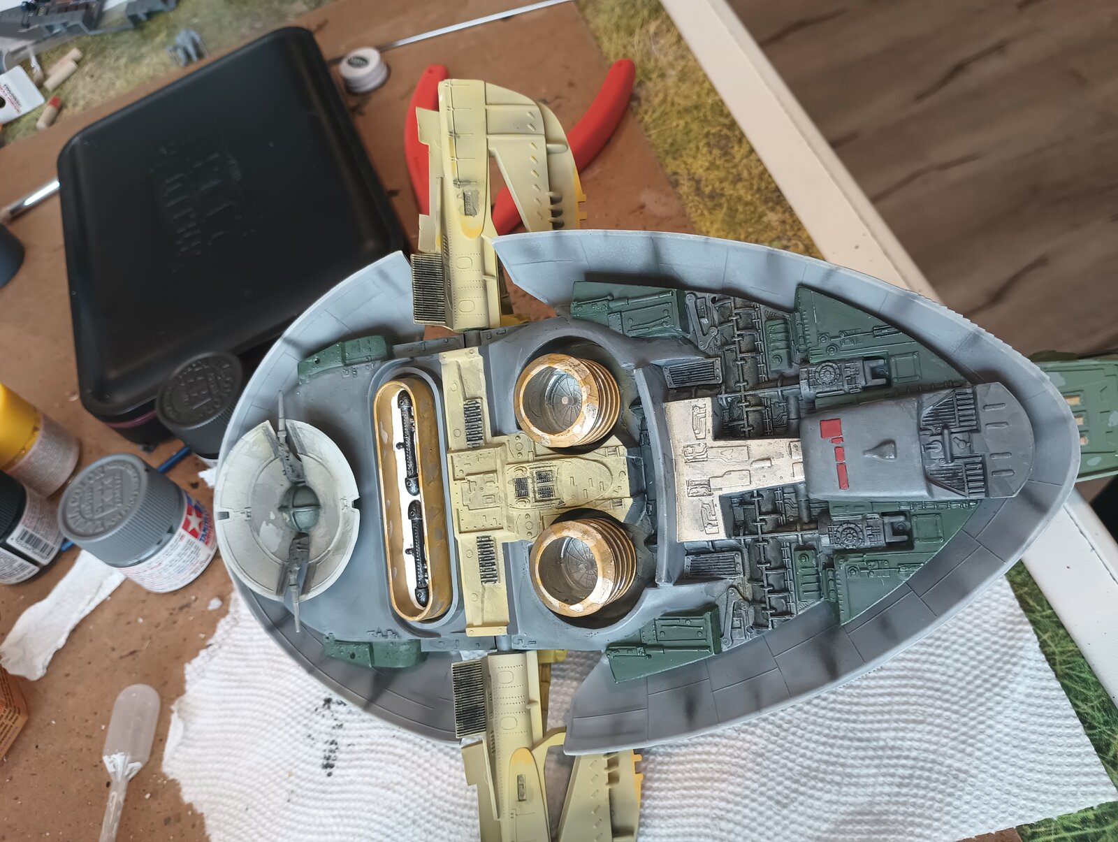

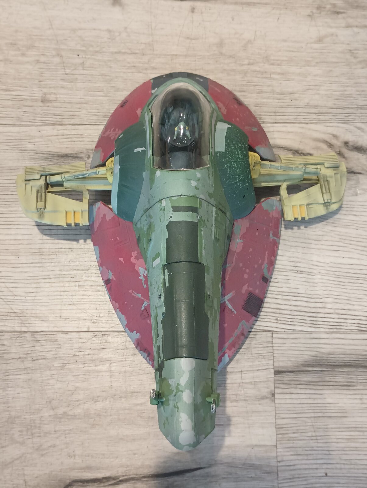

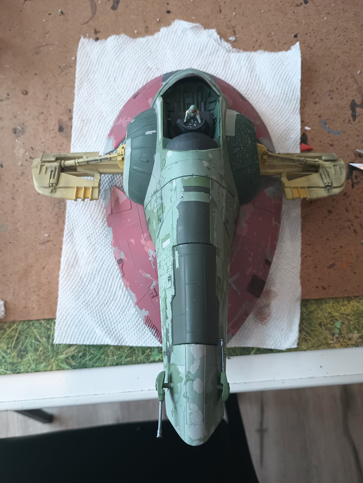

All of the base layers are finally on the hull. Need some touch up, detailing, weathering, and the a light mist coat of gray over everything when completed. Hoping some of the colors will come around better after the mist coat, I'm also worried the first green mist coat may be too light after that coat. First time using masking fluid which is nice for this build. Still a ton of work left, haven't even touched the engine side or the wings yet. All in all even with all of the research this has been an enjoyable build. Slave I (16).jpgSlave I (17).jpg
All of the base layers are finally on the hull. Need some touch up, detailing, weathering, and the a light mist coat of gray over everything when completed. Hoping some of the colors will come around better after the mist coat, I'm also worried the first green mist coat may be too light after that coat. First time using masking fluid which is nice for this build. Still a ton of work left, haven't even touched the engine side or the wings yet. All in all even with all of the research this has been an enjoyable build. View attachment 120732View attachment 120733
It's looking great, loving the weathering. PM
Looks great!

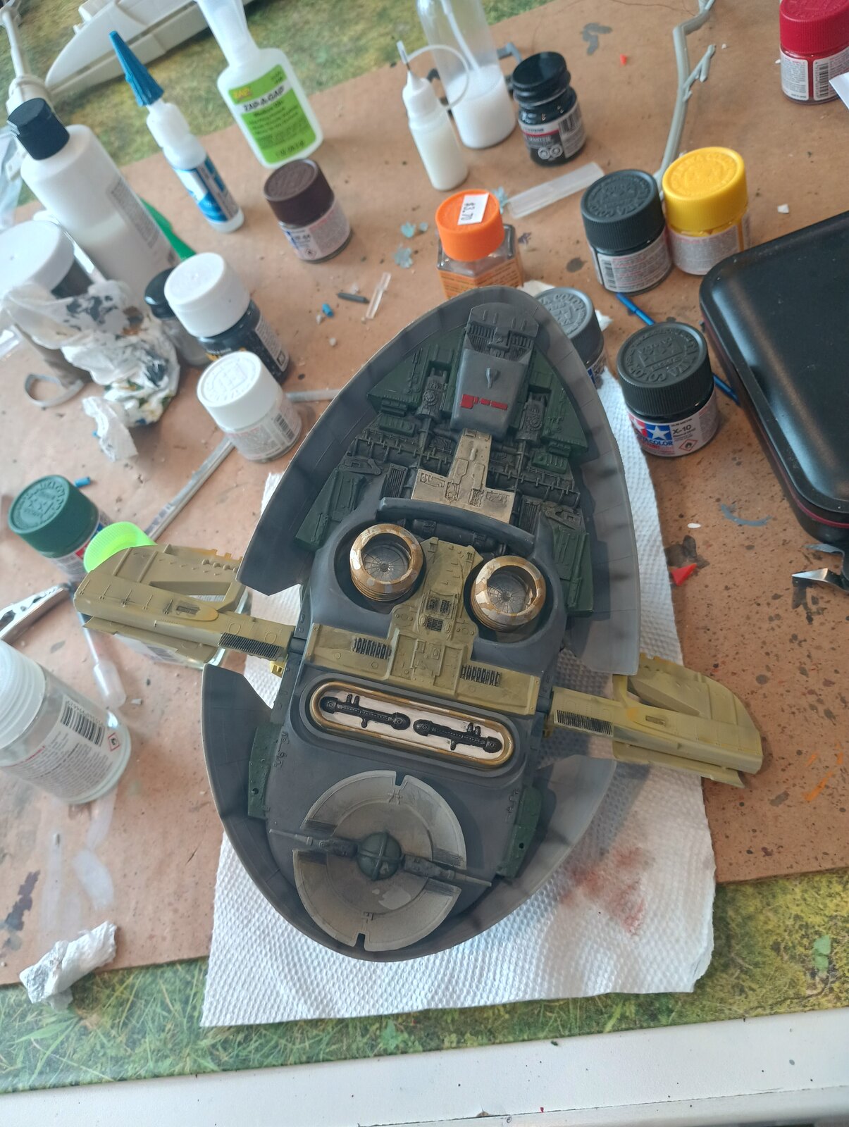

Finally got my got my Shapeways MPC shuttle engine inserts this week which I've been waiting on for a month - and I almost caused the first instance of major damage right out of the gate.
The first image doesn't show it but the vents for these aren't hollow all the way through so I thought I would have to scribe out the holes or drill them myself - which I commenced doing. However, because they are 3D printed, the plastic turns out to be a lot more delicate than I'd anticipated and the first couple of holes really caused some damage to the material. I immediately stopped and I thought I'd ruined them. As I was assessing the damage with my phone's light, I realised the plastic material itself is quite transparent and the light passed through it quite well. So I made the decision to abandon drilling out the vents and I patched up the holes with some glue, then I matched the colour of the inserts as best I could and painted the area I damaged. I actually did a reasonable job - so much so, it would take an eagle eye to spot it.
I proceeded to painting them with the gun metal grey I've used for the main guns and landing gear and then fixed them in place. They fitted in really well and I lined them out with additional aluminium foil before glueing them in place.
In the course of doing this, I decided to move the light tubes and their backing mounts back and glue them directly to the backs of the engine inserts.
The result came out better than I anticipated. I will need to touch up areas on the finials to address some of the light bleed in between each one but I'm really happy with the engine glow effect. I would definitely recommend the tan version of these inserts (as opposed to the grey version) because the resultant yellow glow looks really cool!

So another decision time that previously led me to procrastination. Use photo-etch or not around the cockpit tunnel to represent the Koolshade parts on the original model?
For any who might not know what that is, Koolshade is same material the Tie Fighters wing panels were made of. Was actually a very fine metal shade that was used as sun blocking window blinds back in the ILM days
Looking closely at the parts, I feel the molded plastic parts are actually better detail than the photo-etch
Left is the plastic parts. These are amazingly fine and crisp and even the holes behind the grilles have depth.
On the right are the alternate parts that you can use to glue the photo-etch onto
Although I feel the photo-etch while a bit finer detail when it comes to the holes behind it is actually very flat and less overall detailed looking
So the original plastic parts it is
The only downside I see is there is a noticeable seam/gap between two of the pieces. Maybe I made an error in putting together parts as I know from past experience, some other part being a hair off in some different step like the tunnel construction can cause fit issue with other parts later, but I don't see gaps elsewhere. You can see it off the the right above and then here below as well
Should not be too noticeable once paint and weathering go on in this area I am hoping. If not I will have to try filling as best I can without screwing up the details
But then again, from this angle it is hard to tell

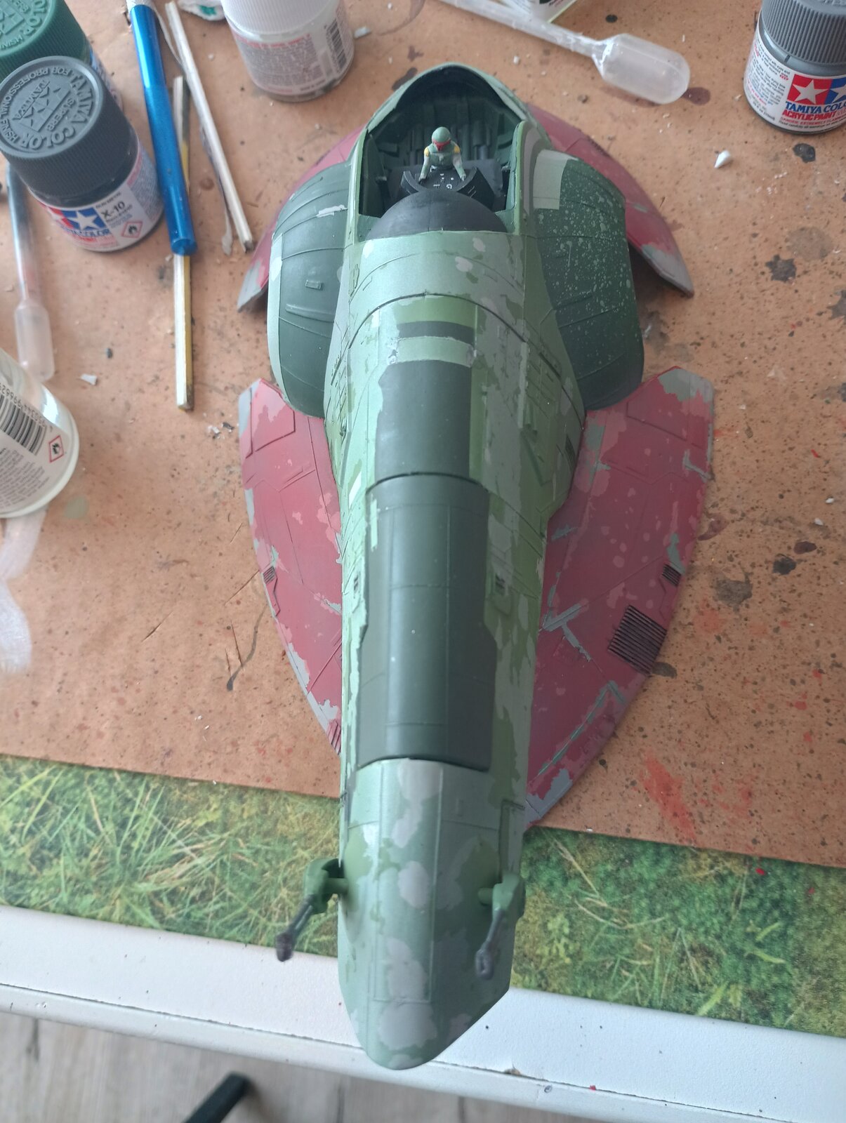

Also finished the other turret. Gave it a bit more time getting the various panel colors to match the set piece
and yes, I use my thumbnail to wipe excess paint off the brush before touching the brush to the model, or test if things are too runny, or check color, or need more thinning etc... :D
Not going to stress to much over neatness/crisp straight lines, since it only needs to look good from the front angle looking back instead of side on
Fantastic detailing! Fabulous work, brother!
