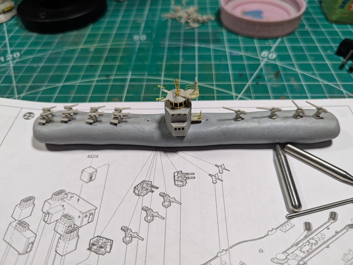

As I mentioned, I'm on the slow track with the I Love Kit 1/350 CV-6. The kit depicts the ship as of fall, 1942 at Santa Cruz. I want to backdate a bit to Midway, and happily most if not all the appropriate parts are in the box leftover from their CV-5 kit. Here are some pics:
The first thing I had to do was add de-gaussing cables. The kit supplied photo etch ones are, of course, flat. But they are also completely the wrong shape. No idea what they were looking at. Anyway, some .015 rod and patience later, here we are.20240714_164749.jpg
Here's where I am now with this one:
I'm going slow with this one. Ships are not normally my thing but I've always been a big fan of Enterprise and I want to do it right.

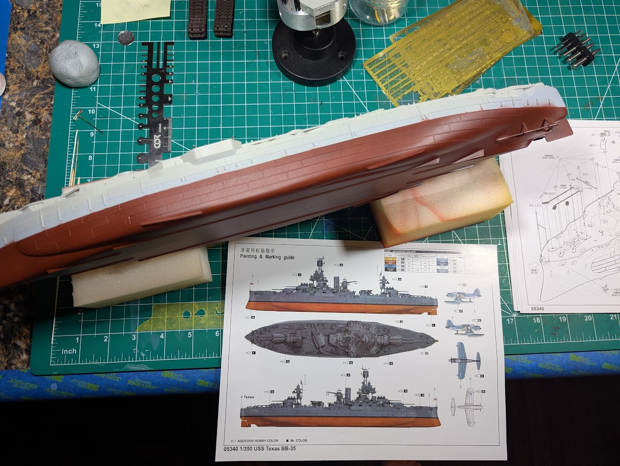

So to start, the Academy kit has a two piece hull, upper and lower if you would like to waterline it. As I'll be building her full hull, I had to take care of three injection points on the bottom hull. Now they really won't be seen, but I know they are there. My first step was to drill them out just deep enough to punch out styrene sheet to fill them just slightly above flush so they can be sanded and never be seen again.
I generally prefer this method over putty or filler, as it is stronger and plastic through and through. If you ever have to scribe or drill, you can do so without long cures and cracking from putty.
Anyway, here are the injection points in the plastic lower hull:
One close up:
And after drilling out to match the punched plugs:
And after plug inserted and fused in with Tamiya extra thin cement:
I'll let them set overnight, and then sand them flush and done. I'll give the full lower hull a good wet sanding to remove all seam lines and prep for joining lower and upper hull.

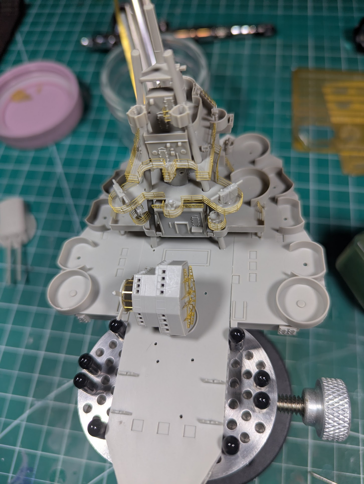

A little bit of a late start for me, but I finally got started on the 1/700 scale CV6 (pulled it from my stash and the USS Arizona fell on my head. Forgot I had that one).
Those little guns were a pain.
View attachment 135632View attachment 135633
Got as far as I want to tonight, I'll get more done tomorrow
Great start on this. Love the coffee mug too.
